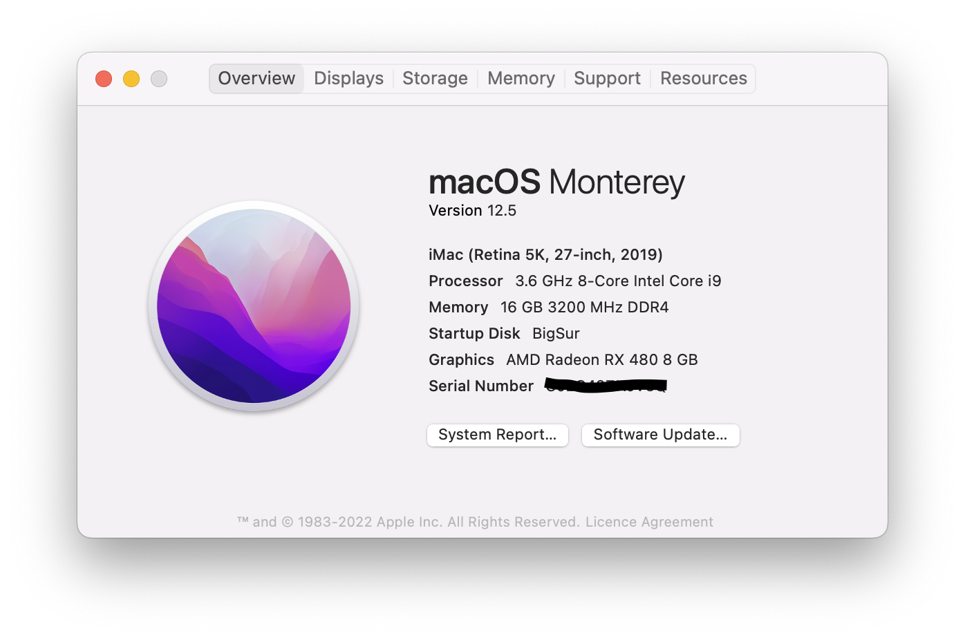

Ziadantosh Posted August 5, 2022 Share Posted August 5, 2022 First thanks to @eSaF @pkdesign for their suggestions and help 🥰 So, I managed to brick my EFI couple of times before I successfully update it from 0.6.3 to 0.8.3 - then upgraded macOS from Big Sur beta to Monterey 12.5 and it worked 🕺😍 And finally I have Premiere Pro and Final Cut Pro working Anyone updated to 13 beta 2 yet and how is it? Thanks again Oh I forgot! How can I get iServices working? as when I launch it and login with my fruity ID it shows ⬇️ 2 Link to comment https://www.insanelymac.com/forum/topic/339980-audiogods-aorus-z390-pro-patched-dsdt-mini-guide-and-discussion/page/198/#findComment-2790800 Share on other sites More sharing options...

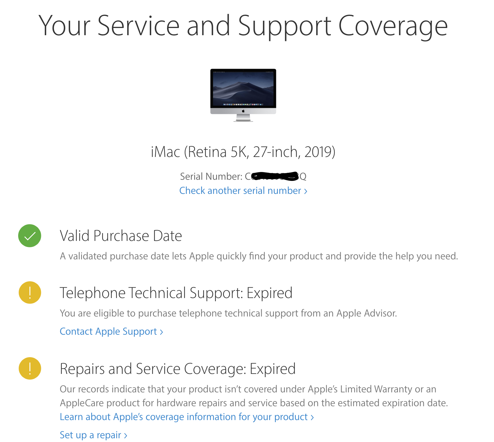

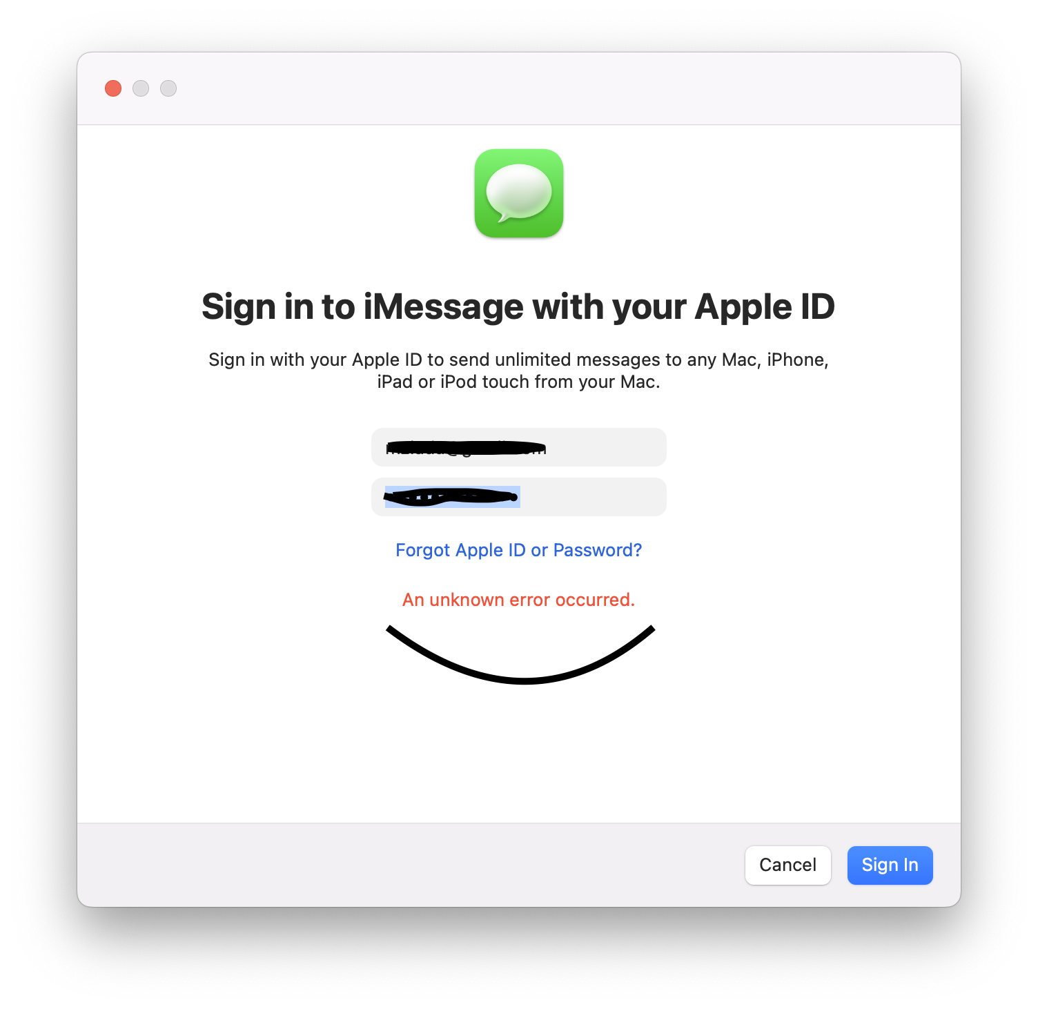

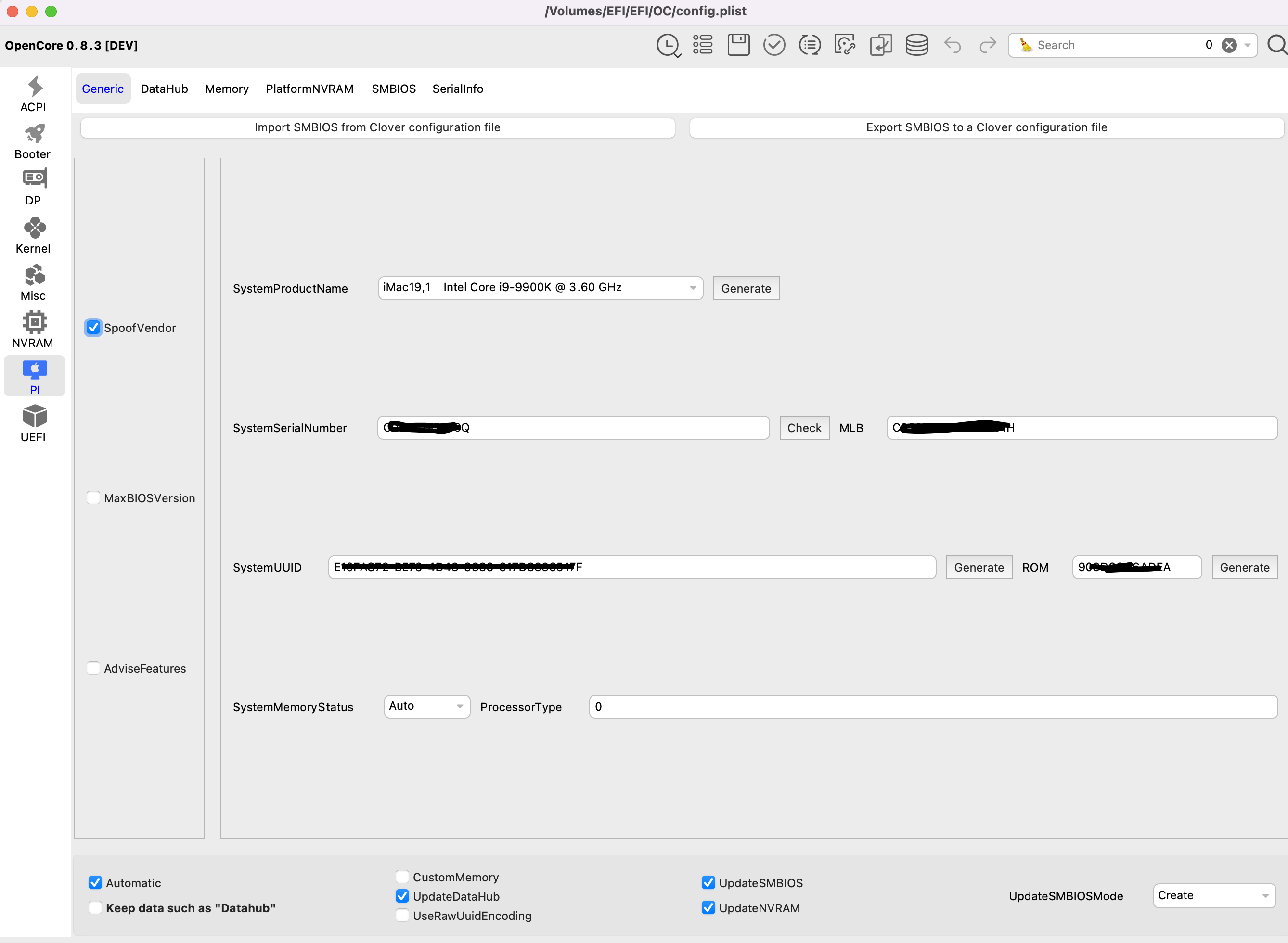

Ziadantosh Posted August 9, 2022 Share Posted August 9, 2022 (edited) On 8/5/2022 at 3:50 PM, eSaF said: @Ziadantosh - An unknown error occurred' - I haven't seen that since back in the day when iMessage was first introduced. All I can say is make sure your data i.e S/N, ROM SmUUID etc entries are correct and in the right format, you can also run iMessageDebug (attached) and look at the output, it should not say Null or Void on any of the lines and should look like my example (I've blocked out my info). Reveal hidden contents iMessageDebug 19.78 kB · 4 downloads The output is lines and lines and loads of wtf :S but I copied a line here: Quote -xDo you want to save to iMessageDebug.txt? (y/n) %s/iMessageDebug.txtwSmUUID: failedBoard-id: failedbyteslengthstringWithFormat:stringByAppendingString:datasetLength:UTF8StringallocinitWithData:encoding:mainBundlebundlePathÏ44¡(4 Doesn't seem to have a good info like it should, I am certain the SN and other info are fine, as I open config file with OCAT and clicked on check which went to the 🍏 website and said valid Anything else I can do? Edited August 9, 2022 by Ziadantosh Link to comment https://www.insanelymac.com/forum/topic/339980-audiogods-aorus-z390-pro-patched-dsdt-mini-guide-and-discussion/page/198/#findComment-2791110 Share on other sites More sharing options...

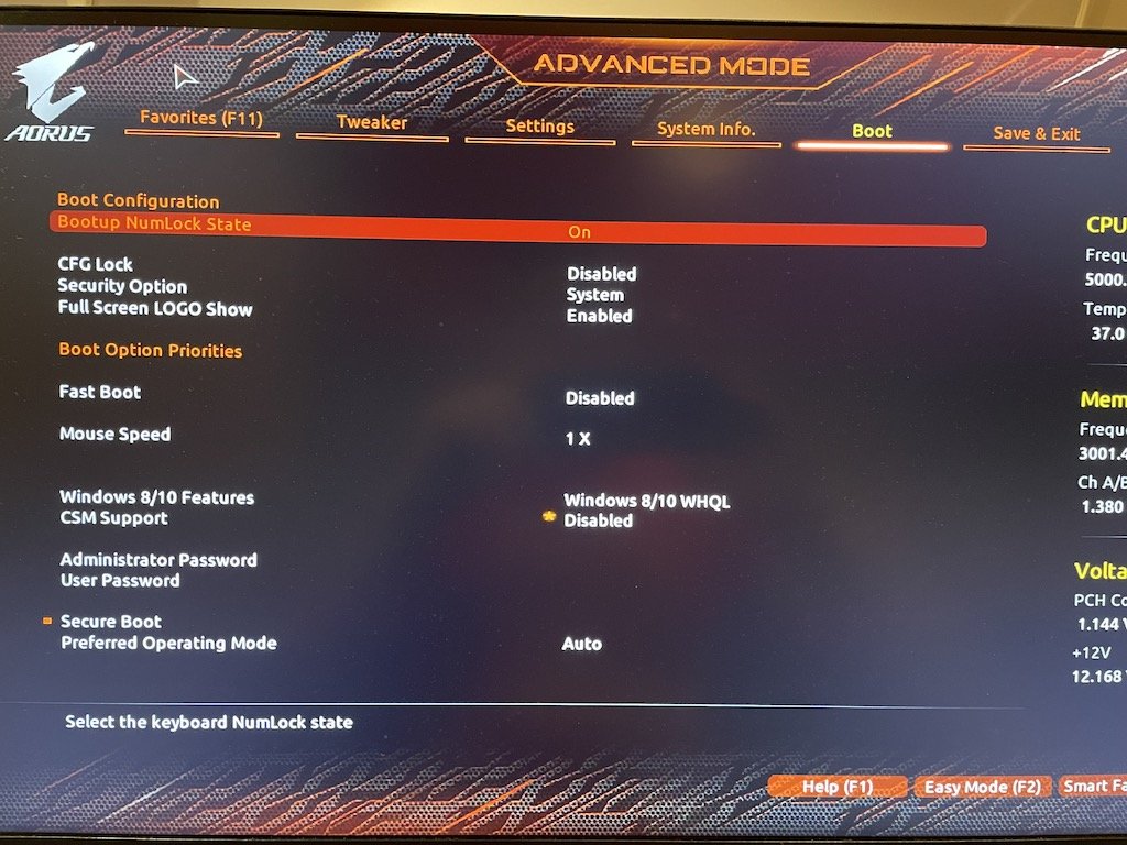

Cipha Posted August 11, 2022 Share Posted August 11, 2022 guys, I'm running Dual Boot and updated to win 11. now I have to activate Secure Boot to be able to run some customer software needed. Is there anything I need to change in the EFI to keep OC alive? Link to comment https://www.insanelymac.com/forum/topic/339980-audiogods-aorus-z390-pro-patched-dsdt-mini-guide-and-discussion/page/198/#findComment-2791202 Share on other sites More sharing options...
Slice Posted August 11, 2022 Share Posted August 11, 2022 No, UEFI Secure Boot for Windows is not the same as Apple Secure Boot in OpenCore. Link to comment https://www.insanelymac.com/forum/topic/339980-audiogods-aorus-z390-pro-patched-dsdt-mini-guide-and-discussion/page/198/#findComment-2791211 Share on other sites More sharing options...
Slice Posted August 11, 2022 Share Posted August 11, 2022 1 hour ago, eSaF said: Ok - So in the BIOS the setting should be 'Other OS' or am I on the wrong track? Not concerning the current thread i prefer to set in BIOS "Windows 10 WHQL" and then disable CSM. Secure Mode set as enabled but without certificates it does nothing. As well if you enable Apple Secure Boot in opencore then are you going to provide your own keys? Else what is the secure? Link to comment https://www.insanelymac.com/forum/topic/339980-audiogods-aorus-z390-pro-patched-dsdt-mini-guide-and-discussion/page/198/#findComment-2791220 Share on other sites More sharing options...
pkdesign Posted August 11, 2022 Share Posted August 11, 2022 I have my SecureBootModel set to Disabled. Otherwise I can not boot. But that may be for some other reason. I also dual boot Win 11 and had to make a change on order for Win 11 to install and run. Link to comment https://www.insanelymac.com/forum/topic/339980-audiogods-aorus-z390-pro-patched-dsdt-mini-guide-and-discussion/page/198/#findComment-2791233 Share on other sites More sharing options...

Ziadantosh Posted August 18, 2022 Share Posted August 18, 2022 On 8/9/2022 at 8:59 PM, eSaF said: @Ziadantosh - Ok let me explain, despite what you've read or was told about a S/N should be valid but not registered, please ignore and do not use your current S/N unless it is from a genuine Mac that belongs to you and registered in your name. Your current S/N tells me it is already registered by Apple in their data base as one of theirs possibly out in the wild. Your machine sporting the same S/N is like you having the same license plate as your neighbour's car. The problem with you using that S/N is throwing up a security flag on the Apple Servers, hence the reason you cannot log into some services for security reasons. You need to log out of all Apple Services i.e iCloud, App Store etc etc, delete that S/N, MLB and generate another that throws up the not valid message when checked which will mean it is unique to your machine and not already registered by Apple as one of theirs. While you're at it, also generate a new SmUUID number as well, enter the new data. Reboot the machine with the new info, clean the NvRAM, on reaching the Desktop log into your Apple Account and try all the Services, you may have to wait a few moments for the Servers to accept this new machine also before I forget, you need to remove the previous machine from your account containing the previous (genuine) S/N. Good luck. PS - See attached, this is the message you should get when checking. Reveal hidden contents This MUST be pinned for people like me! Absolutely works like a charm now! Thank you so much @eSaF you are a legend! Link to comment https://www.insanelymac.com/forum/topic/339980-audiogods-aorus-z390-pro-patched-dsdt-mini-guide-and-discussion/page/198/#findComment-2791633 Share on other sites More sharing options...

Cipha Posted August 22, 2022 Share Posted August 22, 2022 On 8/11/2022 at 2:19 PM, eSaF said: Ok - So in the BIOS the setting should be 'Other OS' or am I on the wrong track? Ater some research I finally got it running. To be able to fully use UEFI Secure Boot we need to sign all Open Core EFIs in BIOS. This is super easy since gigabyte has implemented a tool in BIOS. The functionis called "Enroll EFI image"- I enrolled these efis BOOT/Bootx64.efi OC/OpenCore.efi OC/Drivers/OpenRuntime.efi No files were changed during signing (hashcode remains the same). After this OC boots as usual. Important: This has to be done after every OC update. 1 Link to comment https://www.insanelymac.com/forum/topic/339980-audiogods-aorus-z390-pro-patched-dsdt-mini-guide-and-discussion/page/198/#findComment-2791857 Share on other sites More sharing options...
