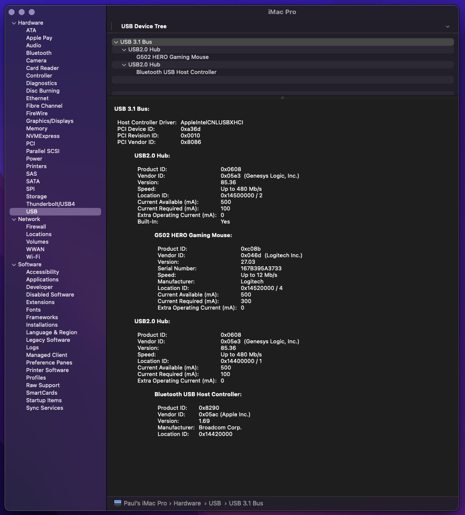

mariodj Posted September 28, 2021 Share Posted September 28, 2021 (edited) On 9/27/2021 at 8:16 AM, mariodj said: Anyone try to back from Monterey to Big Sur ?? i download latest version of Big Sur and now i got a problem to install. Help me please. I try different OC and OSX and every time i got this screen. on Verbose it stuck on this Edited September 28, 2021 by mariodj Link to comment Share on other sites More sharing options...

AudioGod Posted October 3, 2021 Author Share Posted October 3, 2021 (edited) On 10/1/2021 at 2:44 PM, texem said: Hi, still suffering from Bluetooth issues with latest Monterey b8 ( Wake from sleep - no function at all until reset BT daemon) i'm wondering someone here w/o any problems operates the same BCM adapter : ABWB 802,11 AC WI-FI + Bluetooth 4.0 PCI-Express (PCI-E) BCM94360CS2 ? Appreciate any hint or feedback Cheers If you are still using SMBIOS iMacPro1,1 then XHC1 is actually in need of a name change as it’s conflicting with Apple's own USB map. It’s something I missed when I was using this setup but quickly learned about when I moved over to AMD. This is a general thing not a AMD thing so it totally applies to you but only if you are still using 1,1. (19,1 and 7,1 need no USB Name changes) Try adding this patch to your ACPI Patches and edit the USBMap.kext to match the name change and see if that helps. XHC1 to SHCI: Key Type Value Comment String XHC1 to SHCI Count Number <0> Enabled Boolean YES Find Data <58484331> Limit Number <0> Replace Data <53484349> Skip Number <0> TableLength Number <0> TableSignature Data <> Edited October 3, 2021 by AudioGod 1 Link to comment Share on other sites More sharing options...
eSaF Posted October 3, 2021 Share Posted October 3, 2021 3 minutes ago, AudioGod said: If you are still using SMBIOS iMacPro1,1 then XHC1 is actually in need of a name change as it’s conflicting with Apple's own USB map. It’s something I missed when I was using this setup but quickly learned about when I moved over to AMD. This is a general thing not a AMD thing so it totally applies to you but only if you are still using 1,1. (19,1 and 7,1 need no USB Name changes) Try adding this patch to your ACPI Patches and edit the USBMap.kext to match the name change and see if that helps. XHC1 to SHCI: Key Type Value Comment String XHC1 to SHCI Count Number <0> Enabled Boolean YES Find Data <58484331> Limit Number <0> Replace Data <53484349> Skip Number <0> TableLength Number <0> TableSignature Data <> Nice one AG - Although I am now using 19.1, I will make a note of this in my 'UseFull Notes' for future reference. Cheers Maestro. 1 Link to comment Share on other sites More sharing options...
AudioGod Posted October 3, 2021 Author Share Posted October 3, 2021 (edited) 7 minutes ago, eSaF said: Nice one AG - Although I am now using 19.1, I will make a note of this in my 'UseFull Notes' for future reference. Cheers Maestro. You can actually check to see if a setup needs a rename simply by running the following Command in terminal. ioreg -l -p IOService -w0 | grep -i XHC1 If it chucks out a load of info like below then a name change is needed. Spoiler Edited October 3, 2021 by AudioGod 1 Link to comment Share on other sites More sharing options...
eSaF Posted October 3, 2021 Share Posted October 3, 2021 @AudioGod - Yea I ran that sometime back according to a Guide when I did USB Mapping for 19.1 and all was well like so Spoiler 2 Link to comment Share on other sites More sharing options...
AudioGod Posted October 3, 2021 Author Share Posted October 3, 2021 9 minutes ago, eSaF said: @AudioGod - Yea I ran that sometime back according to a Guide when I did USB Mapping for 19.1 and all was well like so Hide contents Nice and clean so No changes needed. 1 Link to comment Share on other sites More sharing options...
texem Posted October 3, 2021 Share Posted October 3, 2021 Hi buddy, thanks for the hint. Still on 1,1 but unfortunately there is nothing wrong with USB mapping . The ioreg cmd returns no output. In between re-installed b8 completely but nothing better. In another thread i found that Hackintool doesn't show the BT adapter not only here . it's working until sleep. The ID of my adapter 0x0a5c (Broadcom) and 0x828f (Product-ID) Possibly there is something in the upgraded Monterey kext's missing now ? Let's wait for the release of 12.0 . Link to comment Share on other sites More sharing options...
AudioGod Posted October 3, 2021 Author Share Posted October 3, 2021 (edited) 12 minutes ago, texem said: Hi buddy, thanks for the hint. Still on 1,1 but unfortunately there is nothing wrong with USB mapping . The ioreg cmd returns no output. In between re-installed b8 completely but nothing better. The CMD command must be broken under Monterey then I guess but you need to do some research and learn about USB bud as your missing my point about it and again I stress if you are using 1,1 without a name change then it’s wrong but don’t take my word for it as it’s very clearly stated in the OC guide too. Read! https://dortania.github.io/OpenCore-Post-Install/usb/system-preparation.html#checking-what-renames-you-need Edited October 3, 2021 by AudioGod Link to comment Share on other sites More sharing options...
texem Posted October 3, 2021 Share Posted October 3, 2021 tnx buddy, nothing to rename , there is no XHC1 on z390pro . Neither in DSDT nor SSDT. it's just XHC Link to comment Share on other sites More sharing options...
