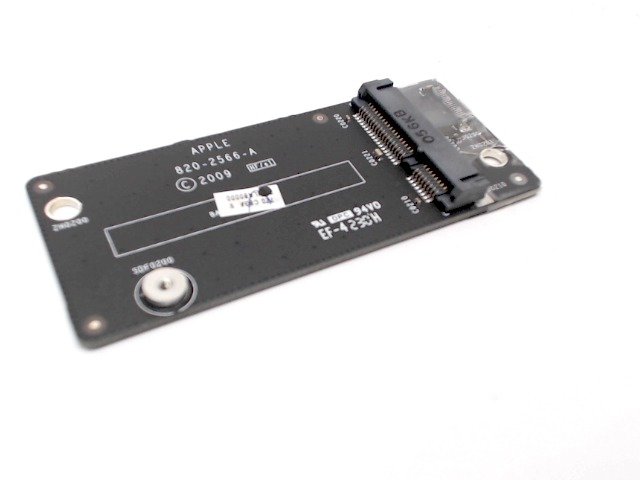

Tiem Posted August 1, 2020 Share Posted August 1, 2020 2 hours ago, AudioGod said: The second you slap the card on a pcie adaptor it’s stop being native. Hardly. It’s an additional layer but it still doesn’t change the actual component. Older BCMs had their own carriers too: The quality of the carrier card and the fact it’s attached to a non Apple logic board make things tricky, but the card itself is a true Broadcom and it will function like one. If I take an engine out of a Porsche, it’s still a true Porsche engine. It’s just going to be a matter of making sure it’s mounted how it should be in your Toyota. The issues with sleep could be bugs in the USB stack/ACPI layer as both are integrated tightly in recent version of macOS. Such avenues to explore would be a much more fruitful discussion. You built the SSDT so you’re in the drivers seat to help find the potential bug and better yet, the fix. It could be unsolvable (as many things with Hacks) often are, but just throwing up your hands surely won’t fix this Link to comment https://www.insanelymac.com/forum/topic/339980-audiogods-aorus-z390-pro-patched-dsdt-mini-guide-and-discussion/page/143/#findComment-2732755 Share on other sites More sharing options...
