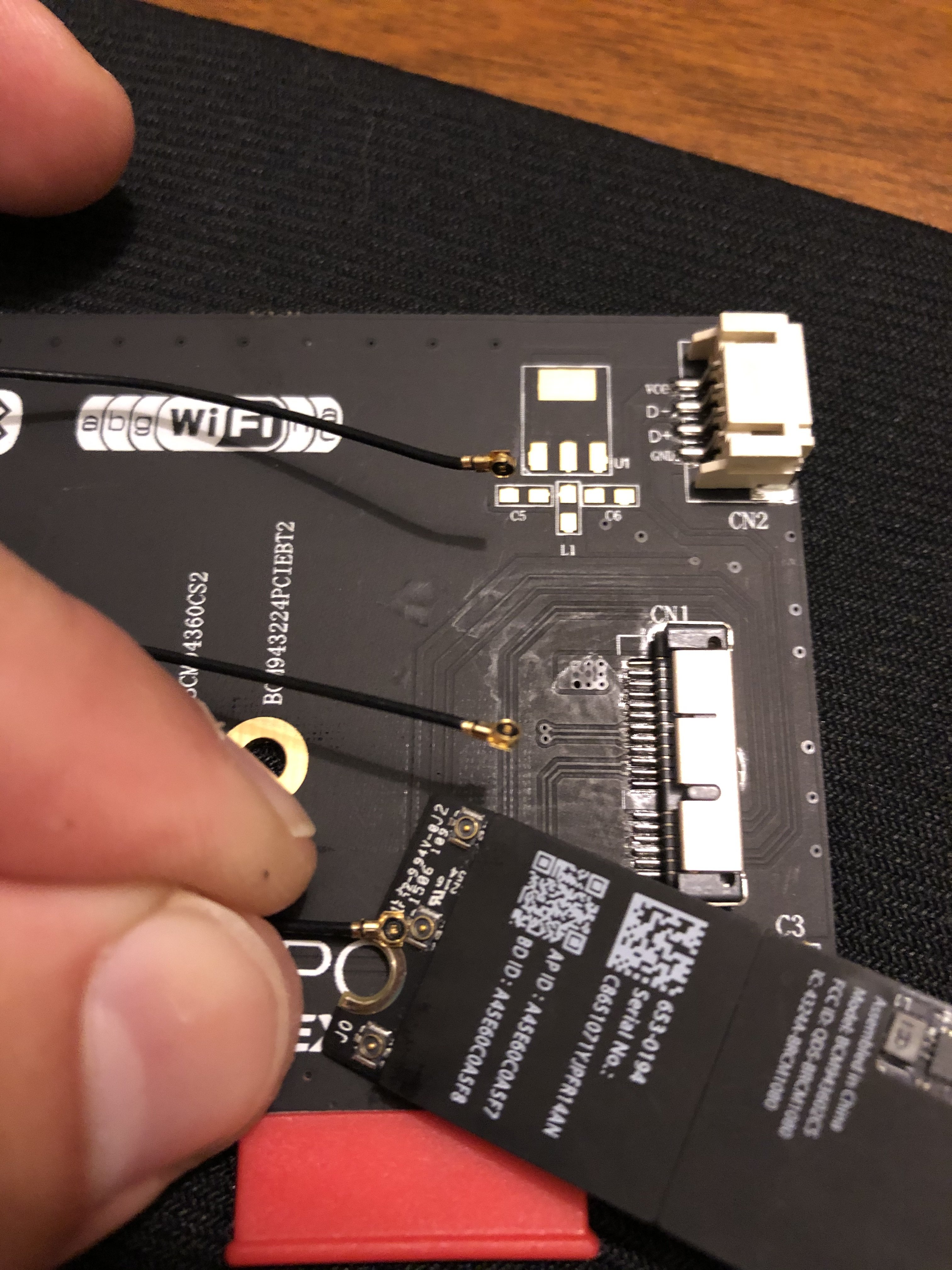

Tiem Posted July 30, 2020 Share Posted July 30, 2020 (edited) @rob1980 I finally managed to install the card. It took me about 4h total to mount the pigtails. I had success by taking a very point tip of a pair of tweezers to the centre and making sure there was enough space to for the male pin to slide into the female pigtail. The quality leaves something to be desired. I couldn't source a pair of aftermarket tails (the ones from Amazon I linked were too big for the card), but it's ok, the ones that come with the card seem fine. Live and learn. Now for the tech dump. The follow is the standard output from macOS and Hackintool. The bluetooth module: The wifi module: Hackintosh detecting PCI info: So green across the board. I'm running AirportBrcmFixup.kext but not sure if I need it. If everything works I have no incentive to take it out, so if you want to test with or without, please let us know. Before settling down, I strongly suggest doing the following when you install the card: Before you shutdown, delete the contents of /Library/Preferences/SystemConfiguration (it will be repopulated). Reset NVRAM twice. Yes twice. This will clear out any cruft that may conflict. Preliminary tests. I have attached and activated my Apple Wireless Keyboard, my Studio 3s and my Xbox One controller. With the Fenvi, the controller had upwards of up to 1-3s of lag steady, with spikes of missing inputs entirely or dropping the connect briefly. With the BCRM, there is 0 lag. The controller feels extremely responsive. I have not yet tested range but I suspect it won't be an issue. Regardless even if it's on par with the Fenvi, I'll make due. Edited July 31, 2020 by Tiem 1 Link to comment https://www.insanelymac.com/forum/topic/339980-audiogods-aorus-z390-pro-patched-dsdt-mini-guide-and-discussion/page/142/#findComment-2732607 Share on other sites More sharing options...

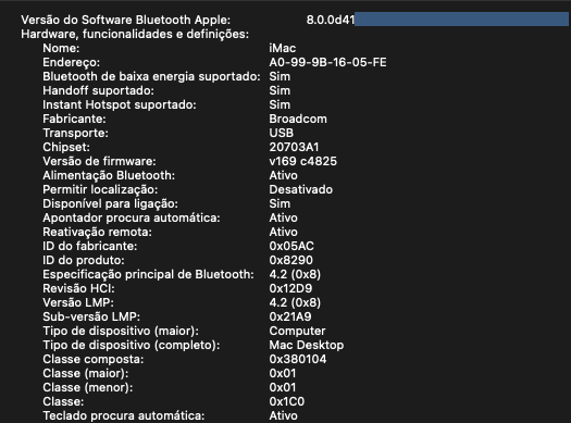

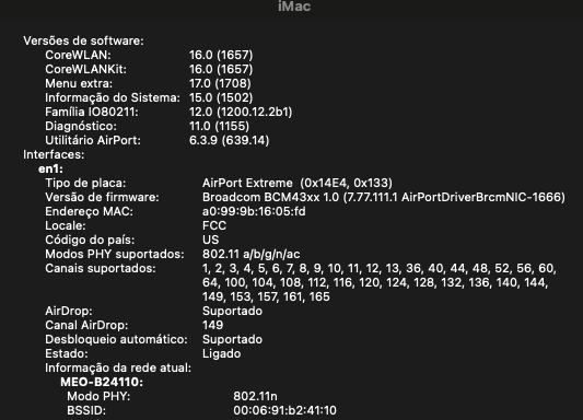

MorenoAv Posted July 31, 2020 Share Posted July 31, 2020 Today I too exchanged my Fenvi T - 919 for my older BCM943602CS following the example of @Tiem, let's see if this time the experience is better that of the Fenvi ... 2 Link to comment https://www.insanelymac.com/forum/topic/339980-audiogods-aorus-z390-pro-patched-dsdt-mini-guide-and-discussion/page/142/#findComment-2732651 Share on other sites More sharing options...

MorenoAv Posted July 31, 2020 Share Posted July 31, 2020 @Tiem, I deleted that content, and reset nvram, but my system thinks that I have yet the fenvi, although although all is working... Link to comment https://www.insanelymac.com/forum/topic/339980-audiogods-aorus-z390-pro-patched-dsdt-mini-guide-and-discussion/page/142/#findComment-2732688 Share on other sites More sharing options...

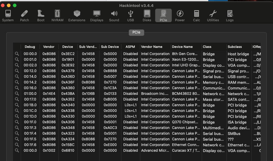

Tiem Posted August 1, 2020 Share Posted August 1, 2020 11 hours ago, MorenoAv said: @Tiem, I deleted that content, and reset nvram, but my system thinks that I have yet the fenvi, although although all is working... Can you pull up the pci tab on Hackintool and post what it reads on the network card. I feel you’re actually good. You’re a full firmware revision ahead of me (I’m on 7.0 so you may have a newer card. But the Fenvi only has 4.0 BT I believe with the 2CS and CS2 are 4.2. I’m sorry I don’t recall the details on the Fenvi. Are you on Mojave? Link to comment https://www.insanelymac.com/forum/topic/339980-audiogods-aorus-z390-pro-patched-dsdt-mini-guide-and-discussion/page/142/#findComment-2732717 Share on other sites More sharing options...
MorenoAv Posted August 1, 2020 Share Posted August 1, 2020 @Tiem, I'm in BG ... and below is the PCIe Tab of Hackintool ... 2CS is bluetooth 4.0, or at least is what is written in the adapter ... Thanks Link to comment https://www.insanelymac.com/forum/topic/339980-audiogods-aorus-z390-pro-patched-dsdt-mini-guide-and-discussion/page/142/#findComment-2732733 Share on other sites More sharing options...
