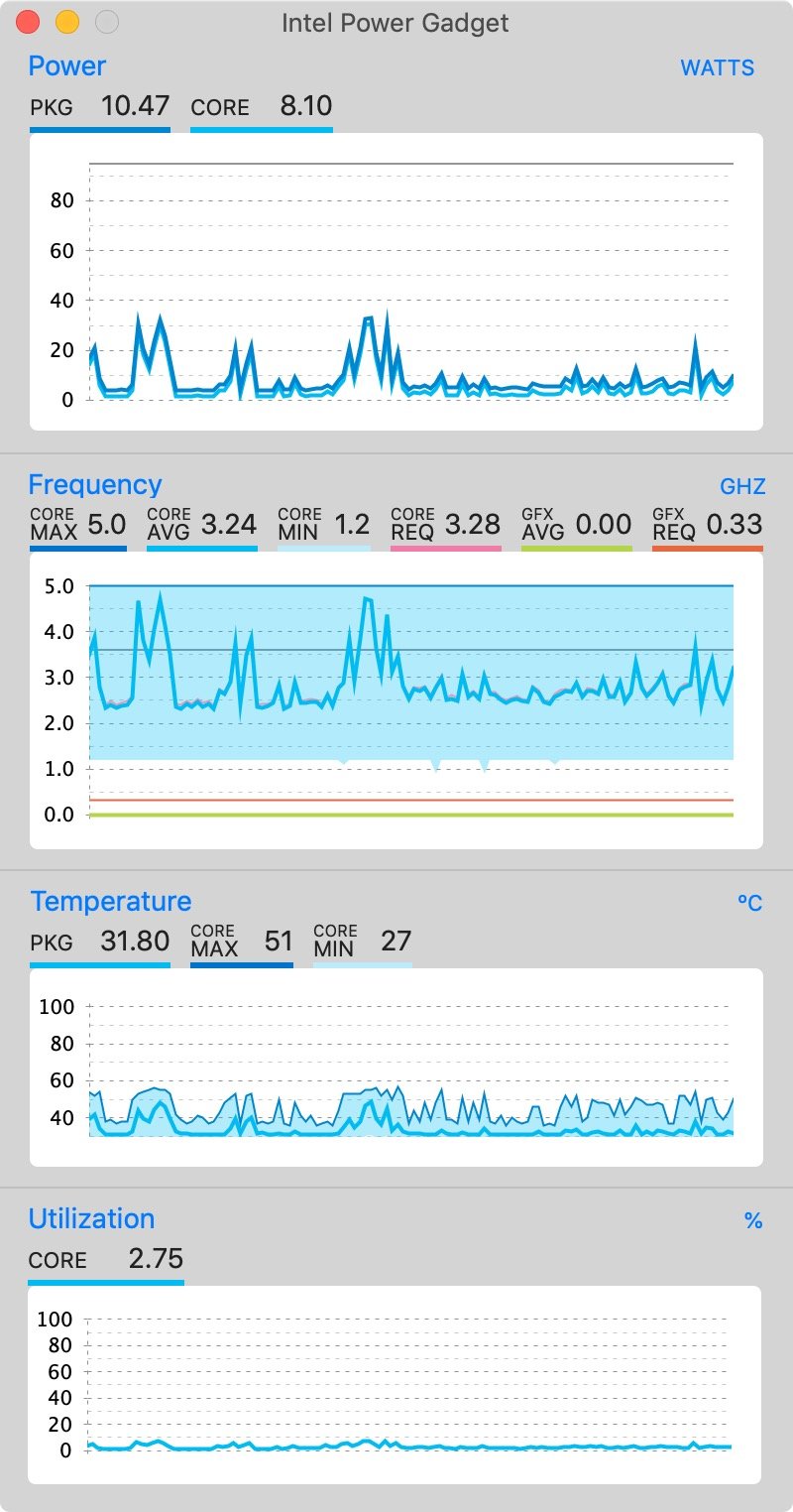

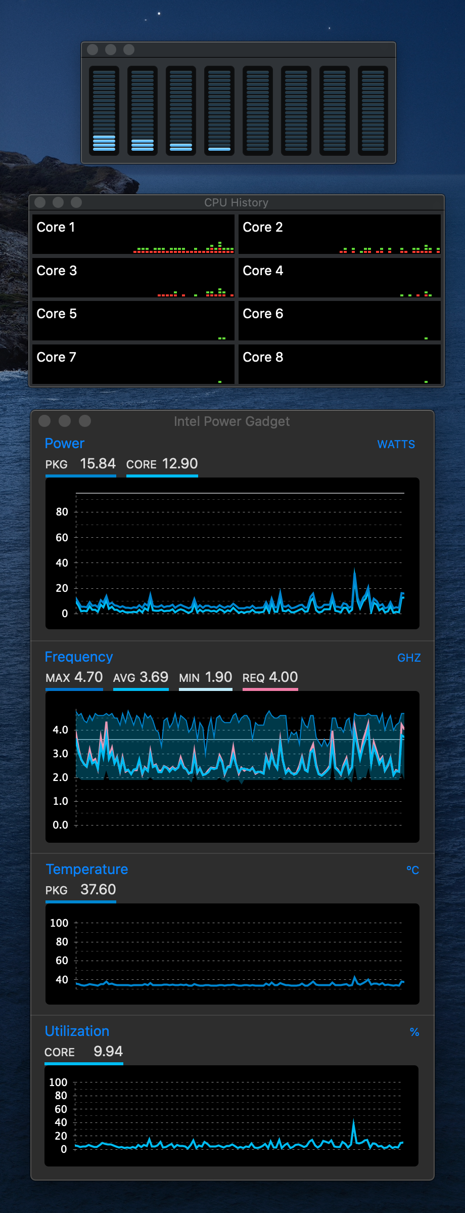

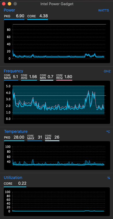

Tiem Posted July 25, 2020 Share Posted July 25, 2020 (edited) 1 hour ago, AudioGod said: All true but 7,1 like 19,1 doesn’t scale the cpu properly where as 1,1 does. Interesting. What can I use to test this? Edit: Oop nm, Intel Power Gadget. Edit 2: Preliminary, but nothing jumps out as abnormal. Edited July 25, 2020 by Tiem Link to comment https://www.insanelymac.com/forum/topic/339980-audiogods-aorus-z390-pro-patched-dsdt-mini-guide-and-discussion/page/141/#findComment-2731820 Share on other sites More sharing options...
AudioGod Posted July 25, 2020 Author Share Posted July 25, 2020 (edited) 8 hours ago, Tiem said: Interesting. What can I use to test this? Edit: Oop nm, Intel Power Gadget. Edit 2: Preliminary, but nothing jumps out as abnormal. You can see it on your min frequency. It should be going down to 800mhz not 1.9ghz. Il update this post in abit with my cpu frequency from 1,1. I’m surprised your not seeing that when it’s jumping out on that graph (Missing states) Dam your cpu is toasty with 37c ave on idol Ignore my Max Freq as I'm overclocked. Compare your states using Hackintool and your see how many are missing compared to what your meant to have. You can fix it for yourself by using CPU Friend my Friend (I'm not using anything like that though, that's just straight up from using 1,1) It's not the biggest of deals tbh but correct is correct no? Edited July 25, 2020 by AudioGod Link to comment https://www.insanelymac.com/forum/topic/339980-audiogods-aorus-z390-pro-patched-dsdt-mini-guide-and-discussion/page/141/#findComment-2731861 Share on other sites More sharing options...

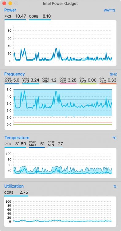

AudioGod Posted July 25, 2020 Author Share Posted July 25, 2020 16 minutes ago, eSaF said: @AudioGod and @Tiem - Here is the examples from my cheapo i5 CPU. I thought I'd come to the party uninvited Hide contents What smbios is that brother? 1,1? Link to comment https://www.insanelymac.com/forum/topic/339980-audiogods-aorus-z390-pro-patched-dsdt-mini-guide-and-discussion/page/141/#findComment-2731881 Share on other sites More sharing options...
AudioGod Posted July 25, 2020 Author Share Posted July 25, 2020 1 hour ago, eSaF said: This is it B - I changed it cause I couldn't get ATV+ and my movies to play only on iMac 1.1 pro Hide contents I was asking cos your cpu is fully scaling with all the p states showing correctly. thats the whole point of what we are debating. I’m on 1,1 aswell now as I’m sick of 19,1.... Link to comment https://www.insanelymac.com/forum/topic/339980-audiogods-aorus-z390-pro-patched-dsdt-mini-guide-and-discussion/page/141/#findComment-2731895 Share on other sites More sharing options...
AudioGod Posted July 25, 2020 Author Share Posted July 25, 2020 (edited) 5 minutes ago, eSaF said: Actually I totally agree with you especially in my case, to my limited knowledge the speed stepping is spot on, when I had it as 19.1 it was all over the place and hardly idling so for me it was definitely a good change, but I am sure initially you advised me to change it but I stuck with it because I carried on using details from when I had the GA-Z87X-OC FORCE with an i7 CPU so the moral of the story is - I should listen to you more in future. CPU Friend can fix it for 19,1 and 7,1 but tbh it’s not the biggest of deals. No more energy is used and not dropping right down or missing some of the states is not really a problem. Edited July 25, 2020 by AudioGod Link to comment https://www.insanelymac.com/forum/topic/339980-audiogods-aorus-z390-pro-patched-dsdt-mini-guide-and-discussion/page/141/#findComment-2731899 Share on other sites More sharing options...
AudioGod Posted July 25, 2020 Author Share Posted July 25, 2020 (edited) 2 minutes ago, eSaF said: Yea I hear you B but I tend to think right or wrong if the numbers are all over the place in Stepping, it aint working as should. a lot of people when overclocking disable most the p and c states anyway that’s why I don’t consider it a biggie at all. OCD is OCD I guess lol Seeing that you have a 9400F 19,1 was never the correct smbios for you to be using anyway. No igpu no 19,1 Edited July 25, 2020 by AudioGod Link to comment https://www.insanelymac.com/forum/topic/339980-audiogods-aorus-z390-pro-patched-dsdt-mini-guide-and-discussion/page/141/#findComment-2731902 Share on other sites More sharing options...
Tiem Posted July 25, 2020 Share Posted July 25, 2020 5 hours ago, AudioGod said: You can see it on your min frequency. It should be going down to 800mhz not 1.9ghz. Il update this post in abit with my cpu frequency from 1,1. I’m surprised your not seeing that when it’s jumping out on that graph (Missing states) Dam your cpu is toasty with 37c ave on idol Ignore my Max Freq as I'm overclocked. Compare your states using Hackintool and your see how many are missing compared to what your meant to have. You can fix it for yourself by using CPU Friend my Friend (I'm not using anything like that though, that's just straight up from using 1,1) It's not the biggest of deals tbh but correct is correct no? No I’m missing a lot. I’d prefer not to use CPUfriend. Even the guide says SMBIOS is the optimal way to fix it and I want to stay on 7,1. I do want a perfect system, but tbh, for a desktop I don’t care that much. It would be nice to find out why 7,1 can’t assign the right states. Same goes for 19,1 given that the iMac actually has an i9 in it (the rest are all Xeons). Link to comment https://www.insanelymac.com/forum/topic/339980-audiogods-aorus-z390-pro-patched-dsdt-mini-guide-and-discussion/page/141/#findComment-2731906 Share on other sites More sharing options...
AudioGod Posted July 25, 2020 Author Share Posted July 25, 2020 (edited) 6 minutes ago, Tiem said: No I’m missing a lot. I’d prefer not to use CPUfriend. Even the guide says SMBIOS is the optimal way to fix it and I want to stay on 7,1. I do want a perfect system, but tbh, for a desktop I don’t care that much. It would be nice to find out why 7,1 can’t assign the right states. Same goes for 19,1 given that the iMac actually has an i9 in it (the rest are all Xeons). It’s CPU Friend or live with it buddy, that’s it if you want to stick on 7,1 I’m afraid. as for why, MaLD0n says it’s a bug in the programming with a 8th and 9th gen CPU. Edited July 25, 2020 by AudioGod Link to comment https://www.insanelymac.com/forum/topic/339980-audiogods-aorus-z390-pro-patched-dsdt-mini-guide-and-discussion/page/141/#findComment-2731907 Share on other sites More sharing options...

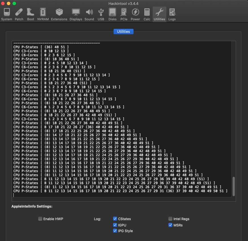

pkdesign Posted July 26, 2020 Share Posted July 26, 2020 Well, I don't know what I'm looking at now! I don’t have nearly the same number of P States: Spoiler CPU Ratio Info: ------------------------------------------ Base Clock Frequency (BLCK)............. : 100 MHz Maximum Efficiency Ratio/Frequency...... : 8 ( 800 MHz) Maximum non-Turbo Ratio/Frequency....... : 36 (3600 MHz) Maximum Turbo Ratio/Frequency........... : 50 (5000 MHz) IGPU Info: ------------------------------------------ IGPU Current Frequency.................. : 0 MHz IGPU Minimum Frequency.................. : 350 MHz IGPU Maximum Non-Turbo Frequency........ : 350 MHz IGPU Maximum Turbo Frequency............ : 1200 MHz IGPU Maximum limit...................... : No Limit P-State ratio * 100 = Frequency in MHz ------------------------------------------ CPU P-States [ (24) 35 50 ] iGPU P-States [ ] CPU C3-Cores [ 4 5 6 7 13 ] CPU C6-Cores [ 1 2 5 8 11 12 ] CPU P-States [ (24) 34 35 50 ] iGPU P-States [ ] CPU C3-Cores [ 2 4 5 6 7 13 14 ] CPU C6-Cores [ 1 2 5 8 11 12 15 ] CPU P-States [ (24) 33 34 35 50 ] iGPU P-States [ ] CPU C3-Cores [ 2 4 5 6 7 10 11 13 14 ] CPU C6-Cores [ 1 2 5 8 11 12 13 14 15 ] CPU P-States [ (24) 33 34 35 50 ] iGPU P-States [ ] CPU C3-Cores [ 2 3 4 5 6 7 8 9 10 11 13 14 ] CPU C6-Cores [ 0 1 2 5 8 11 12 13 14 15 ] CPU P-States [ 24 33 34 35 38 (50) ] iGPU P-States [ ] CPU C6-Cores [ 0 1 2 5 8 9 10 11 12 13 14 15 ] CPU C3-Cores [ 0 2 3 4 5 6 7 8 9 10 11 13 14 ] CPU C6-Cores [ 0 1 2 3 5 8 9 10 11 12 13 14 15 ] CPU C3-Cores [ 0 2 3 4 5 6 7 8 9 10 11 13 14 15 ] CPU C6-Cores [ 0 1 2 3 5 6 8 9 10 11 12 13 14 15 ] CPU C6-Cores [ 0 1 2 3 5 6 7 8 9 10 11 12 13 14 15 ] CPU C3-Cores [ 0 2 3 4 5 6 7 8 9 10 11 12 13 14 15 ] CPU C3-Cores [ 0 1 2 3 4 5 6 7 8 9 10 11 12 13 14 15 ] CPU P-States [ (13) 24 33 34 35 38 50 ] iGPU P-States [ ] CPU C6-Cores [ 0 1 2 3 4 5 6 7 8 9 10 11 12 13 14 15 ] Link to comment https://www.insanelymac.com/forum/topic/339980-audiogods-aorus-z390-pro-patched-dsdt-mini-guide-and-discussion/page/141/#findComment-2732082 Share on other sites More sharing options...
AudioGod Posted July 26, 2020 Author Share Posted July 26, 2020 (edited) 28 minutes ago, pkdesign said: Well, I don't know what I'm looking at now! I don’t have nearly the same number of P States: Hide contents CPU Ratio Info: ------------------------------------------ Base Clock Frequency (BLCK)............. : 100 MHz Maximum Efficiency Ratio/Frequency...... : 8 ( 800 MHz) Maximum non-Turbo Ratio/Frequency....... : 36 (3600 MHz) Maximum Turbo Ratio/Frequency........... : 50 (5000 MHz) IGPU Info: ------------------------------------------ IGPU Current Frequency.................. : 0 MHz IGPU Minimum Frequency.................. : 350 MHz IGPU Maximum Non-Turbo Frequency........ : 350 MHz IGPU Maximum Turbo Frequency............ : 1200 MHz IGPU Maximum limit...................... : No Limit P-State ratio * 100 = Frequency in MHz ------------------------------------------ CPU P-States [ (24) 35 50 ] iGPU P-States [ ] CPU C3-Cores [ 4 5 6 7 13 ] CPU C6-Cores [ 1 2 5 8 11 12 ] CPU P-States [ (24) 34 35 50 ] iGPU P-States [ ] CPU C3-Cores [ 2 4 5 6 7 13 14 ] CPU C6-Cores [ 1 2 5 8 11 12 15 ] CPU P-States [ (24) 33 34 35 50 ] iGPU P-States [ ] CPU C3-Cores [ 2 4 5 6 7 10 11 13 14 ] CPU C6-Cores [ 1 2 5 8 11 12 13 14 15 ] CPU P-States [ (24) 33 34 35 50 ] iGPU P-States [ ] CPU C3-Cores [ 2 3 4 5 6 7 8 9 10 11 13 14 ] CPU C6-Cores [ 0 1 2 5 8 11 12 13 14 15 ] CPU P-States [ 24 33 34 35 38 (50) ] iGPU P-States [ ] CPU C6-Cores [ 0 1 2 5 8 9 10 11 12 13 14 15 ] CPU C3-Cores [ 0 2 3 4 5 6 7 8 9 10 11 13 14 ] CPU C6-Cores [ 0 1 2 3 5 8 9 10 11 12 13 14 15 ] CPU C3-Cores [ 0 2 3 4 5 6 7 8 9 10 11 13 14 15 ] CPU C6-Cores [ 0 1 2 3 5 6 8 9 10 11 12 13 14 15 ] CPU C6-Cores [ 0 1 2 3 5 6 7 8 9 10 11 12 13 14 15 ] CPU C3-Cores [ 0 2 3 4 5 6 7 8 9 10 11 12 13 14 15 ] CPU C3-Cores [ 0 1 2 3 4 5 6 7 8 9 10 11 12 13 14 15 ] CPU P-States [ (13) 24 33 34 35 38 50 ] iGPU P-States [ ] CPU C6-Cores [ 0 1 2 3 4 5 6 7 8 9 10 11 12 13 14 15 ] Read though my comments on the last page as I fully explained it already pal. Edited July 26, 2020 by AudioGod Link to comment https://www.insanelymac.com/forum/topic/339980-audiogods-aorus-z390-pro-patched-dsdt-mini-guide-and-discussion/page/141/#findComment-2732084 Share on other sites More sharing options...
pkdesign Posted July 27, 2020 Share Posted July 27, 2020 Okay got it. Tried CPU Friend but it didn’t seem to do much. Oh well. CPU Ratio Info: ------------------------------------------ Base Clock Frequency (BLCK)............. : 100 MHz Maximum Efficiency Ratio/Frequency...... : 8 ( 800 MHz) Maximum non-Turbo Ratio/Frequency....... : 36 (3600 MHz) Maximum Turbo Ratio/Frequency........... : 50 (5000 MHz) IGPU Info: ------------------------------------------ IGPU Current Frequency.................. : 0 MHz IGPU Minimum Frequency.................. : 350 MHz IGPU Maximum Non-Turbo Frequency........ : 350 MHz IGPU Maximum Turbo Frequency............ : 1200 MHz IGPU Maximum limit...................... : No Limit P-State ratio * 100 = Frequency in MHz ------------------------------------------ CPU P-States [ (34) 46 50 ] iGPU P-States [ ] CPU C3-Cores [ 2 3 5 ] CPU C6-Cores [ 0 1 3 5 8 9 ] CPU P-States [ (8) 34 46 50 ] iGPU P-States [ ] CPU C3-Cores [ 0 1 2 3 5 11 14 ] CPU C6-Cores [ 0 1 2 3 5 8 9 10 15 ] CPU P-States [ 8 (24) 34 46 50 ] iGPU P-States [ ] CPU C3-Cores [ 0 1 2 3 5 9 10 11 14 ] CPU C6-Cores [ 0 1 2 3 5 8 9 10 14 15 ] CPU P-States [ 8 (13) 24 34 46 50 ] iGPU P-States [ ] CPU C3-Cores [ 0 1 2 3 4 5 9 10 11 14 ] CPU C6-Cores [ 0 1 2 3 5 6 7 8 9 10 12 14 15 ] CPU C3-Cores [ 0 1 2 3 4 5 8 9 10 11 14 ] CPU C6-Cores [ 0 1 2 3 5 6 7 8 9 10 12 13 14 15 ] CPU C3-Cores [ 0 1 2 3 4 5 8 9 10 11 13 14 ] CPU P-States [ 8 (13) 24 34 45 46 50 ] iGPU P-States [ ] CPU C6-Cores [ 0 1 2 3 5 6 7 8 9 10 11 12 13 14 15 ] CPU C3-Cores [ 0 1 2 3 4 5 6 7 8 9 10 11 13 14 15 ] CPU C6-Cores [ 0 1 2 3 4 5 6 7 8 9 10 11 12 13 14 15 ] CPU C3-Cores [ 0 1 2 3 4 5 6 7 8 9 10 11 12 13 14 15 ] CPU P-States [ 8 13 24 (34) 45 46 50 ] iGPU P-States [ ] Link to comment https://www.insanelymac.com/forum/topic/339980-audiogods-aorus-z390-pro-patched-dsdt-mini-guide-and-discussion/page/141/#findComment-2732100 Share on other sites More sharing options...

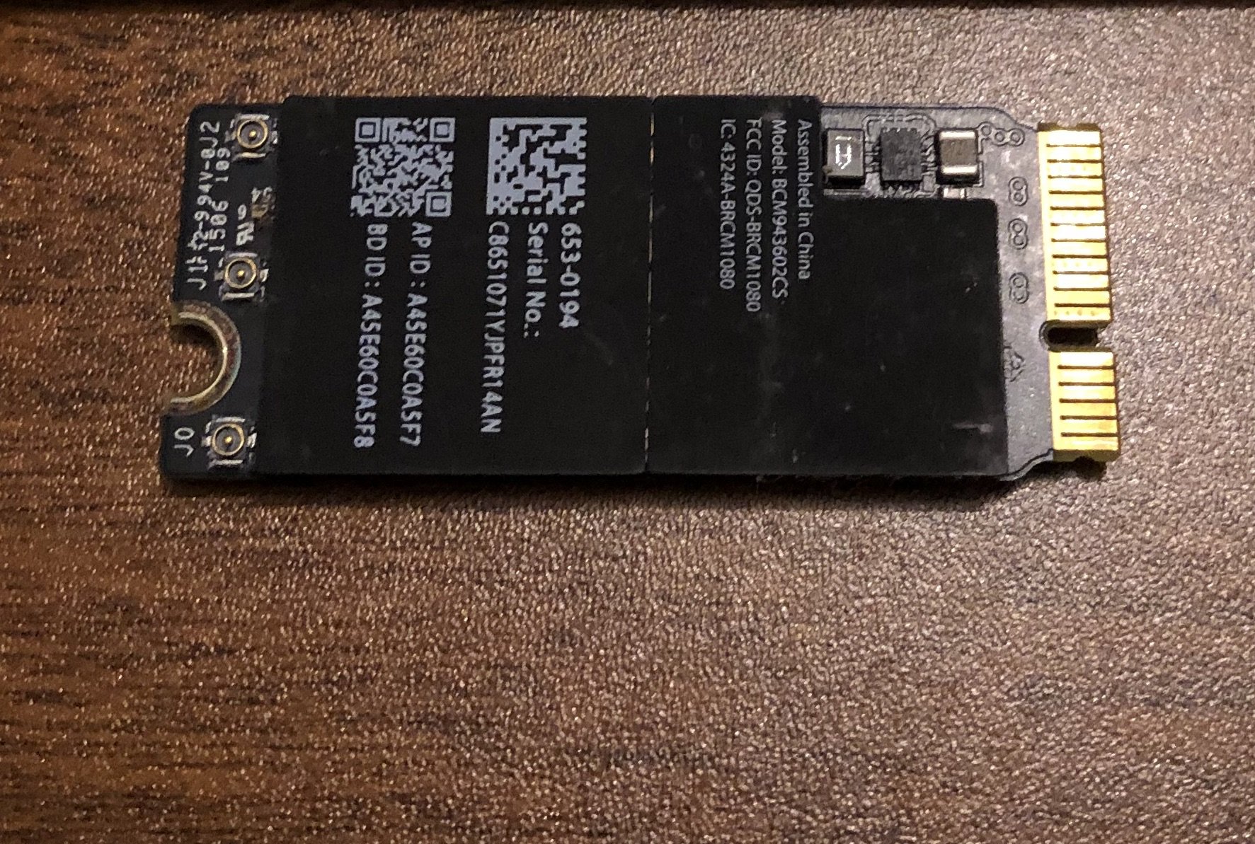

rob1980 Posted July 27, 2020 Share Posted July 27, 2020 On 7/26/2020 at 9:37 AM, AudioGod said: @Tiem @eSaF I don’t think I need to tell either of you how I feel about the Fenvi cards. I think most people on here know how much I can not stand that card Be warned The 2CS can be a little troublesome with Catalina and sleep and you might have to use BrcmPatchRAM to resolve it. The CS2 with the dual antenna is the most trouble free one of the bunch. I've noticed that my Fenvi T919 is not as reliable as I'd hoped (bluetooth is ok...) I get a better/ more constant signal from my old iPhone 7. Would the following be a better replacement? https://www.ebay.co.uk/itm/Dual-Band-BCM94360CS2-PCI-E-867Mbps-802-11AC-BT4-0-Wifi-PCI-Express-Adapter-Card/282961128646?_trkparms=ispr%3D1&hash=item41e1cc2cc6:g:1S8AAOSwvwRcOcFe&amdata=enc%3AAQAFAAACYBaobrjLl8XobRIiIML1V4Imu%2Fn%2BzU5L90Z278x5ickk7PdDazAlGltMLJlUhrWsDwD5WGBlzxviqJ7kMy57rx%2FIMlI%2BfuD5H1x9in%2FF8HMkfSfUCSyyn3ketH9kemopqcpM%2BA27PiHlma8w7VYNN45R3OJ4IjEA%2Brl1LB4s5Ks9p9EzmiXwIN9gxg9f3aRcwKJPmdjvLnbfE8aLuqImIVCdqcqbWEh6HHaQYEVfjSglV2mhrCp%2BdaDieM9p6Gcp3Xzq%2Bdq7AmTt%2FxS5GgAIREC83Wk0oeg2dyrgWjz0wabRnwwzlGkrctHaNpf2%2FW9S8hV7%2FPYU7XkeYV6e7JzzaP%2FPihLtWFIT4MkZgvp0GJ%2BY0KPzjCIqibZHv5K91uVJvaHqCpGDYcMopxhUgmtRJygvUIW%2FAvaZUW9g%2FFRlYGDBlG%2BszyOHnAcOvN%2FjX5U%2FzMdWHUbpetLz9Rk56EytafJ%2BgGjS2xJYP0Hku1%2FtD9ks4a8byeW4YZHRqYf6ySKx8m2%2FZw4Amm9oFmvDU8j4F4KIfX4fiCVwM2PphJKc26nS2Je0E0LJlRKelGzNvQUro3JtZV6BTlwtywnolHsuR%2FZPrLeLCcb6xKmAYXHg8IWsljunQ9UyVajFmGpI1%2Fumn7X4lXwgo02cQgy0AqYWTdw1bl2Hn%2FzVKtWUa3pqDJTsrJxxva2g8UJqFGvfndrq7USuO8DD0Gs5EYTuB0vSEALBJEm4852lAv9jchcfz9HHV%2FhoOU2HU2TdAef04Z3WeygcLG0fxDj3liY%2BA9DeD1GPd6M8hAZ2wX8%2BA72IumHj|cksum%3A28296112864668a09d34207e42af8a307ecae40f204f|ampid%3APL_CLK|clp%3A2334524 Link to comment https://www.insanelymac.com/forum/topic/339980-audiogods-aorus-z390-pro-patched-dsdt-mini-guide-and-discussion/page/141/#findComment-2732108 Share on other sites More sharing options...
Tiem Posted July 27, 2020 Share Posted July 27, 2020 2 hours ago, rob1980 said: I've noticed that my Fenvi T919 is not as reliable as I'd hoped (bluetooth is ok...) I get a better/ more constant signal from my old iPhone 7. Would the following be a better replacement? {snip} That's some URI. No. Worse. I don't believe it's got a 100% genuine BCRM anymore than anyone selling 100% genuine PS2 memory cards. Grab the card and pull off the plate. I'd be shocked if it was legit. Moreover, that card is slow as molasses, nearly 10 years old now (from 2012 Macs). Get yourself a real Broadcom from a real Mac. Then source a decent PCIe adapter. Stay away from already built units. Link to comment https://www.insanelymac.com/forum/topic/339980-audiogods-aorus-z390-pro-patched-dsdt-mini-guide-and-discussion/page/141/#findComment-2732115 Share on other sites More sharing options...
rob1980 Posted July 27, 2020 Share Posted July 27, 2020 26 minutes ago, Tiem said: That's some URI. No. Worse. I don't believe it's got a 100% genuine BCRM anymore than anyone selling 100% genuine PS2 memory cards. Grab the card and pull off the plate. I'd be shocked if it was legit. Moreover, that card is slow as molasses, nearly 10 years old now (from 2012 Macs). Get yourself a real Broadcom from a real Mac. Then source a decent PCIe adapter. Stay away from already built units. OH my, sorry about the link, I hadn't noticed how ridiculous it was lol Ok, So I'm looking for the latest version I can get from a mac then a PCIe adapter.. do I need an adapter with USB for the Bluetooth like the Fenvi? Thanks for the help, its much appreciated. Link to comment https://www.insanelymac.com/forum/topic/339980-audiogods-aorus-z390-pro-patched-dsdt-mini-guide-and-discussion/page/141/#findComment-2732117 Share on other sites More sharing options...
