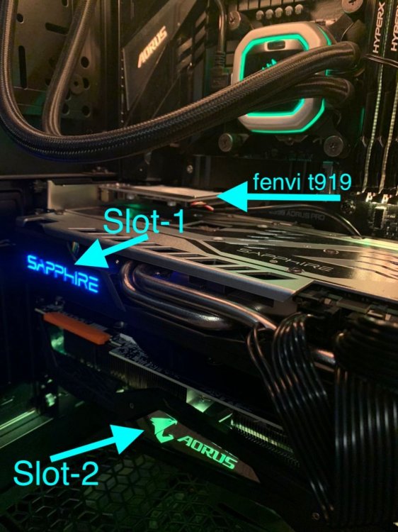

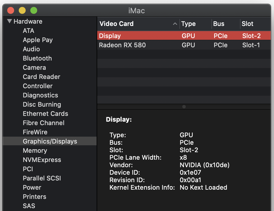

Help please :(
1. I checked my Nvidia for details in Windows and get this info:
\_SB.PCI0.PEG1.PEGP
PCIROOT(0)#PCI(0101)#PCI(0000)
ACPI(_SB_)#ACPI(PCI0)#ACPI(PEG1)#ACPI(PEGP)
2. Then I using this github and make this file 'SSDT-NVIDIA.aml' using my details from Windows above (file is attached)
3. At this point I need to add something into the OpenCore 0.6.0 (Root->ACPI->Add..) but I don't do this before and do not know what exactly I need to add.
Can anybody help me to disable Nvidia slot properly, please?

4 hours ago, velopitex said:
Help please :(
\_SB.PCI0.PEG1.PEGP
SSDT-NVIDIA.aml.zip
In your Opencore config.plist (OC/config.plist), you need to add new entry in the ACPI section for the new file. Originally, your ACPI add section probably looks like this:

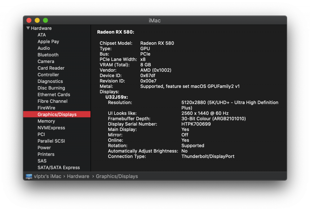

Just make sure that new file is unzipped (should have .aml extension) and put it in your OC/ACPI folder with the other .aml files.
Thank you!!!!
I’ll try it tomorrow.
UPD: Looks like Nvidia is gone now! Unfortunately sleep works strange, it's wake up immediately after put to sleep machine.
