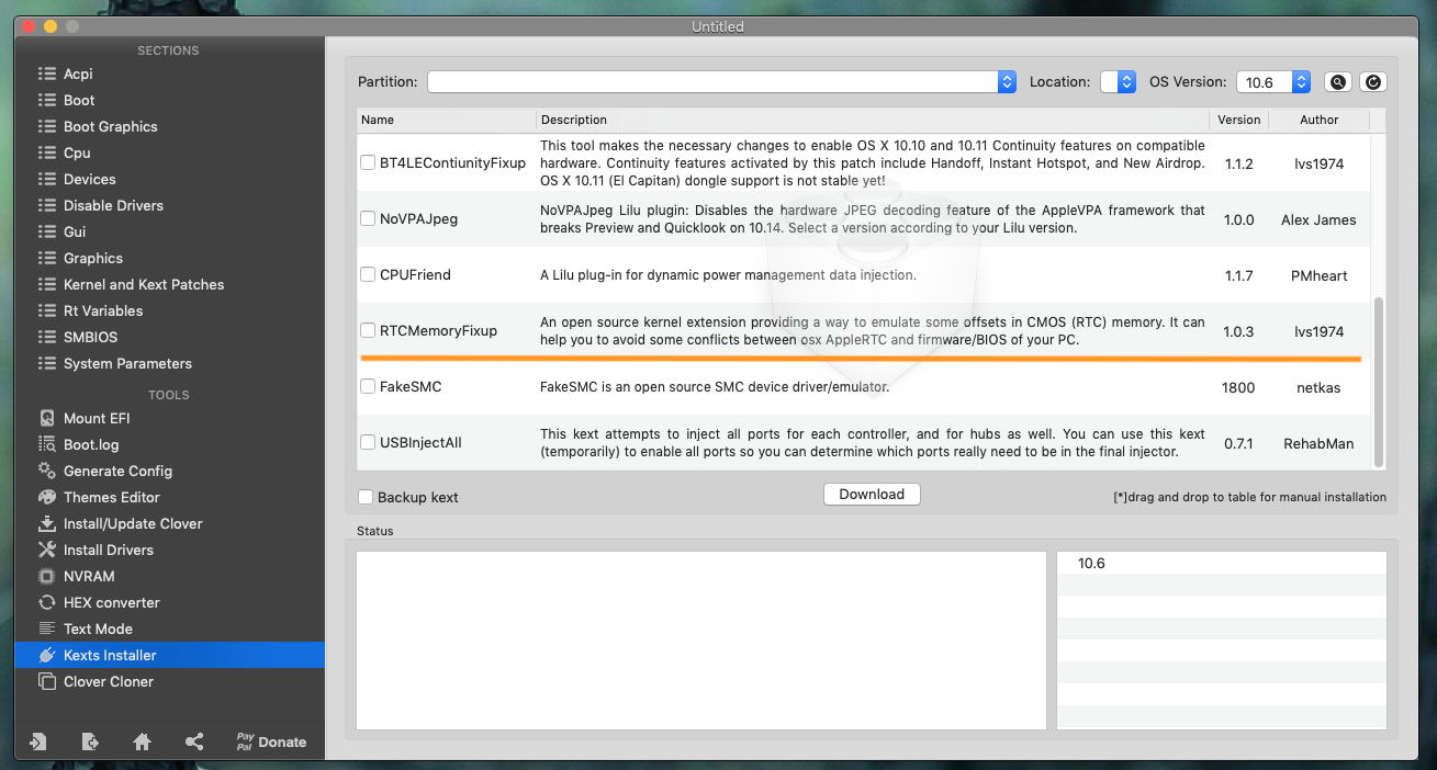

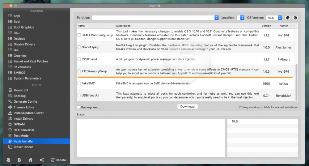

Delecta Posted May 21, 2019 Share Posted May 21, 2019 Hey @glasgood ! I am thinking to change my mobo for this one with a i9-9900K. Just had few questions, what's the purpose of RTCMemoryFixup ? Seems be developped by lvs1974 but I can't find anything on his Github ? Thank you Link to comment https://www.insanelymac.com/forum/topic/337837-glasgoods-macos-mojave-successguide-for-aorus-z390-pro/page/15/#findComment-2674566 Share on other sites More sharing options...
glasgood Posted May 21, 2019 Author Share Posted May 21, 2019 1 hour ago, Delecta said: Hey @glasgood ! I am thinking to change my mobo for this one with a i9-9900K. Just had few questions, what's the purpose of RTCMemoryFixup ? Seems be developped by lvs1974 but I can't find anything on his Github ? Thank you An excellent motherboard go for it !!! , best Hackintosh board I have owned. You can Clover Configurator to see what each kext is used for: Link to comment https://www.insanelymac.com/forum/topic/337837-glasgoods-macos-mojave-successguide-for-aorus-z390-pro/page/15/#findComment-2674579 Share on other sites More sharing options...

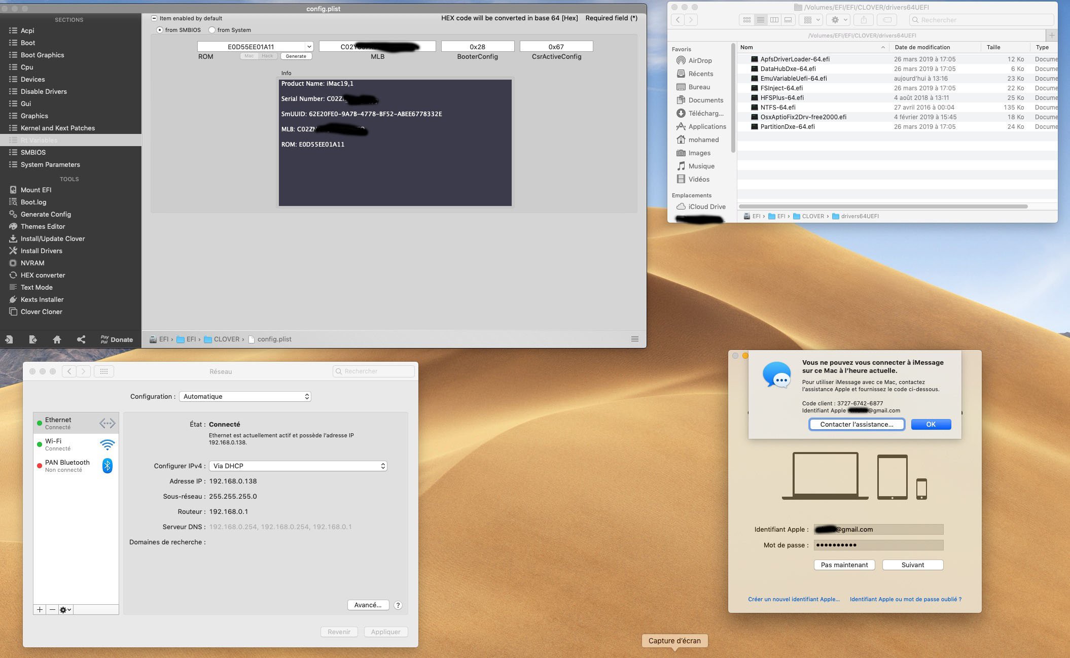

nelio33 Posted May 23, 2019 Share Posted May 23, 2019 Hello, i receive today my combo wifi/bluetooth recommended on first post, all work fine. but little problem with imessage not work and facetime like with no card, i make all configuration, check sn is invalid, EmuVariableUefi-64.efi is inside driver folder, longin on icloud is ok and on itune ok but facetime and imessage not work. how to check airdrop without iphone ? Link to comment https://www.insanelymac.com/forum/topic/337837-glasgoods-macos-mojave-successguide-for-aorus-z390-pro/page/15/#findComment-2674882 Share on other sites More sharing options...
glasgood Posted May 23, 2019 Author Share Posted May 23, 2019 (edited) 5 hours ago, eSaF said: Just noticed on my board (Gigabyte Aorus z390 Pro wifi) Bluetooth is permanently on, I cannot toggle it on/off in System Preferences. On the Windows side there is no problem but in Mojave 'Turn Bluetooth Off' is greyed out, I tried two different cards and the results are the same - surely this can't be normal, please share any ideas you might have - Thanks. Double check your SSDT, try removing SSDT and see if problem persists without SSDT. 54 minutes ago, nelio33 said: Hello, i receive today my combo wifi/bluetooth recommended on first post, all work fine. but little problem with imessage not work and facetime like with no card, i make all configuration, check sn is invalid, EmuVariableUefi-64.efi is inside driver folder, longin on icloud is ok and on itune ok but facetime and imessage not work. how to check airdrop without iphone ? What wifi-card are you using? One of the recommended cards requires AirportBrcmFixup.kext. Are you using the SSDT for usb ports fix from EFI provided by the guide? Is cable firmly attached from wifi-bluetooth combo card to motherboard usb header. Edited May 23, 2019 by glasgood Link to comment https://www.insanelymac.com/forum/topic/337837-glasgoods-macos-mojave-successguide-for-aorus-z390-pro/page/15/#findComment-2674884 Share on other sites More sharing options...
nelio33 Posted May 23, 2019 Share Posted May 23, 2019 2 hours ago, glasgood said: What wifi-card are you using? One of the recommended cards requires AirportBrcmFixup.kext. Are you using the SSDT for usb ports fix from EFI provided by the guide? Is cable firmly attached from wifi-bluetooth combo card to motherboard usb header. Hi Glasgood, he use this : https://fr.aliexpress.com/item/BCM943602CS-1300-Mbps-double-bande-802-11AC-bureau-PCI-E-carte-sans-fil-PC-wifi-adaptateur/32879992316.html just plug it, and all work wifi and bluetooth. i use DEFAULT SSDT and usb is plugged on F_USB1 HS11 Link to comment https://www.insanelymac.com/forum/topic/337837-glasgoods-macos-mojave-successguide-for-aorus-z390-pro/page/15/#findComment-2674890 Share on other sites More sharing options...
glasgood Posted May 23, 2019 Author Share Posted May 23, 2019 7 minutes ago, nelio33 said: Hi Glasgood, he use this : https://fr.aliexpress.com/item/BCM943602CS-1300-Mbps-double-bande-802-11AC-bureau-PCI-E-carte-sans-fil-PC-wifi-adaptateur/32879992316.html just plug it, and all work wifi and bluetooth. i use DEFAULT SSDT and usb is plugged on F_USB1 HS11 Try placing the 9 Pin cable into F_USB2, Temporary remove WiFi (Broadcom Card) entry from config.plist Devices / Properties. Refresh SMBIOS and follow video guide for iMessages. 1 Link to comment https://www.insanelymac.com/forum/topic/337837-glasgoods-macos-mojave-successguide-for-aorus-z390-pro/page/15/#findComment-2674891 Share on other sites More sharing options...
nelio33 Posted May 23, 2019 Share Posted May 23, 2019 1 hour ago, glasgood said: Try placing the 9 Pin cable into F_USB2, Temporary remove WiFi (Broadcom Card) entry from config.plist Devices / Properties. Refresh SMBIOS and follow video guide for iMessages. i need to go back to the mac mini configuration for imessage? on smbios on devices/properties i dont have entry broadcom i try and populate the pci with the hackintool method the pc does not start anymore ?I started on the key and I delivered the config.list saved earlier. Link to comment https://www.insanelymac.com/forum/topic/337837-glasgoods-macos-mojave-successguide-for-aorus-z390-pro/page/15/#findComment-2674901 Share on other sites More sharing options...
