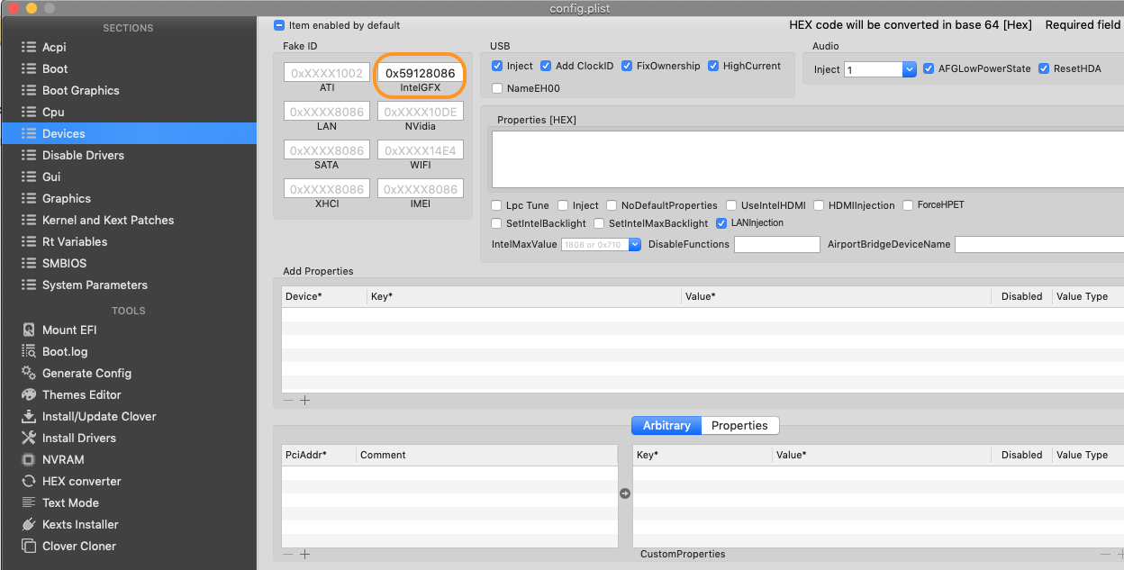

mfortuna Posted May 29, 2019 Share Posted May 29, 2019 21 minutes ago, glasgood said: Try ==> EFI mfortuna.zip What changes did you make? The EFI I uploaded was the one that was working before I've updated to your newer EFI Link to comment https://www.insanelymac.com/forum/topic/337837-glasgoods-macos-mojave-successguide-for-aorus-z390-pro/page/18/#findComment-2675517 Share on other sites More sharing options...
glasgood Posted May 29, 2019 Author Share Posted May 29, 2019 3 minutes ago, mfortuna said: What changes did you make? The EFI I uploaded was the one that was working before I've updated to your newer EFI Removed: 0x59128086 Kaby Lake spoof not needed. Link to comment https://www.insanelymac.com/forum/topic/337837-glasgoods-macos-mojave-successguide-for-aorus-z390-pro/page/18/#findComment-2675519 Share on other sites More sharing options...

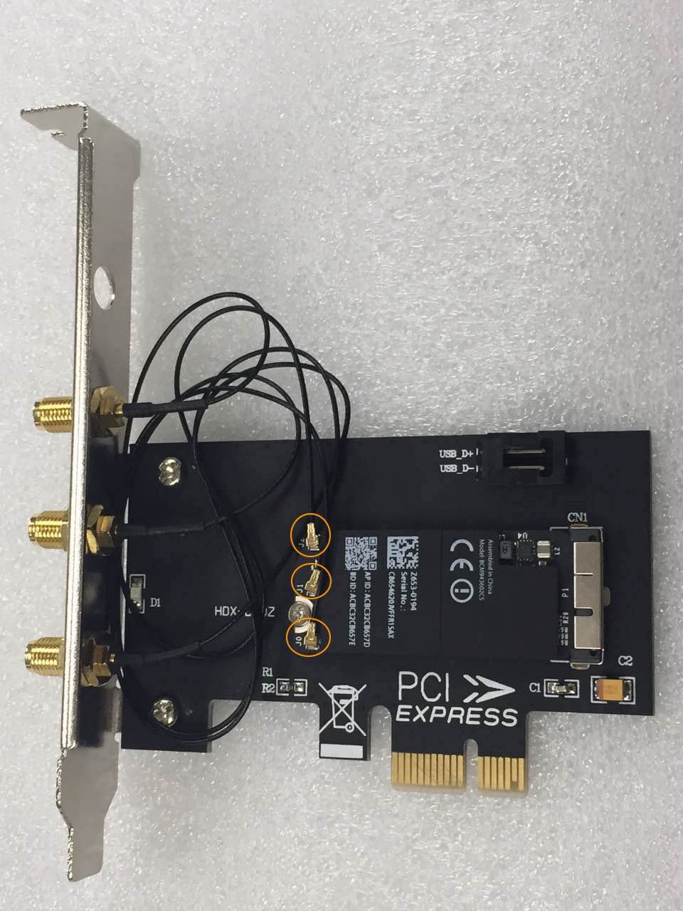

glasgood Posted May 31, 2019 Author Share Posted May 31, 2019 (edited) @panosru Also worth disconnecting and reattaching antenna cables. You could also try switching position of antennae cables on the card, to rule out any faulty wire that is connected to card. Looking at the photo of your desktop setup your desktop hackintosh is a small distance away from your keyboard, did you try testing keyboard directly next to your hackintosh desktop computer? ( what happens if Hackintosh is placed on floor, under desk, directly below keyboard ) Possibly RF signal could be degraded on USB3.0 bus, hence the lag, if you have external USB storage remove it and test. Did you try testing USB keyboard dongle( if applicable ) on a USB 2.0 port ? Do you have handoff enabled, if so try turning it off and see if problem persists. Also noticed you are using a multi-monitor setup, I assume refresh rate has nothing to do with this, but can you test keyboard with hackintosh and one monitor and have all other devices turned off. Edited May 31, 2019 by glasgood Link to comment https://www.insanelymac.com/forum/topic/337837-glasgoods-macos-mojave-successguide-for-aorus-z390-pro/page/18/#findComment-2675683 Share on other sites More sharing options...
