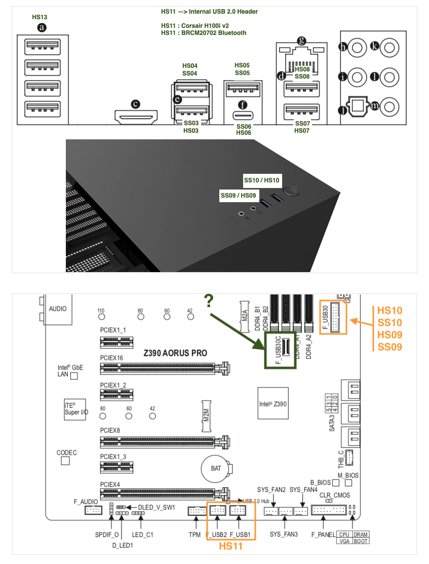

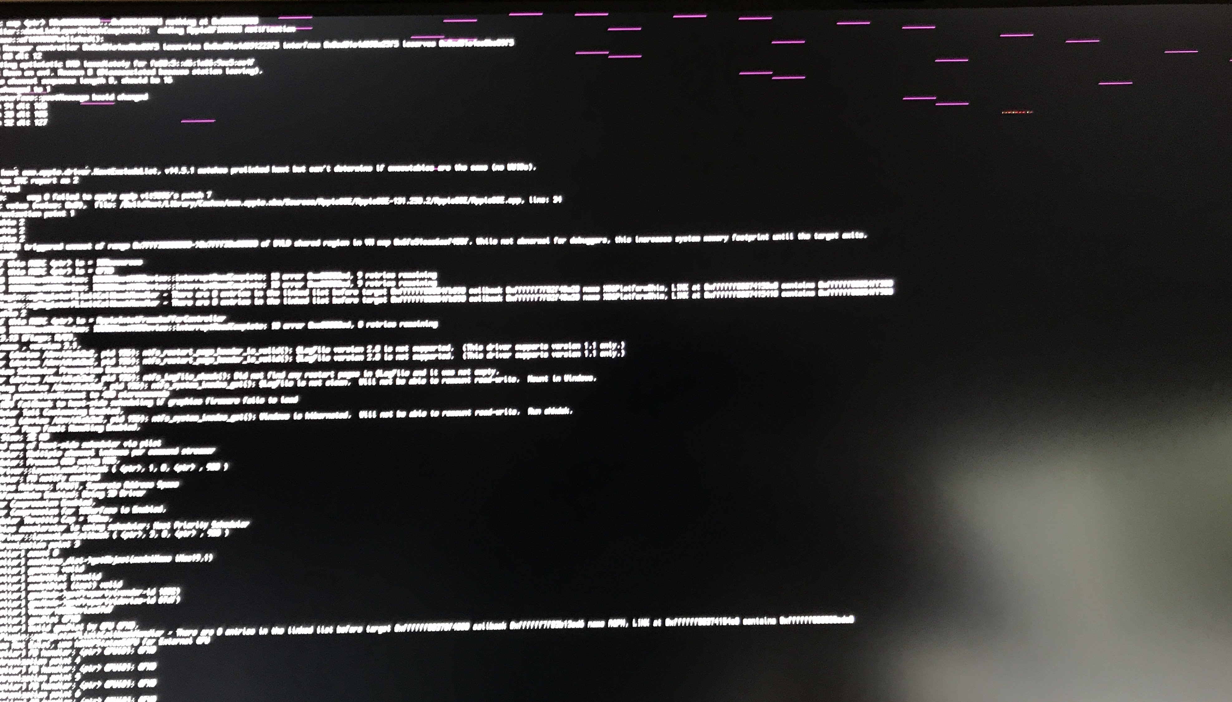

Hi,
Since the latest update of Mojave I'm getting little purple strips appear for  a second just before it boots up, never happened until the latest update. Has this happened to you and do you know how to fix it by any chance?
Its ugly and annoying but not a problem really.
Is it a kext thing maybe?
Also I'm going to redo my USB ports later and wake up my front USB c port, will I have to shut a different port down to compensate?
Also while I'm talking USB, why are you bothering to enable the h100i USB internal headers and why don't you just run the h100i without it?
I ask only because the h100i USB header is only used for corsair link and since you can't use link in mac os it's doing absolutely nothing and power to the h100i is coming directly from the psu and any settings done via windows are saved in the h100i and sticks so I'm thinking to turn them off totally and use the frees up ports for other ports. What do you think?
Do you see my logic here or am I missing something?

@AudioGod
I got the same purple strips just before getting to Mojave login screen, agree it's ugly and annoying. Only happened when I updated to latest Clover, so possibly Clover related and not kext.
The post graphics glitch, only happens during that post startup stage. Hopefully next Clover update will sort this, or you could go back to using pervious Clover.
When I first built my PC, I was initially just running Windows and cable remains since back then. I can see your logic,  if the Corsair link saves profile to H100i then you don't need cable.
You could free up an extra port.  See guide DEFAULT SSDT used in guide EFI folder has 12 ports enabled, leaves three extra ports to play with.  :)
Thanks buddy, I will give it a go later and report back and tell you my results and pass the ssdt over to you for your very wise eyes.
I've built many a build where I have not used the USB cable on the h100i and rooted the fans directly though the motherboard for control and it's always worked fine but this was back in the old days when we didn't have so many ports to choose from on the Mb. I have just tested my theory and disconnected the USB from my h100i platinum and then booted into macos and strained the cpu for 10 mins and the h100i reacted exactly the same as when its connected to the USB header so perfect it really is not needed in that case. If you want too change anything in the h100i then you have to boot into windows anyway no?
Awesome that's the port for my front USB c header sorted anyway.
It's a shame you can't turn off one of the USB ports on the USB 2 hub as I don't no if you have noticed but if you connect all 4 ports up it trips something on the hub out  for me it's my native instruments audio 6 and I have to unplug it and plug it back in every time I boot up but with 3 ports used instead of four its perfect. Strange huh?
This guide below may help you to create your SSDT
Edited by glasgood
  • Thanks 1
Thanks il take my time and read it twice lol.
Can I change the ssdt I'm already using of yours or should i start from scratch?
I've never done this before sorry buddy
Also do I need to remove anything from my efi folder before i start the process of doing this?
Best to take time and create your own from scratch, you will need to remove SSDT from Clover / ACPI / patched. It's is easy to create the SSDT using Hackintool, just take time and read guide.
I've done it,  I did the same USB layout as your one in the post efi folder but I've also enabled the front USB c port and also made ss07, USB2 & 3 compatible aswell, I left the h100i internal USB on as I didn't need anymore USB2 ports to he enabled. I have Not gone over the 15 port limit like you said and it seems to me to be working perfectly  I'm chuffed and super grateful for your help. Your a good guy buddy, awesome!
I've attached my ssdt for you to check over for me. Let me know if it's ok and please do feel free to post it on here as an alternative ssdt for people who want front USB c and an extra usb2 port. That's if you think it's done ok and ive not made a mess of it.
If it is then please do tell me what I've done wrong?
I'm going turn to the system off now and not use it again until I get a ssdt all clear from you just incase I've made a bad mistake...lol
Thanks again :)
P.s should I use the kext hackintool also created or stick to the inject all kext?
I'm not using the kext hackintool made and it seems fine to me.
SSDT-UIAC.aml
Edited by AudioGod
Thanks again :)
SSDT-UIAC.aml
@AudioGod
So F_USB30C header is connected to your chassis / case, and front USB C ports are SSO1, SS02, SS03 ? What chassis / case are you using ? You can use either SSDT or you can remove USBInjectAll.kext and use kext provided by Hackintool. Test your SSDT, it wont harm your Hackintosh. Is USB C port working ?
Edited by glasgood

1 hour ago, glasgood said:
@AudioGod
The Chasis is a LIAN-LI PC-O11 DYNAMIC, Ports used for it came up as SS02 and SS03 I think it was, il double check in a little bit and confirm that (TYPE C plugged in both ways) and getting full speed to the lacie drive I'm testing it with.
All the USB ports I opened are running at there correct speeds by the look of it and i am still using the injectall kext for now.
Thank you so much again mate, your a absolute legend.
Edited by AudioGod
Good to know ports running at correct speeds. What port is your SS01 then ?
Are SS ? ports below connected to Motherboard header F_USB30C.   I can add your SSDT and USBKext to guide and credit you for this.
