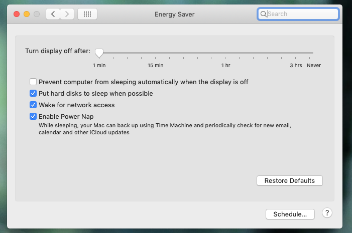

Hifi33 Posted June 3, 2019 Share Posted June 3, 2019 Weird, I was just about to post my screenshot of my Power Saving panel as I didn't see the Power Nap etc any longer, and I see your panel does not have the option there either. I am having some difficulty connecting to the build over the network once it is asleep. Plex, Media Servers etc. so I am trying to locate the issue. Turned on File Sharing in Sharing prefs, and will see what that does. Sleep works fine, just won't wake over network. Link to comment https://www.insanelymac.com/forum/topic/337837-glasgoods-macos-mojave-successguide-for-aorus-z390-pro/page/20/#findComment-2676016 Share on other sites More sharing options...
glasgood Posted June 3, 2019 Author Share Posted June 3, 2019 1 minute ago, Hifi33 said: Weird, I was just about to post my screenshot of my Power Saving panel as I didn't see the Power Nap etc any longer, and I see your panel does not have the option there either. I am having some difficulty connecting to the build over the network once it is asleep. Plex, Media Servers etc. so I am trying to locate the issue. Turned on File Sharing in Sharing prefs, and will see what that does. Sleep works fine, just won't wake over network. Just fixed this, see new uploaded EFI and read update Link to comment https://www.insanelymac.com/forum/topic/337837-glasgoods-macos-mojave-successguide-for-aorus-z390-pro/page/20/#findComment-2676017 Share on other sites More sharing options...
glasgood Posted June 3, 2019 Author Share Posted June 3, 2019 (edited) @digital_is_now @Hifi33 Had a further look into this, here is a fix. I don't use sleep myself but glad you flagged this up. See update CodecCommander.kext.zip SSDT-ALC1220.aml.zip Edited June 4, 2019 by glasgood 1 Link to comment https://www.insanelymac.com/forum/topic/337837-glasgoods-macos-mojave-successguide-for-aorus-z390-pro/page/20/#findComment-2676020 Share on other sites More sharing options...
glasgood Posted June 3, 2019 Author Share Posted June 3, 2019 1 minute ago, eSaF said: If I may be bold and jump in - Looking at the 'Energy Saver' posted, I noticed a choice of only 4 settings offered where as mine has 5 (See included pic - The Mac Model I chose is 17.1). Would I be thinking it goes according to Mac Model used, I am just curious. Hi @eSaF Yes, different Energy Saver profile according to Mac Model used. I'm using iMac 19,1. Link to comment https://www.insanelymac.com/forum/topic/337837-glasgoods-macos-mojave-successguide-for-aorus-z390-pro/page/20/#findComment-2676024 Share on other sites More sharing options...

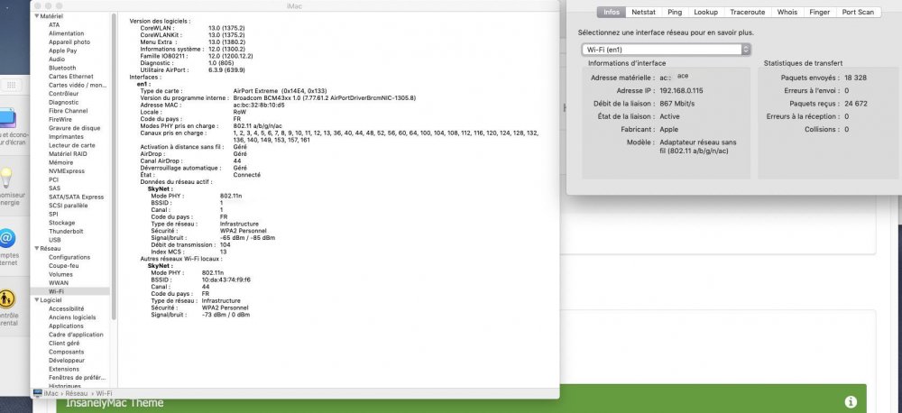

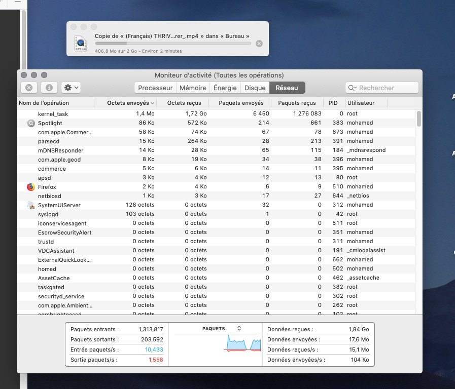

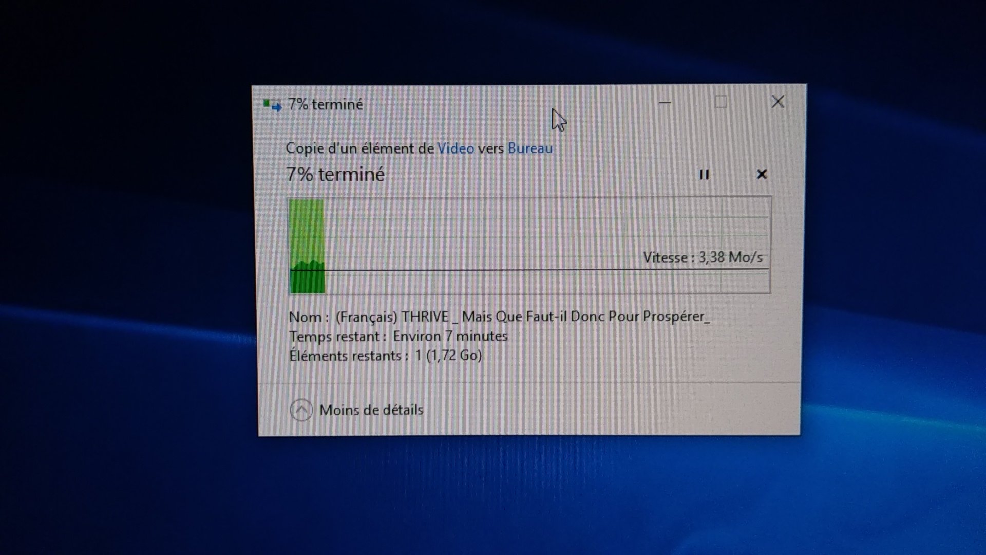

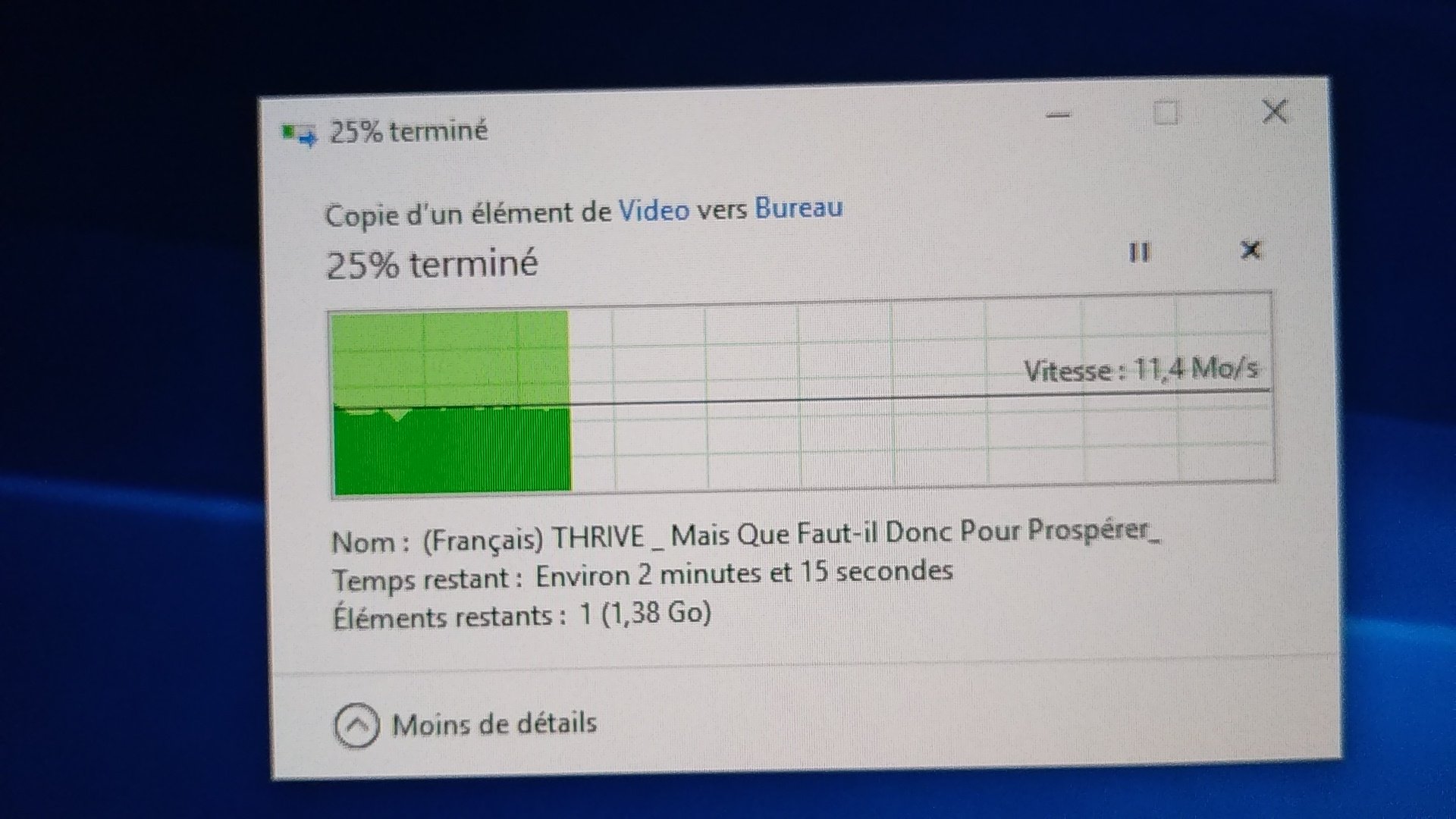

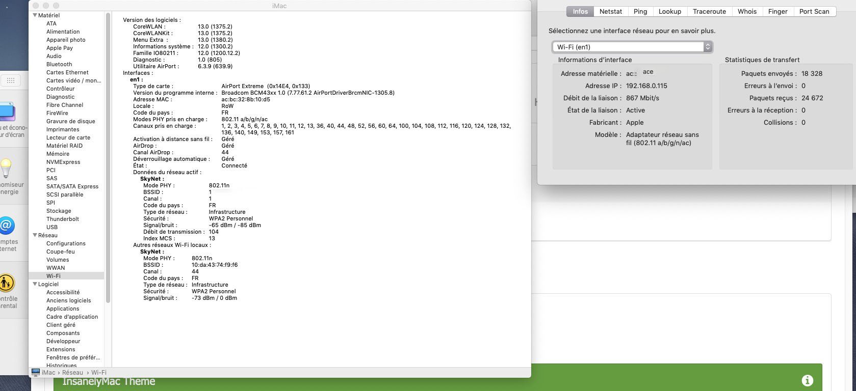

nelio33 Posted June 3, 2019 Share Posted June 3, 2019 On 5/23/2019 at 3:24 PM, glasgood said: helloI encounter a speed problem on the wifi / bluetooth card, the internet connection and very slow unstable and lag a lotin local network copying a 2go file since my nas takes more than 39 minutes.in ethernet less than 30 secondsi have BCM943602CS i tried in 5ghz and 2,4ghz same problemAny ideas ? Link to comment https://www.insanelymac.com/forum/topic/337837-glasgoods-macos-mojave-successguide-for-aorus-z390-pro/page/20/#findComment-2676039 Share on other sites More sharing options...
glasgood Posted June 3, 2019 Author Share Posted June 3, 2019 1 hour ago, nelio33 said: helloI encounter a speed problem on the wifi / bluetooth card, the internet connection and very slow unstable and lag a lotin local network copying a 2go file since my nas takes more than 39 minutes.in ethernet less than 30 secondsi have BCM943602CS i tried in 5ghz and 2,4ghz same problemAny ideas ? As far as I know, there are a few versions of the BCM943602CS with different number of antenna, some have 3 and 4. Someone recently mentioned having lag and resolved issue by replacing the card. What happens if you move machine nearer the wireless router, does anything improve. 1 Link to comment https://www.insanelymac.com/forum/topic/337837-glasgoods-macos-mojave-successguide-for-aorus-z390-pro/page/20/#findComment-2676059 Share on other sites More sharing options...

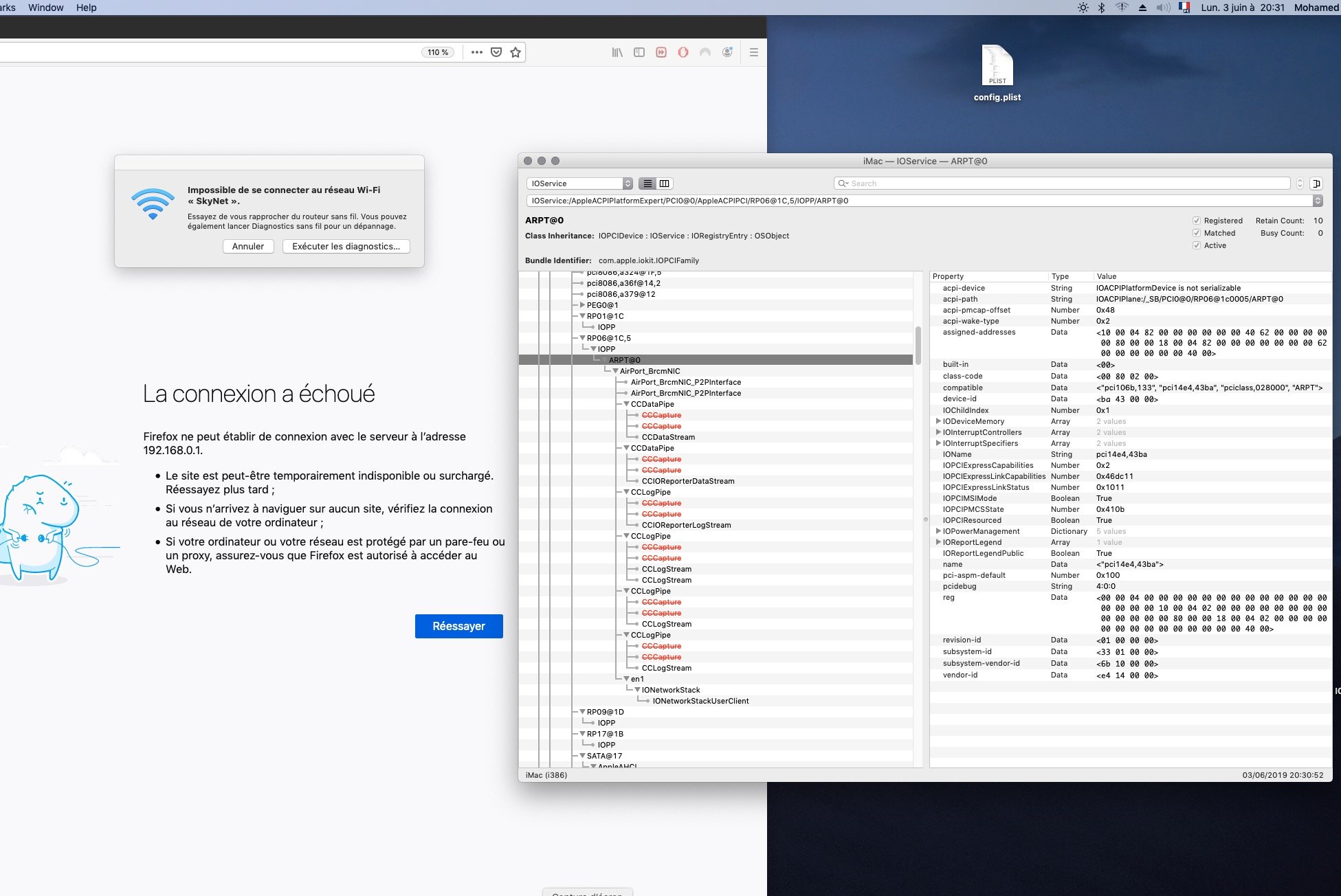

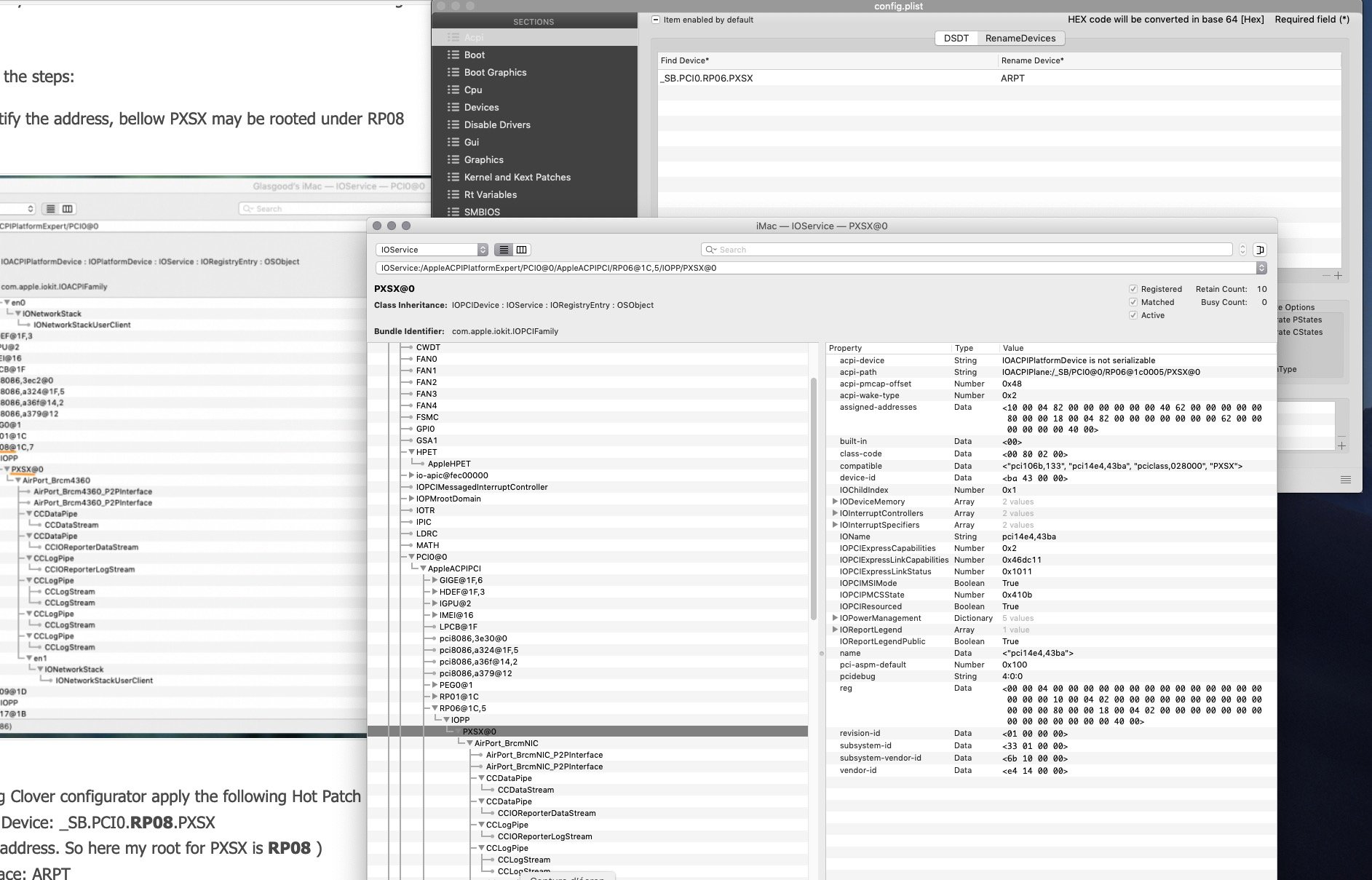

glasgood Posted June 3, 2019 Author Share Posted June 3, 2019 (edited) 3 hours ago, nelio33 said: helloI encounter a speed problem on the wifi / bluetooth card, the internet connection and very slow unstable and lag a lotAny ideas ? Hi @nelio33 Try adding the following hot patch to config.plist. Wifi cards are listed under ARPT in macOS and not PXSX. It's not essential that you should need to rename PXSX to ARPT for working WiFi, but in this instance it may be helpful. So here are the steps: Identify the address, bellow PXSX may be rooted under RP08 Using Clover configurator apply the following Hot Patch : Find Device: _SB.PCI0.RP08.PXSX ( PXSX is attached to a different root then use that root address. So here my root for PXSX is RP08 ) Rename: ARPT Save Clover Configurator Shutdown / and start Hackintosh ( may cause a kernel panic on restart, if it does just restart Hackintosh ) Check that rename has taken effect ( So, _SB.PCI0.RP08.PXSX is now _SB.PCI0.RP08.ARPT ) Hope this is helpful ? Edited June 3, 2019 by glasgood 1 Link to comment https://www.insanelymac.com/forum/topic/337837-glasgoods-macos-mojave-successguide-for-aorus-z390-pro/page/20/#findComment-2676068 Share on other sites More sharing options...
nelio33 Posted June 3, 2019 Share Posted June 3, 2019 (edited) 2 hours ago, glasgood said: Hope this is helpful ? Hello Glasgood, i make change with clover mine is on RPO6, little bit better with "ARPT" reduce time, obtain better result when i move wifi acess point to other rom in under the desk. i compare with windows 10 i have better reslut when access point is on other rom. hackintosh is a little behind. my card have 3 antenna, and my access point is EX3700 Edited June 3, 2019 by nelio33 Link to comment https://www.insanelymac.com/forum/topic/337837-glasgoods-macos-mojave-successguide-for-aorus-z390-pro/page/20/#findComment-2676089 Share on other sites More sharing options...

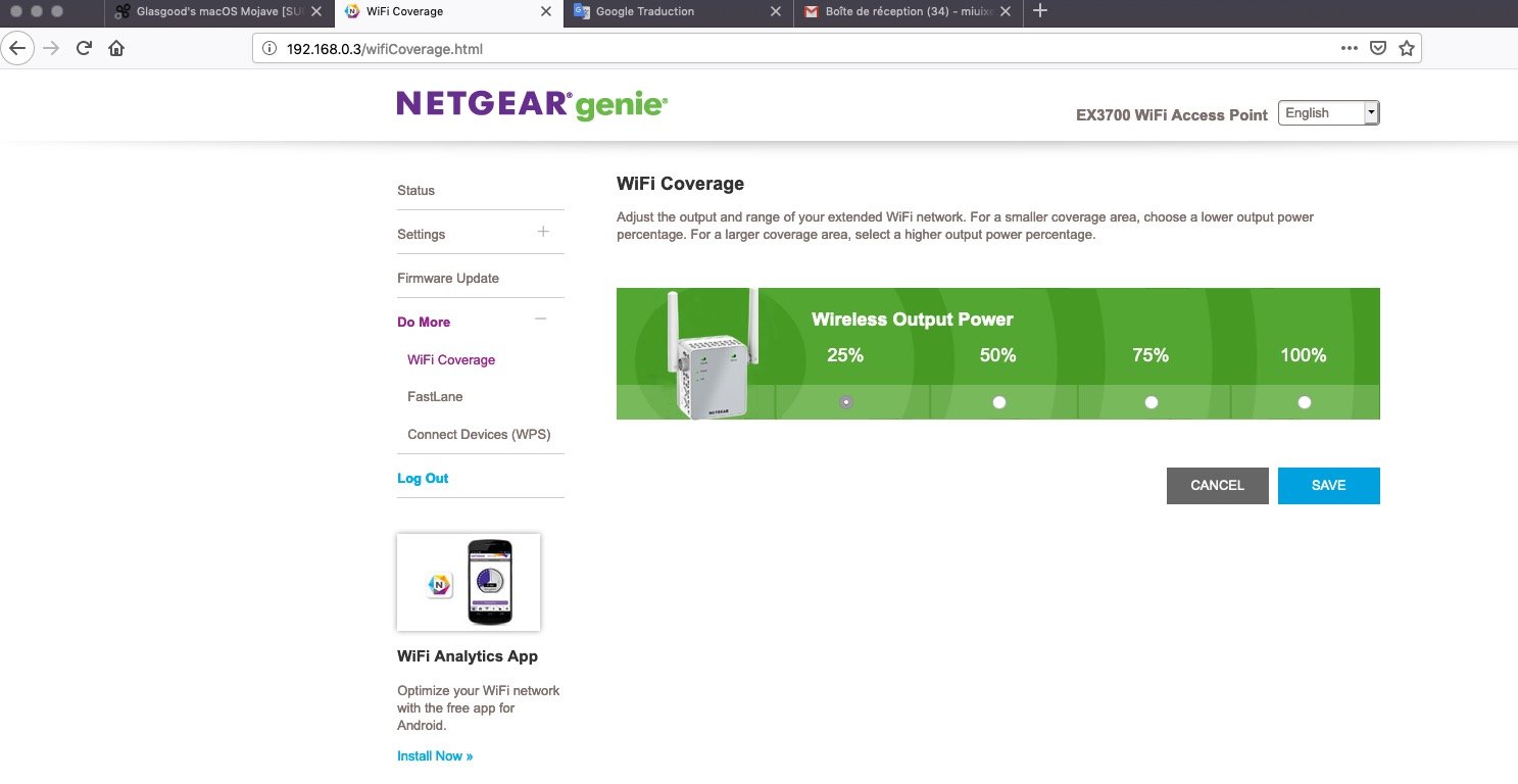

nelio33 Posted June 4, 2019 Share Posted June 4, 2019 Hello I found my problem, I'm ashamed lol , the wifi terminal was limited in power to 25% I had to configure it several years ago to protect my brain from fukushima radiation ... I get a proper navigation now, and the speed is more better, I think the limiting factor is the access point "EX3700" I use little wifi, I just wanted to test this card with which I can not still not having imessage and facetime. Do you think the second card choice (work with kext) would be better with imessage and facetime? 1 Link to comment https://www.insanelymac.com/forum/topic/337837-glasgoods-macos-mojave-successguide-for-aorus-z390-pro/page/20/#findComment-2676241 Share on other sites More sharing options...
