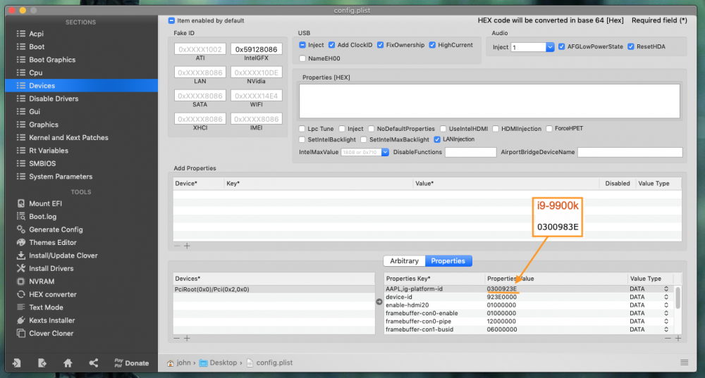

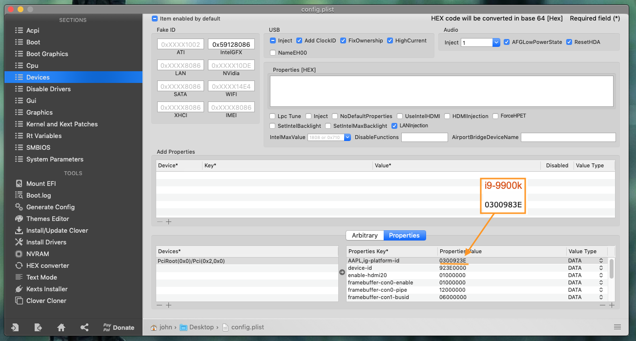

AudioGod Posted May 18, 2019 Share Posted May 18, 2019 (edited) Update number two, It's got something to do with the 630 gpu as I opened geekbench to run a test and noticed it used to display both GPU and it still does but before I could only select the rx580 and now I can select both to run a gpu test with so when I moved the properties and it renamed it by removing the 2 and I changed it all around something happened I guess. Hopefully you will know what's going on cos I'm abit lost and have gone back to nothing showing under pci for now. Edited May 18, 2019 by AudioGod Link to comment https://www.insanelymac.com/forum/topic/337837-glasgoods-macos-mojave-successguide-for-aorus-z390-pro/page/13/#findComment-2674214 Share on other sites More sharing options...
AudioGod Posted May 18, 2019 Share Posted May 18, 2019 (edited) Ok I've sorted it out, instead of copying and paisting all the pci info lines into properties at once I did it one at a time and when I found one that already existed (for the 630) I added the extra info into it manually with clover, rebooted and perfect. Boot time is back to normal and everything is displaying under pci. Also in geekbench I can see the 630 and 580 but can only select the 580 to run a test with. Phew Edited May 18, 2019 by AudioGod Link to comment https://www.insanelymac.com/forum/topic/337837-glasgoods-macos-mojave-successguide-for-aorus-z390-pro/page/13/#findComment-2674223 Share on other sites More sharing options...
glasgood Posted May 18, 2019 Author Share Posted May 18, 2019 3 minutes ago, AudioGod said: Ok I've sorted it out, instead of copying and pasting all the lines in at once I did it one at a time and when I found one that already existed (for the 630) I added the extra info into if manually with clover rebooted and perfect. Boot time is back to normal and everything is displaying under pci. Also in geekbench I can see the 630 and 580 but can only select the 580 to run a test with. Phew Is you CPU is not reported as i9 is "About this Mac" Then you can try these settings: Back tomorrow ! Link to comment https://www.insanelymac.com/forum/topic/337837-glasgoods-macos-mojave-successguide-for-aorus-z390-pro/page/13/#findComment-2674225 Share on other sites More sharing options...

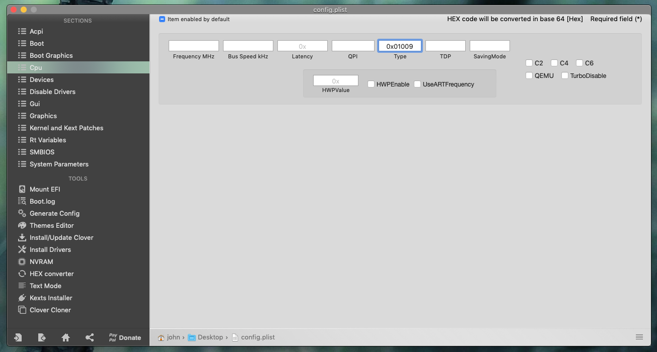

AudioGod Posted May 18, 2019 Share Posted May 18, 2019 1 hour ago, glasgood said: Is you CPU is not reported as i9 is "About this Mac" Then you can try these settings: Back tomorrow ! 01009 yes it shows the correct cpu but changing the other value doubles the time it takes for it too boot up (40 seconds) and drops my geekbench and cinibench scores where as leaving it as it was makes my system boot super quick (18 seconds) and my scores shoot right up so that can't be right surely? Have a good evening pal Link to comment https://www.insanelymac.com/forum/topic/337837-glasgoods-macos-mojave-successguide-for-aorus-z390-pro/page/13/#findComment-2674230 Share on other sites More sharing options...

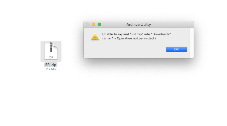

paulo92 Posted May 19, 2019 Share Posted May 19, 2019 40 minutes ago, glasgood said: Attach your EFI Actually it your your EFI In my final atempts I have just copy pasted your EFI to see if I can get to the install screen. There is no config.plist edit in this. But hence here it is. EFI.zip Link to comment https://www.insanelymac.com/forum/topic/337837-glasgoods-macos-mojave-successguide-for-aorus-z390-pro/page/13/#findComment-2674286 Share on other sites More sharing options...
glasgood Posted May 19, 2019 Author Share Posted May 19, 2019 (edited) 5 minutes ago, paulo92 said: Actually it your your EFI In my final atempts I have just copy pasted your EFI to see if I can get to the install screen. There is no config.plist edit in this. But hence here it is. EFI.zip @paulo92 I cannot open EFI, how are you creating your Mojave Installer, are you using VMWare ? what version of macOS Mojave did you download ? Edited May 19, 2019 by glasgood Link to comment https://www.insanelymac.com/forum/topic/337837-glasgoods-macos-mojave-successguide-for-aorus-z390-pro/page/13/#findComment-2674287 Share on other sites More sharing options...

paulo92 Posted May 19, 2019 Share Posted May 19, 2019 7 minutes ago, glasgood said: @Juniorsant I cannot open EFI, how are you creating your Mojave Installer, are you using VMWare ? what version of macOS Mojave did you download ? Sorry, it seems I have managed to upload a corrupted zip. Here it is once more. I could unzip this one. And actually I am using a real mac (an older air) to create the installation USB. The OSX is the latest one, downloaded yesterday from the appstore. EFI_GOOD.zip Link to comment https://www.insanelymac.com/forum/topic/337837-glasgoods-macos-mojave-successguide-for-aorus-z390-pro/page/13/#findComment-2674291 Share on other sites More sharing options...
