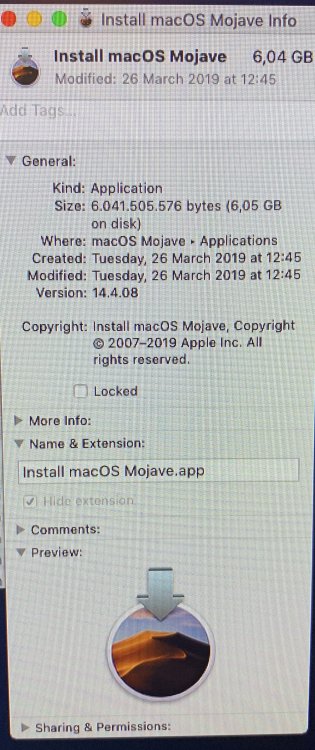

You mention you created the installer using VM, did you download macOS Mojave from App Store ?

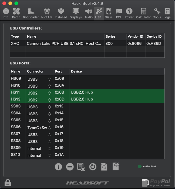

Amazing guide! Works perfectly on my setup. :D

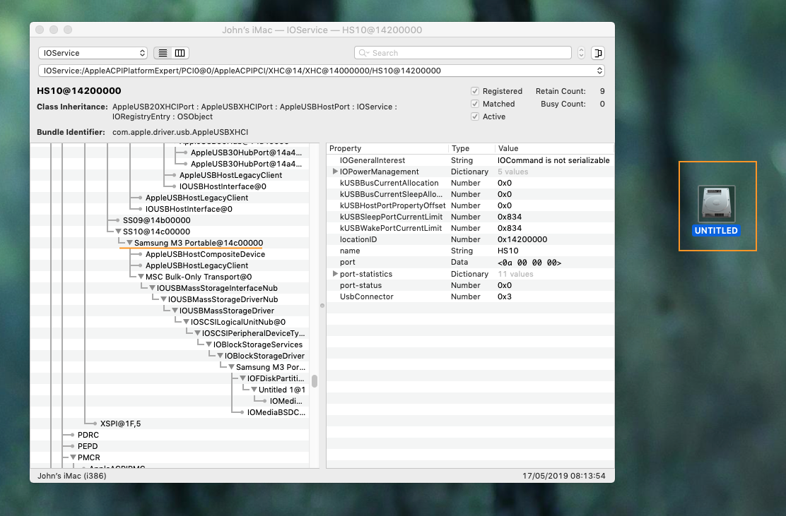

One issue I had with your SSDT in the POST INSTALL zip file. In Hackintool, SS09 & SS10 are shown as Internal. I found this out when I inserted external hard drive into the port, it does not show the drive on the desktop and only in the Finder. So what I did was change from Internal to USB3. Then export and replaced the SSDT-UIAC.aml. I also copied the USBPorts.kext created to the kext folder and remove USBInjectAll.kext.
Edited by Madane
@Madane
Hi

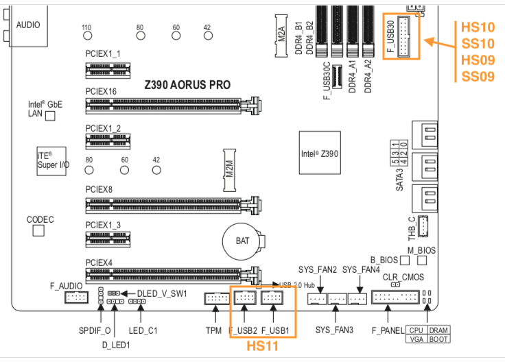

During ports discovery, Internal header F_USB30 maps to HSS10, SS10, HS0,9 SS09 on my motherboard. Hence why HSS10, SS10, HS09, SS09 are internal.
My Samsung M3 Portable ( External ) hard drive is mounted and shown on Desktop.

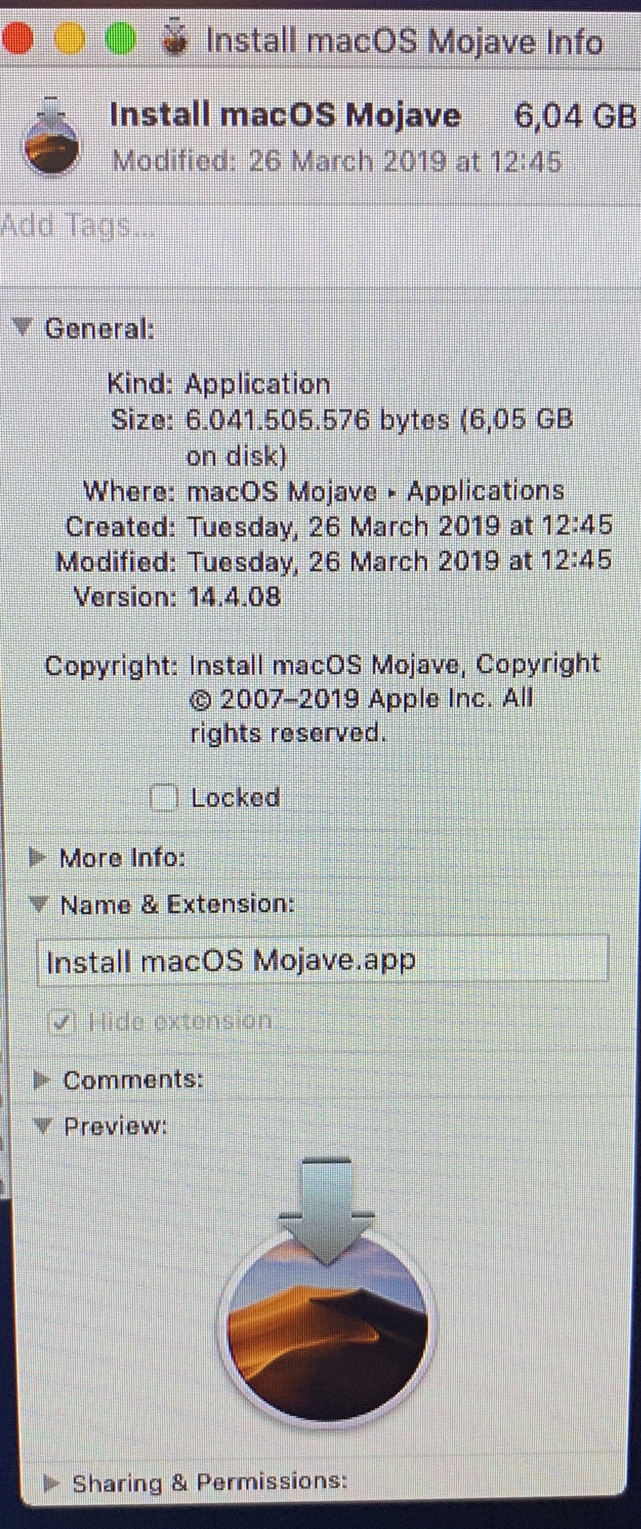

ok this is the situation.... now install go on, and stay stuck at 2% then give me a message that the download is damaged or incomplete ..... now I download again the Mojave app installer...same size...creating the USB again!
I think the problem is when I run the command line:
"sudo /Applications/Install\ macOS\ Mojave.app/Contents/Resources/createinstallmedia --volume /Volumes/USB --nointeraction && say Mojave Drive Created"
and it freeze, when I stop it something is corrupted....
the Mojave app is ok, downloaded 2 times and size and all its ok
Maybe because I create the USB from Sierra?
If it'll freeze again I'll move the installer on Mojave and create the USB from there!!
damn... :hyper:
this is really strange, absurd, argh argh argh argh :wallbash:
USB creation using high sierra, freeze at the end, I mean no terminal prompt but I have to stop it and I get a message that I'll stop some operation, dunno if its ok...
when I install, it say the installation disk is corrupted or incomplete, at about 2% from the end
USB creation using Mojave, all is fine and I get at the end the terminal prompt, but when I install at about 3% from the end, I get always the errors I show before.....

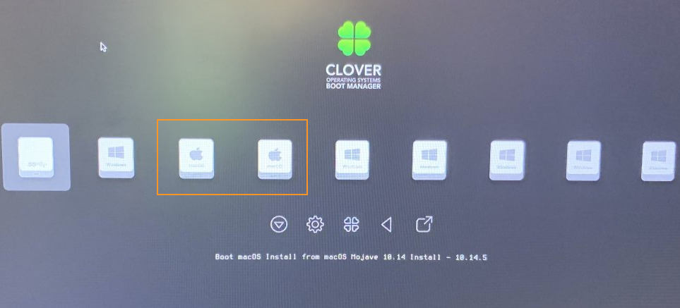

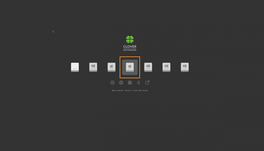

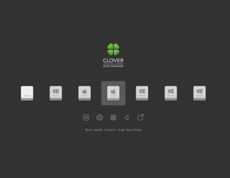

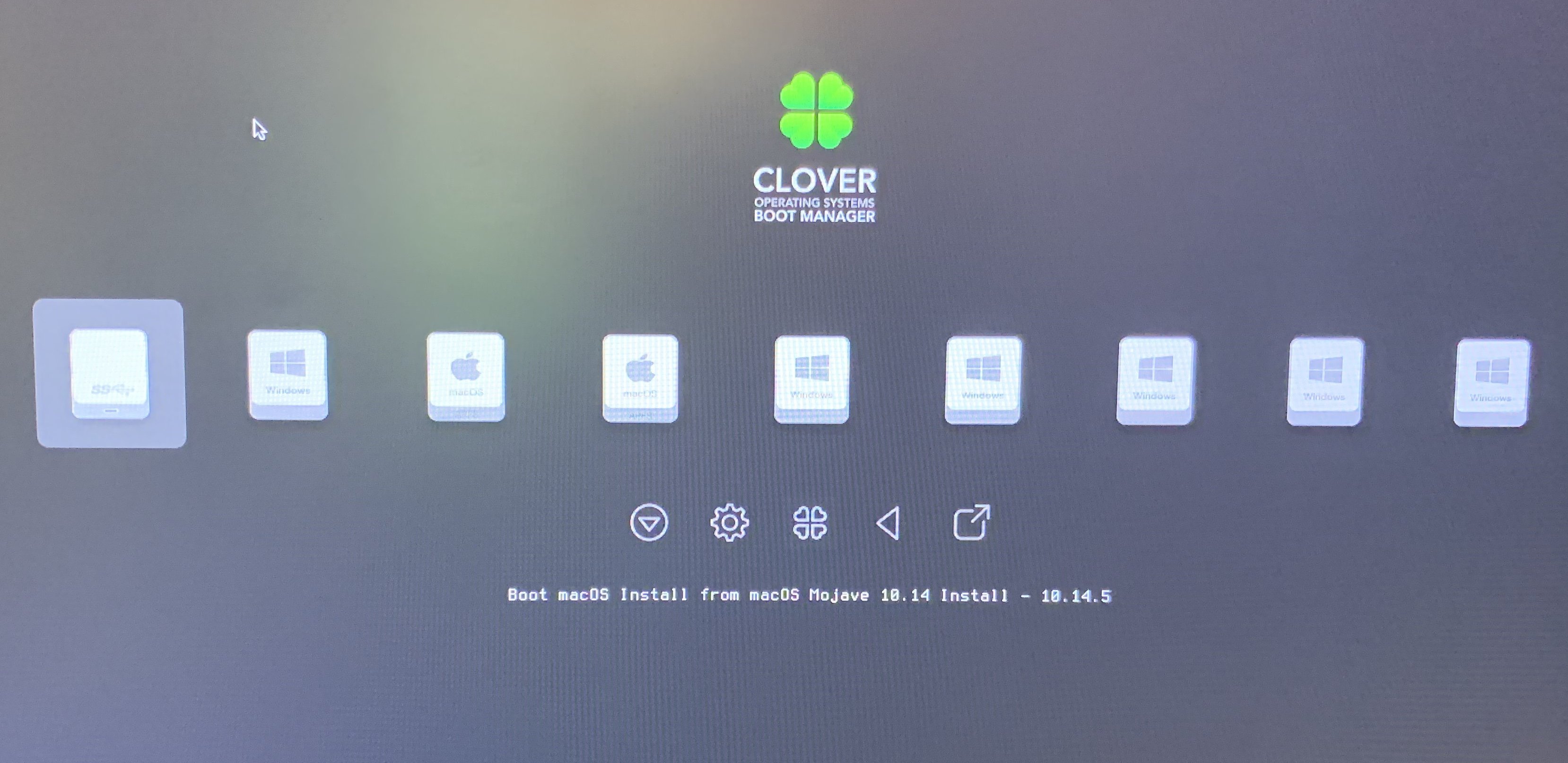

Can you boot with your USB Mojave installer and send me a photo of the Clover boot menu.
32 minutes ago, glasgood said:
Can you attach EFI folder

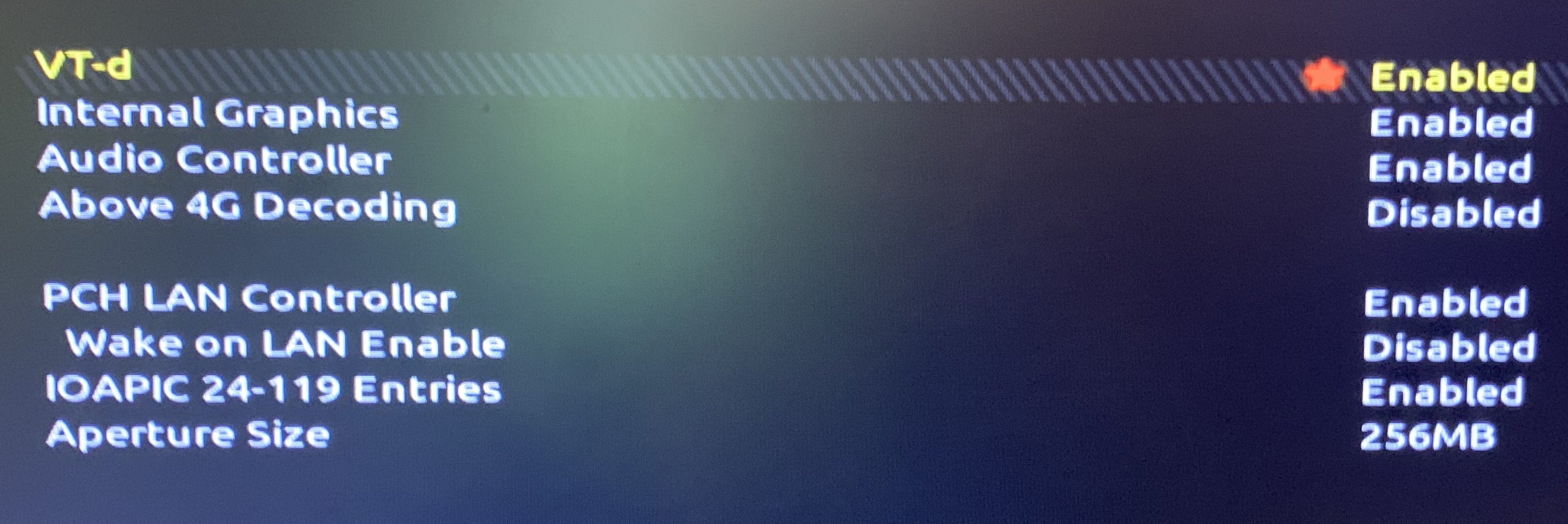

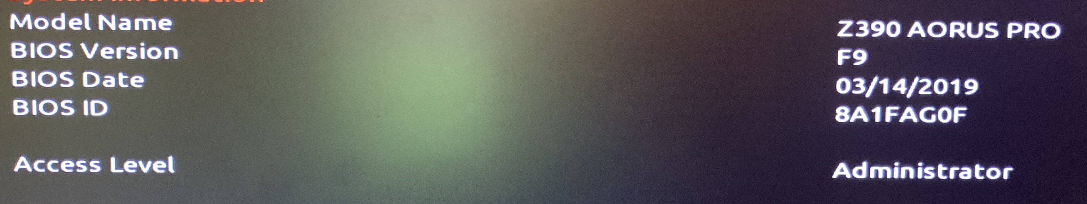

@blackwalker What BIOS version are you on ?
  • In BIOS can you check and confirm if Above 4G decoding is disabled ?
  • Send EFI folder
  • Boot to Clover menu, send me a photo of Clover menu.
Check BIOS settings:
First:  Save & Exit → Load Optimized Defaults
 then
 BIOS  Windows 8/10 Features  Other OS
 BIOS  CSM Support  Enabled
 Peripherals  Initial Display Output  PCIe 1 Slot
 Peripherals  Trusted Computing  Security Device Support   Disable
 Peripherals  Intel(R)Bios Guard  Intel BIOS Guard Support   Disable
 Peripherals  USB Configuration  Legacy USB Support   Enabled
 Peripherals  USB Configuration  XHCI Hand-off   Enabled
 Peripherals  Network Stack Configuration  Network Stack   Disabled
 Peripherals  SATA And RST Configuration  SATA Mode Selection   AHCI
 Chipset  Vt-d  Enabled
 Chipset  Internal Graphics  Enabled
 Chipset  DVMT Pre-Allocated  64M
 Chipset  DVMT Total Gfx Mem  256M
 Chipset  Audio Controller  Enabled
 Chipset  Above 4G Decoding  Disabled
 Power  ErP  Disabled
 Power  RC6 (Render Standby)  Enabled
Edited by glasgood
