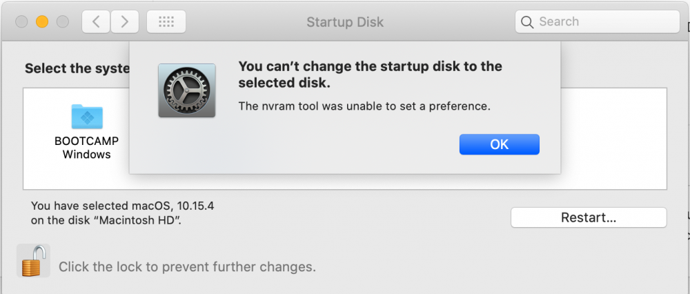

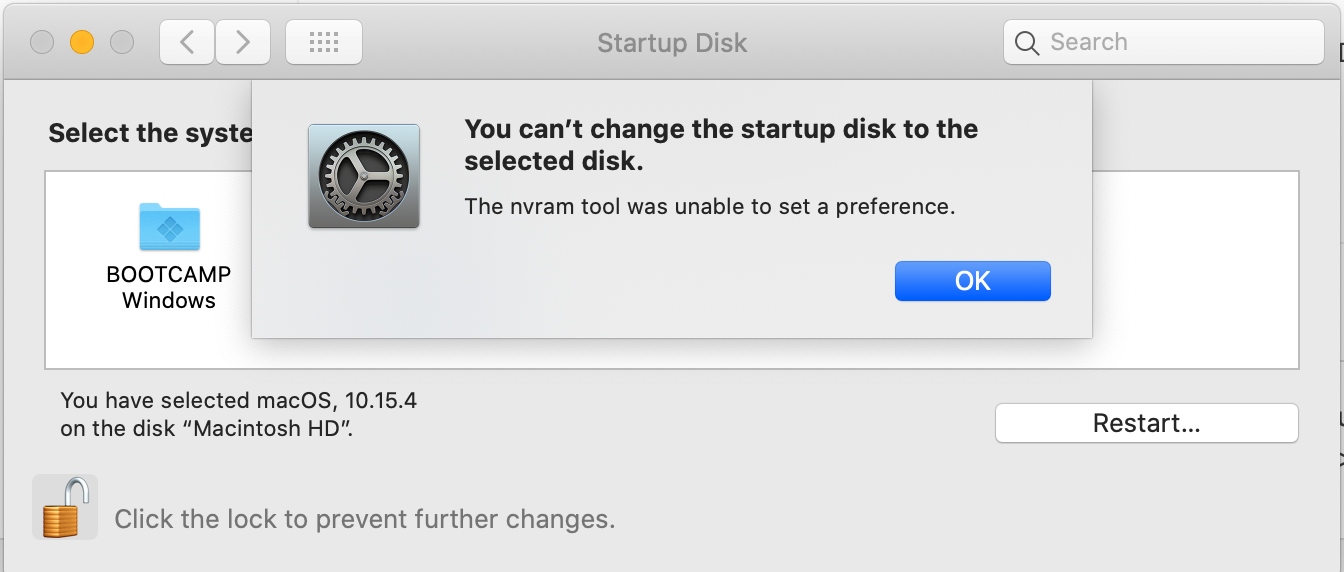

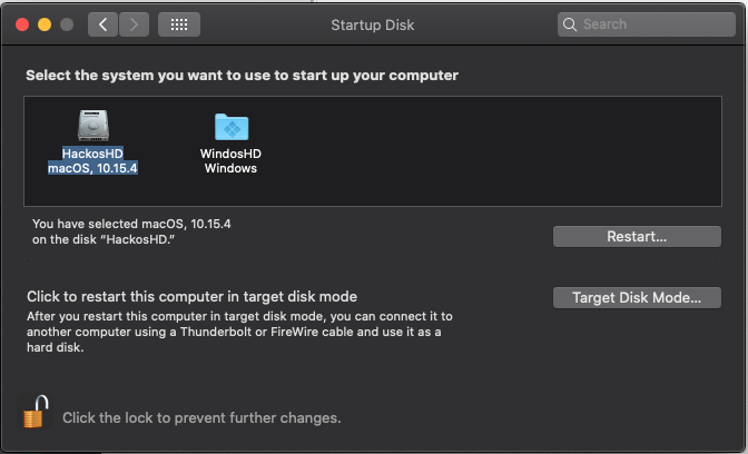

obus Posted March 29, 2020 Author Share Posted March 29, 2020 After updating to 10.15.4 I have this problem when trying to change boot disk with bless tool in System Preferences:Any ideas? Link to comment https://www.insanelymac.com/forum/topic/335193-help-installing-mojave-on-xeon-w-2175-and-asus-ws-c422-mobo/page/25/#findComment-2714491 Share on other sites More sharing options...
yapan4 Posted March 29, 2020 Share Posted March 29, 2020 14 minutes ago, obus said: After updating to 10.15.4 I have this problem when trying to change boot disk with bless tool in System Preferences:Any ideas? Clover v.5107 has no this issue EFI.zip Link to comment https://www.insanelymac.com/forum/topic/335193-help-installing-mojave-on-xeon-w-2175-and-asus-ws-c422-mobo/page/25/#findComment-2714494 Share on other sites More sharing options...

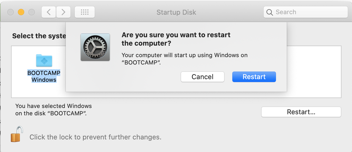

addoil Posted March 29, 2020 Share Posted March 29, 2020 2 hours ago, obus said: After updating to 10.15.4 I have this problem when trying to change boot disk with bless tool in System Preferences:Any ideas? I had this problem when I updated to 10.15.4. What I did was: 1. In BIOS, change boot disk to MacOS drive. I have two NVME drives, one loaded with MacOS, one with Windows. After updating to 10.15.4, the boot preference was reset to Windows Boot Manager. 2. Boot into Windows (using boot loader menu), change boot disk to MacOS. 3. Boot back to MacOS, I can freely choose Windows boot disk Not sure if this will help. If not, maybe try clear nvram? 1 Link to comment https://www.insanelymac.com/forum/topic/335193-help-installing-mojave-on-xeon-w-2175-and-asus-ws-c422-mobo/page/25/#findComment-2714522 Share on other sites More sharing options...
obus Posted March 30, 2020 Author Share Posted March 30, 2020 (edited) 12 hours ago, addoil said: I had this problem when I updated to 10.15.4. What I did was: 1. In BIOS, change boot disk to MacOS drive. I have two NVME drives, one loaded with MacOS, one with Windows. After updating to 10.15.4, the boot preference was reset to Windows Boot Manager. 2. Boot into Windows (using boot loader menu), change boot disk to MacOS. 3. Boot back to MacOS, I can freely choose Windows boot disk Not sure if this will help. If not, maybe try clear nvram? Tested this but unfortunately it didn't work for me. I have the same config as you with Windows 10 on a separate disk with it's own EFI. Are you booting Windows in the same way or are you booting with only one EFI on your main macOS disk? If so could you please share your config.plist/EFI. Edited March 30, 2020 by obus Link to comment https://www.insanelymac.com/forum/topic/335193-help-installing-mojave-on-xeon-w-2175-and-asus-ws-c422-mobo/page/25/#findComment-2714571 Share on other sites More sharing options...

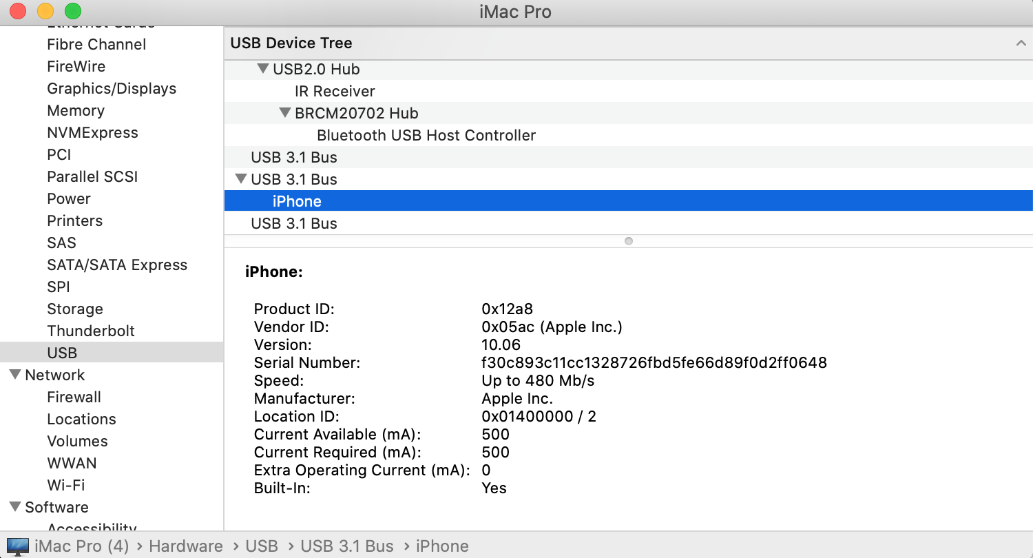

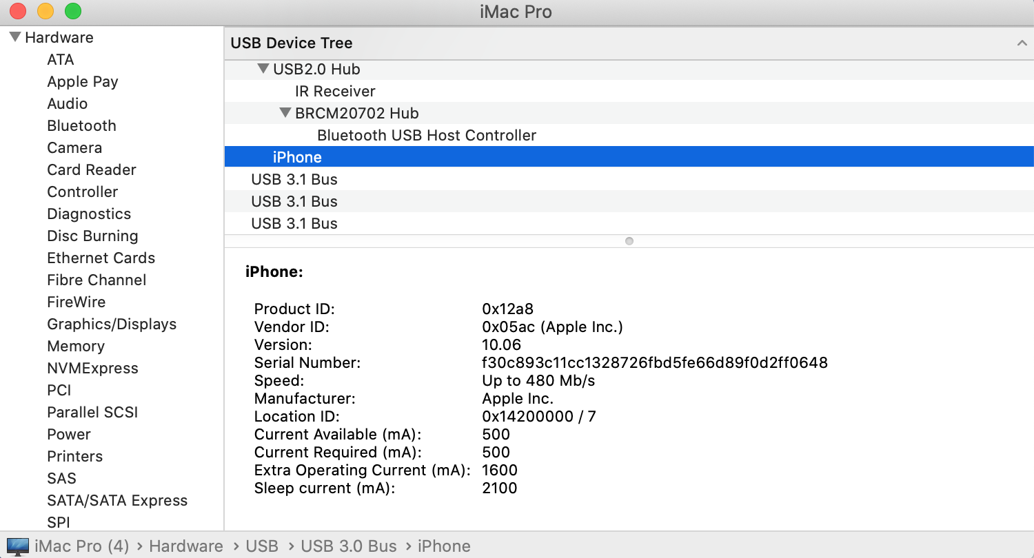

obus Posted April 2, 2020 Author Share Posted April 2, 2020 On 12/7/2019 at 4:17 AM, addoil said: If you plug your iPhone into the ASM3142 USB ports, do you still see "Extra Operating Current (mA): 1600" as in your picture? Hi @addoil. Did you fix this problem? Link to comment https://www.insanelymac.com/forum/topic/335193-help-installing-mojave-on-xeon-w-2175-and-asus-ws-c422-mobo/page/25/#findComment-2715114 Share on other sites More sharing options...
addoil Posted April 5, 2020 Share Posted April 5, 2020 On 3/30/2020 at 3:16 AM, obus said: Tested this but unfortunately it didn't work for me. I have the same config as you with Windows 10 on a separate disk with it's own EFI. Are you booting Windows in the same way or are you booting with only one EFI on your main macOS disk? If so could you please share your config.plist/EFI. I think I spoke too soon. I still have the same problem as you. However, in my case, when change setting in MacOS fails, the boot loader will resort back to default setting, which happens to be Windows 10 for me. And in Windows 10, Startup Disk tool works correctly. So this issue does not bother me. I did some diagnosis. If you run sudo systemsetup then liststartupdisks you should see startup entries available. For my case, they are /Volumes/BOOTCAMP/WINDOWS /System/Library/CoreServices But the MacOS entry seems not correct. Because when I set the entry in Windows 10 correctly, and successfully boot into MacOS, the MacOS entry is blank. This suggests to me that, somehow MacOS cannot detect correct MacOS boot entry. Link to comment https://www.insanelymac.com/forum/topic/335193-help-installing-mojave-on-xeon-w-2175-and-asus-ws-c422-mobo/page/25/#findComment-2715451 Share on other sites More sharing options...
addoil Posted April 5, 2020 Share Posted April 5, 2020 On 4/2/2020 at 9:17 AM, obus said: Hi @addoil. Did you fix this problem? I check again. Now the only port I cannot charge iPad is the USB type A port above USB type C. All other ports including the internal ones can charge. This seems weird because that type A port and type C port are on the same switch. Link to comment https://www.insanelymac.com/forum/topic/335193-help-installing-mojave-on-xeon-w-2175-and-asus-ws-c422-mobo/page/25/#findComment-2715453 Share on other sites More sharing options...

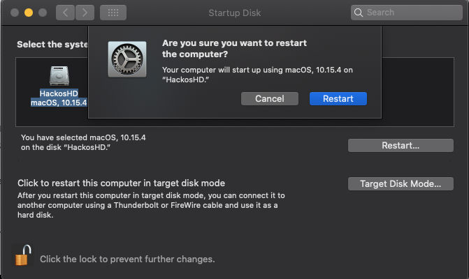

obus Posted April 5, 2020 Author Share Posted April 5, 2020 (edited) 18 hours ago, addoil said: I think I spoke too soon. I still have the same problem as you. However, in my case, when change setting in MacOS fails, the boot loader will resort back to default setting, which happens to be Windows 10 for me. And in Windows 10, Startup Disk tool works correctly. So this issue does not bother me. I presume you have done this otherwise it will NOT work: Boot Camp control panel uses GPT partition table to obtain each boot option name. After installing Windows separately you will have to relabel the partition manually. This can be done with many tools including open-source gdisk utility. Reference example: PS C:\gdisk> .\gdisk64.exe \\.\physicaldrive0 GPT fdisk (gdisk) version 1.0.4 Command (? for help): p Disk \\.\physicaldrive0: 419430400 sectors, 200.0 GiB Sector size (logical): 512 bytes Disk identifier (GUID): DEC57EB1-B3B5-49B2-95F5-3B8C4D3E4E12 57 Partition table holds up to 128 entries Main partition table begins at sector 2 and ends at sector 33 First usable sector is 34, last usable sector is 419430366 Partitions will be aligned on 2048-sector boundaries Total free space is 4029 sectors (2.0 MiB) Number Start (sector) 1 2048 2 1024000 3 1226752 4 1259520 Command (? for help): c Partition number (1-4): 4 Enter name: BOOTCAMP End (sector) Size 1023999 499.0 MiB 1226751 99.0 MiB 1259519 16.0 MiB 419428351 199.4 GiB Code Name 2700 Basic data partition EF00 EFI system partition 0C01 Microsoft reserved ... 0700 Basic data partition Command (? for help): w Final checks complete. About to write GPT data. THIS WILL OVERWRITE EXISTING PARTITIONS!! Do you want to proceed? (Y/N): Y OK; writing new GUID partition table (GPT) to \\.\physicaldrive0. Disk synchronization succeeded! The computer should now use the new partition table. The operation has completed successfully. Configuration.pdf Edited April 5, 2020 by obus Link to comment https://www.insanelymac.com/forum/topic/335193-help-installing-mojave-on-xeon-w-2175-and-asus-ws-c422-mobo/page/25/#findComment-2715584 Share on other sites More sharing options...
obus Posted April 5, 2020 Author Share Posted April 5, 2020 (edited) I've solved my "bless" problems by reworking my config.plist. Everything is working as it should now. You could test my config.plist with your personal changes and see if it will work for you (just put in your own PlatformInfo). Charging is working for me both during sleep and power off on all my USB 3.0 ports. Charging from my USB type C port is working when my rig is powered on but not during sleep and power off: config.plist Edited April 9, 2020 by obus Link to comment https://www.insanelymac.com/forum/topic/335193-help-installing-mojave-on-xeon-w-2175-and-asus-ws-c422-mobo/page/25/#findComment-2715588 Share on other sites More sharing options...

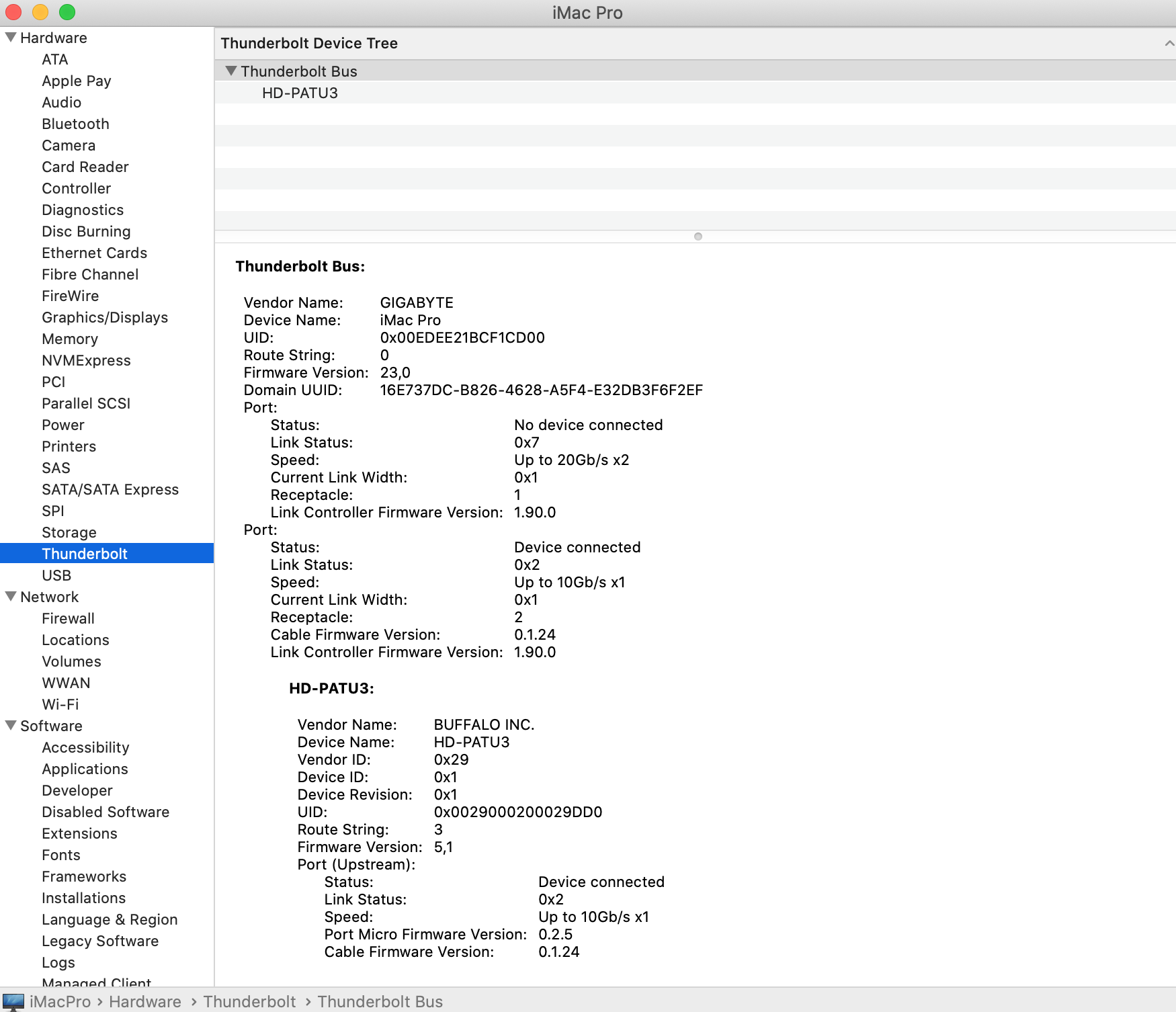

obus Posted July 2, 2020 Author Share Posted July 2, 2020 (edited) Flashed my Gigabyte Titan-Ridge TB3 card with new firmware today. The card is now working more or less like the native Apple thunderbolt 3. Credit goes to @DSM2 and his team for the hard work to get this working. (https://www.hackintosh-forum.de/forum/thread/46713-natives-thunderbolt3-an-jedem-rechner/?pageNo=1 Kudos to @maleorderbride for the nice and simple SSDT-HOTPLUG-TB3.aml he provided from this thread: https://www.insanelymac.com/forum/topic/323540-thunderbolt-drivers/ and last but not least credits to @ameyrupji for his great guide how to flash the firmware: https://github.com/ameyrupji/thunderbolt-macpro-5-1/blob/master/GC-TitanRidge.md?fbclid=IwAR05Z3oG3fZc2ArzPiYgQcG0P7PEXlmbCktf0ulODeFaTSJa2BF0iWMaCDM SSDT-HOTPLUG-TB3.aml Edited July 2, 2020 by obus 3 1 Link to comment https://www.insanelymac.com/forum/topic/335193-help-installing-mojave-on-xeon-w-2175-and-asus-ws-c422-mobo/page/25/#findComment-2728369 Share on other sites More sharing options...
Rangers Posted July 5, 2020 Share Posted July 5, 2020 On 7/3/2020 at 2:45 AM, obus said: Flashed my Gigabyte Titan-Ridge TB3 card with new firmware today. The card is now working more or less like the native Apple thunderbolt 3. Credit goes to @DSM2 and his team for the hard work to get this working. (https://www.hackintosh-forum.de/forum/thread/46713-natives-thunderbolt3-an-jedem-rechner/?pageNo=1 Kudos to @maleorderbride for the nice and simple SSDT-HOTPLUG-TB3.aml he provided from this thread: https://www.insanelymac.com/forum/topic/323540-thunderbolt-drivers/ and last but not least credits to @ameyrupji for his great guide how to flash the firmware: https://github.com/ameyrupji/thunderbolt-macpro-5-1/blob/master/GC-TitanRidge.md?fbclid=IwAR05Z3oG3fZc2ArzPiYgQcG0P7PEXlmbCktf0ulODeFaTSJa2BF0iWMaCDM SSDT-HOTPLUG-TB3.aml I have used Alpine Ridge TB3 card and according to the old iMac2017 TB3 information to create a SSDT hope that someone can use on ;The only supports Alpine Ridge TB3 card。 SSDT-Thunder-C422-GC-APLNE-Slot-3.aml 1 Link to comment https://www.insanelymac.com/forum/topic/335193-help-installing-mojave-on-xeon-w-2175-and-asus-ws-c422-mobo/page/25/#findComment-2728672 Share on other sites More sharing options...
