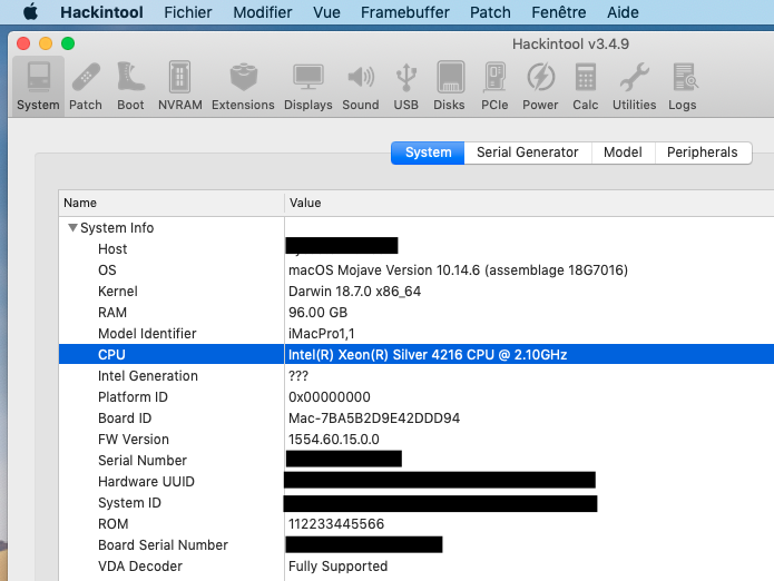

:thumbsup_anim: SUCCESS! :thumbsup_anim:
After throwing in my own CPU wrapper, VoodooTSCSync, emulated NVRAM and the npci=0x2000 flag in response to error messages and a last stumbling block after [PCI initialisation begins], I am finally able to boot into pre-installed Mojave or Catalina installations on the internal M.2 drive (reused from a previous hack).
I can suspend the system, and wake it at a keybord press or a click of the mouse.

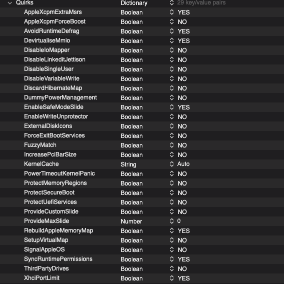

OpenCore (currently 0.6.5 because I did most of the work from January) Configured according to the guide for Skylake-X, but some quirks are not currently used: CustomSlide (as suggested by the OpenCore log: All slides are good! That was also the case with the Gigabyte C246 boards.); AppleXcpmCfgLock and AppleXcpmExtraMsrs (due to my patched BIOS). Emulated NVRAM set. Boot argument "npci=0x2000".

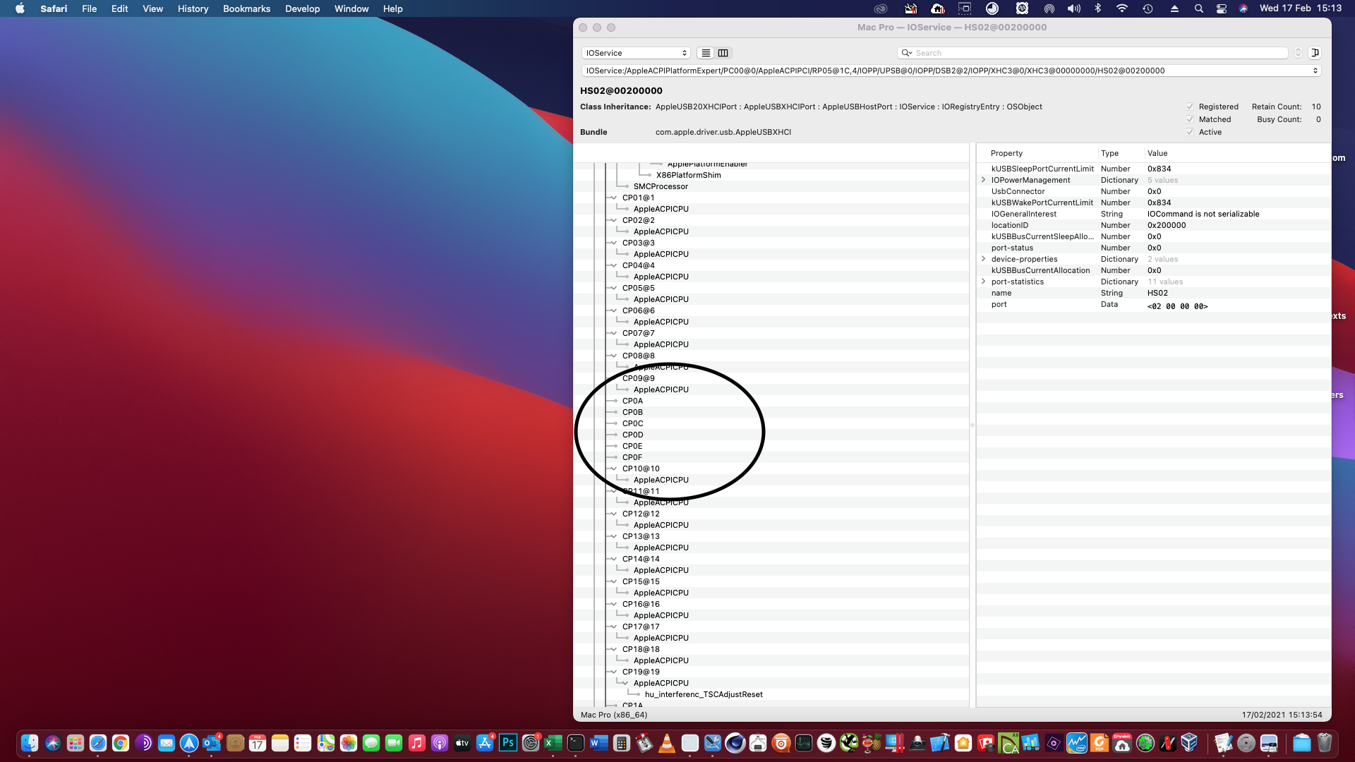

CPU Wrapping
As explained here, recent firmwares for C621 boards declare CPU as ACPI "devices" rather than "processors", as required by OS X. Other than downgrading the firmware until the DSDT describes CPU as "processor", the solution found by @metacollin is to wrap the CPU methods and create an ACPI processor object for OS X to play with.
A SysReport dump from OpenCore confirmed that BIOS F8 for the Gigabyte C621-SU8 has this issue. As the ACPI pathing for the CPU was the same, I first tried to use metacollin's SSDT, cut down to one socket (SSDT-CPU-WRAP-1S), but the boot halted shortly after an ACPI error. I then assumed that the wrapping for a Supermicro X11 board was not good enough for my Gigabyte board and, using metacollin's SSDT as a template, wrote my own SSDT for all the CPU methods I found in the DSDT as well as the sidecar files SSDT-1.aml and OEM1-1.aml to OEM4-1.aml (SSDT-CPU-WRAP-C621SU8; it dezips to a lovely 292 ko DSL which compiles to a 77 ko AML—yes the code is a little bit repetitive…). I got the same error, but then found that the ACPI error was a non-fatal red herring, that the real issue was in PCI initialisation and required boot-arg "npci=0x2000".
And it turned out that with this boot argument, metacollin's SSDT works also.

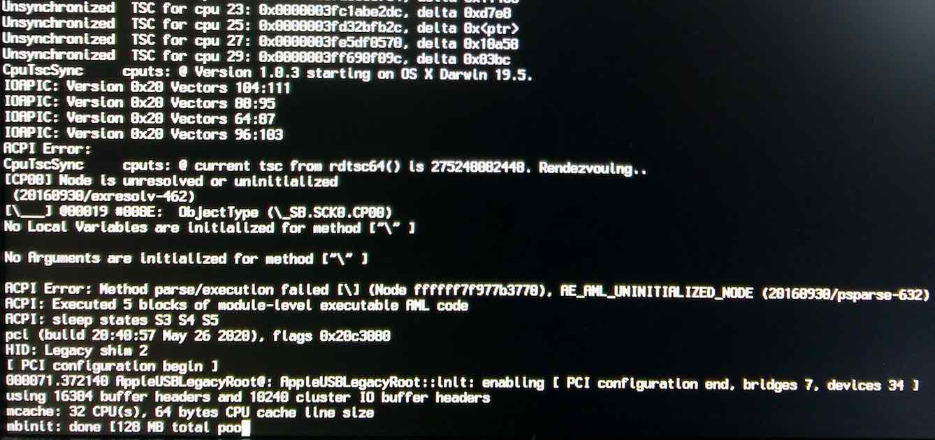

    [CP00] Node is unresolved or unitilized
    [\___] @00019 #008E: ObjectType (\_SB.SCK0.CP00)
    No Local Variables are initialised for method ["\" ]
    No Arguments are initialized for method ["\" ]
    Should I worry about it? Do something about it? And if so, what?
    More wrappings? External declarations with "\_SB" isntead of "_SB_"?
    [answered below]
(This shot is from an earlier trial with a different TSC kext from what I settled for, and shows how PCI intialisation halts brutally without "npci=0x2000". But it's always the same ACPI error.)

Quick update on my progress with C621-SU8:
I caught the red herring! My custom SSDT-PLUG, written at the very beginning, was trying to attach to the real CPU. With CPU wrapping, it should attach to the wrapped PR00 instead of CP00. With a new SSDT-PLUG the ACPI error has disappeared, and I appear to have working power management (whole AppleACPICPU subtree under PR00 in IORegistryExplorer.)

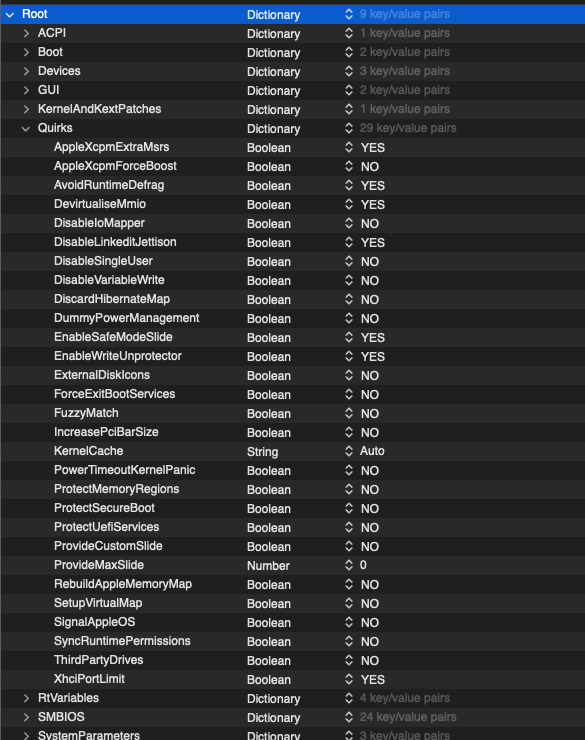

With the EnableWriteUnprotector quirk instead of RebuildAppleMemoryMap+SyncRuntimePermissions, the boot process is now very stable. My Gigabyte C246 boards have the same behaviour, so there seems to be trend with Gigabyte Xeon boards —if only the trend extended to native NVRAM…
This Quirk settings are well suited for my hackintosh too
Spoiler
I'll watch a bit and probably leave your version, thank you for sharing your knowledge

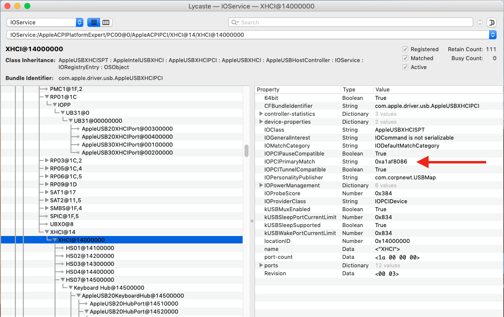

Right now I do small post-install improvements. USB 3.0 from the chipset works! I found a post by @KGP-iMacPro about a similar issue on X299: AppleUSBXHPCI attaches to the chipset USB controller XHCI@14000000 with IOPCIClassMatchID 0x0c033000 instead of 0xa2af8086 and breaks USB on X299 boards. On my C621-SU8, class 0x0c033000 attaches to both the ASM media controller, which works, and to the chipset XCHI controller, which should have class is 0xa1af8086, and does not work. I modified KGP-iMacPro's kext to have the right injector, made an appropriate USB map and now all USB ports work. (The kext is both an injector for the correct IOPCIClass and an USB map.)

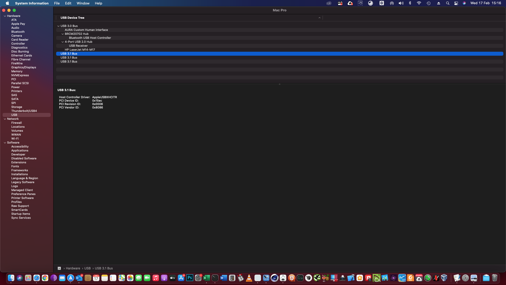

Is there anyone using a flashed or non-flashed Gigabyte Titan Ridge Thunderbolt V2 card?? I have installed the card. Thunderbolt port is recognised but the USB-C do not show in the IOReg tree... It shows up as USB3.0 in the about this Mac USB Device tree. To note, all USB device plugged into the port are not recognised..
@etorix I just noticed you have the Titan Ridge V1. Do all your USB-C port shows up and are they functional??
Hello @amjsez. Obus has already posted all the information you need for your board.
Off this topic, my TitanRidge v1 is flashed according to the detailed teachings in the forum-which-shall-not-be-named-here and connected to the C246-WU4 with the Thunderbolt cable but not the USB cable. As far I can test, both ports work as they should, with hot plug for Thunderbolt and USB-C devices. I expect that this flashed card would work on the C621-SU8 but I have not yet tested. I have a new TitanRidge v2 and want to experiment again with a "native" card before I fire up the CH341a programmer again.
19 hours ago, obus said:
Read this thread a little more thoroughly and you will learn!!:whistle:
Hi obus, I have been following this post for some time now... Don't know how I missed the thunderbolt parts.............:wallbash::wallbash:..
I had to flashed back to BIOS 1202. (Is BIOS 1202 a prerequisite to have USB-C shows up? My CPU core is not showing properly with bios 1202?)
Now the USB-C ports are showing properly. But it's still non functional... It still charge my phone, but any USB-C drives does not shows up.
Edited by amjsez
