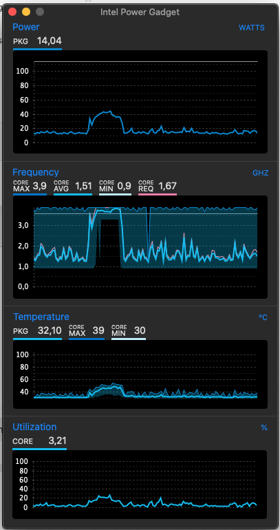

1 hour ago, yapan4 said:
@obus
I notice min CPU freq 0.9GHz instead 1.2GHz for our CPUs.  How did you do it? This is normal?
No idea.

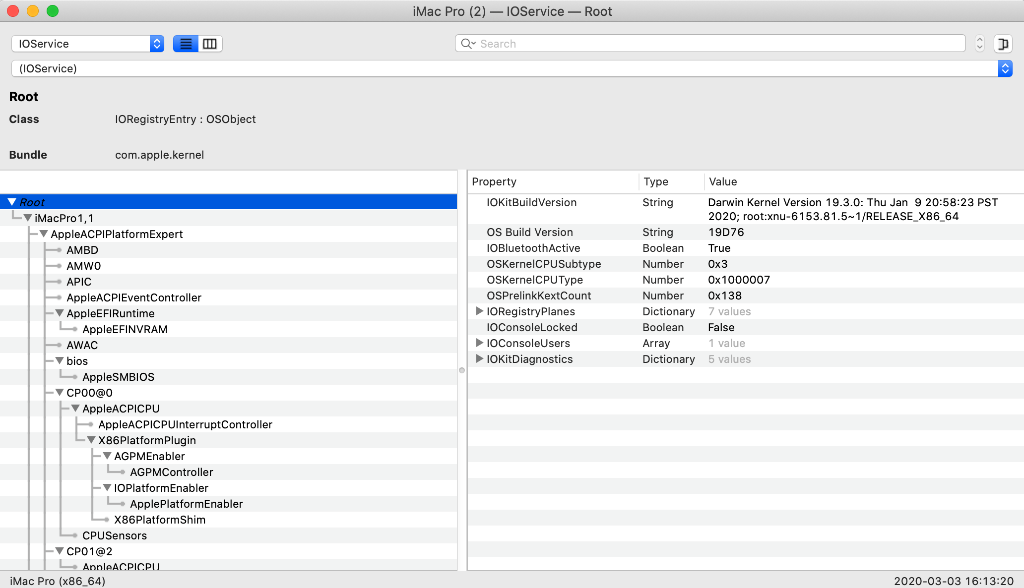

Tested your SSDT-RTC.aml and my rig didn't boot. Attached SSDT works fine and give me working RTC for booting and initialised AWAC.
SSDT-RTC.aml
SSDT-RTC.aml

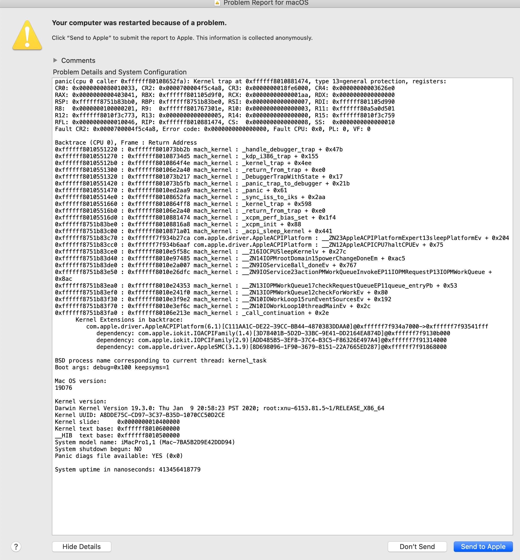

Hi @metacollin
Your modded bios 3003 is working fine overall and the only culprit I have is (compared with original bios and enabled AppleXcpmCfgLock, AppleXcpmExtraMsrs in OC) that wake after sleep gives me KP. With the original version of 3003 wake after sleep is working as it should.
Could we test a version where only MSR0xE2 is unlocked?
Edited by obus
The same kernel panic after wake from sleep. Mina from Apple :lol:. I do not use sleep at all and kep some time remained in this BIOS for test on oter posible issues

Now Intel Power Gadget show me the same Min frequency 0.9GHz
Windows boot - OK, sleep - OK, wake - OK, Intel Power Gadget - as usual

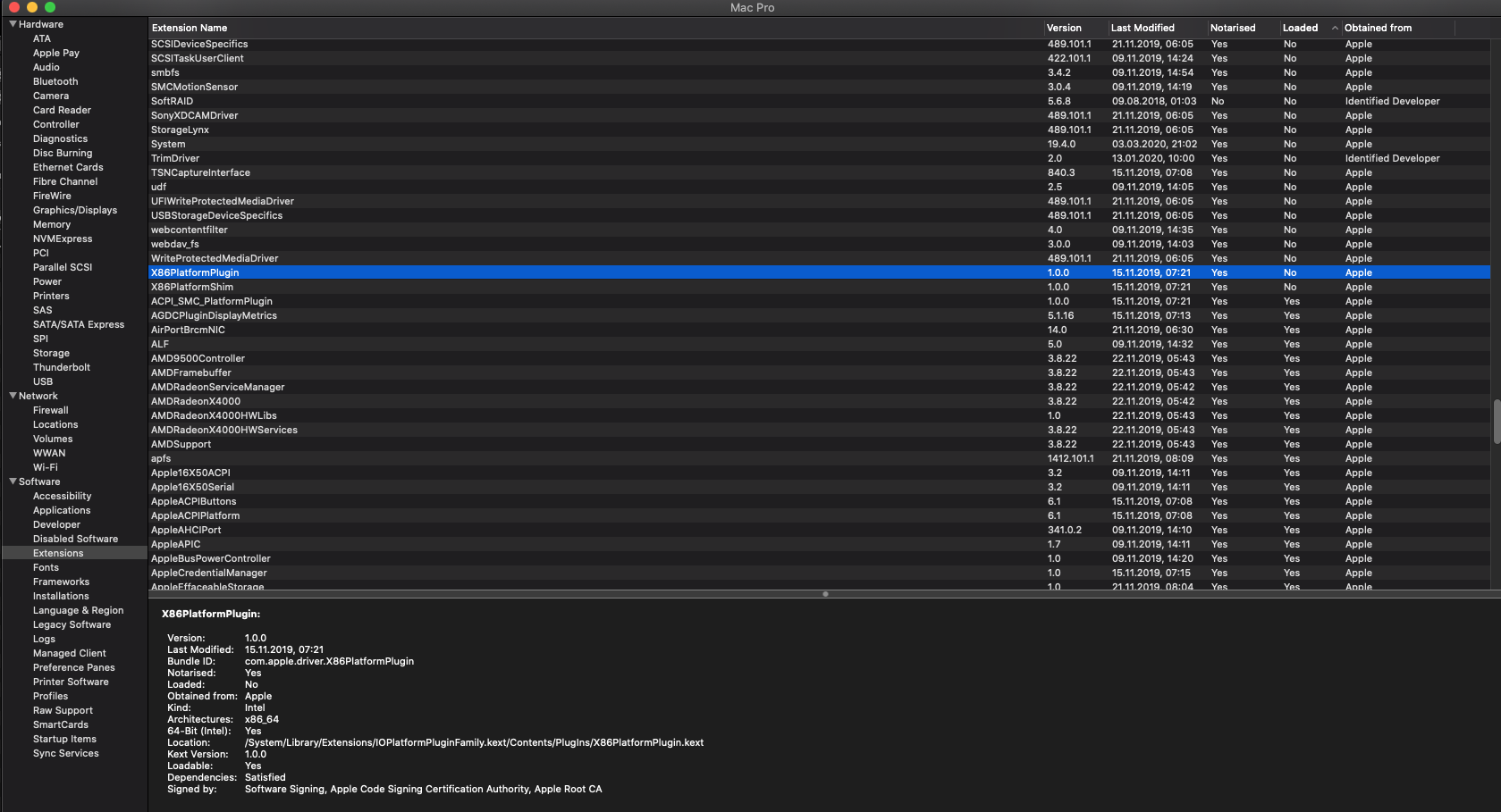

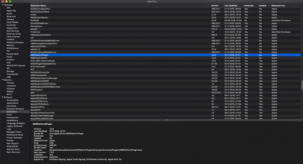

A-ha, somehow here is wrong
X86PlatformPlugin not loaded
Are you using old bootstrap_pach? If so XCPM is not working. With modded bios v.3003 in clover you don't need bootstrap_patch. Use the EFI I sent to you earlier and it will work perfect on 10.15.3 at least.
