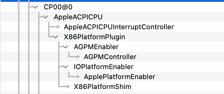

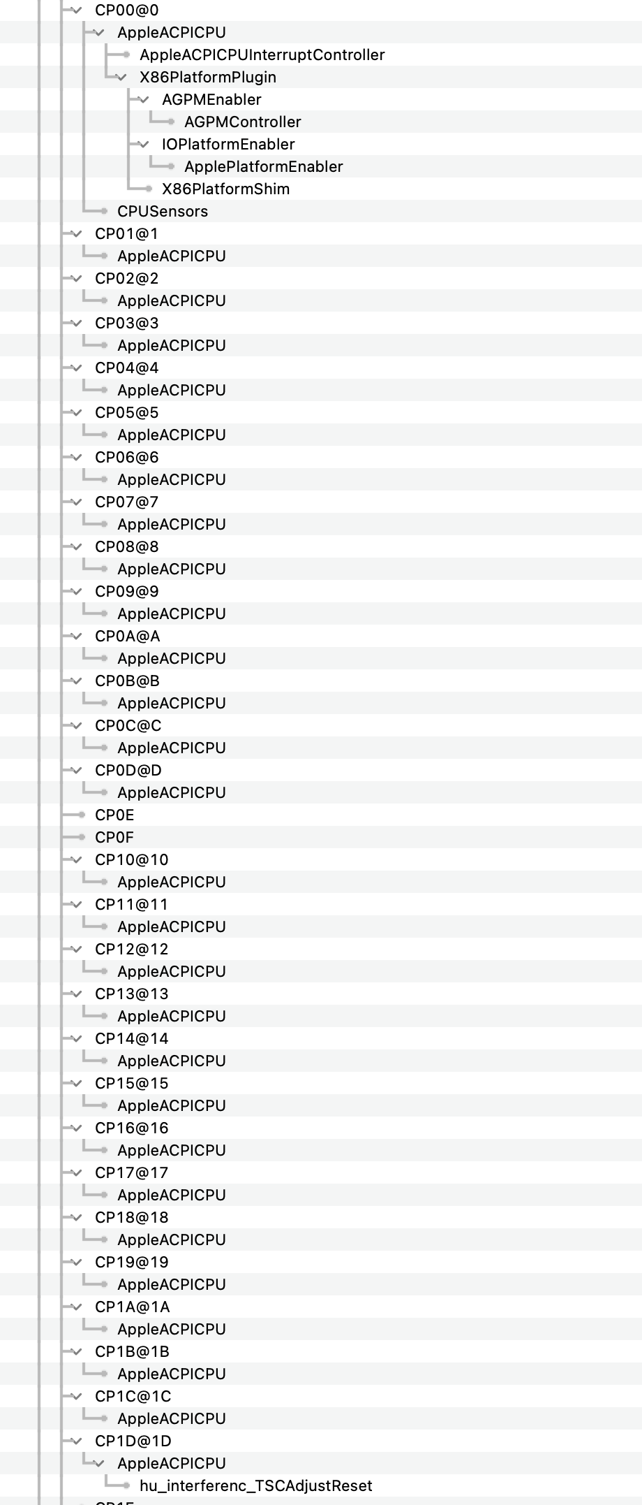

obus Posted February 17, 2021 Author Share Posted February 17, 2021 (edited) 8 hours ago, amjsez said: My CPU core is not showing properly with bios 1202?) This is perfectly ok as long as all 20 threads are showing up and you have working PM. Spoiler This is a screenshot from my rig: Spoiler Edited February 17, 2021 by obus Link to comment https://www.insanelymac.com/forum/topic/335193-help-installing-mojave-on-xeon-w-2175-and-asus-ws-c422-mobo/page/29/#findComment-2751335 Share on other sites More sharing options...

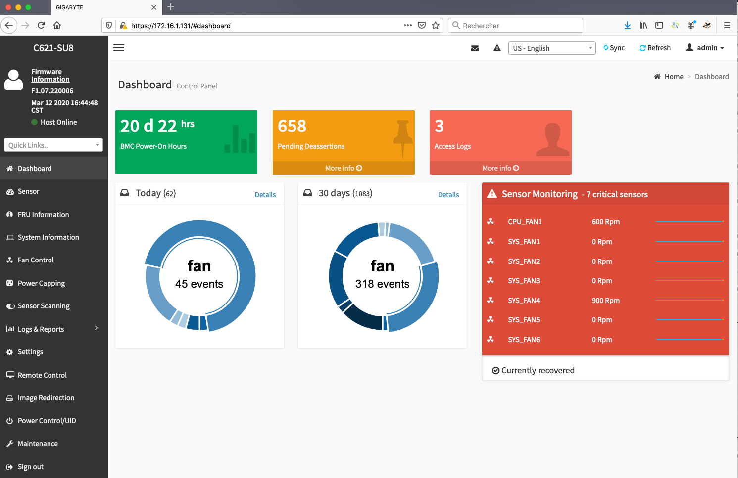

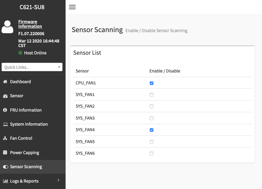

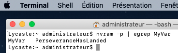

etorix Posted February 18, 2021 Share Posted February 18, 2021 Working NVRAM! The DSDT defines an object with _HID "PNP0C02" and _UID "PCHRESV" which is similar (and actually cleaner) than the one defined by the DSDT of the C246-WU4. So a SSDT-PMC according to Dortania's template provides NVRAM. I could have tried that from the very beginning… I still have to do Thunderbolt testing, fan control through the BMC, a bit of cleaning and update to OpenCore 0.6.6 but it seems that the Gigabyte C621-SU8 will make a good Hackintosh Pro. 2 Link to comment https://www.insanelymac.com/forum/topic/335193-help-installing-mojave-on-xeon-w-2175-and-asus-ws-c422-mobo/page/29/#findComment-2751435 Share on other sites More sharing options...

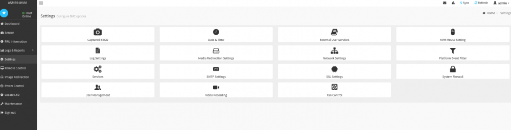

yapan4 Posted February 18, 2021 Share Posted February 18, 2021 (edited) 39 minutes ago, etorix said: fan control through the BMC This point can be interesting for ASUS WS C422Pro/SE users because this motherboard has cooling monitor and control via BMC chip Edited February 18, 2021 by yapan4 Link to comment https://www.insanelymac.com/forum/topic/335193-help-installing-mojave-on-xeon-w-2175-and-asus-ws-c422-mobo/page/29/#findComment-2751442 Share on other sites More sharing options...

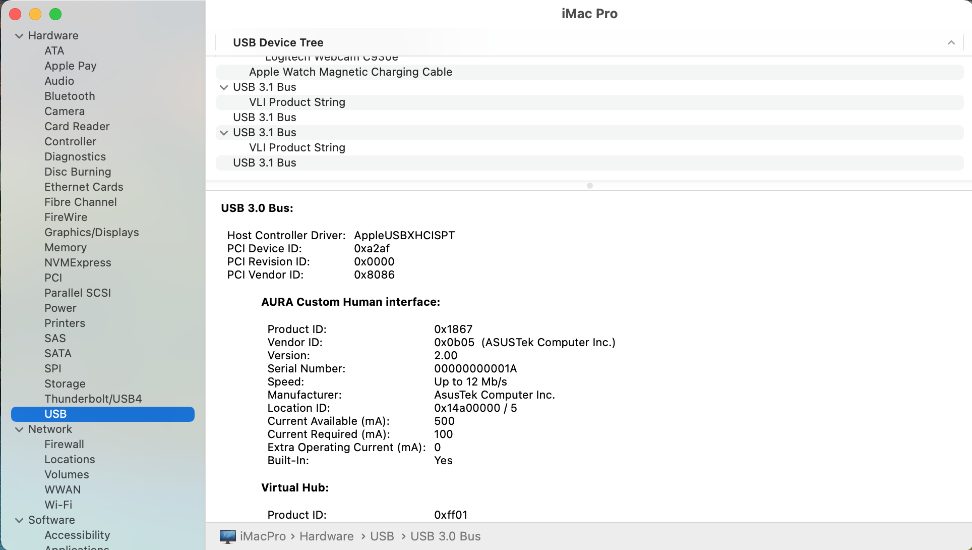

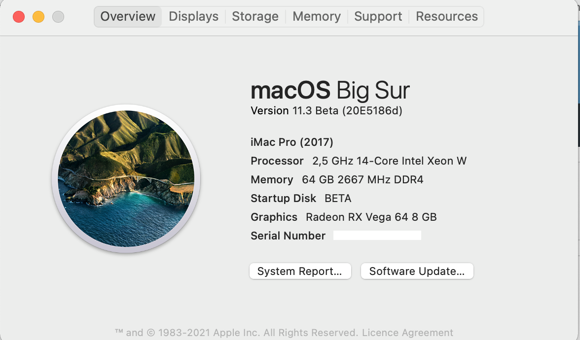

obus Posted February 21, 2021 Author Share Posted February 21, 2021 Updated to Big Sur 11.3 Beta 2 (20E5186d) without problems Spoiler 1 Link to comment https://www.insanelymac.com/forum/topic/335193-help-installing-mojave-on-xeon-w-2175-and-asus-ws-c422-mobo/page/29/#findComment-2751640 Share on other sites More sharing options...

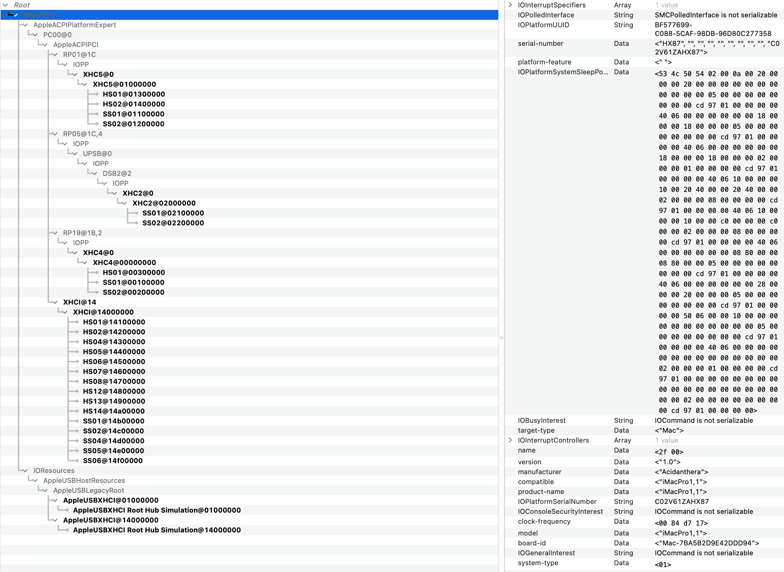

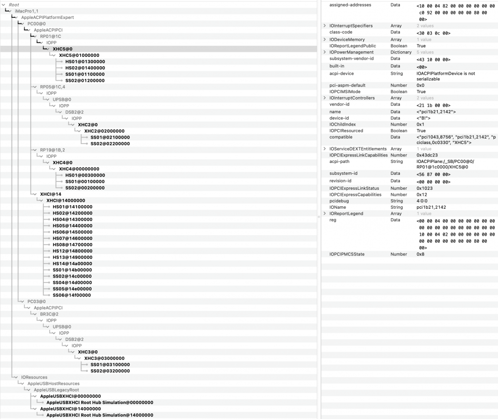

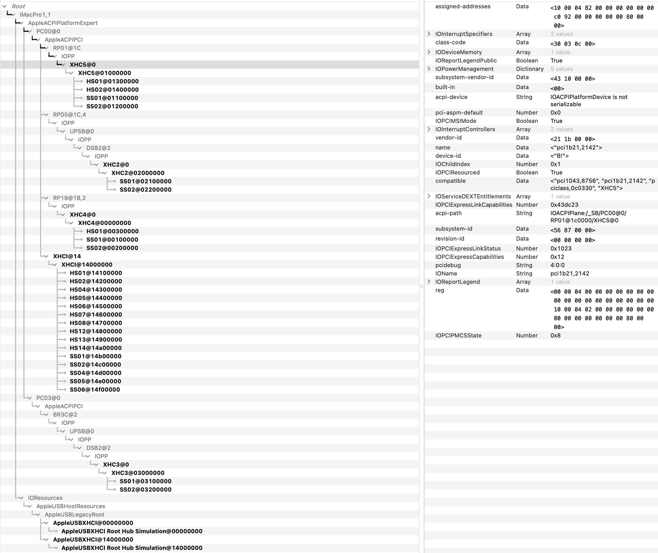

amjsez Posted February 23, 2021 Share Posted February 23, 2021 21 hours ago, obus said: Load this bios with the attached settings in the CMO - file. After that send me your ioreg. iMac Pro.ioreg Hi @obus, Pls see attached ioreg as requested. I had to enable Above 4G in the bios, other wise it would not boot. Thanks. iMac Pro.zip Link to comment https://www.insanelymac.com/forum/topic/335193-help-installing-mojave-on-xeon-w-2175-and-asus-ws-c422-mobo/page/29/#findComment-2751739 Share on other sites More sharing options...
obus Posted February 23, 2021 Author Share Posted February 23, 2021 7 minutes ago, amjsez said: Hi @obus, Pls see attached ioreg as requested. I had to enable Above 4G in the bios, other wise it would not boot. Thanks. iMac Pro.zip 3.21 MB · 1 download Yes I know. It's not possible to save that settings in the *.cmo file. I will have a look at your ioreg. Link to comment https://www.insanelymac.com/forum/topic/335193-help-installing-mojave-on-xeon-w-2175-and-asus-ws-c422-mobo/page/29/#findComment-2751740 Share on other sites More sharing options...

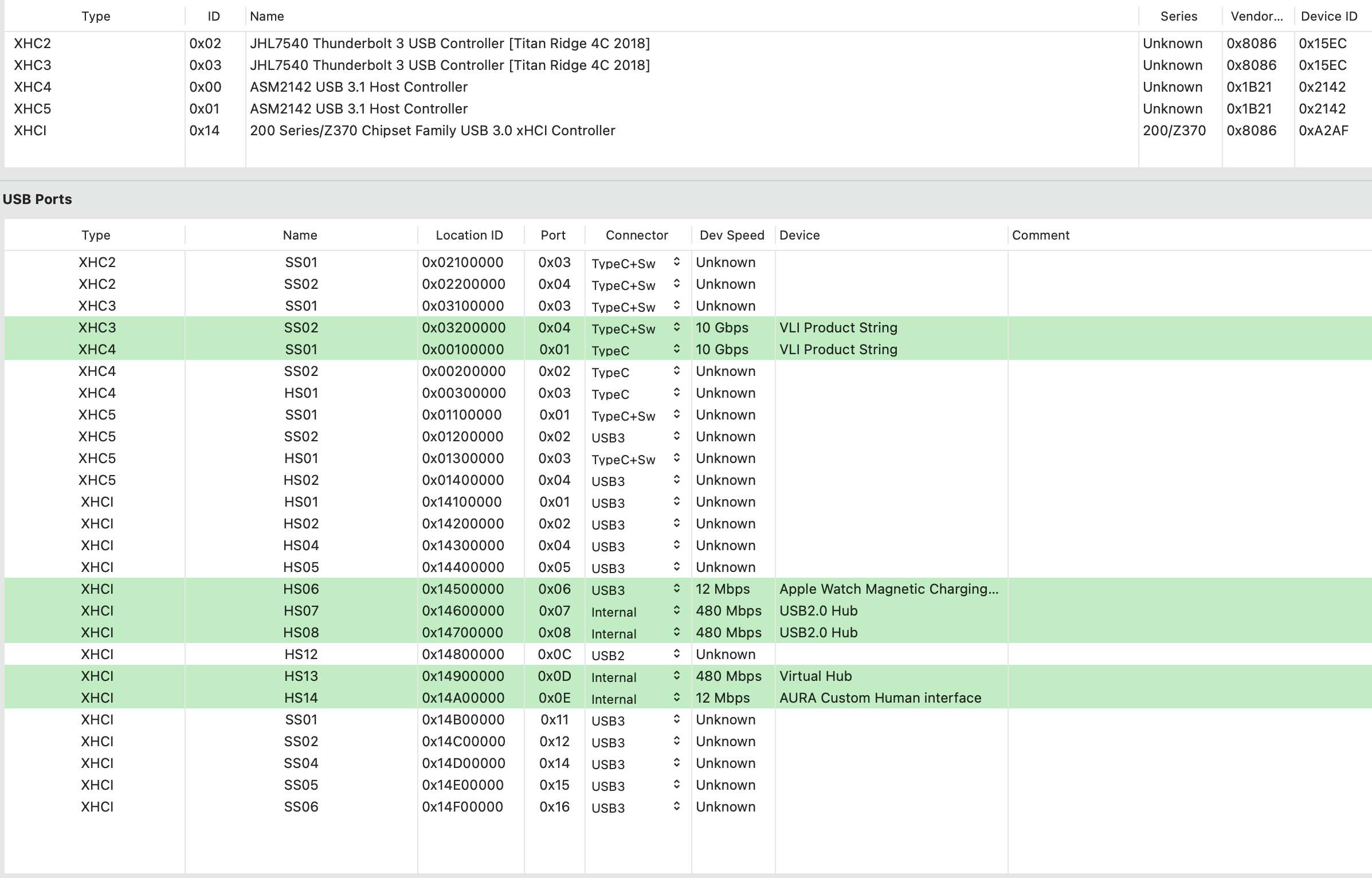

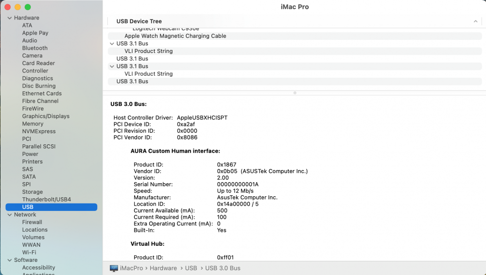

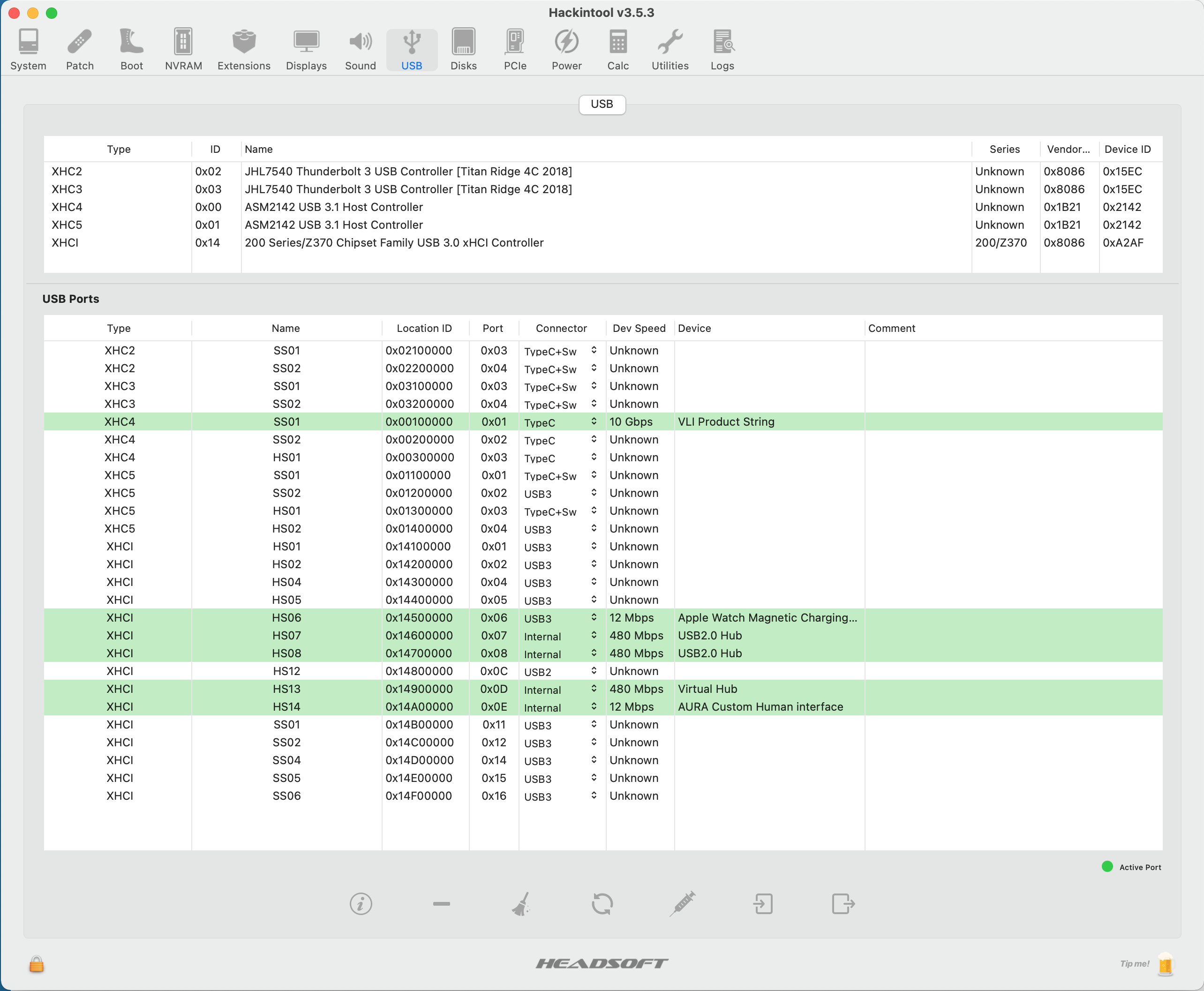

obus Posted February 23, 2021 Author Share Posted February 23, 2021 (edited) Everything is there as it should!!!!! You have 15 USB 3.0 port:s (XHCI) 2 thunderbolt 3/USB-C port:s (XHC2) and your rear and front ASM2142 USB-C respectively USB 3.1 port:s (XHC4 and XHC5). What is the Problem? Spoiler Edited February 23, 2021 by obus Link to comment https://www.insanelymac.com/forum/topic/335193-help-installing-mojave-on-xeon-w-2175-and-asus-ws-c422-mobo/page/29/#findComment-2751743 Share on other sites More sharing options...

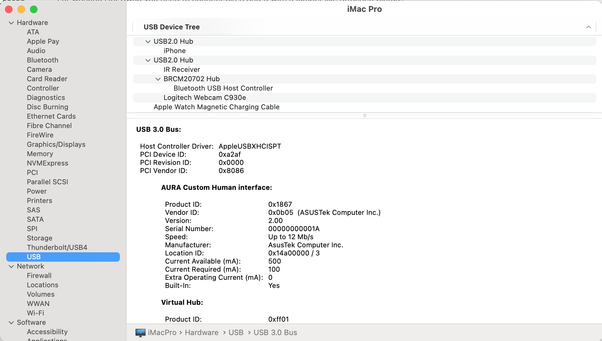

amjsez Posted February 24, 2021 Share Posted February 24, 2021 13 hours ago, obus said: Everything is there as it should!!!!! You have 15 USB 3.0 port:s (XHCI) 2 thunderbolt 3/USB-C port:s (XHC2) and your rear and front ASM2142 USB-C respectively USB 3.1 port:s (XHC4 and XHC5). What is the Problem? Hide contents Yes, the USB tree shows up and is completely as it should. But when USB-C drives, iPhone with USB-C to Lightning cable and the iPad with USB-C to lighting cable is plugged into the USB-C/Thunderbolt port it charges but nothing shows up on the USB tree and it is not detected by the system... Link to comment https://www.insanelymac.com/forum/topic/335193-help-installing-mojave-on-xeon-w-2175-and-asus-ws-c422-mobo/page/29/#findComment-2751771 Share on other sites More sharing options...
obus Posted February 24, 2021 Author Share Posted February 24, 2021 (edited) 10 hours ago, amjsez said: Yes, the USB tree shows up and is completely as it should. But when USB-C drives, iPhone with USB-C to Lightning cable and the iPad with USB-C to lighting cable is plugged into the USB-C/Thunderbolt port it charges but nothing shows up on the USB tree and it is not detected by the system... I have no USB-C to Lightning cable so I can't test that but if I put one of my external USB-C disk in one of my thunderbolt port:s and the other one in my ASM2142 port:s I have this result in About this Mac --> System Report --> USB. Booth disks shows up as USB 3.1. The same in Hackintool,both disk:s shows up with correct speed too. Is your Titan Ridge card flashed? If so I think this could be the culprit. I've read somewhere that all devices is not showing up with flashed cards depending on which firmware you flashed. You need to investigate that a little bit further. Is your iPhone showing up if you connect it to your ASM2142 port with a lightning cable? If so it must have to be something with your flashed Titan Ridge firmware. (IPhone show up as a USB 3.0 device on the USB 3.0 bus even if it's connected to a thunderbolt 3 port on a original Mac.) Spoiler Edited February 24, 2021 by obus Link to comment https://www.insanelymac.com/forum/topic/335193-help-installing-mojave-on-xeon-w-2175-and-asus-ws-c422-mobo/page/29/#findComment-2751786 Share on other sites More sharing options...

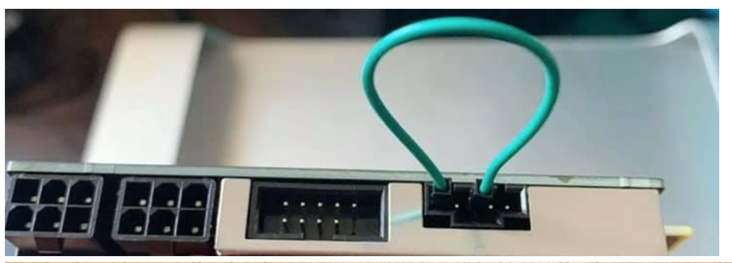

obus Posted February 24, 2021 Author Share Posted February 24, 2021 (edited) For working Hot Swap you need to connect pin 3 and 5 with a jumper like attached picture. For working USB you need to connect your Titan Ridge card to the internal USB 2.0 or 3.0. Spoiler Spoiler This is how my iPhone 12 (connected with a borrowed lighting cable) is showing up with my Titan Ridge card connected to the internal USB 2.0 port. If I connect my phone to ASM2142 USB-C port (front) it will show up exactly the same way on the USB 2.0 hub. Edited February 24, 2021 by obus Link to comment https://www.insanelymac.com/forum/topic/335193-help-installing-mojave-on-xeon-w-2175-and-asus-ws-c422-mobo/page/29/#findComment-2751795 Share on other sites More sharing options...

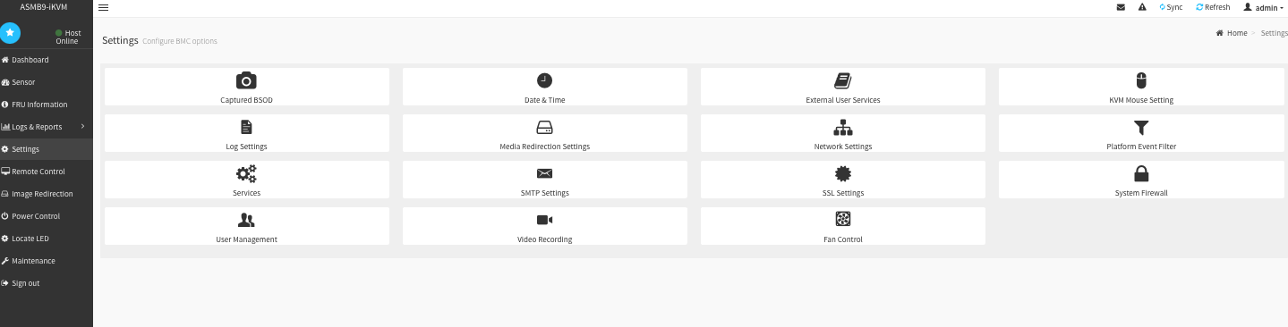

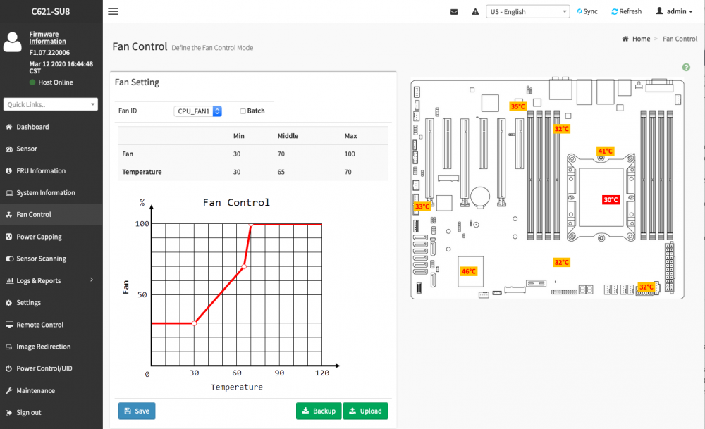

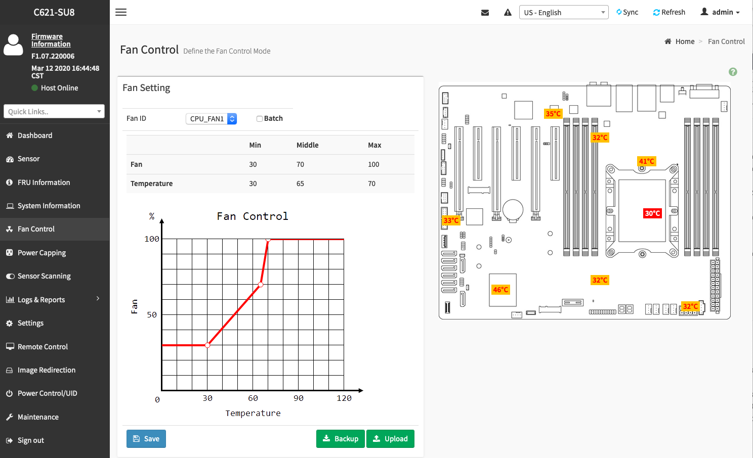

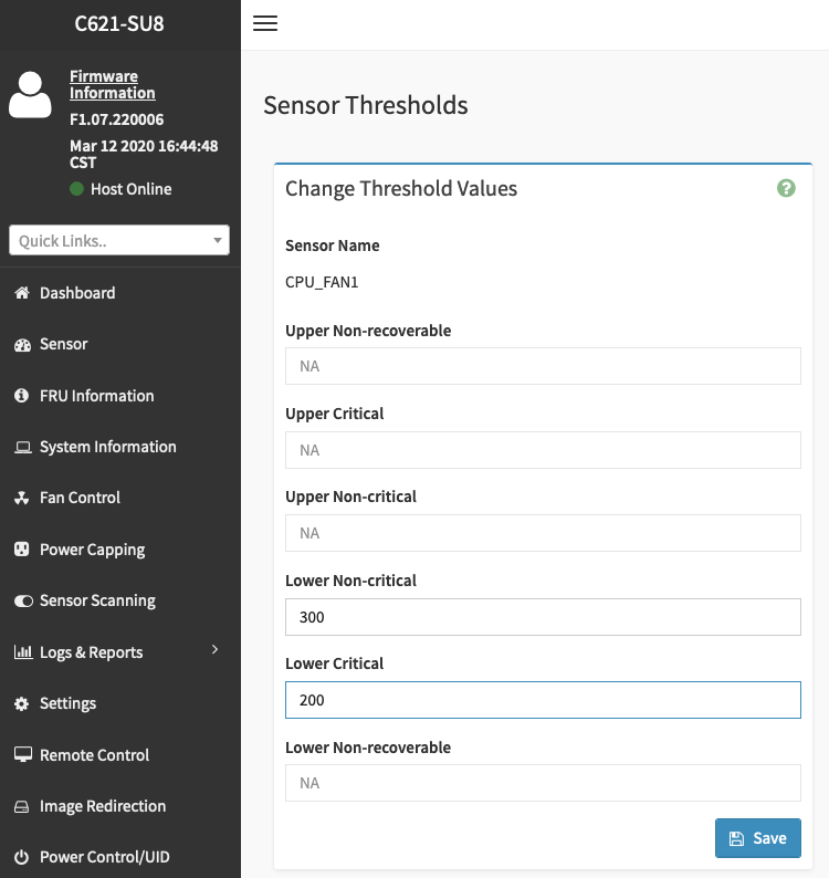

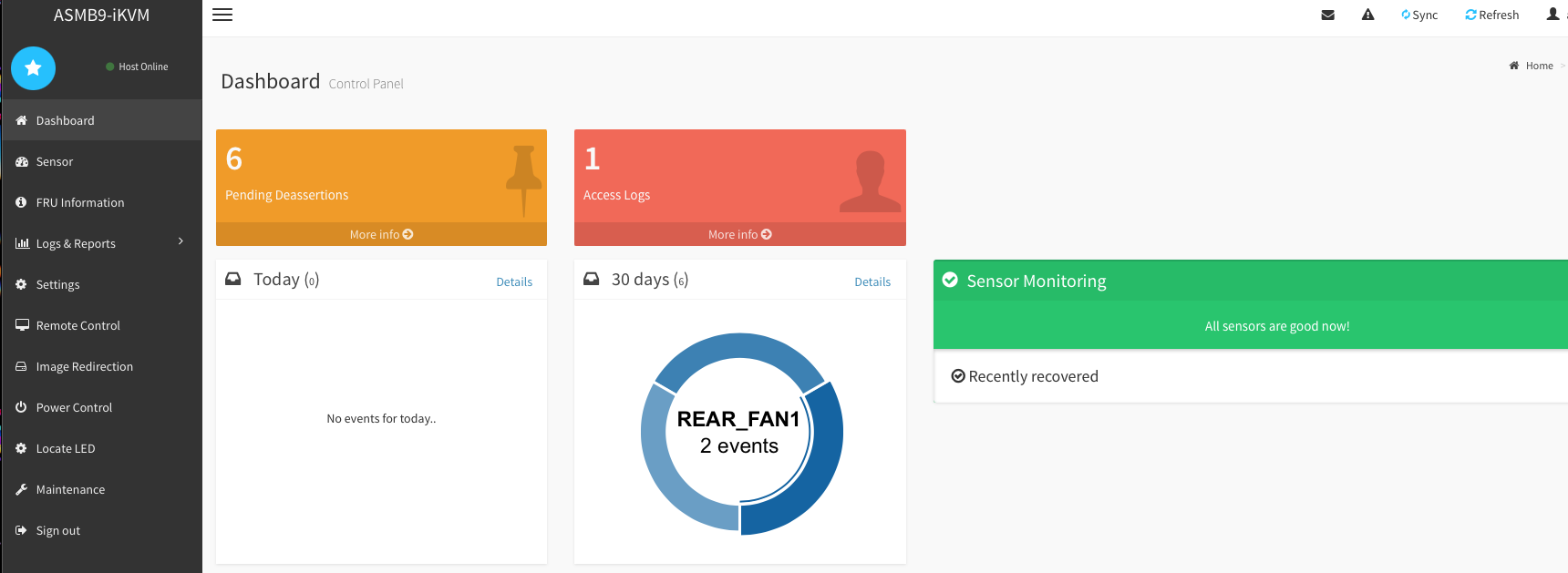

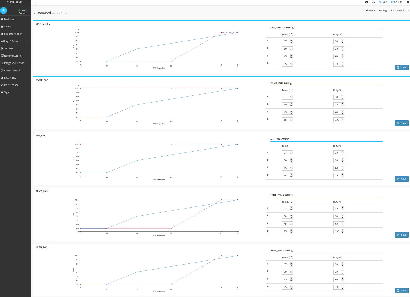

etorix Posted February 24, 2021 Share Posted February 24, 2021 On 2/18/2021 at 11:25 PM, yapan4 said: This point can be interesting for ASUS WS C422Pro/SE users because this motherboard has cooling monitor and control via BMC chip Sorry for the late reply. The last few days have been frustrating: Although I can set the boot drive or create persisting entries in NVRAM, I still cannot run an OS X installer or updater. In swiching to OpenCore 0.6.6 I used another USB stick which had a Mojave installer and found that, contrary to Catalina, I could boot this one and get to the installer GUI—but then it would fail after the reboot. The issue seems to be in the way OS X installers operate rather than with my settings. As for fan control it was both very simple, and also frustrating. Very simple: It's all in the GUI. Frustrating: It's all in the GUI—and there is not much! Making matter worse Gigabyte's excuse for a documentation is a mere string of screenshots without any explanation. You actually have to plug the BMC to a LAN and power it up to learn how you should have wired the fans in your case… What fun! I have already set up IMPI fan control for my NAS (TrueNAS Core), based on Supermicro (server) motherboard. A fan profile can be selected from the BMC web GUI and customisation is done through the command line using ipmitool on the NAS console or ipmiutil for remote administration. It is important to adjust the BMC settings because defaults thresholds are meant for server fans, so the lower thresholds are above the usual operating range of (quieter) consumer fans: If a dynamic profile is used but suitable thresholds are not set for the fans, the BMC will slow down the fans, sense they are spinning at a few hundred RPMs, consider that the fans are stalling (below about 1000 RPM is a critical failure for a typical 4-5000 RPM server fan!) and immediately try to wake them up by pushing to the maximum, detect a low temperature and… slow down the fans… The result is pulsating fan noise: WHOOOSH! Whooshhhh… WHOOOSH! Whooshhh… Here is what a custom setting looks like on a Supermicro A2SDi-H-TF: root@NASflash[~]# ipmitool sensor list all | egrep FAN FAN1 | 600.000 | RPM | ok | 100.000 | 200.000 | 300.000 | 25300.000 | 25400.000 | 25500.000 FAN2 | 500.000 | RPM | ok | 100.000 | 200.000 | 300.000 | 25300.000 | 25400.000 | 25500.000 FAN3 | 500.000 | RPM | ok | 100.000 | 200.000 | 300.000 | 25300.000 | 25400.000 | 25500.000 FANA | 1500.000 | RPM | ok | 300.000 | 500.000 | 700.000 | 25300.000 | 25400.000 | 25500.000 NAME | current value | unit | condition | lnr (lower non-recoverable) | lc (lower critical) | lnc (lower non-critical) | unc (upper non-critical) | uc (upper critical) | unr (upper non-recoverable) Upper values are actually not set because these are of little use in my case; lower values are custom. Intake fans FAN2, FAN3 are Noctua NF-A9 PWM with a lower spinning rate of 400 RPM +/-20% so lower non-critical is set below the operating range to prevent any false alarm, the other lower thresholds are set accordingly. This is done and set with just one command (per fan): # ipmitool sensor thresh FAN2 lower 100 200 300 ... # ipmitool bmc reset warm In the same manner as "lower lnr lc lnc", upper thresholds would be set with "ipmitool sensor thresh FAN# unc uc unr". The changes are permanent but take effect only after a BMC restart—which can be done on the command line without resetting the whole computer. And on the BMC web interface, fan mode is set under Configuration, from a fixed list of four uneditable profiles: Here it is set to Full Speed rather than Standard or Optimal because speed control is actually done through a very fine PERL script running in the background which uses ipmitool to pool CPU and HDD temperatures and adjust fan duty level per motherboard zone as required. This is very effective and can be adjusted to any choice of fans or use of the motherboard connectors (my build is actually the reverse of Supermicro default: CPU is on FANA and chassis fans for HDD on FAN1..3). Turning to the Hackintosh, Brew provides bottles for "impitool" and "ipmiutil" but there is no available driver for a local BMC; both programs are meant to be used over a network and are actually two different ports of UNIX impiutil. I picked ipmitool. Despite being the same Aspeed 2500 BMC as on the Supermicro board, the C621-SU8 is a wholly different experience. $ brew install ipmitool $ ipmitool -I lan -H 172.16.1.131 -U admin -P admin chassis power status Get Session Challenge command failed: Invalid data field in request Error: Unable to establish LAN session Error: Unable to establish IPMI v1.5 / RMCP session $ ipmitool -I lanplus -H 172.16.1.131 -U admin -P admin chassis power status Chassis Power is on $ ipmitool -I lanplus -H 172.16.1.131 -U admin -P admin sensor list | egrep FAN CPU_FAN1 | 600.000 | RPM | ok | na | 800.000 | 1200.000 | na | na | na SYS_FAN1 | na | | na | na | 800.000 | 1200.000 | na | na | na SYS_FAN2 | 0.000 | RPM | ok | na | 800.000 | 1200.000 | na | na | na SYS_FAN3 | 0.000 | RPM | ok | na | 800.000 | 1200.000 | na | na | na SYS_FAN4 | 900.000 | RPM | ok | na | 800.000 | 1200.000 | na | na | na SYS_FAN5 | 0.000 | RPM | ok | na | 800.000 | 1200.000 | na | na | na SYS_FAN6 | 0.000 | RPM | ok | na | 800.000 | 1200.000 | na | na | na So "lanplus" is the right interface— and something is to be done sooner than later about the default user/password! The Noctua NH-U12S DX3647 CPU cooler is reported OK although the defaults settings would qualify its normal operation as "critical failure" and many thresholds are simply not implemented. $ ipmitool -I lanplus -H 172.16.1.131 -U admin -P admin sensor thresh CPU_FAN 100 200 300 Valid threshold '100' for sensor 'CPU_FAN' not specified! $ ipmitool -I lanplus -H 172.16.1.131 -U admin -P admin sensor list | egrep CPU_FAN CPU_FAN1 | 600.000 | RPM | ok | na | 800.000 | 1200.000 | na | na | na $ ipmitool -I lanplus -H 172.16.1.131 -U admin -P admin bmc reset warm Sent warm reset command to MC ... $ ipmitool -I lanplus -H 172.16.1.131 -U admin -P admin sensor list | egrep CPU_FAN CPU_FAN1 | 600.000 | RPM | ok | na | 800.000 | 1200.000 | na | na | na Thresholds cannot be adjusted. Script control is not likely to succeed here, even with a crossed cable from the BMC LAN to one i210 LAN port to avoid going through a switch or router. This implementation is meant to be administered from the web GUI. "Sensor Scanning" to disable reporting. From the overview "Sensor", double clicking on a sensor brings to another screen, from where the thresholds can eventually be adjusted: This clears the red "Critical" flag. But these changes are lost if the computer is unplugged! So the reporting of sensor events is essentially useless because it can never be cleared of fallacious errors. The only setting which does persist over a loss of power is a customised 3-point fan curve under "Fan Control". The red temperature on the right indicates which sensor is used to adjust the fan. This is obvious for the CPU fan, not so much for SYS_FAN1 to SYS_FAN6… (1: Rear Right. 2: CPU MOS 3: North Side. 4: Near CPU Vccin (RAM) 5: BMC 6: PCH Too bad for the seventh temperature sensor in the bottom, which screams into the void.) There is apparently no way to assign another temperature sensor to a given fan port in the GUI, this has to be done through cabling. So setting fan control was quite short in my case, and could have been very, very short if Gigabyte had bothered to pay a technical writer to document what is actually implemented… I couldn't even find something about the BMC interface in the manual for the WS C422 Pro/SE so I have absolutely no idea what ASUS has devised and, well, it seems that Gigabyte's documentation is not even the worst out there. I hope the above can help as a starting point if you have issues. 1 Link to comment https://www.insanelymac.com/forum/topic/335193-help-installing-mojave-on-xeon-w-2175-and-asus-ws-c422-mobo/page/29/#findComment-2751798 Share on other sites More sharing options...
yapan4 Posted February 25, 2021 Share Posted February 25, 2021 (edited) On 2/24/2021 at 6:55 PM, etorix said: Sorry for the late reply. The last few days have been frustrating: Although I can set the boot drive or create persisting entries in NVRAM, I still cannot run an OS X installer or updater. In swiching to OpenCore 0.6.6 I used another USB stick which had a Mojave installer and found that, contrary to Catalina, I could boot this one and get to the installer GUI—but then it would fail after the reboot. The issue seems to be in the way OS X installers operate rather than with my settings. You can try to clean NVRAM after each restart, but you've probably already tried it. I'm sure you'll find a solution. Thank you for sharing your experience about IPMI. ASUS has similar capabilities and similar GUI. I do not use the command line, but if necessary I will use your tips from this post. Thank you. I will note that the first versions of BMC firmware were very buggy and looked raw. Recent releases have significantly improved the situation, but there are still minor ones that have to be tolerated. Two little questions to @all 1) How to enable PMBus monitoring for the power supply on ASUS WS C422 Pro/SE or similar motherboards? 2) Could something motivate our developers to write a FakeSMC or VirtualSMC plugin for monitoring via BMC chip (something like BMCMonitor.kext)? Spoiler Spoiler Spoiler Spoiler Edited February 25, 2021 by yapan4 Link to comment https://www.insanelymac.com/forum/topic/335193-help-installing-mojave-on-xeon-w-2175-and-asus-ws-c422-mobo/page/29/#findComment-2751864 Share on other sites More sharing options...
etorix Posted February 25, 2021 Share Posted February 25, 2021 1 hour ago, yapan4 said: Thank you for sharing your experience about IPMI. ASUS has similar capabilities and similar GUI. I do not use the command line, but if necessary I will use your tips from this post. Thank you. You're welcome! It is a very similar GUI indeed, only with the fan curves in a different place and defined by four points instead of three. The command line has two issues. 1/ Because real macs do not have BMCs there is no Darwin driver, so commands have to go through the network. And it may be even more difficult to motivate developers to port the Linux openipmi driver to Darwin than to motivate developers to write a FakeSMC/VirtualSMC plugin. 2/ The command line provides a way to read fan speed or temperature through standardised commands (there are much more commands than the few I have illustrated). But setting fan duty is done by sending raw hexadecimal commands to the BMC; there is no standard here, it all depends on the manufacturer's implementation. Supermicro's implementation is known (at least to gurus…) and the script I use on my NAS is written using this knowledge for Supermicro X10/X11 boards. Seeing how crippled Gigabyte's implementation of the BMC feels compared to Supermicro's, I fear that significant work would be required to find out the hex sequences to control the fans, and then to rewrite the script accordingly. It may be easier to hackintosh a X11SRA-F or X11SRL-F… 1 Link to comment https://www.insanelymac.com/forum/topic/335193-help-installing-mojave-on-xeon-w-2175-and-asus-ws-c422-mobo/page/29/#findComment-2751866 Share on other sites More sharing options...

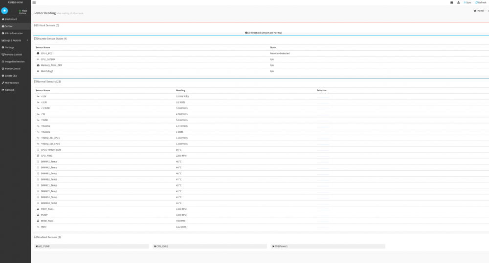

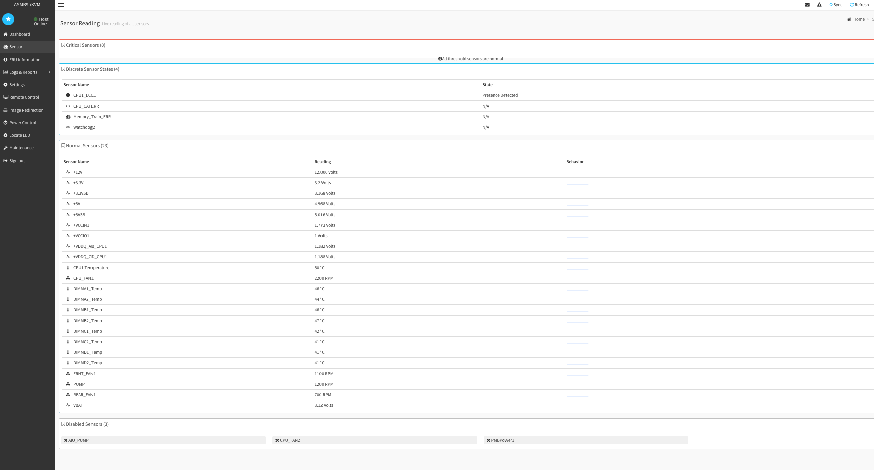

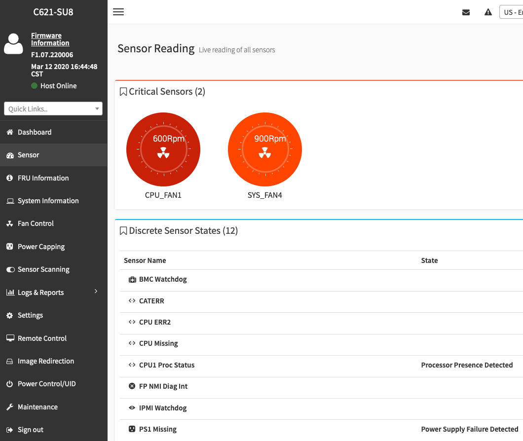

yapan4 Posted February 27, 2021 Share Posted February 27, 2021 (edited) @etorix I imagined it much easier because the BMC chip communicates through the LPC bus (just like the SMC chip). Maybe there are some thoughts what to do to make working PSU monitoring through PMbus. I bought two power supplies, both have a PMBus connector, both from Supermicro and PMBus monitoring do not work on both. Thank you. Edited February 27, 2021 by yapan4 Link to comment https://www.insanelymac.com/forum/topic/335193-help-installing-mojave-on-xeon-w-2175-and-asus-ws-c422-mobo/page/29/#findComment-2751948 Share on other sites More sharing options...
