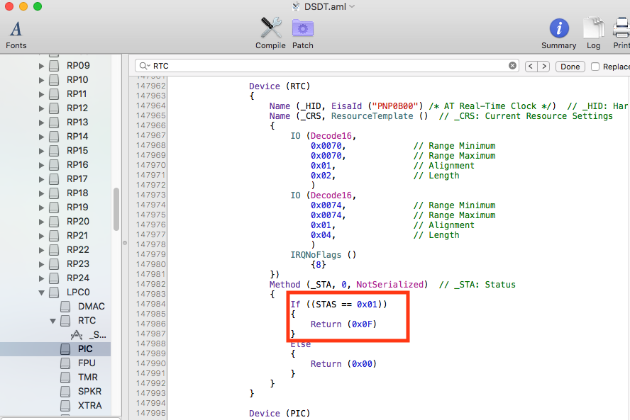

1 hour ago, hardcorehenry said:
Have you tried boot only with SSDT-AWAC.aml and without SSDT-RTC.aml? In your ACPI in RTC there is condition if STAS=1 that should triger RTC return 0x0F exactly what you trying add separately via SSDT-RTC.aml
Please check AWAC only .aml. if is correct then result negative, macos stoped in the same place

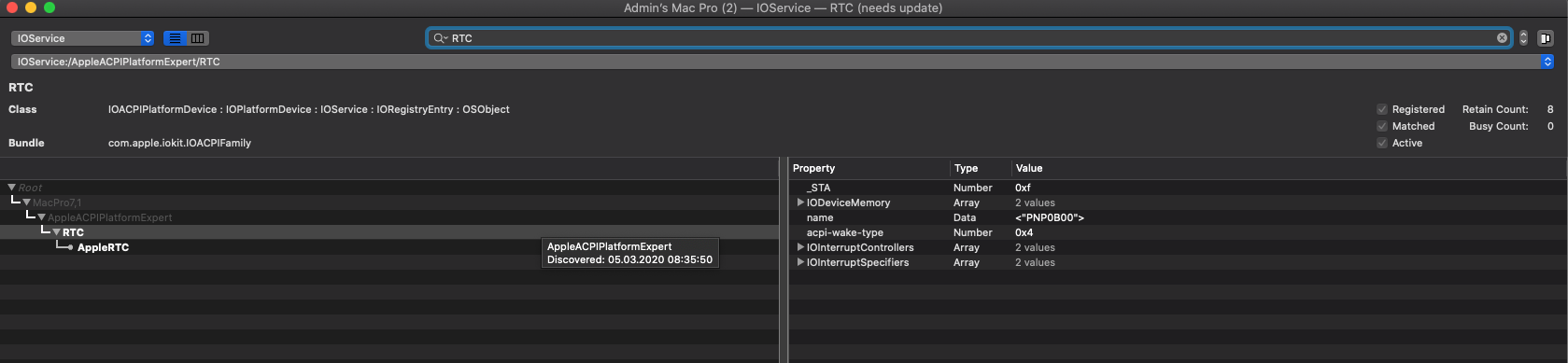

Now

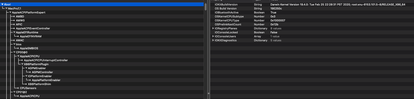

RTC:
AWAC: not found
I don't know what method is more suitable because a'm not expert. But now we have three alternative methods: RTC and RTC+AWAC from @lovest.fhd and AWAC only from @hardcorehenry.
Edited by yapan4

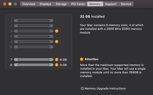

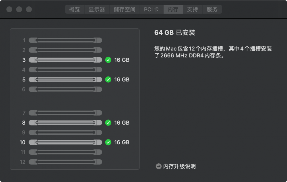

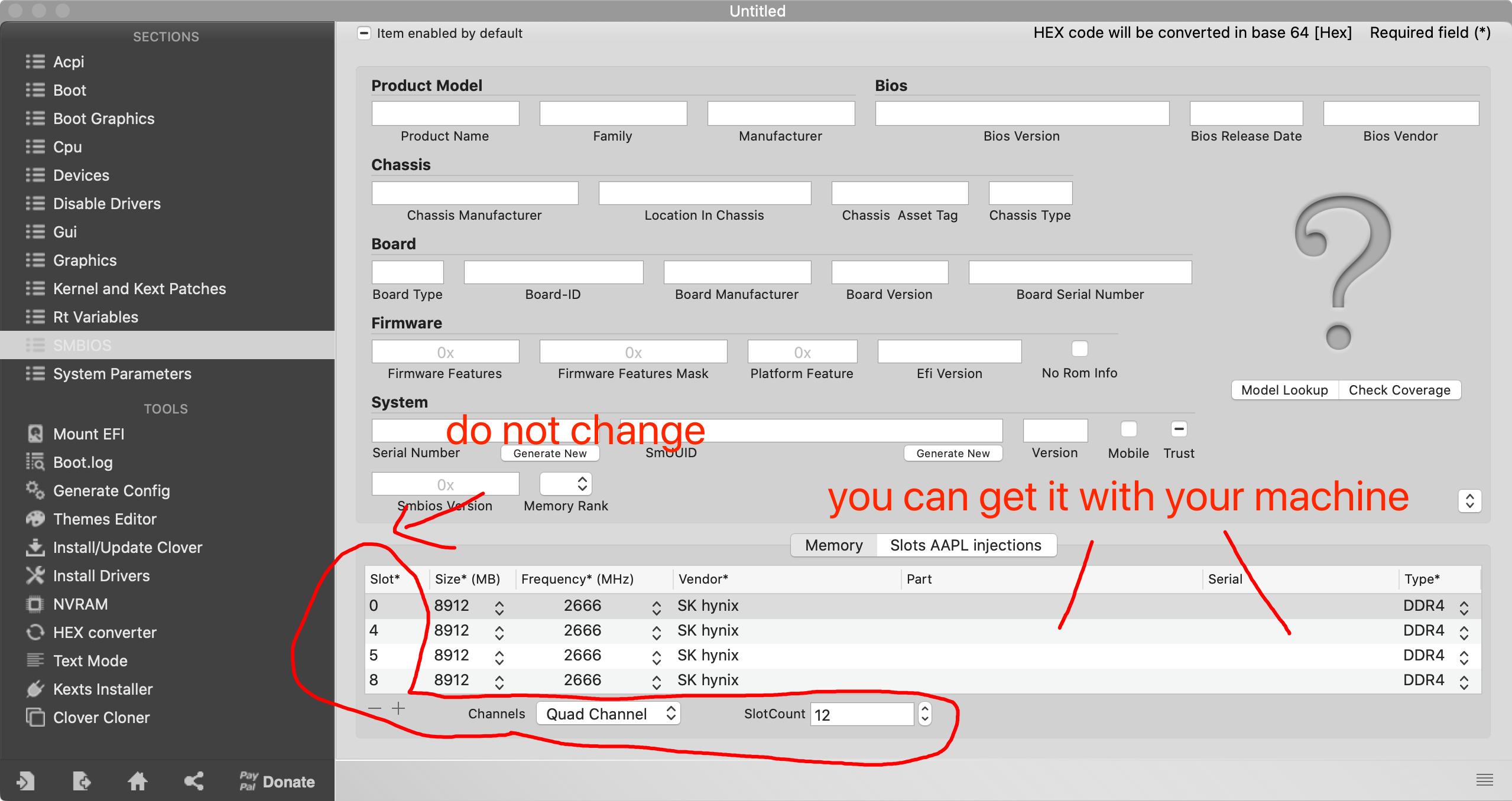

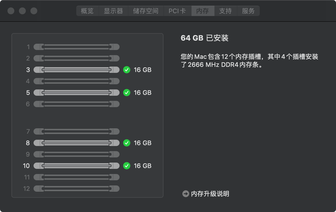

And one more question - Because you motherboard is similar to original macpro7,1, is memory shown correctly in About This Mac window?
Thank you.

_sta method is just a switch.
if you rename XSTA, this method will Invalid,and RTC work as "0xf"

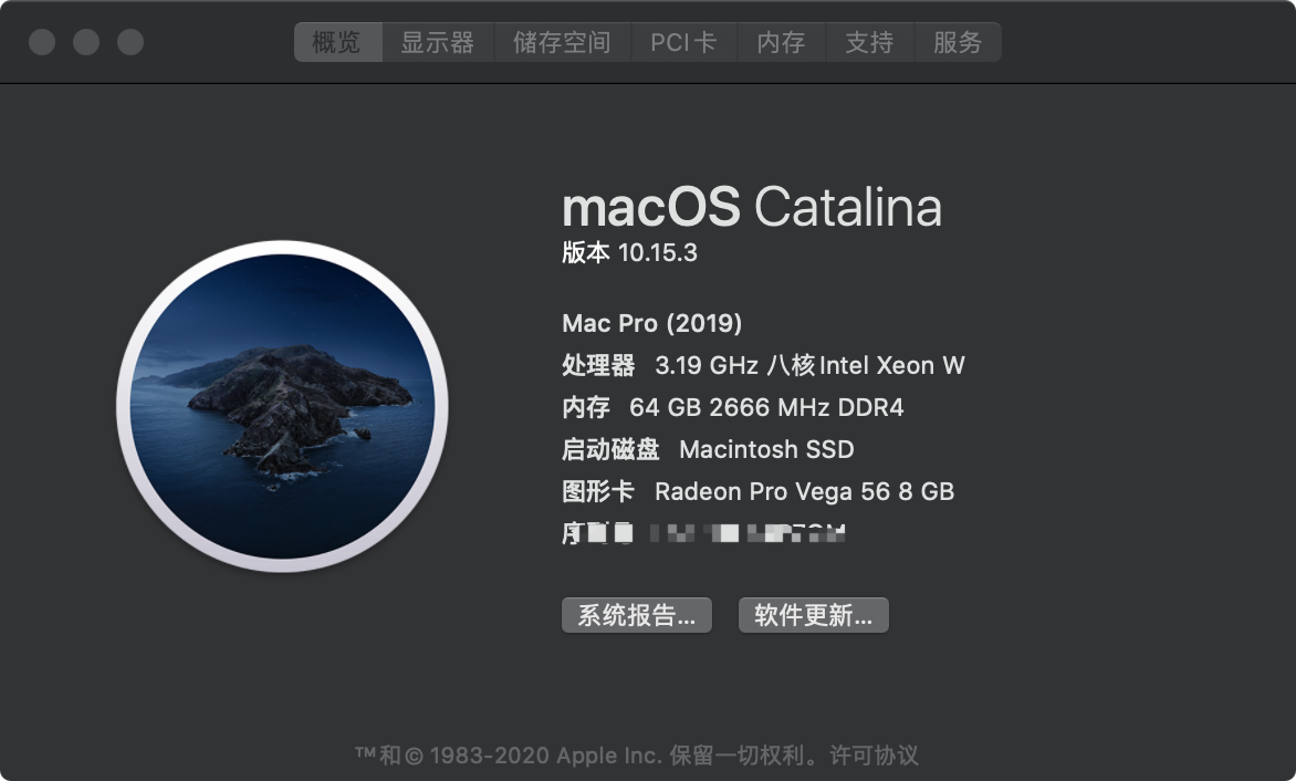

14 hours ago, yapan4 said:
Hi, @skyflying5
What is the behavior of macOS on your apple-native CPU? I mean kernel panic when waking up.
everything as usual when waking up
