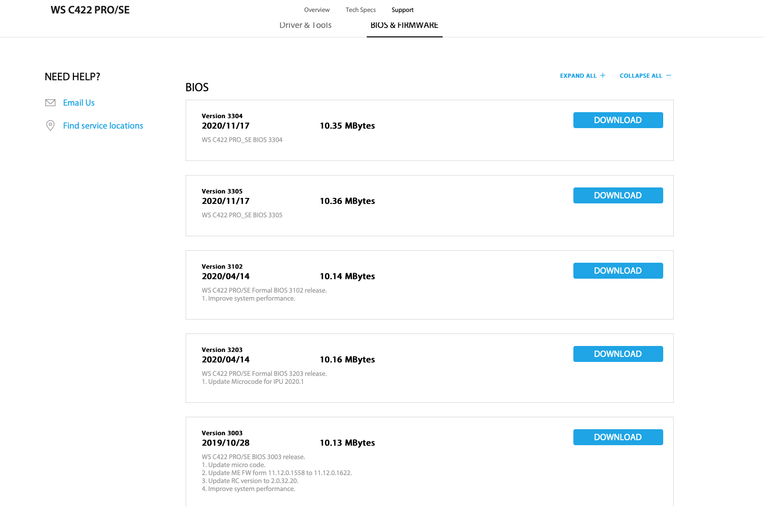

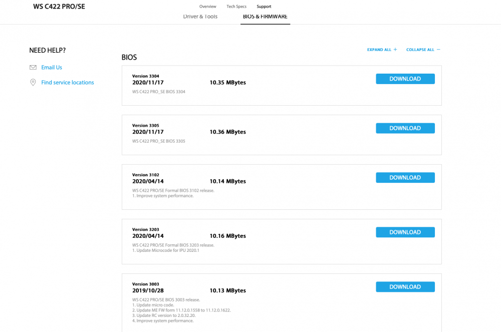

Hmm, something strange on the Asus download page - two versions of BIOS at the same time, v.3305 and v.3304???
I chose version 3305...
Spoiler
Edited by yapan4
  Hide contents
Funny!! Did 3305 work? Can you see any difference?
I did not test v.3304.
v.3305 work great.
I don't know what the difference is except the size.:)
Apparently we need to wait for some clarifications from ASUS.

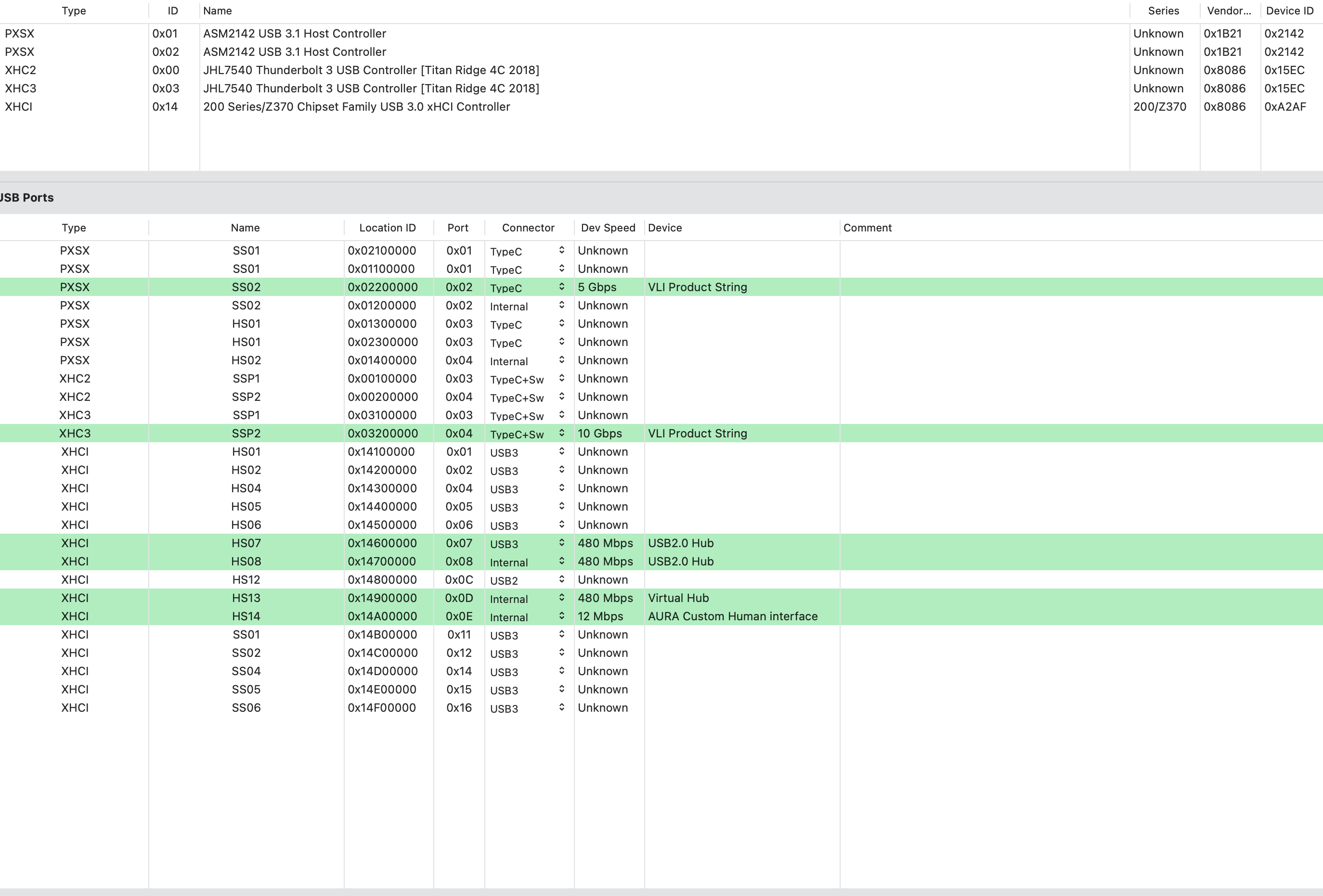

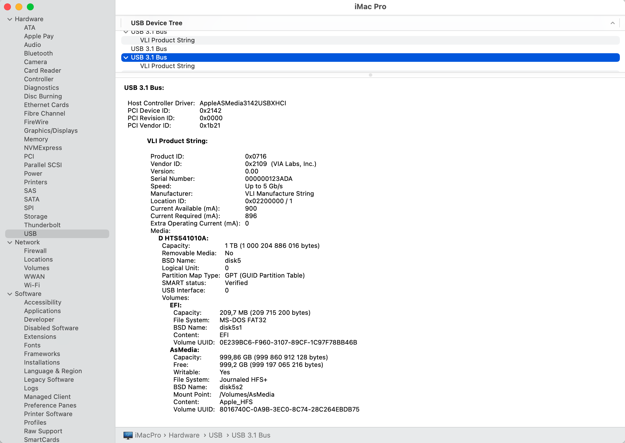

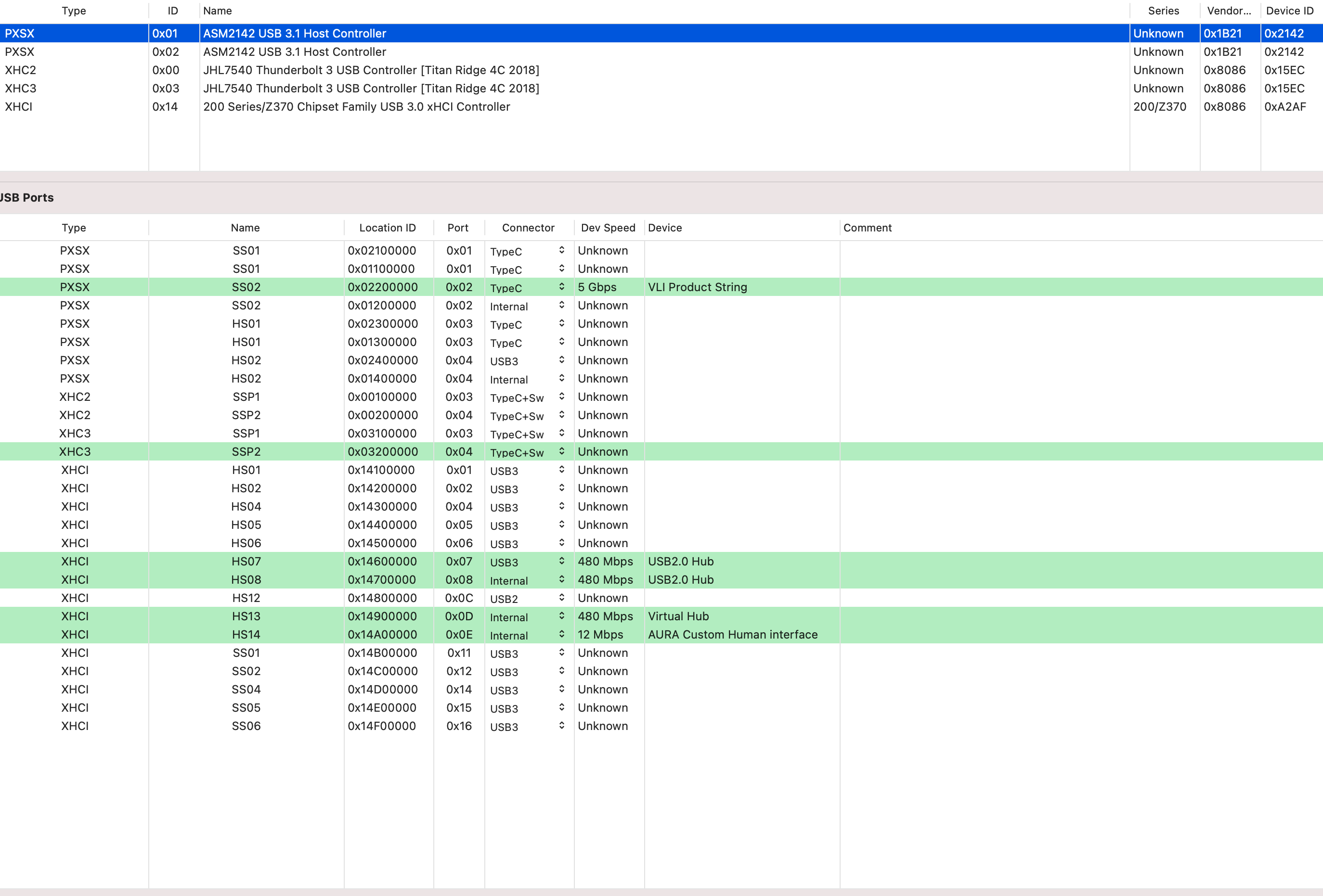

Both versions gives me huge problems with my ASM2142 USB 3.1 Controllers front and rear. Controller shows up but no ports and when they work they only show up with 5 Gbps.
Randomly I have the same problems with other tested bios versions so for the moment I use 1202 wich seems to be the most stable together with my two flashed Gigabyte Thunderbolt 3 Titan Ridge card.
This is a complete new problem starting with beta 6 of Big Sur. With Catalina everything worked and this problem with undiscovered ports never ever appears and the speed was always showing 10 Gbps.
Anybody experiencing the same problem?

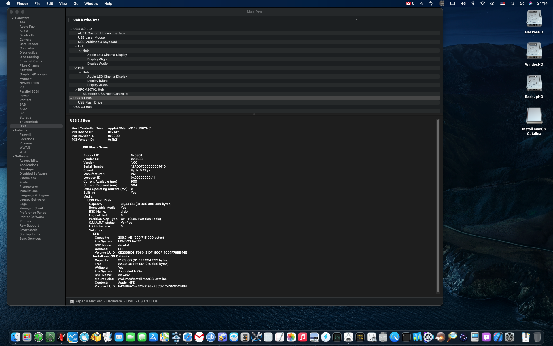

Clover r5127 and Big Sur 11.1b1, any patches or kexts for USB:
-front and rear USB type A works. I do not have currently any type C and 10Gb/s device for test
-Apple System Information correctly show both Asmedia ASM2142 controllers
-speed 5Gb/s
-Extra Operating Current (mA): 0
Spoiler
Spoiler

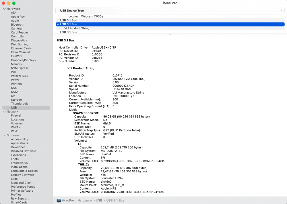

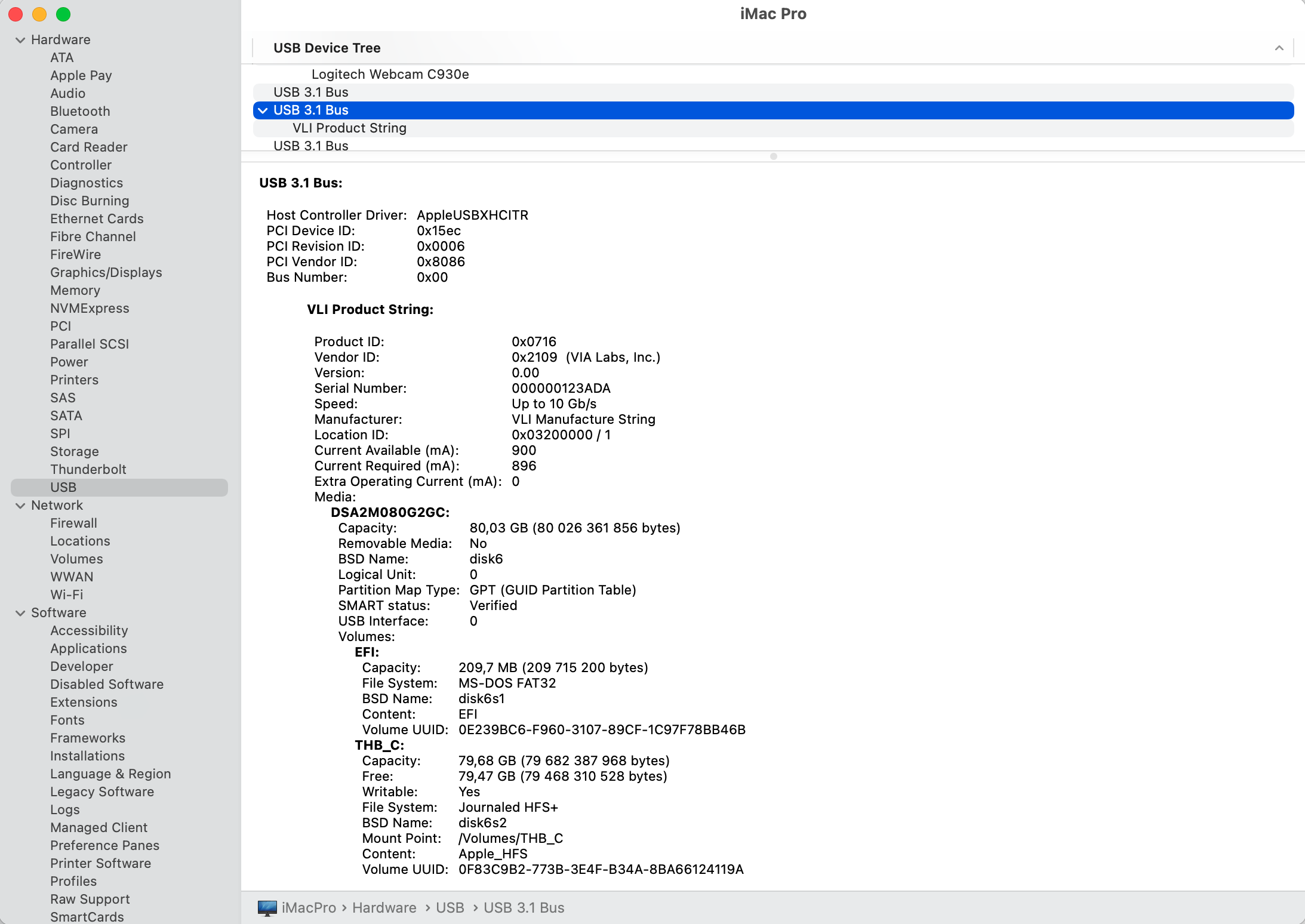

For my four Thunderbolt 3 ports XHC2 x2 and XHC3 x2 (two ports on each Titan Ridge card) USB 3.1 Gen 2 type C speed is reported correctly 10 Gbps. On my ASM2142 speed wrongly (both from front and rear ports) is reported to only 5 Gbps.
On Catalina 10.15.6 the speed both for Thunderbolt 3 and ASM2142 ports was reported correctly to 10 Gbps. So obviously something changed with Big Sur from beta 6.
This is not the worst problem for me with Big Sur. The worst problem is that the ports on the ASM2142 controller just randomly is discovered by the system. Sometimes I need three or four boots at a row to get all my controllers to showing up and connecting to my devices. This was working without any problems on Catalina 10.15.6.
Power is no problem. I have 900 mA on all my USB 3.1 Gen 2 type C ports. I have that on sleep and on shutdown if the device is connected before shut down. Sleep is working flawlessly if "wake for network access" is unchecked in Energy Saver.

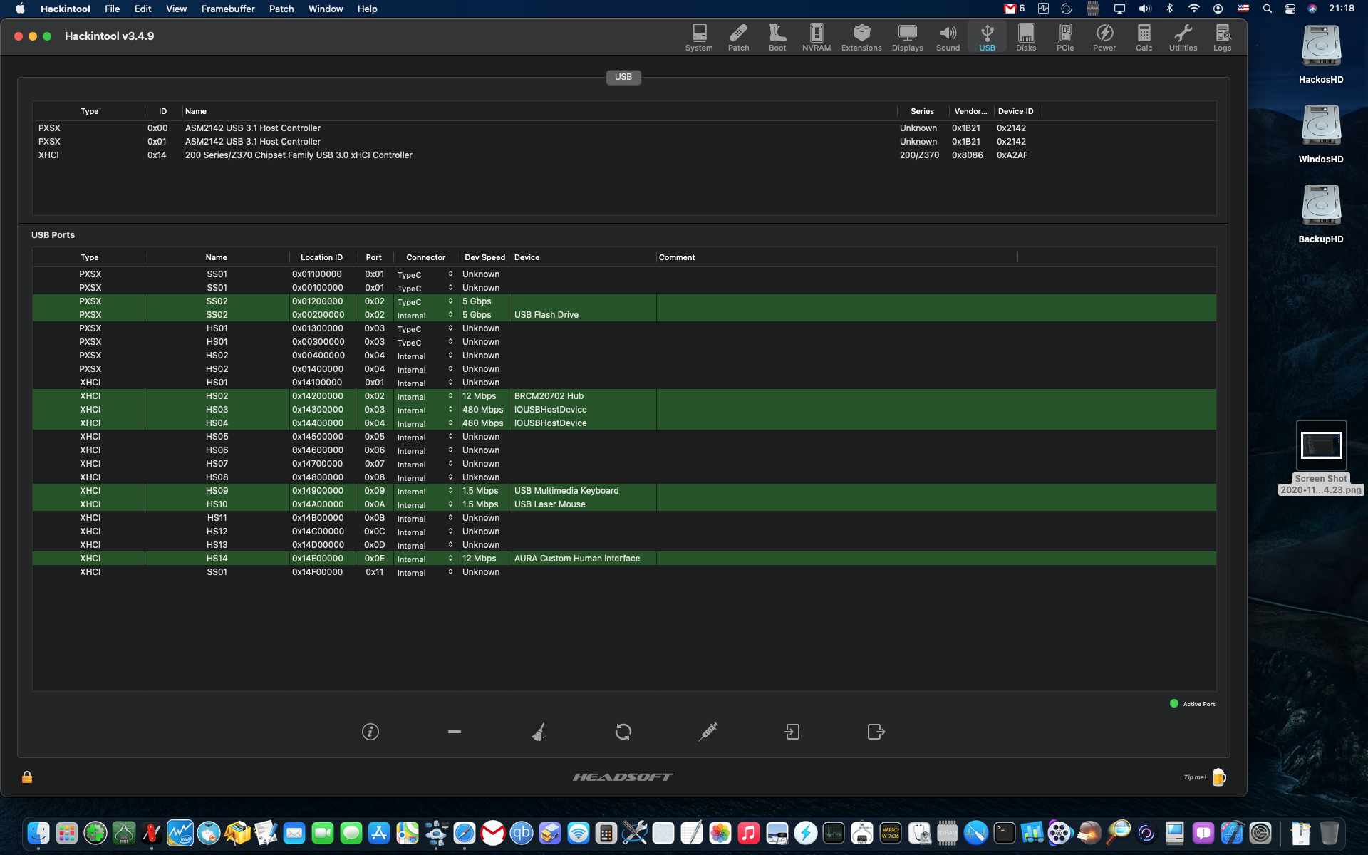

Hackintool:
Spoiler
1706168882_Screenshot2020-11-26at22_15_15.thumb.png.15f8b12fdc49625436de9f396d707b96.png
Power ASM2141:
Spoiler
405049893_Screenshot2020-11-26at22_27_52.thumb.png.ce8b84fb51fe2e523de2da21223f3643.png
Power THB Titan Ridge:
Spoiler
531228367_Screenshot2020-11-26at22_28_34.thumb.png.b21152e90229b9d5dbe16c14ed72e185.png

5 minutes ago, yapan4 said:
New (or not???) BIOS v.3301
I guess old, since the WS-C422-PRO-SE-ASUS-3301.CAP date is 04.September 2020.
Date of 3305 firmware, which is gone now from the download page, is 17.November 2020.
I agree. So the confusion with BIOSes continues.
P.S.  I tried version 3301, everything is fine and did not notice the difference. An updated version of IPMI firmware was also released at the same time. I also updated it, also all is well.
