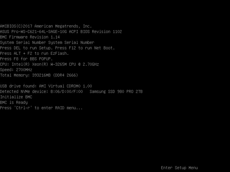

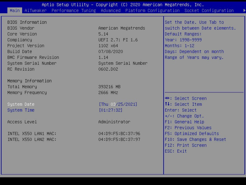

Balamut Posted March 23, 2021 Share Posted March 23, 2021 1102 but was doing the same in 1001 too. All working fine, panic in sleep is the issue Link to comment https://www.insanelymac.com/forum/topic/335193-help-installing-mojave-on-xeon-w-2175-and-asus-ws-c422-mobo/page/30/#findComment-2753703 Share on other sites More sharing options...

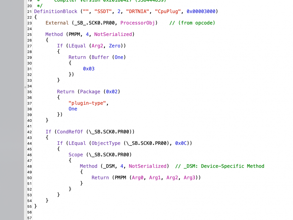

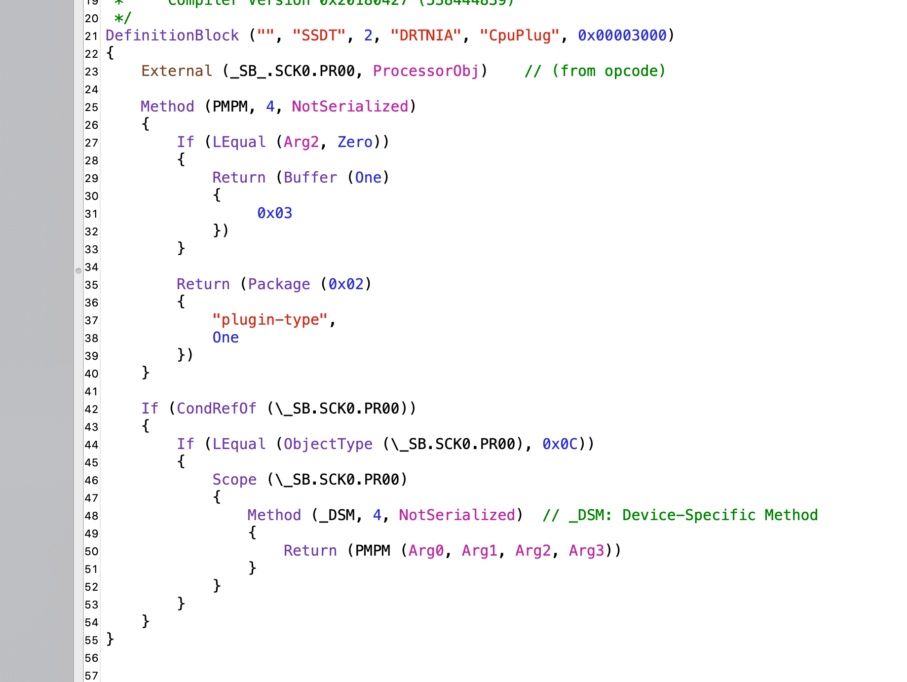

etorix Posted March 24, 2021 Share Posted March 24, 2021 7 hours ago, Balamut said: Had to put CPU Wrapper to boot but still no dice. Instant reboot from Wake. If you have a CPU wrapper, SSDT-PLUG should attach to the first "wrapped" (fake) CPU, not to the real ACPI CPU device. 2 Link to comment https://www.insanelymac.com/forum/topic/335193-help-installing-mojave-on-xeon-w-2175-and-asus-ws-c422-mobo/page/30/#findComment-2753759 Share on other sites More sharing options...

Balamut Posted March 25, 2021 Share Posted March 25, 2021 (edited) 10 hours ago, etorix said: If you have a CPU wrapper, SSDT-PLUG should attach to the first "wrapped" (fake) CPU, not to the real ACPI CPU device. It is. 7 hours ago, yapan4 said: Ok, took the config.plist from your topic, only preboot.log please... Do you use a patched BIOS? CFG Bios is Patched or else I wouldn't be able to boot.Attaching preboot.log preboot.log Maybe some setting in the BIOS got screwed up? T-States are enabled just didnt have a picture of it. Edited March 25, 2021 by Balamut 1 Link to comment https://www.insanelymac.com/forum/topic/335193-help-installing-mojave-on-xeon-w-2175-and-asus-ws-c422-mobo/page/30/#findComment-2753797 Share on other sites More sharing options...

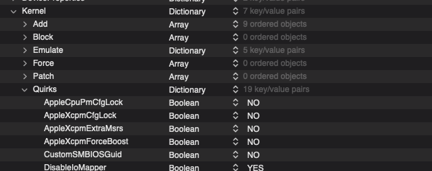

yapan4 Posted March 25, 2021 Share Posted March 25, 2021 @Balamut Enable AppleXcpmExtraMsrs Quirk and test Sleep/Wakeup... Link to comment https://www.insanelymac.com/forum/topic/335193-help-installing-mojave-on-xeon-w-2175-and-asus-ws-c422-mobo/page/30/#findComment-2753800 Share on other sites More sharing options...

Balamut Posted March 26, 2021 Share Posted March 26, 2021 18 hours ago, yapan4 said: @Balamut Enable AppleXcpmExtraMsrs Quirk and test Sleep/Wakeup... Just tried on Clover and OC no dice same panic on wake. 3 hours ago, obus said: Do you have a thunderbolt card installed? Nope not yet, I was hoping to get it running before adding cards. Brand new OS, minimal ACPI and kexts. Can you guys read this panic? Whats the cause of it? Backtrace (CPU 0), Frame : Return Address 0xffffff801c7561e0 : 0xffffff801c8bab4d mach_kernel : _handle_debugger_trap + 0x3dd 0xffffff801c756230 : 0xffffff801c9fd7e3 mach_kernel : _kdp_i386_trap + 0x143 0xffffff801c756270 : 0xffffff801c9ede1a mach_kernel : _kernel_trap + 0x55a 0xffffff801c7562c0 : 0xffffff801c85fa2f mach_kernel : _return_from_trap + 0xff 0xffffff801c7562e0 : 0xffffff801c8ba3ed mach_kernel : _DebuggerTrapWithState + 0xad 0xffffff801c756400 : 0xffffff801c8ba6d8 mach_kernel : _panic_trap_to_debugger + 0x268 0xffffff801c756470 : 0xffffff801d0bef9a mach_kernel : _panic + 0x54 0xffffff801c7564e0 : 0xffffff801c9ee1e6 mach_kernel : _sync_iss_to_iks + 0x2c6 0xffffff801c756660 : 0xffffff801c9edecd mach_kernel : _kernel_trap + 0x60d 0xffffff801c7566b0 : 0xffffff801c85fa2f mach_kernel : _return_from_trap + 0xff 0xffffff801c7566d0 : 0xffffff801ca0ba97 mach_kernel : _xcpm_perf_bias_set + 0x1c7 0xffffffa59a553c20 : 0xffffff801ca0bd2a mach_kernel : _xcpm_init + 0xaa 0xffffffa59a553c40 : 0xffffff801c9fb72a mach_kernel : _acpi_sleep_kernel + 0x32a 0xffffffa59a553c90 : 0xffffff801d89d8b2 com.apple.driver.AppleACPIPlatform : __ZN23AppleACPIPlatformExpert13sleepPlatformEv + 0x204 0xffffffa59a553ce0 : 0xffffff801d8a1bab com.apple.driver.AppleACPIPlatform : __ZN12AppleACPICPU7haltCPUEv + 0x75 0xffffffa59a553d00 : 0xffffff801d039fff mach_kernel : __Z16IOCPUSleepKernelv + 0x19f 0xffffffa59a553d60 : 0xffffff801d07d115 mach_kernel : __ZN14IOPMrootDomain15powerChangeDoneEm + 0xb25 0xffffffa59a553de0 : 0xffffff801cfff883 mach_kernel : __ZN9IOService8all_doneEv + 0x753 0xffffffa59a553e50 : 0xffffff801cffc5f1 mach_kernel : __ZN9IOService23actionPMWorkQueueInvokeEP11IOPMRequestP13IOPMWorkQueue + 0x881 0xffffffa59a553ea0 : 0xffffff801cff9660 mach_kernel : __ZN13IOPMWorkQueue17checkRequestQueueEP11queue_entryPb + 0x90 0xffffffa59a553ef0 : 0xffffff801cff950a mach_kernel : __ZN13IOPMWorkQueue12checkForWorkEv + 0xca 0xffffffa59a553f30 : 0xffffff801d01691e mach_kernel : __ZN10IOWorkLoop15runEventSourcesEv + 0x11e 0xffffffa59a553f70 : 0xffffff801d015f06 mach_kernel : __ZN10IOWorkLoop10threadMainEv + 0x36 0xffffffa59a553fa0 : 0xffffff801c85f13e mach_kernel : _call_continuation + 0x2e 1 Link to comment https://www.insanelymac.com/forum/topic/335193-help-installing-mojave-on-xeon-w-2175-and-asus-ws-c422-mobo/page/30/#findComment-2753885 Share on other sites More sharing options...

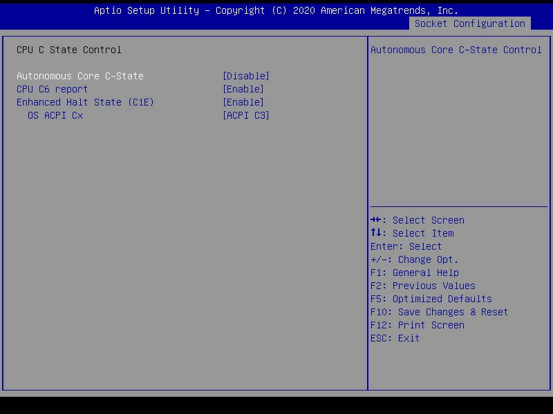

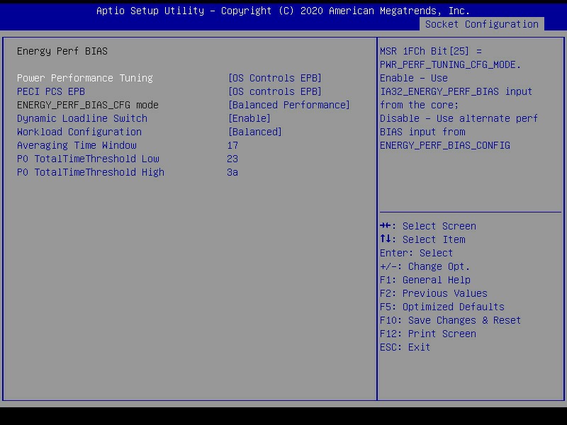

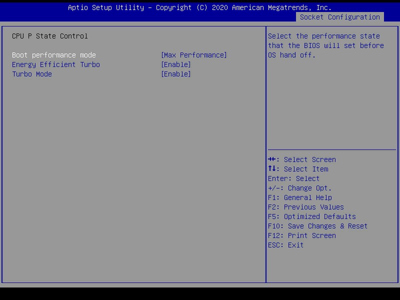

yapan4 Posted March 26, 2021 Share Posted March 26, 2021 (edited) @Balamut 1. First of all, reading and decoding kernel panic logs is not my level. So sorry for that. This question has been raised several times in this and other topics, but so far no one with relevant knowledge has responded. So my messages are just a desire to keep the topic alive until the problem is solved. 2. You can try last one time. Get rid of KP on patched BIOS when wake up, I was helped by the kernel patches which were used to run the system on the original BIOS Note: This is Clover version for Catalina! Edited March 26, 2021 by yapan4 Link to comment https://www.insanelymac.com/forum/topic/335193-help-installing-mojave-on-xeon-w-2175-and-asus-ws-c422-mobo/page/30/#findComment-2753888 Share on other sites More sharing options...

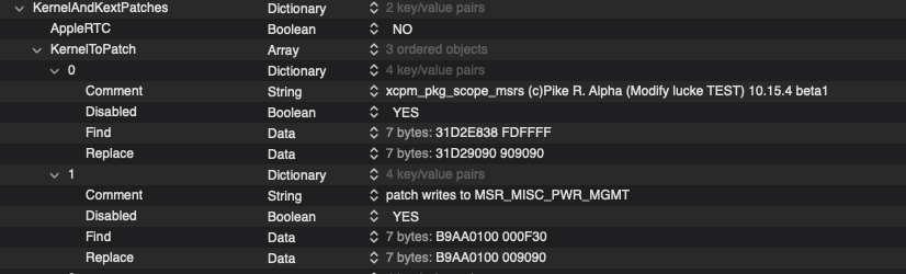

yapan4 Posted March 26, 2021 Share Posted March 26, 2021 (edited) Some more thoughts: 1) This kernel panic is noticed only on motherboards ASUS C422 and C621. Supermicro and Gigabyte do not have this problem. 2) This kernel panic is noticed only on the patched MSR 0x1AA. So you can try patch MSR 0xE2 parts only. Then use AppleXcpmExtraMsrs Quirk 3) New versions of the BIOS for C422 have a working ConfigureLock Setting for lock/unlock MSR 0x0E2 so ASUS C621 users can ask ASUS Support for that. 4) Unlocked MSR 0xE2 + AppleXcpmExtraMsrs Quirk allow me successfully boot Big Sur and use Sleep/Wakeup. P.S. Sorry my English. Edited March 26, 2021 by yapan4 3 Link to comment https://www.insanelymac.com/forum/topic/335193-help-installing-mojave-on-xeon-w-2175-and-asus-ws-c422-mobo/page/30/#findComment-2753890 Share on other sites More sharing options...
Balamut Posted March 26, 2021 Share Posted March 26, 2021 1 hour ago, yapan4 said: @Balamut 1. First of all, reading and decoding kernel panic logs is not my level. So sorry for that. This question has been raised several times in this and other topics, but so far no one with relevant knowledge has responded. So my messages are just a desire to keep the topic alive until the problem is solved. 2. You can try last one time. Get rid of KP on patched BIOS when wake up, I was helped by the kernel patches which were used to run the system on the original BIOS Note: This is Clover version for Catalina! Tried what I can find it didnt work. 23 minutes ago, yapan4 said: Some more thoughts: 1) This kernel panic is noticed only on motherboards ASUS C422 and C621. Supermicro and Gigabyte do not have this problem. 2) This kernel panic is noticed only on the patched MSR 0x1AA. So you can try patch MSR 0xE2 parts only. Then use AppleXcpmExtraMsrs Quirk 3) New versions of the BIOS for C422 have a working ConfigureLock Setting for lock/unlock MSR 0x0E2 so ASUS C621 users can ask ASUS Support for that. 4) Unlocked MSR 0xE2 + AppleXcpmExtraMsrs Quirk allow me successfully boot Big Sur and use Sleep/Wakeup. P.S. Sorry my English. My Friend you are a F****G GENIUS!!!!!!!!!!!!!!!!!!!!!!!!!!!!! Almost a freaking month!!!!!!!!!!!!!! It was the MSR 0x1AA issue, only patched CFG from the OC and BOOM! it woke up. I owe you BIG ONE, and never apologies for your English, it's good enough for me. I gonna flash virgin bios and test it a bit with BMC off, will report a bit later. By the way the UEFIPatch for my bios nor Brambaurs CFGLock works. Again Спасибо! 1 Link to comment https://www.insanelymac.com/forum/topic/335193-help-installing-mojave-on-xeon-w-2175-and-asus-ws-c422-mobo/page/30/#findComment-2753892 Share on other sites More sharing options...
yapan4 Posted March 26, 2021 Share Posted March 26, 2021 (edited) 51 minutes ago, Balamut said: Again Спасибо! You're welcome! ...but this is workaround, question still opened. So let's wait for someone to decipher the panic log and clarify in some way how it relates to unlocked MSR 0x1AA on ASUS motherboards... Edited March 26, 2021 by yapan4 1 Link to comment https://www.insanelymac.com/forum/topic/335193-help-installing-mojave-on-xeon-w-2175-and-asus-ws-c422-mobo/page/30/#findComment-2753893 Share on other sites More sharing options...

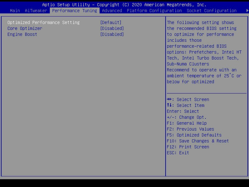

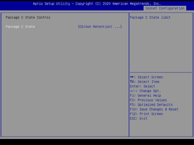

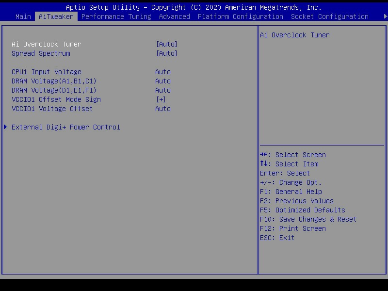

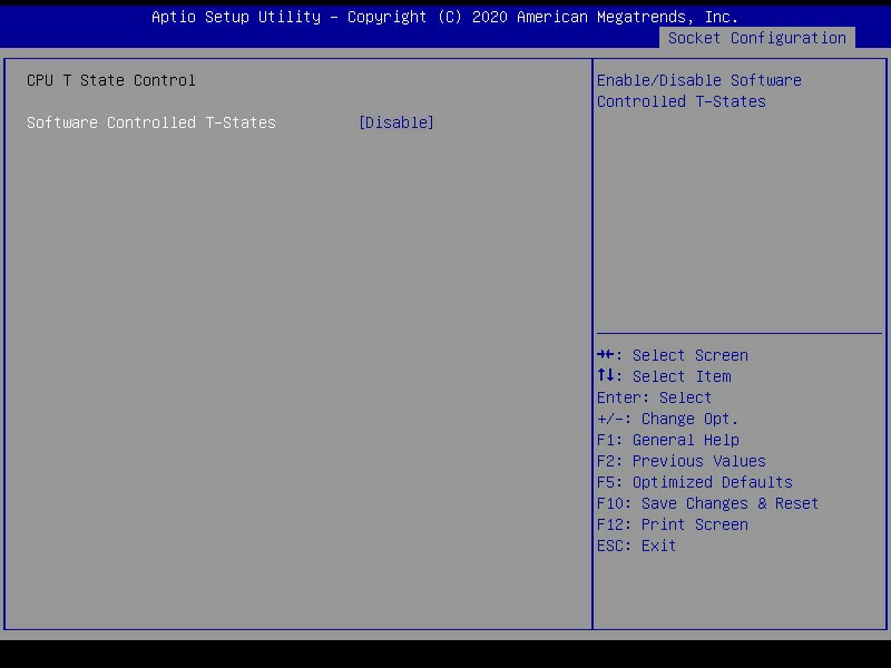

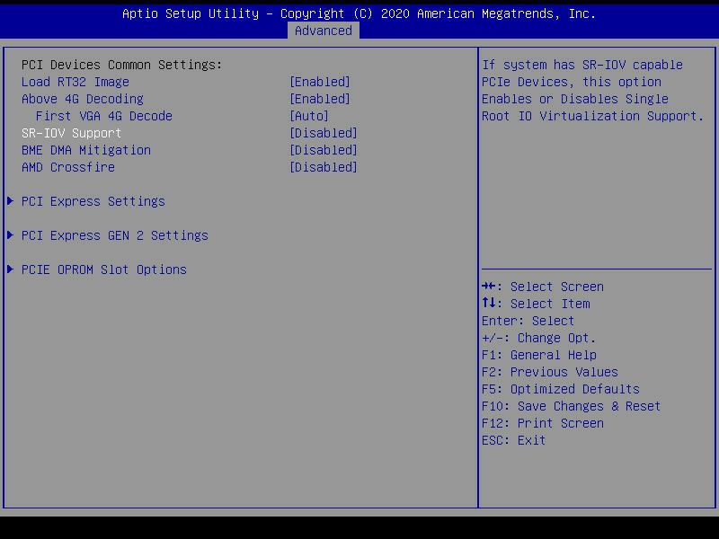

yapan4 Posted March 26, 2021 Share Posted March 26, 2021 (edited) The BIOS v.3405 for WS C422 Pro/SE has been released, now some settings have been added: One more Above 4G Decoding and Re-Size BAR Support https://dlcdnets.asus.com/pub/ASUS/mb/Socket2066/WS_C422_PRO_SE/WS-C422-PRO-SE-ASUS-3405.ZIP 210326072129.BMP 210326072150.BMP 210327204640.BMP Edited March 27, 2021 by yapan4 1 Link to comment https://www.insanelymac.com/forum/topic/335193-help-installing-mojave-on-xeon-w-2175-and-asus-ws-c422-mobo/page/30/#findComment-2753898 Share on other sites More sharing options...

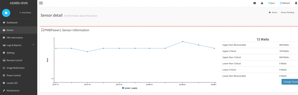

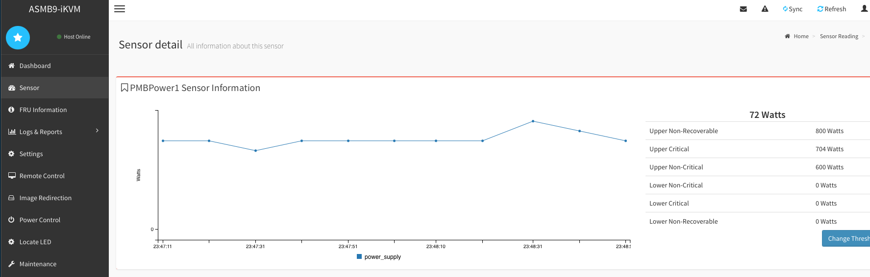

yapan4 Posted April 10, 2021 Share Posted April 10, 2021 Short report about my solution for PMBus. Hope it be useful for any users with ASUS WS C422 Pro/SE or similar motherboards. After unsuccessful experience with Supermicro PMBus capable PSU's I decide to bay vendor independent PMBus capable PSU. Finally I chose and bought FSP700-80WEPB. This is 2U format Power Supply with PMBus v1.2. Was some troubles with mounting this not usual PSU into usual ATX Case but finally were installed and connected. This PSU has standart set of connectors + 5pin PMBus connector so my motherboard started as usual. Main result - finally my Motherboard detect PMBus sensor, so combination ASUS WS C422 Pro/SE and FSP700-80WEPB can be considered successful. Work in progress... Link to comment https://www.insanelymac.com/forum/topic/335193-help-installing-mojave-on-xeon-w-2175-and-asus-ws-c422-mobo/page/30/#findComment-2755216 Share on other sites More sharing options...

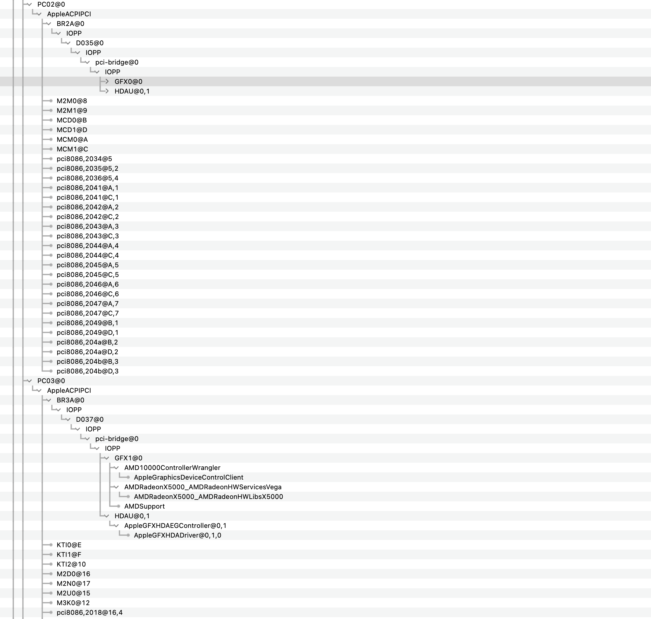

Balamut Posted April 17, 2021 Share Posted April 17, 2021 Hey guys, I've swapped 5700 XT with Dual Radeon VII and now it won't go to sleep, any of you seen this error in the logs? 2021-04-16 21:37:50.832399-0700 localhost kernel[0]: (AppleACPIPlatform) <AppleACPIPlatform`AppleACPIPlatformExpert::queryPlatformCanSleep()> System sleep prevented by GFX1 2021-04-16 21:37:50.832401-0700 localhost kernel[0]: (AppleACPIPlatform) <AppleACPIPlatform`AppleACPIPlatformExpert::queryPlatformCanSleep()> System sleep prevented by GFX1 2021-04-16 21:32:35.271062-0700 localhost kernel[0]: PMRD: setAggressiveness(0) kPMMinutesToSleep = 0 2021-04-16 21:32:35.414767-0700 localhost kernel[0]: PMRD: setAggressiveness(0) kPMMinutesToSleep = 30 2021-04-16 21:32:35.415482-0700 localhost kernel[0]: PMRD: idle sleep timer enabled 2021-04-16 21:32:35.418919-0700 localhost kernel[0]: PMRD: setAggressiveness(0) kPMMinutesToSleep = 0 2021-04-16 21:32:35.419423-0700 localhost kernel[0]: PMRD: idle sleep timer disabled 2021-04-16 21:32:35.421892-0700 localhost kernel[0]: PMRD: setAggressiveness(0) kPMMinutesToSleep = 30 2021-04-16 21:32:35.422277-0700 localhost kernel[0]: PMRD: setAggressiveness(0) kPMMinutesToSleep = 0 2021-04-16 21:32:35.560475-0700 localhost kernel[0]: PMRD: setAggressiveness(0) kPMMinutesToSleep = 30 2021-04-16 21:32:35.561162-0700 localhost kernel[0]: PMRD: idle sleep timer enabled 2021-04-16 21:32:41.224422-0700 localhost kernel[0]: PMRD: setAggressiveness(0) kPMMinutesToSleep = 0 2021-04-16 21:32:41.225288-0700 localhost kernel[0]: PMRD: idle sleep timer disabled 2021-04-16 21:35:47.366332-0700 localhost kernel[0]: PMRD: setAggressiveness(0) kPMMinutesToSleep = 30 2021-04-16 21:35:47.367079-0700 localhost kernel[0]: PMRD: idle sleep timer enabled 2021-04-16 21:35:48.110866-0700 localhost kernel[0]: PMRD: setAggressiveness(0) kPMMinutesToSleep = 0 2021-04-16 21:35:48.111675-0700 localhost kernel[0]: PMRD: idle sleep timer disabled 2021-04-16 21:37:27.784696-0700 localhost kernel[0]: (IOAudioFamily) <IOAudioFamily`IOAudioDevice::scheduleIdleAudioSleep()> + IOAudioDevice[<private>]::scheduleIdleAudioSleep: idleSleepDelayTime = ffffffffffffffffffffffff 2021-04-16 21:37:27.784697-0700 localhost kernel[0]: (IOAudioFamily) <IOAudioFamily`IOAudioDevice::scheduleIdleAudioSleep()> - IOAudioDevice[<private>]::scheduleIdleAudioSleep: idleSleepDelayTime = ffffffffffffffffffffffff 2021-04-16 21:37:34.978331-0700 localhost kernel[0]: PMRD: setAggressiveness(0) kPMMinutesToSleep = 30 2021-04-16 21:37:34.979199-0700 localhost kernel[0]: PMRD: idle sleep timer enabled 2021-04-16 21:37:35.726440-0700 localhost kernel[0]: PMRD: changePowerStateWithOverrideTo(SLEEP_STATE, 5c0067) 2021-04-16 21:37:35.726570-0700 localhost kernel[0]: PMRD: user inactive 0 min, time to idle sleep 30 min 2021-04-16 21:37:35.726782-0700 localhost kernel[0]: PMRD: PowerChangeOverride (ON_STATE->SLEEP_STATE, f, 0xc2) tag 0x5c0067 2021-04-16 21:37:35.726913-0700 localhost kernel[0]: PMRD: sleep reason Software Sleep 2021-04-16 21:37:35.727126-0700 localhost kernel[0]: PMRD: Removed IODisplayWrangler from idle sleep preventers list (Total 0) 2021-04-16 21:37:35.727129-0700 localhost kernel[0]: PMRD: changePowerStateWithTagTo(SLEEP_STATE, 5e0004) 2021-04-16 21:37:35.728485-0700 localhost kernel[0]: PMRD: SleepWake UUID queued: D21569BA-9C43-433D-AAEF-5A4EB1FAC995 2021-04-16 21:37:35.728560-0700 localhost kernel[0]: PMRD: tellChangeDown::userActivityAtSleep 0 2021-04-16 21:37:35.734882-0700 localhost kernel[0]: PMRD: kIOMessageSystemWillSleep[249] to pid 83, powerd 2021-04-16 21:37:35.734891-0700 localhost kernel[0]: PMRD: kIOMessageSystemWillSleep[250] to pid 112, apsd 2021-04-16 21:37:35.734932-0700 localhost kernel[0]: PMRD: kIOMessageSystemWillSleep[251] to pid 235, airportd 2021-04-16 21:37:35.734976-0700 localhost kernel[0]: PMRD: kIOMessageSystemWillSleep[252] to pid 136, corebrightnessd 2021-04-16 21:37:35.735013-0700 localhost kernel[0]: PMRD: kIOMessageSystemWillSleep[253] to pid 162, loginwindow 2021-04-16 21:37:35.735042-0700 localhost kernel[0]: PMRD: kIOMessageSystemWillSleep[254] to pid 162, loginwindow 2021-04-16 21:37:35.735049-0700 localhost kernel[0]: PMRD: kIOMessageSystemWillSleep[255] to pid 411, WirelessRadioMan 2021-04-16 21:37:35.735083-0700 localhost kernel[0]: PMRD: kIOMessageSystemWillSleep[256] to __kernel__ 2021-04-16 21:37:35.735130-0700 localhost kernel[0]: PMRD: kIOMessageSystemWillSleep[257] to pid 457, sharingd 2021-04-16 21:37:35.735164-0700 localhost kernel[0]: PMRD: kIOMessageSystemWillSleep[258] to pid 739, PerfPowerService 2021-04-16 21:37:35.735262-0700 localhost kernel[0]: PMRD: kIOMessageSystemWillSleep[259] to com.apple.filesystems.smbfs 2021-04-16 21:37:35.757565-0700 localhost kernel[0]: PMRD: setAggressiveness(0) kPMMinutesToSleep = 0 2021-04-16 21:37:35.758444-0700 localhost kernel[0]: PMRD: idle sleep timer disabled 2021-04-16 21:37:36.165208-0700 localhost kernel[0]: PMRD: tellChangeDown::userActivityAtSleep 0 2021-04-16 21:37:37.187739-0700 localhost kernel[0]: PMRD: DarkWake: sleepASAP 1, clamshell closed 0, disabled 0/0, desktopMode 1, ac 1 2021-04-16 21:37:37.187740-0700 localhost kernel[0]: PMRD: System sleep prevented by kPMCPUAssertion 2021-04-16 21:37:50.831848-0700 localhost kernel[0]: PMRD: DarkWake: sleepASAP 1, clamshell closed 0, disabled 0/0, desktopMode 1, ac 1 2021-04-16 21:37:50.832399-0700 localhost kernel[0]: (AppleACPIPlatform) <AppleACPIPlatform`AppleACPIPlatformExpert::queryPlatformCanSleep()> System sleep prevented by GFX1 2021-04-16 21:37:50.832401-0700 localhost kernel[0]: (AppleACPIPlatform) <AppleACPIPlatform`AppleACPIPlatformExpert::queryPlatformCanSleep()> System sleep prevented by GFX1 2021-04-16 21:37:50.832403-0700 localhost kernel[0]: PMRD: System sleep prevented by kPMPCIUnsupported 2021-04-16 21:38:19.211407-0700 localhost kernel[0]: PMRD: setAggressiveness(0) kPMMinutesToSleep = 30 2021-04-16 21:38:32.256155-0700 localhost kernel[0]: PMRD: setAggressiveness(0) kPMMinutesToSleep = 0 2021-04-16 21:38:33.736809-0700 localhost kernel[0]: PMRD: setAggressiveness(0) kPMMinutesToSleep = 30 2021-04-16 21:38:56.078608-0700 localhost kernel[0]: PMRD: display wrangler tickled1 1 lastSleepReason 103 2021-04-16 21:38:56.078662-0700 localhost kernel[0]: PMRD: display wrangler tickled1 2 lastSleepReason 103 2021-04-16 21:38:56.082986-0700 localhost kernel[0]: PMRD: Added IODisplayWrangler to idle sleep preventers list (Total 1) 2021-04-16 21:38:56.082990-0700 localhost kernel[0]: PMRD: Idle Sleep Preventers: IODisplayWrangler 2021-04-16 21:38:56.083078-0700 localhost kernel[0]: PMRD: idle sleep timer disabled 2021-04-16 21:38:56.931988-0700 localhost kernel[0]: PMRD: setAggressiveness(0) kPMMinutesToSleep = 0 2021-04-16 21:38:56.932814-0700 localhost kernel[0]: PMRD: idle sleep timer disabled 2021-04-16 21:38:56.945122-0700 localhost kernel[0]: PMRD: setAggressiveness(0) kPMMinutesToSleep = 30 2021-04-16 21:38:56.945312-0700 localhost kernel[0]: PMRD: setAggressiveness(0) kPMMinutesToSleep = 0 2021-04-16 21:38:57.153444-0700 localhost kernel[0]: PMRD: setAggressiveness(0) kPMMinutesToSleep = 30 2021-04-16 21:38:57.153864-0700 localhost kernel[0]: PMRD: idle sleep timer enabled 2021-04-16 21:38:57.594297-0700 localhost kernel[0]: PMRD: setAggressiveness(0) kPMMinutesToSleep = 0 2021-04-16 21:38:57.595680-0700 localhost kernel[0]: PMRD: idle sleep timer disabled 2021-04-16 21:38:59.662900-0700 localhost kernel[0]: PMRD: setAggressiveness(0) kPMMinutesToSleep = 30 2021-04-16 21:38:59.663776-0700 localhost kernel[0]: PMRD: idle sleep timer enabled Link to comment https://www.insanelymac.com/forum/topic/335193-help-installing-mojave-on-xeon-w-2175-and-asus-ws-c422-mobo/page/30/#findComment-2755813 Share on other sites More sharing options...
yapan4 Posted April 17, 2021 Share Posted April 17, 2021 Hi again @Balamut You can try to block AppleGFXHDA.kext for load. It seems suspicious to me idleSleepDelayTime = ffffffffffffffffffffffff 2021-04-16 21:37:27.784696-0700 localhost kernel[0]: (IOAudioFamily) <IOAudioFamily`IOAudioDevice::scheduleIdleAudioSleep()> + IOAudioDevice[<private>]::scheduleIdleAudioSleep: idleSleepDelayTime = ffffffffffffffffffffffff 2021-04-16 21:37:27.784697-0700 localhost kernel[0]: (IOAudioFamily) <IOAudioFamily`IOAudioDevice::scheduleIdleAudioSleep()> - IOAudioDevice[<private>]::scheduleIdleAudioSleep: idleSleepDelayTime = ffffffffffffffffffffffff 1 Link to comment https://www.insanelymac.com/forum/topic/335193-help-installing-mojave-on-xeon-w-2175-and-asus-ws-c422-mobo/page/30/#findComment-2755849 Share on other sites More sharing options...
