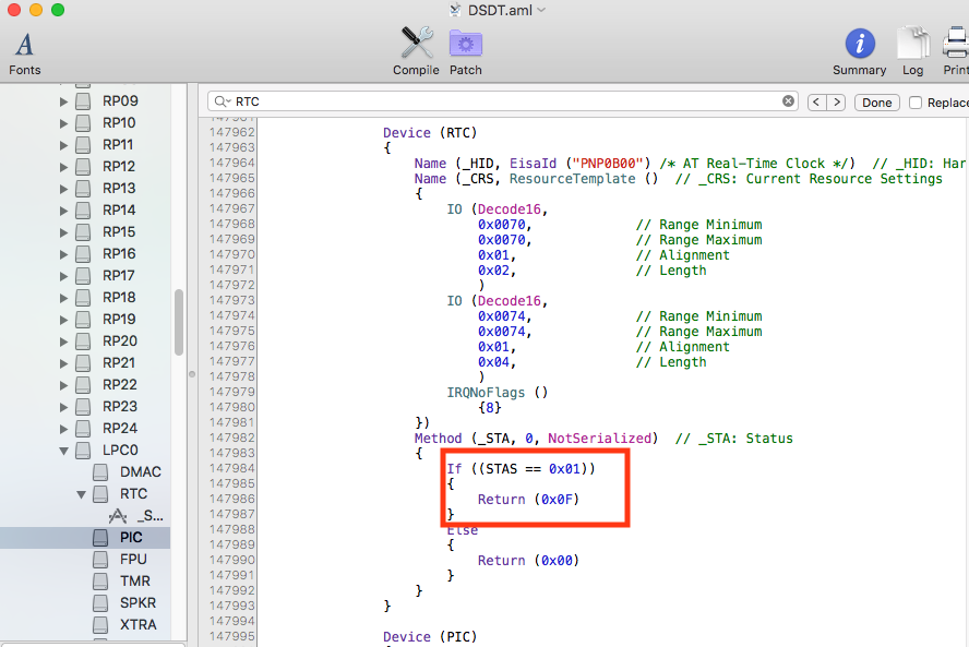

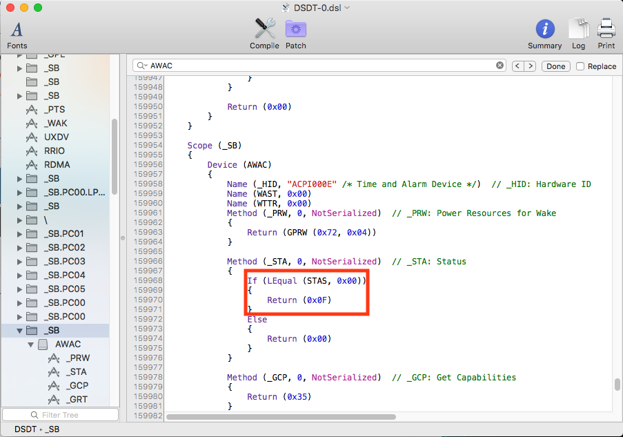

obus Posted March 6, 2020 Author Share Posted March 6, 2020 (edited) 1 hour ago, hardcorehenry said: You trying to enable two conflicting devices. AWAC(_STA 0xf) condition STAS=0 and RTC(_STA 0xf) condition STAS=1. You managed to do it forcibly via SSDT then you're surprised you have unexpected behavior(panic). I don't know... You could instead test given SSDT-AWAC.aml and contribute, post request to Acidanthera team for editing comment in SSDT-AWAC.aml, but of course it's up to you I have no KP with original v. 3003 bios and @lovest.fhd:s SSDT-RTC.aml, so I don't exactly know what you are reffering to. My rig is rock stable with this configuration and I have both RTC and AWAC initialised. Wake after sleep is working perfect too. The "problem/unexpected behaviour" I was talking about in earlier post was KP when trying to wake the rig after sleep with a modded v. 3003 bios from @metacollin, and this is a complete different story I presume. And by the way I'm trying to contribute as good as I can in relation to my knowledge. Edited March 6, 2020 by obus Link to comment https://www.insanelymac.com/forum/topic/335193-help-installing-mojave-on-xeon-w-2175-and-asus-ws-c422-mobo/page/24/#findComment-2711398 Share on other sites More sharing options...

hardcorehenry Posted March 6, 2020 Share Posted March 6, 2020 (edited) 1 hour ago, obus said: I have no KP with original v. 3003 bios and @lovest.fhd:s SSDT-RTC.aml, so I don't exactly know what you are reffering to. My rig is rock stable with this configuration and I have both RTC and AWAC initialised. Wake after sleep is working perfect too. The "problem/unexpected behaviour" I was talking about in earlier post was KP when trying to wake the rig after sleep with a modded v. 3003 bios from @metacollin, and this is a complete different story I presume. And by the way I'm trying to contribute as good as I can in relation to my knowledge. Question is, why do you insist on having AWAC in your IOReg, macos doesn't control AWAC, there's no AWAC device in any MAC AFAIK Edited March 6, 2020 by hardcorehenry Link to comment https://www.insanelymac.com/forum/topic/335193-help-installing-mojave-on-xeon-w-2175-and-asus-ws-c422-mobo/page/24/#findComment-2711409 Share on other sites More sharing options...
obus Posted March 6, 2020 Author Share Posted March 6, 2020 1 hour ago, hardcorehenry said: Question is, why do you insist on having AWAC in your IOReg, macos doesn't control AWAC, there's no AWAC device in any MAC AFAIK I'm not insisting on that and I know after reading @vit9696:s comment on GitHub that there is no AWAC device to control in a Mac. But because both SSDT-AWAC and SSDT-RTC is working on my rig I was confused. That's it! 1 Link to comment https://www.insanelymac.com/forum/topic/335193-help-installing-mojave-on-xeon-w-2175-and-asus-ws-c422-mobo/page/24/#findComment-2711431 Share on other sites More sharing options...

hardcorehenry Posted March 6, 2020 Share Posted March 6, 2020 16 minutes ago, obus said: @hardcorehenry Now there is a new problem with OC 0.5.6!!! With new OC release my rig isn't booting at all with SSDT-AWAC.aml but booting perfect with SSDT-RTC.aml without initialising AWAC??? This with @metacollin:s modded v. 3003 bios. What about That??? Post your current untouched DSDT.aml Link to comment https://www.insanelymac.com/forum/topic/335193-help-installing-mojave-on-xeon-w-2175-and-asus-ws-c422-mobo/page/24/#findComment-2711439 Share on other sites More sharing options...
obus Posted March 6, 2020 Author Share Posted March 6, 2020 (edited) Here we go DSDT.aml Edited March 6, 2020 by obus Link to comment https://www.insanelymac.com/forum/topic/335193-help-installing-mojave-on-xeon-w-2175-and-asus-ws-c422-mobo/page/24/#findComment-2711442 Share on other sites More sharing options...
