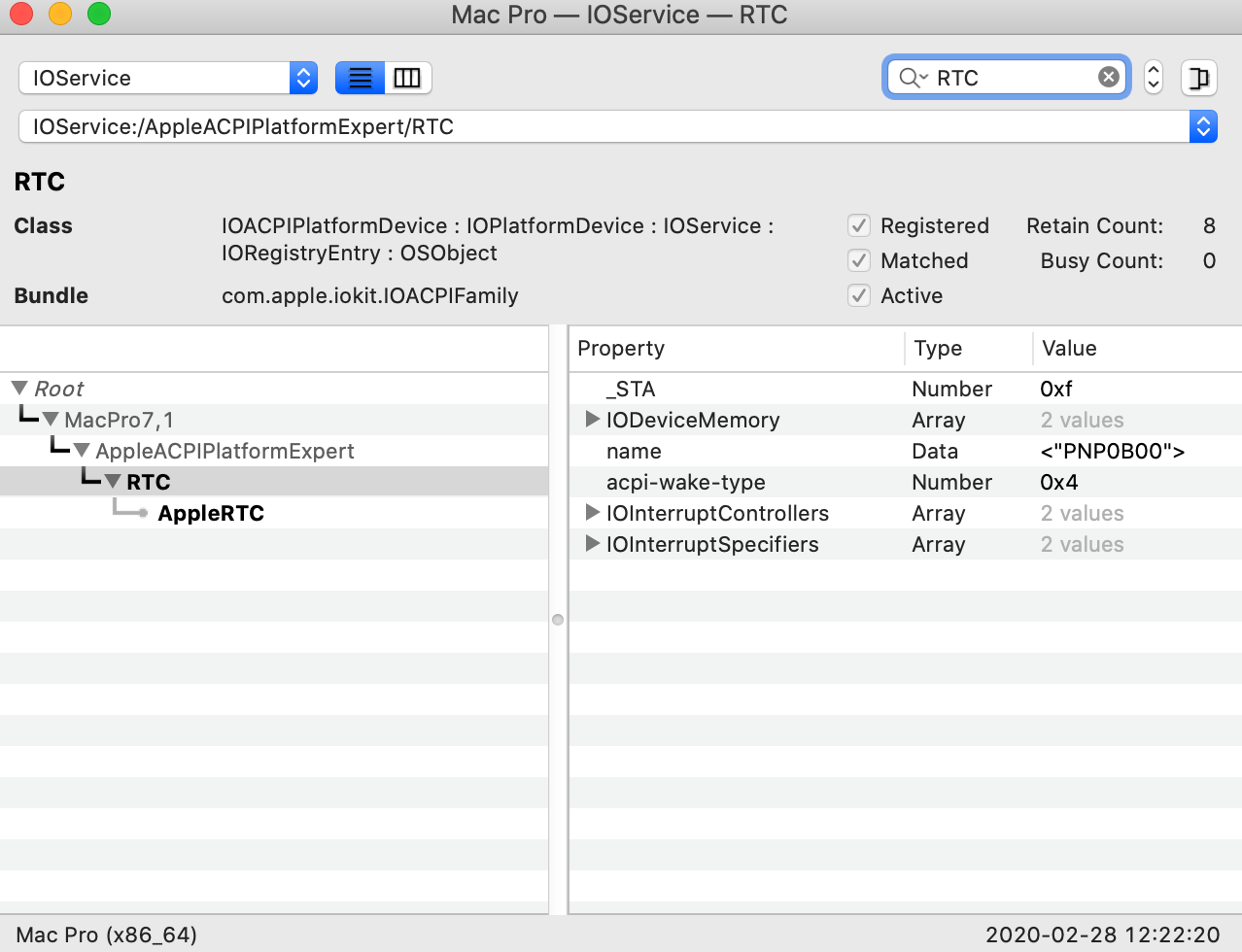

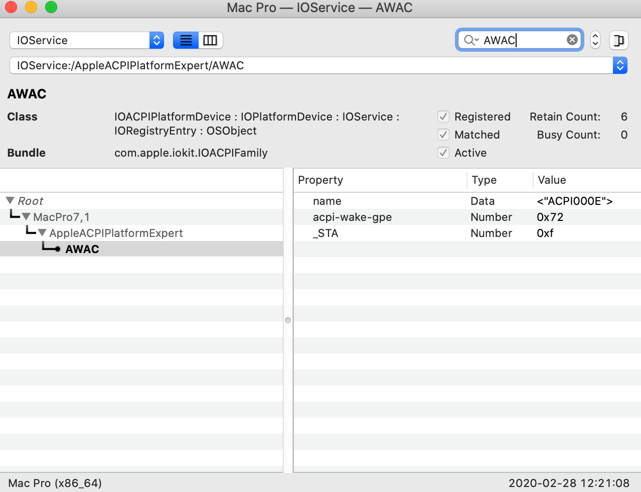

My bad. Bluetooth is working now in UEFI as it should after reseating cmos.. If you use the SSDT you tested first (attached) you will get AWAC working after boot. We need ONLY this SSDT together wit 3003 bios for working boot and initialised AWAC.
SSDT-RTC.aml

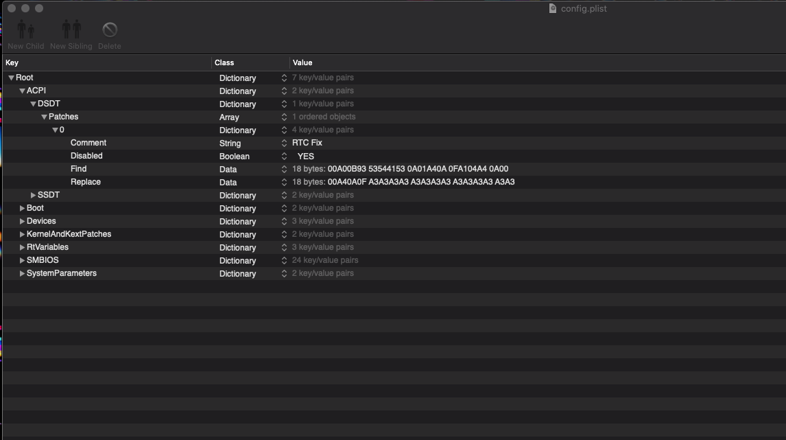

 I agree, i notice longer boot time with RTC+AWAC. Probably single RTC is more suitable for ASUS vs RTC+AWAC for Supermicro, owned by @lovest.fhd (my speculation)
About ACPI path "find - replace" for Clover: negative result.
Edited by yapan4
About ACPI path "find - rename" for Clover: negative result.
RTC 0XF
find:00 A0 0B 93 53 54 41 53 0A 01 A4 0A 0F A1 04 A4 0A 00
rep:00 A4 0A 0F A3 A3 A3 A3 A3 A3 A3 A3 A3 A3 A3 A3 A3 A3
awac 0x00
find:00 A0 0B 93 53 54 41 53 0A 00 A4 0A 0F A1 04 A4 0A 00
rep:00 A4 0A 00 A3 A3 A3 A3 A3 A3 A3 A3 A3 A3 A3 A3 A3 A3
2 hours ago, lovest.fhd said:
RTC 0XF
awac 0x00
Tested RTC 0XF only - don't work :(

rename not work for clover,I don't know why?
maybe you need  SortedOrder
I wonder why you trying inject this rename. Macos doesn't expect _STA 0xF in RTC, in fact macos expect there's no _STA at all. In recap renaming _STA to XSTA in RTC should be enough.
Edited by hardcorehenry
There are many ways to control these two devices
