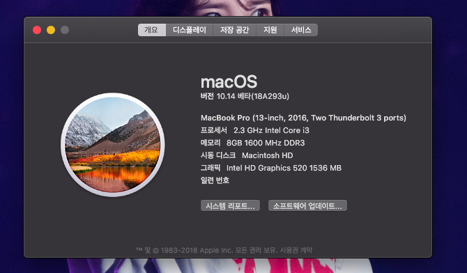

Working great with Layout id for ALC236 = 15,,
But with AppleALC.kext, layoutid=15 is no internal mic. At High sierra i used LayouID = 13 and Internal Mic is good.
So i download AppleALC Master from Github and modif it, delete all data for LayouID 15 and change data of layoutID 13 to LayoutID 15 then recompile AppleALC.kext
Now Audio and Mic is working great again

Internal Mic testing image

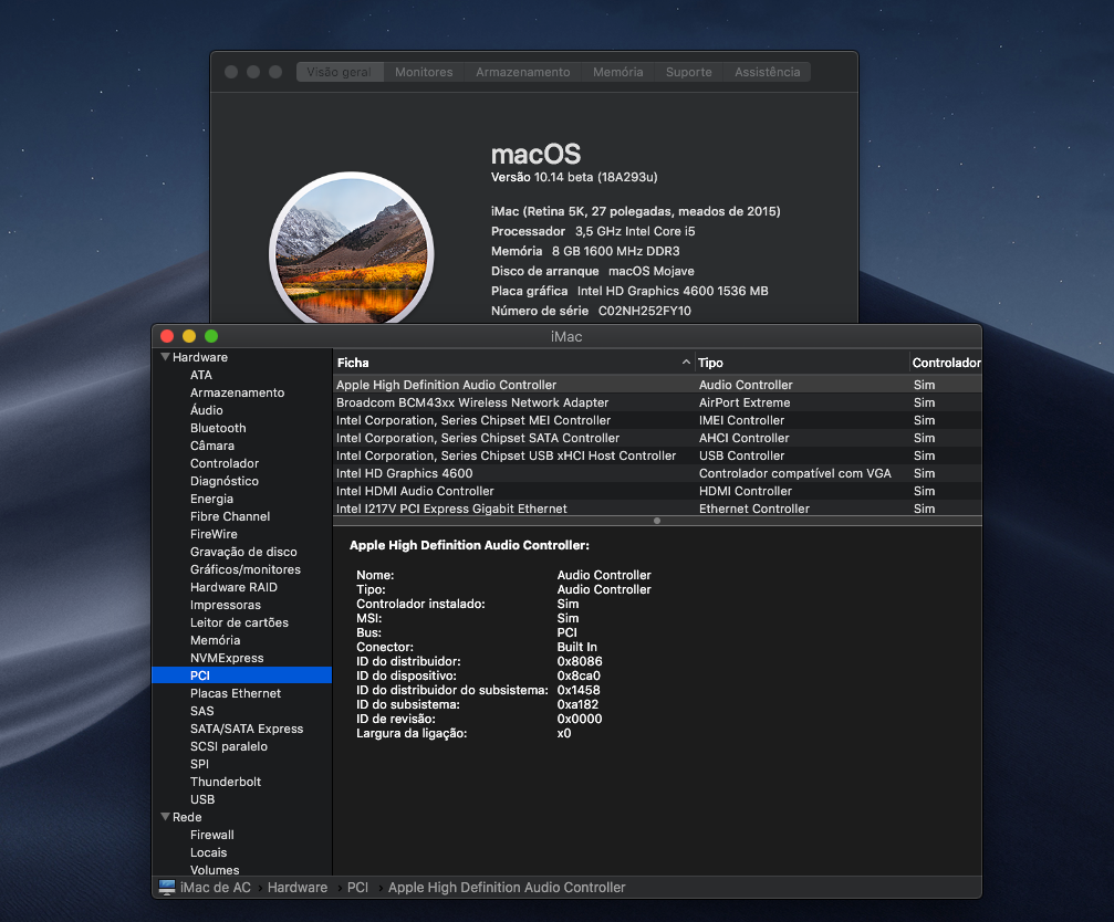

and voilá ... finally installed macOs Mojave, at this point bluetooth, wifi, ethernet all works ... except sound... but tomorrow is another day...
MorenoAV...
Can you tell me how did you get HD 4600 to work? Thanks!

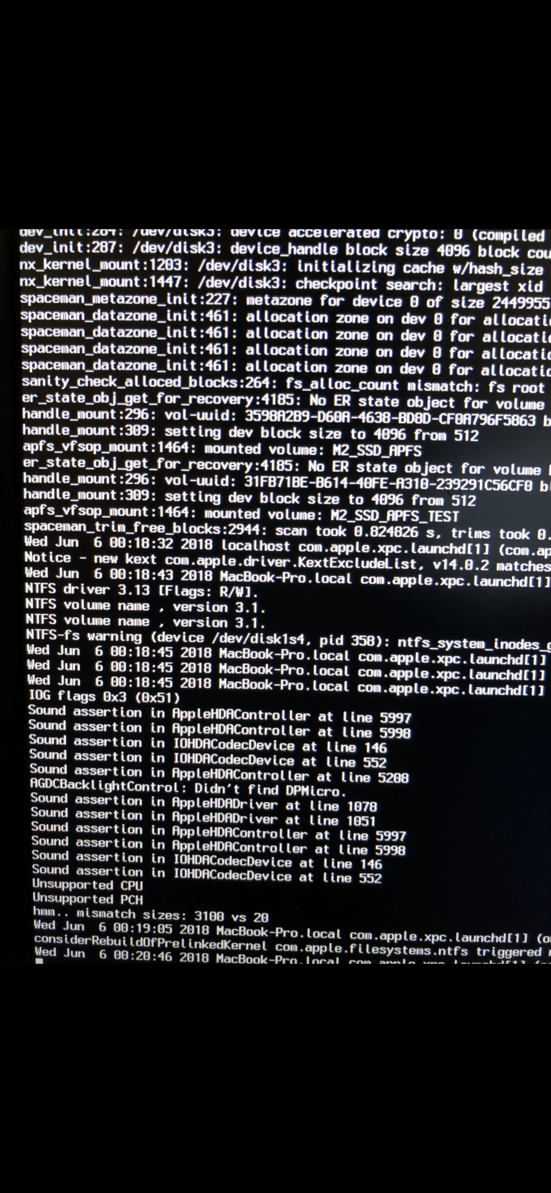

3 minutes ago, abdouoi said:
I’m stuck. Can someone help me please?8B305479-8BAA-4A7B-8CAF-9EAD6C3A5B28.thumb.png.0ac669158259ca8118b33847db22f8f9.png?
Download latest clover build and from the second page here PMHeart CLOVERX64.efi, put it in the CLOVER folder, and put it also in BOOT folder but you have to rename it to BOOTX64.efi, download apfs.10.14 from that page also, and you're done ^_^ !
I was already using the new binaries of clover. The only thing I didn’t do was to use the new apfs.efi. I’m gonna give it a try. Thanks
From the screenshot you've just posted, it appear that it is not APFS related problem, because if no APFS.efi no drive or partition will be detected on the Clover boot menu!
