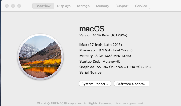

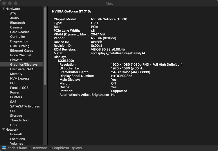

Geforce GT 710 2048 mb Works  :D
EDIT ***
I always forget this card and I do not use it very much but it serves me well for my Optiplex 790

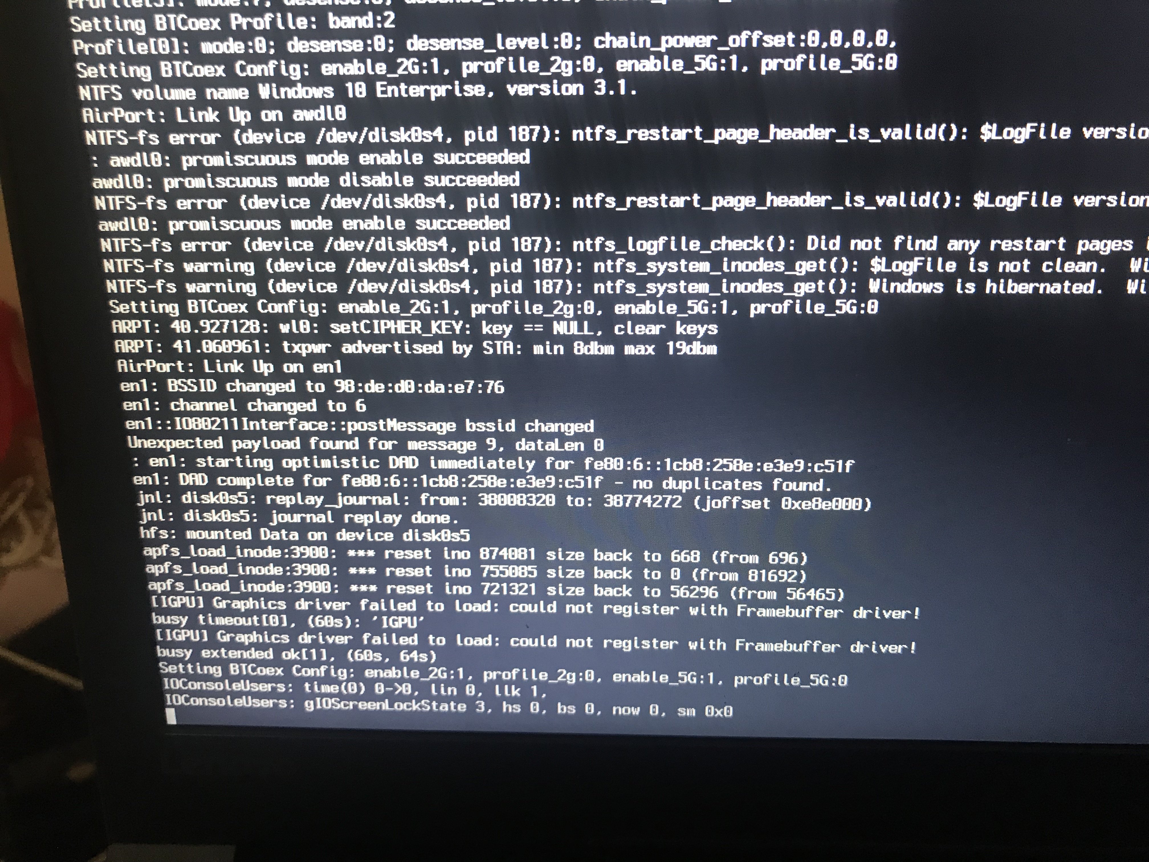

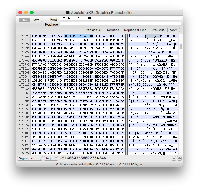

2 minutes ago, Andres ZeroCross said:
Binary for DVMT MinStolenPatch has been totally changed at 10.14 Beta, need new patch to "MinStolenPatch" for KabyLake Platform Notebook. Maybe Skylake and Broadwell Notebook face the same problem too
Looks like if your BIOS is hard patched we're still OK, full acceleration on my Latitude E5550. (Broadwell)
Try to patch "89 6D C0 76 46 48" to "89 6D C0 EB 46 48" and the result "Failed to load Framebuffer" (i set 0x591B0000)
Yes,, i assume you have unlock DVMT COnfiguration at your BIOS :)

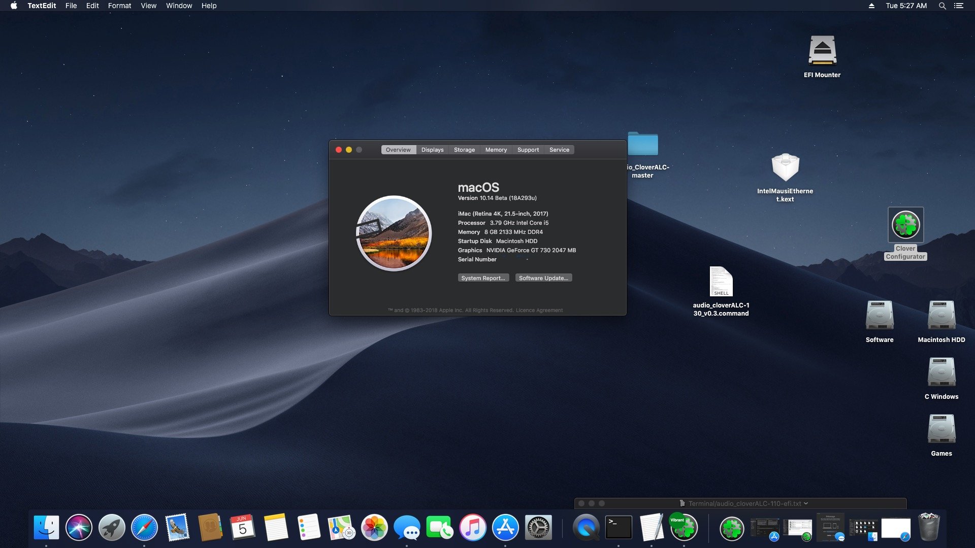

30 minutes ago, PcSolutions12 said:

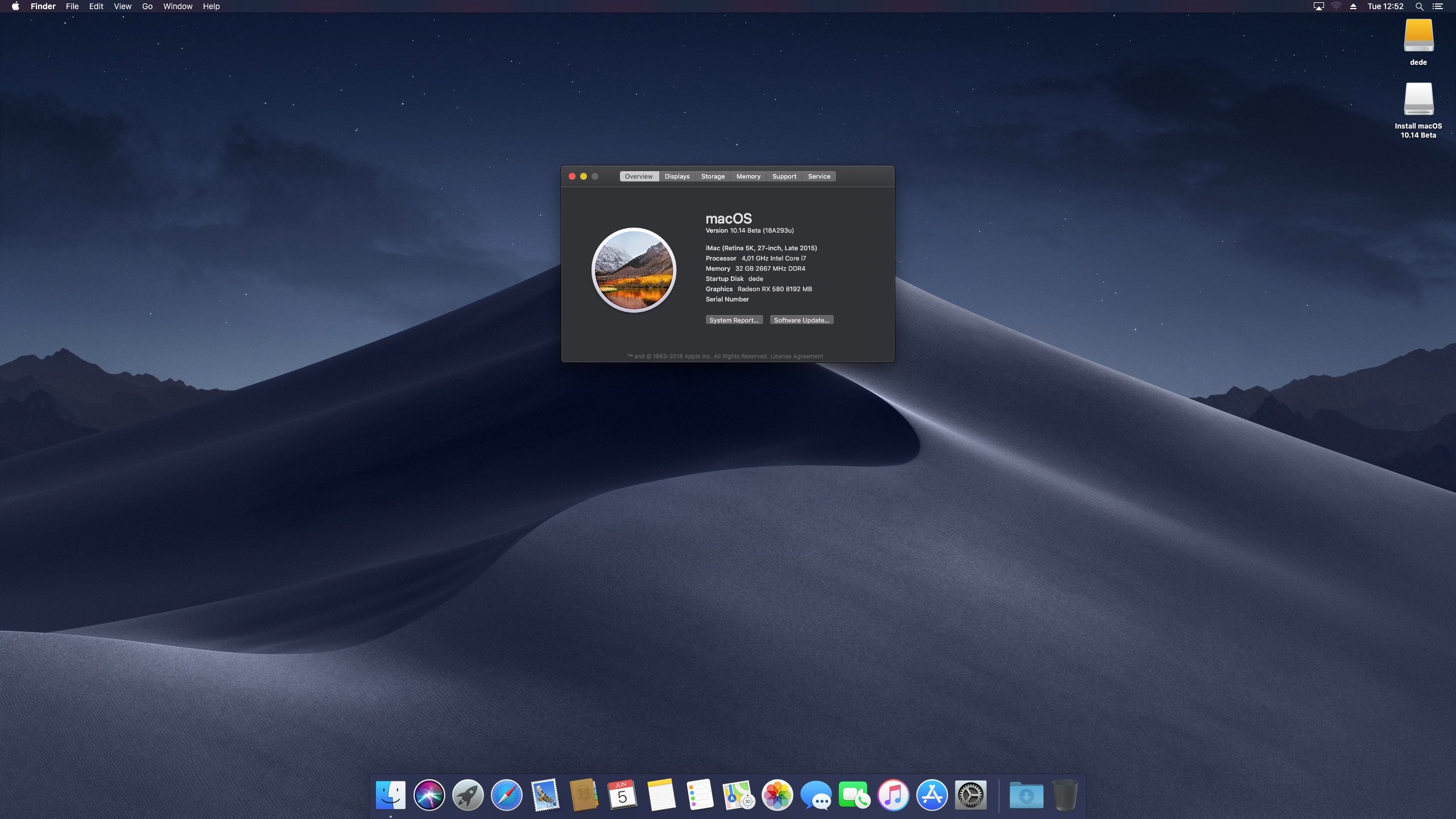

270440752_Screenshot2018-06-05at5_27_39AM.thumb.png.28e5e4f58663bd1f81583c84f6ea59f8.pngSUCCESSSSS!!!!!!!!
i5 7600k
gigabyte b250m-D3h
Nvidia gt 730
Ram??? Well I have uploaded the photo !
Sorry for my Desktop !:D I am always dis organised as I am 13 years old only .LOL

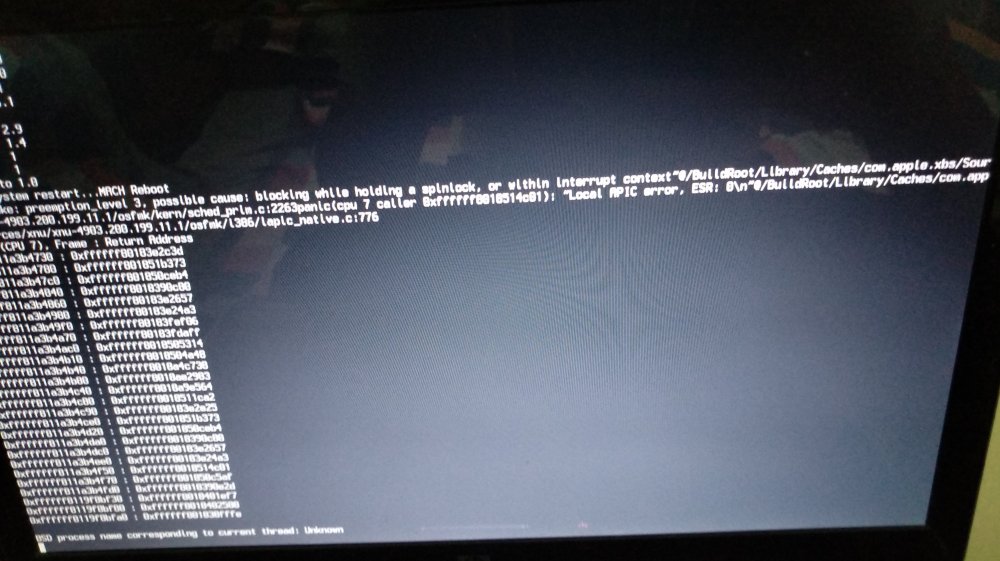

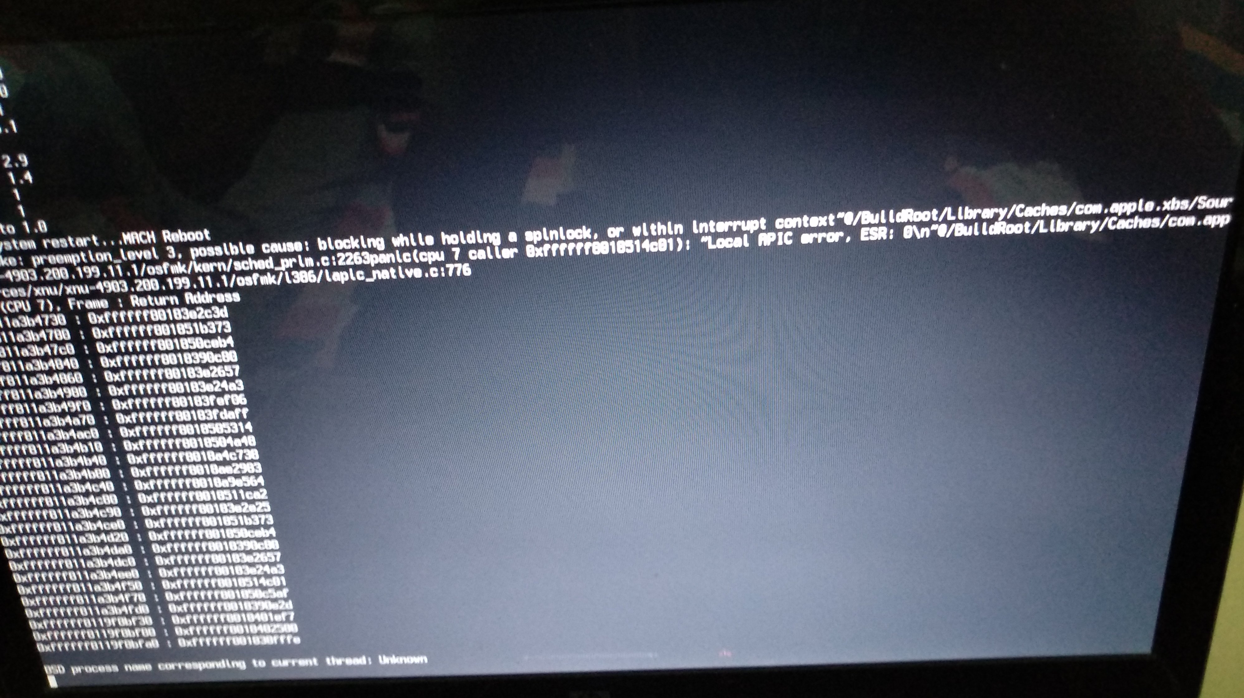

Guys  Hi,
mine is very old hardware and I attempted Mojave install only to get the following as if the clover is not working at all, a lapic error!!!!!!
Used both 11.1 and 13.1 smbios to initiate boot, but always the same. Except for the smbios all the rest of config, plist is as before and it boots fine with High Sierra.
Am on clover 4515 , tried both to external disk via high sierra and with installer usb made with boot buddy.
Will it go any further or is it the end of this hardware with Mojave.
Any suggestions to try.
Thanks
Macq
Yes, the previous patches no longer work.
Here are the new patches for macOS 10.14 Beta 1
AppleIntelBDWGraphicsFramebuffer
Find:
76 40 48 FF 05 A2 2A 06
Repl:
EB 40 48 FF 05 A2 2A 06
AppleIntelSKLGraphicsFramebuffer
Find:
76 40 48 FF 05 11 E5 07
Repl:
EB 40 48 FF 05 11 E5 07
AppleIntelKBLGraphicsFramebuffer
Find:
76 46 48 FF 05 BA 48 08
Repl:
EB 46 48 FF 05 BA 48 08
config_BDW_SKL_KBL_DVMT_Patches.plist

Guys  Hi,
Thanks
Macq
Have you checked the kernel lapic option in clover configurator?
Sent from my SM-G930F using Tapatalk

But before i tried to patch "89 6D C0 76 46 48" to "89 6D C0 EB 46 48" and the result "Failed to load Framebuffer" (i set 0x591B0000). Need check again
