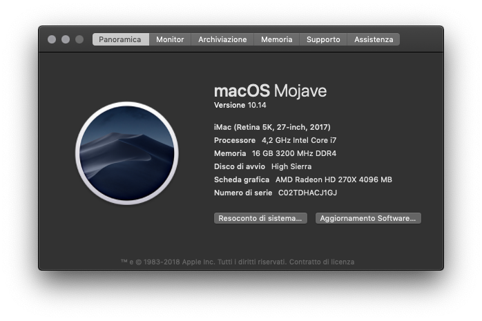

daeron666 Posted September 27, 2018 Share Posted September 27, 2018 (edited) 1 hour ago, Cyberdevs said: Post the whole EFI folder and I'll take a look. The 20 points drop in cinebench score is not usual unless the iGPU is totally disabled which can explain the performance drop. Add this under the Kernel and Kext Patches name: com.apple.kext.AMD7000Controller find: 37787878 replace: 32373058 comment: The 7xxx fix is: Change 7xxx to 270X There is my efi https://drive.google.com/file/d/1i7-0VLYg-5naqgHF8gIQiFhPBLQ_g4B1/view?usp=sharing Do you think is better to see the iGPU too even for FCPX performance? Now I see this Edited September 27, 2018 by daeron666 Link to comment https://www.insanelymac.com/forum/topic/334881-how-to-fix-quicklook-and-preview-loading-issues-in-mojave/page/7/#findComment-2637266 Share on other sites More sharing options...

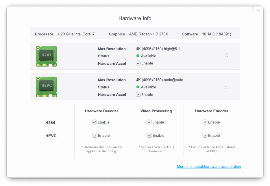

Cyberdevs Posted September 27, 2018 Share Posted September 27, 2018 49 minutes ago, daeron666 said: There is my efi https://drive.google.com/file/d/1i7-0VLYg-5naqgHF8gIQiFhPBLQ_g4B1/view?usp=sharing Do you think is better to see the iGPU too even for FCPX performance? Your EFI folder seems ok, download the MacX Video Converter Pro and see if the hardware encoding support is enabled, if it is enabled it means that Intel Graphics is detected by macOS and there's no need to add the extra setting in config, if not you can use the same config. You might need to do a system cache rebuild to make macOS rebuild the kext caches after you make the changes. Link to comment https://www.insanelymac.com/forum/topic/334881-how-to-fix-quicklook-and-preview-loading-issues-in-mojave/page/7/#findComment-2637280 Share on other sites More sharing options...
daeron666 Posted September 27, 2018 Share Posted September 27, 2018 (edited) 55 minutes ago, Cyberdevs said: Your EFI folder seems ok, download the MacX Video Converter Pro and see if the hardware encoding support is enabled, if it is enabled it means that Intel Graphics is detected by macOS and there's no need to add the extra setting in config, if not you can use the same config. You might need to do a system cache rebuild to make macOS rebuild the kext caches after you make the changes. I see it in istats, but not in system, I see a great slowdown in games and the GPU processor is always at 100%..... Edited September 27, 2018 by daeron666 Link to comment https://www.insanelymac.com/forum/topic/334881-how-to-fix-quicklook-and-preview-loading-issues-in-mojave/page/7/#findComment-2637289 Share on other sites More sharing options...
Cyberdevs Posted September 27, 2018 Share Posted September 27, 2018 If you see a decrease in performance revert back to your previous settings and re run the tests and compare the results. WEG can affect the GPUs performance on some cases. Link to comment https://www.insanelymac.com/forum/topic/334881-how-to-fix-quicklook-and-preview-loading-issues-in-mojave/page/7/#findComment-2637291 Share on other sites More sharing options...

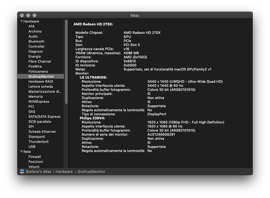

daeron666 Posted September 27, 2018 Share Posted September 27, 2018 Is the iGPU correctly configured? Link to comment https://www.insanelymac.com/forum/topic/334881-how-to-fix-quicklook-and-preview-loading-issues-in-mojave/page/7/#findComment-2637308 Share on other sites More sharing options...
Cyberdevs Posted September 28, 2018 Share Posted September 28, 2018 13 hours ago, daeron666 said: Is the iGPU correctly configured? can you please update your signature with the details of your hardware specs? Link to comment https://www.insanelymac.com/forum/topic/334881-how-to-fix-quicklook-and-preview-loading-issues-in-mojave/page/7/#findComment-2637380 Share on other sites More sharing options...

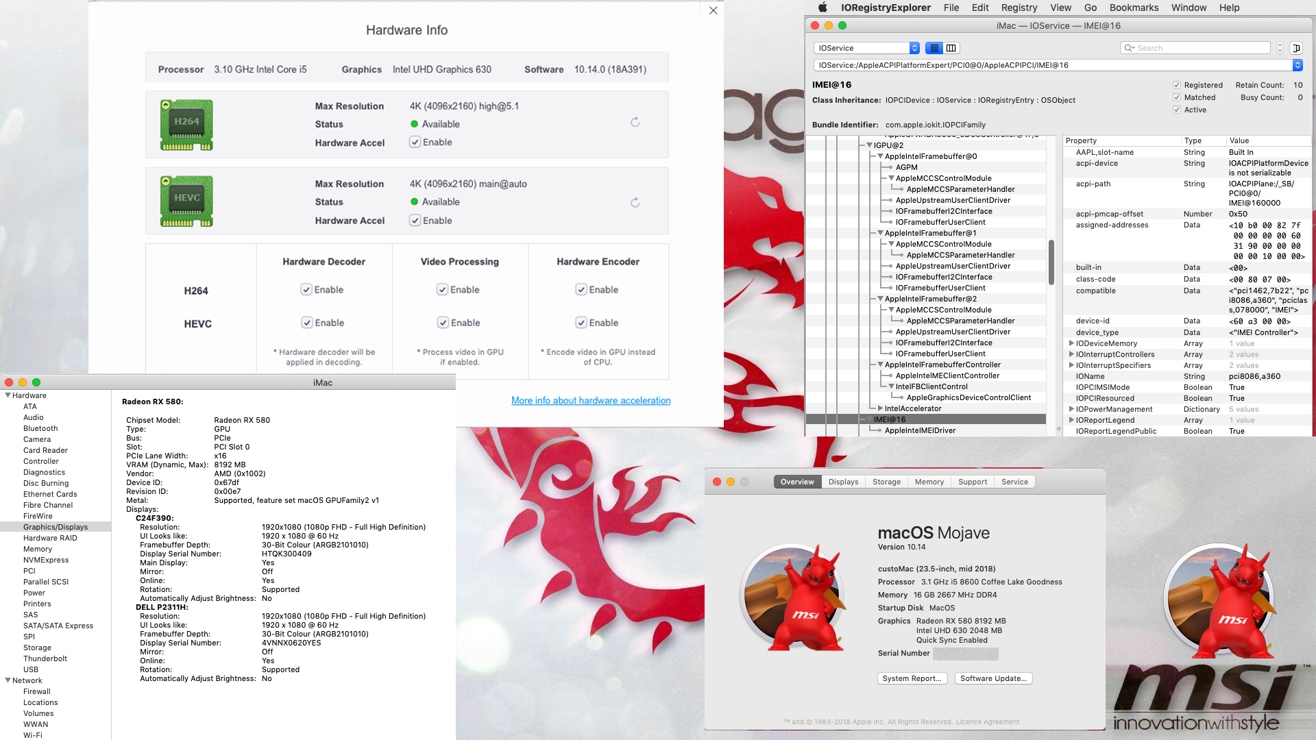

onemanOSX Posted September 30, 2018 Share Posted September 30, 2018 I just would like to share my experience with my new MSI B360 board here. What I did: 1. enable integrated graphics in bios 2. PEG set as primary 3. Using Whatevergreen patching+ lilu In About This Mac, no trace of iGPU is shown except for the RX 580. However, in ioreg clearly IMEI is loaded and using MacX Video Converter Pro, prove that hardware encoding is enabled. So yeah, I initially thought About This Mac is an indicative but I got fooled However, if you'd like to see the cosmetics display in About This Mac, injecting intel in clover with ig-platform-id is the way to go. Cheers to the OP for the guide! Link to comment https://www.insanelymac.com/forum/topic/334881-how-to-fix-quicklook-and-preview-loading-issues-in-mojave/page/7/#findComment-2637849 Share on other sites More sharing options...
