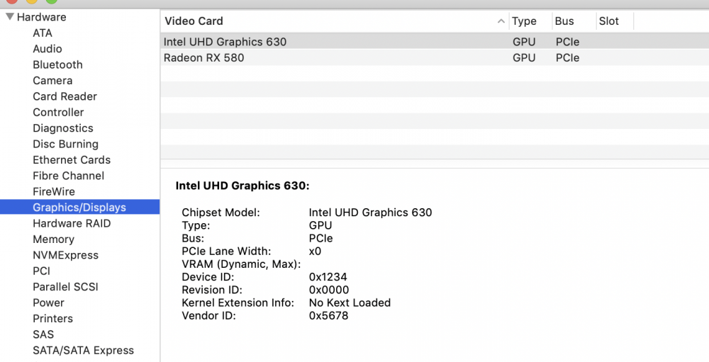

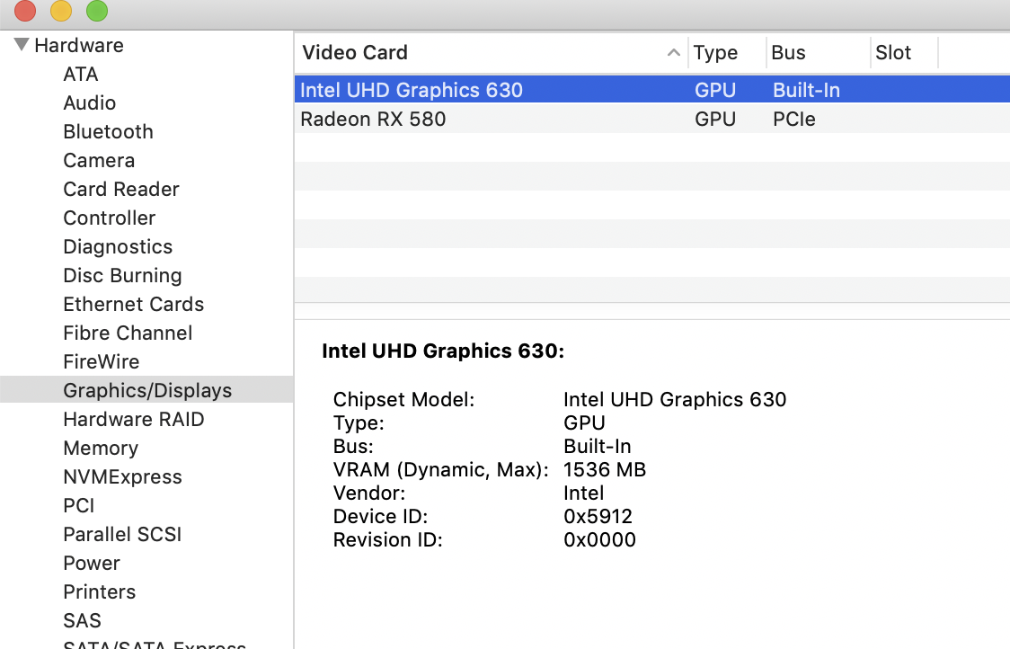

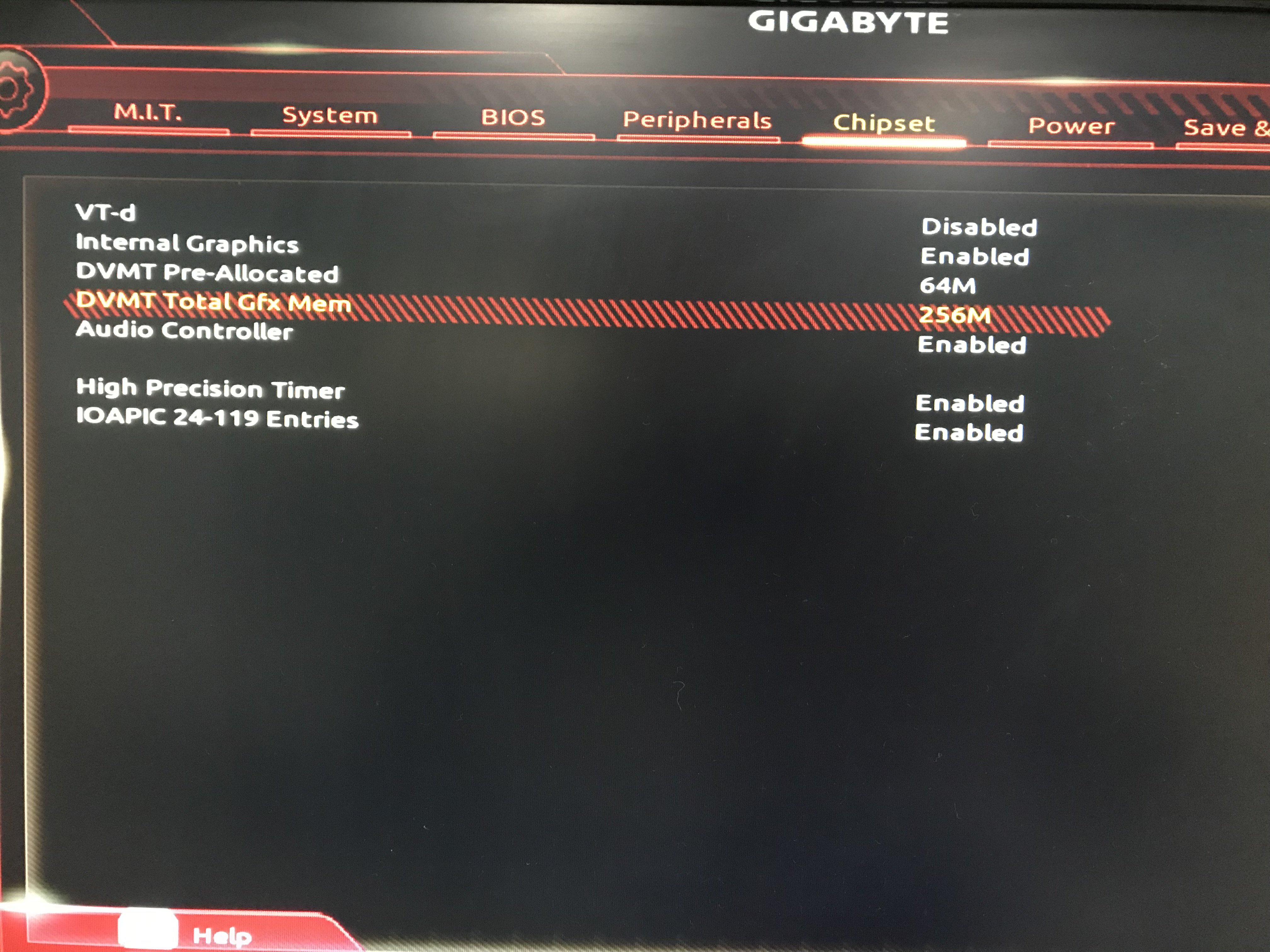

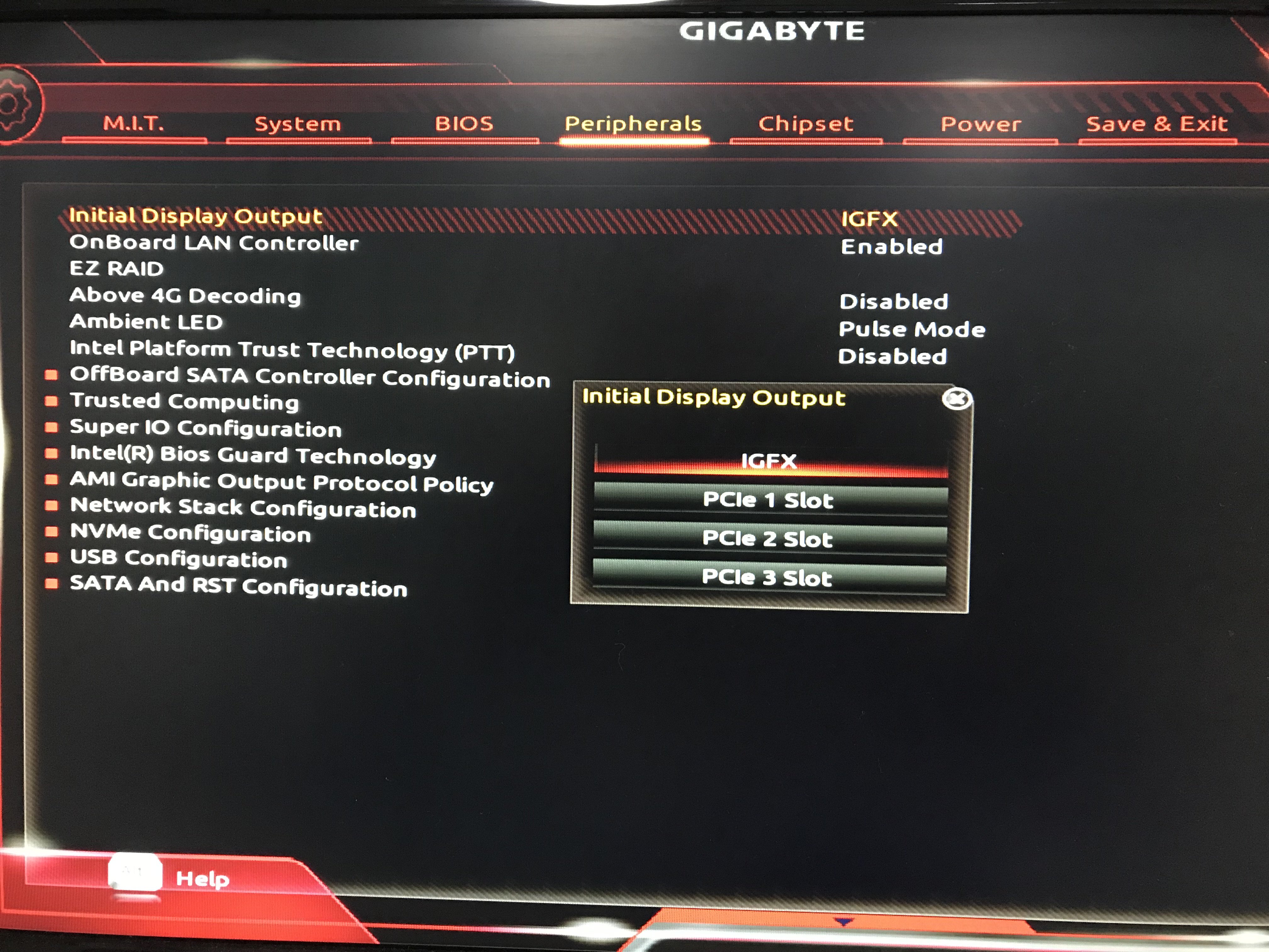

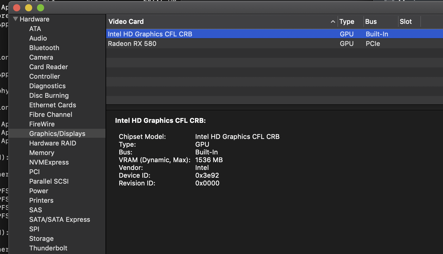

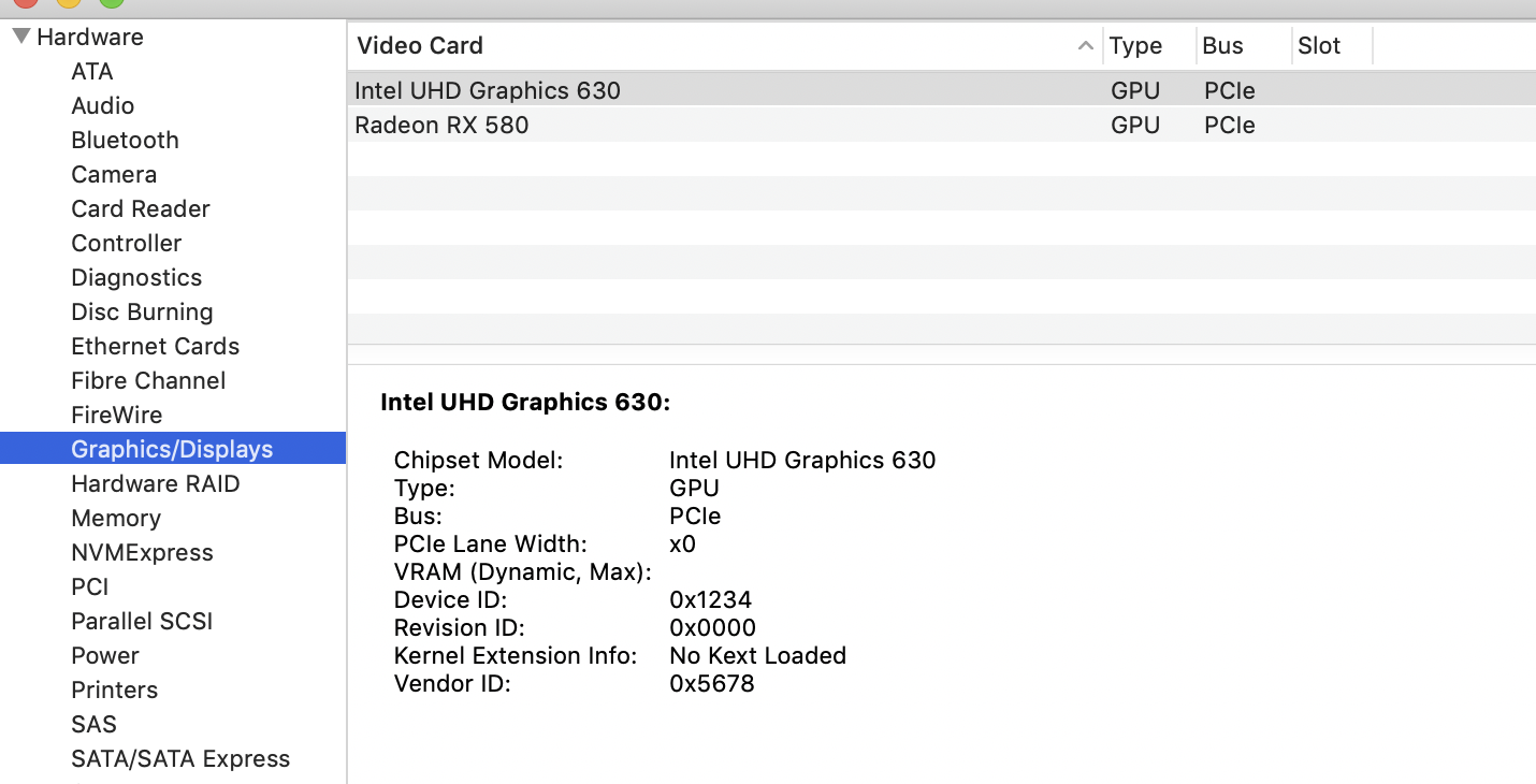

jerryy2 Posted July 18, 2018 Share Posted July 18, 2018 (edited) I am still having problems with jpg images in preview and Quicklook using today’s Public Beta update. Gigabyte Z370XP SLI, bios version F7 I5-8400 Bios settings: DVMT Memory 64M, Total available: 256M Primary graphics: IGPU Internal Graphics Enabled Gigabyte Aorus RX580 8GB macOS 10.14 Public Beta Three: (18A336e), Clover version 4586 With the new update, Quicklook and Preview gained the ability to view TIFFs and play .mov files. Various kinds of camera raw images are NOT viewable in Quicklook or Preview, while the finder has always shown the thumbnails correctly for every kind of image filetype I have tried so far. The QuickLook slideshow (select a bunch of images in the finder, then press the Option key - Spacebar combination) will not display jpgs in slideshow mode, but will display them at various large sizes in index sheet mode. Once an image is chosen though, the slideshow module crashes of course. Selecting a bunch of TIFFs only for the slideshow results in the slideshow module operating correctly, but it crashes in index mode once an individual image is chosen. As far as transparency goes in Light Mode or Dark Mode, it seems to work,. The menu bar is slightly translucent in Light Mode, but it is there, the translucency is more apparent in Dark Mode. Safari now works with a bunch more media heavy websites than before. At this point I am wondering if this issue is a problem with the frame buffer settings. Using Inject Intel = true along with IntelGFX = 0x12345678, the hardware report shows I have Intel UHD Graphics 630, no kext loaded, no known vendor or device id Using Inject Intel = true along with IntelGFX = 0x0, the hardware report shows I have Intel UHD Graphics 630, Vendor: Intel, device id: 5912 Using Inject Intel = false along with IntelGFX = 0x0, the hardware report shows I have Intel HD Graphics CFL CRB, Vendor: Intel, device id: 3e92 I connected a monitor to the motherboard HDMI connector, and observed it though the boot process, it did not show the initial BIOS screen or the Clover screen, but did show the ‘wall of text’ — the list of complaints that apfs has about the superblock pointing to a jump place, but it was not started from there, then pauses until the main monitor screen attached to the GPU comes on with the login screen at which point the motherboard connected monitor goes to black screen. Which is why I think there may be a framebuffer issue going on. Any ideas as to how to get Quicklook and Preview working? Thank you for your help! Edited July 18, 2018 by jerryy2 Added processor type Link to comment https://www.insanelymac.com/forum/topic/334881-how-to-fix-quicklook-and-preview-loading-issues-in-mojave/#findComment-2626292 Share on other sites More sharing options...
arsradu Posted July 19, 2018 Author Share Posted July 19, 2018 (edited) Hmm... For AMD issues, I think @Cyberdevs might be able to help you better. Intel 630 is Kabylake, right? Did you try to add the correct ig-platform-id? I think you might need iMac18,2/iMac18,3 SMBIOS and ig-platform-id 0x59120000. Also, in case you don't already have that, I would also recommend using IntelGraphicsFixup kext in Clover/kexts/Other. The thing is, for as far as I could tell from my limited time spent fiddling with this, you need to have the iGPU correctly set up first, before attempting this trick. As I said, I'm not an expert in AMD cards. This might or might not help. But this is what I'd do first. Try to get the iGPU to work properly, boot properly and all that. After that, it should be only a matter of BIOS switch. Edited July 19, 2018 by arsradu Link to comment https://www.insanelymac.com/forum/topic/334881-how-to-fix-quicklook-and-preview-loading-issues-in-mojave/#findComment-2626478 Share on other sites More sharing options...
