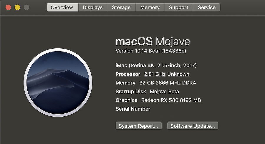

arsradu Posted July 19, 2018 Author Share Posted July 19, 2018 (edited) Hehe. I have already changed my config plist with yours and backed it up in 3 places I boot from from PCI now and everything works as it should. vt-d disabled. iGFX enabled with 32 MB allocated. That's all. I see, so pretty much like in my pictures. Peripherals -> Initial Display Output -> iGFXChipset -> Internal Graphics -> Enabled DVMT Pre-Allocation -> default 64M (you chose 32M).You might wanna leave it 64M though. ) I'm pretty sure that won't harm anything. But in case it does, you can always switch it back, since you know exactly what you've changed. So that should be an easy fix. DVMT Total Gfx Mem -> 256M Thank you! Today was a good day for science. Edited July 19, 2018 by arsradu 1 Link to comment https://www.insanelymac.com/forum/topic/334881-how-to-fix-quicklook-and-preview-loading-issues-in-mojave/page/2/#findComment-2626539 Share on other sites More sharing options...

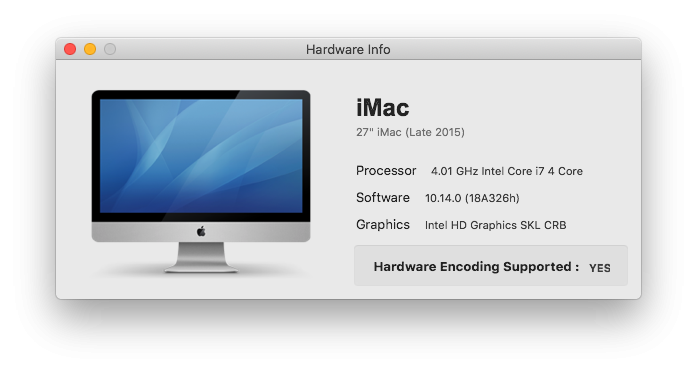

Cyberdevs Posted July 20, 2018 Share Posted July 20, 2018 Well I came to that conclusion about the AMD GPU being set as the primary by examining an 2017 27" iMac with an AMD RX 570 GPU and the result was that there was no issue in transparency in light mode and a working Quick Look and preview. Another thing that I found interesting was that there is no need to inject Intel and the ig-platform-id for my SkyLake rig on Mojave in which case the iGPU would be recognized as "Intel HD Graphics SKL CRB" without any injections and that's how the macOS is recognized it in the iMac as well except for the SKL part which was the KBL (for the KabyLake CPU) and if I inject Intel and the ig-platform-id it will be recognized as "Intel HD Graphics 530" @arsradu About the nVidia GPUs I'm not sure why it's happening but I suspect that it's because of the SMBIOS settings. I have a hunch which is that we usually set the SMBIOS in regard to the CPU but it can be set in regard to the GPU as well (this can explain the Black Screen Issue on several SMBIOS Settings as well), but yet again it's a hunch. For example iMac Late 2012 (Compatible SMBIOS is iMac13,x) has an IvyBridge CPU with a GeForce GTX 675MX GPU and it supports Mojave if you are up to it you can give it a try and test it with Mojave by changing the GPU settings in BIOS/UEFI from iGPU to dGPU and see if the issue still persist with the transparency and Quick Looks and no iGPU injections. You can also give the iMacPro's SMBIOS a test and see how it works. @Pavo has already confirmed that on his Xeon rig by using the iMacPro SMBIOS those issues were fixed and his rig has no issues regarding the transparency and Quick Looks without an iGPU. The iMacPro SMBIOS solved the black screen issue as well when I was still using my 1070 GPU on my SkyLake rig last year. 1 1 Link to comment https://www.insanelymac.com/forum/topic/334881-how-to-fix-quicklook-and-preview-loading-issues-in-mojave/page/2/#findComment-2626613 Share on other sites More sharing options...
arsradu Posted July 20, 2018 Author Share Posted July 20, 2018 Well I came to that conclusion about the AMD GPU being set as the primary by examining an 2017 27" iMac with an AMD RX 570 GPU and the result was that there was no issue in transparency in light mode and a working Quick Look and preview. Another thing that I found interesting was that there is no need to inject Intel and the ig-platform-id for my SkyLake rig on Mojave in which case the iGPU would be recognized as "Intel HD Graphics SKL CRB" without any injections and that's how the macOS is recognized it in the iMac as well except for the SKL part which was the KBL (for the KabyLake CPU) and if I inject Intel and the ig-platform-id it will be recognized as "Intel HD Graphics 530" [mention=1303722]arsradu[/mention] About the nVidia GPUs I'm not sure why it's happening but I suspect that it's because of the SMBIOS settings. I have a hunch which is that we usually set the SMBIOS in regard to the CPU but it can be set in regard to the GPU as well (this can explain the Black Screen Issue on several SMBIOS Settings as well), but yet again it's a hunch. For example iMac Late 2012 (Compatible SMBIOS is iMac13,x) has an IvyBridge CPU with a GeForce GTX 675MX GPU and it supports Mojave if you are up to it you can give it a try and test it with Mojave by changing the GPU settings in BIOS/UEFI from iGPU to dGPU and see if the issue still persist with the transparency and Quick Looks and no iGPU injections. You can also give the iMacPro's SMBIOS a test and see how it works. [mention=685502]Pavo[/mention] has already confirmed that on his Xeon rig by using the iMacPro SMBIOS those issues were fixed and his rig has no issues regarding the transparency and Quick Looks without an iGPU. The iMacPro SMBIOS solved the black screen issue as well when I was still using my 1070 GPU on my SkyLake rig last year.That is interesting. Yeah, I set the SMBIOS in regards to the CPU (i5 4570 —> iMac14,2). Never thought about the GPU. I’ll give it a try tonight and let you know how it went. Now i’m curious. 1 Link to comment https://www.insanelymac.com/forum/topic/334881-how-to-fix-quicklook-and-preview-loading-issues-in-mojave/page/2/#findComment-2626615 Share on other sites More sharing options...

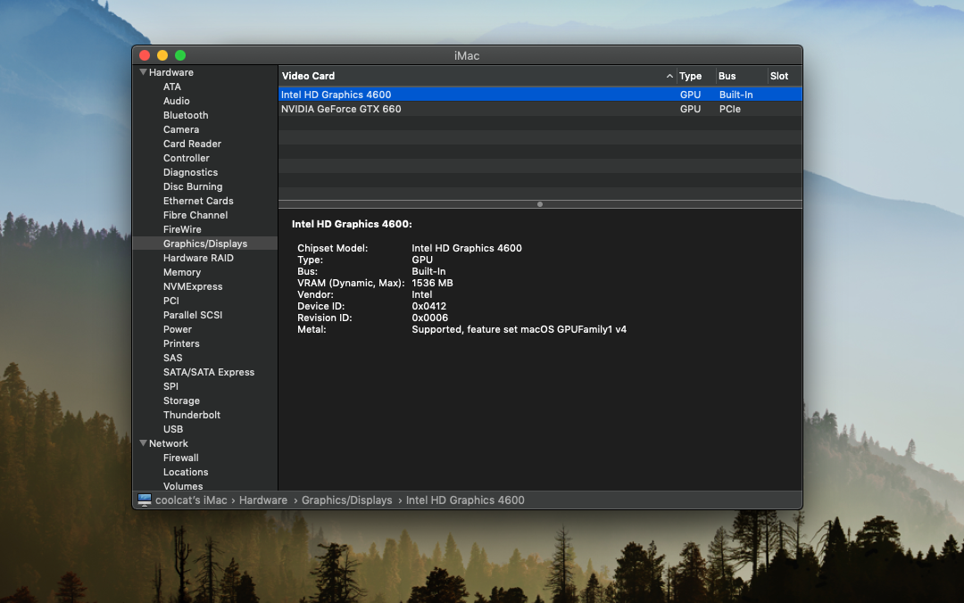

arsradu Posted July 20, 2018 Author Share Posted July 20, 2018 (edited) @Cyberdevs I tested the iMac13,2 SMBIOS. BIOS set to PEG (dedicated GPU). I've got this to say: LOL. It freaking WORKS! :)))))) WHAT THE ACTUAL F...ORK??!!! :))) So, tested: 1. Switched from IGD to PEG (the control, just to make sure I'm not crazy and it really doesn't work by default with iMac14,2 and BIOS set to PEG). English: switched from integrated GPU to dedicated GPU in BIOS. Result: It does not work. Which is both good and bad. Good, cause it means I'm not crazy (that's always nice to hear). Bad, cause, well, it doesn't work. :)) 2. Created a new config with iMac13,2 SMBIOS and rebooted to it from Clover->Options->Configs->ConfigiMac13,2.plist Result: everything works fine 3. Removed Inject Intel and ig-platform-id from this config Result: all fine 4. Removed IntelGraphicsFixup kext form Clover/kexts/Other Result: all fine Edited July 20, 2018 by arsradu 1 Link to comment https://www.insanelymac.com/forum/topic/334881-how-to-fix-quicklook-and-preview-loading-issues-in-mojave/page/2/#findComment-2626719 Share on other sites More sharing options...
Cyberdevs Posted July 20, 2018 Share Posted July 20, 2018 27 minutes ago, arsradu said: @Cyberdevs I tested the iMac13,2 SMBIOS. BIOS set to PEG (dedicated GPU). I've got this to say: LOL. It freaking WORKS! :)))))) WHAT THE ACTUAL F...ORK??!!! :))) So, tested: 1. Switched from IGD to PEG (the control, just to make sure I'm not crazy and it really doesn't work by default with iMac14,2 and BIOS set to PEG). English: switched from integrated GPU to dedicated GPU in BIOS. Result: It does not work. Which is both good and bad. Good, cause it means I'm not crazy (that's always nice to hear). Bad, cause, well, it doesn't work. :)) 2. Created a new config with iMac13,2 SMBIOS and rebooted to it from Clover->Options->Configs->ConfigiMac13,2.plist Result: everything works fine 3. Removed Inject Intel and ig-platform-id from this config Result: all fine 4. Removed IntelGraphicsFixup kext form Clover/kexts/Other Result: all fine So you can confirm my hypothesis? Link to comment https://www.insanelymac.com/forum/topic/334881-how-to-fix-quicklook-and-preview-loading-issues-in-mojave/page/2/#findComment-2626721 Share on other sites More sharing options...
arsradu Posted July 20, 2018 Author Share Posted July 20, 2018 (edited) 10 minutes ago, Cyberdevs said: So you can confirm my hypothesis? Well, I don't have to. Facts do. ) Looks like you were right. Or..otherwise this is a really weird and very lucky coincidence. Aaand I don't believe in that. So yeah, I'd say you were right! Now I wish I had a GTX 770 at hand to test the iMac14,2 as well. ) But yeah, today I learned something new. Thank you! Edited July 20, 2018 by arsradu 1 Link to comment https://www.insanelymac.com/forum/topic/334881-how-to-fix-quicklook-and-preview-loading-issues-in-mojave/page/2/#findComment-2626723 Share on other sites More sharing options...

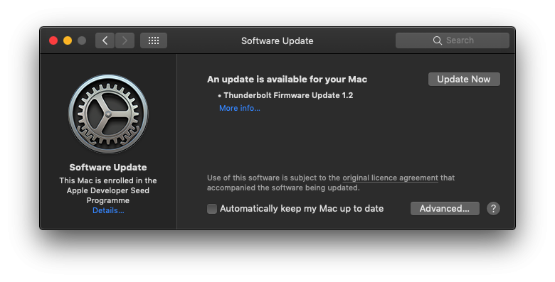

arsradu Posted July 20, 2018 Author Share Posted July 20, 2018 (edited) Guys, did you get this kind of updates before...? Problem is...it doesn't really get installed. I mean, it completes the installation successfully. But, after reboot, it asks for the same update again. Is this intended? Edited July 20, 2018 by arsradu Link to comment https://www.insanelymac.com/forum/topic/334881-how-to-fix-quicklook-and-preview-loading-issues-in-mojave/page/2/#findComment-2626731 Share on other sites More sharing options...
