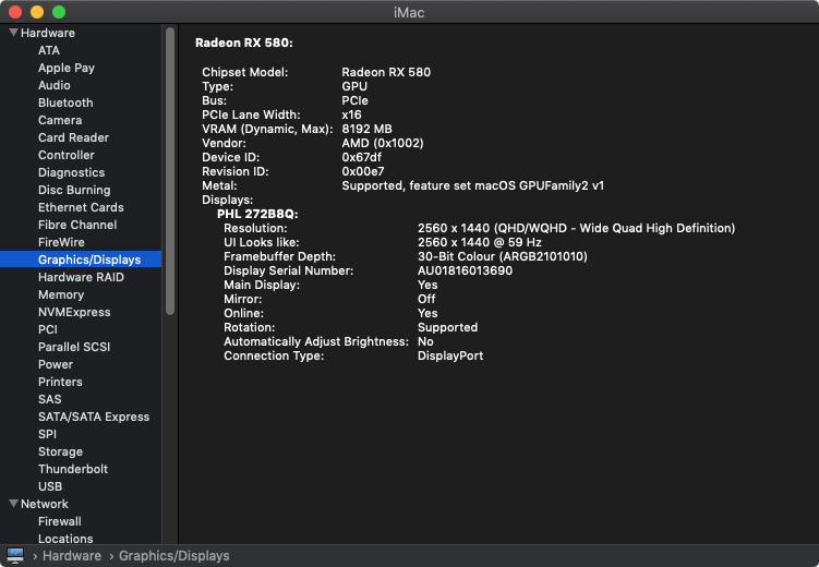

arsradu Posted December 5, 2018 Author Share Posted December 5, 2018 (edited) 2 hours ago, unixb0y said: Hey guys, I have the iMac 18,3 SMBIOS and deactivated iGPU - most elegant solution IMHO as I have the i5-8600K and a RX580 GPU. Unfortunately quick view and Preview both don't work with JPEG images. I tried the kext (NoVPAJpeg.kext) in CLOVER/kexts/Other where I also have Lilu.kext but it didn't work. Anything else that I could try to make it work? Thanks in advance! Dave Yes, enable the iGPU. Another solution, as I mentioned before, is to switch to a MacPro/iMacPro SMBIOS. Edited December 5, 2018 by arsradu Link to comment https://www.insanelymac.com/forum/topic/334881-how-to-fix-quicklook-and-preview-loading-issues-in-mojave/page/11/#findComment-2652128 Share on other sites More sharing options...
unixb0y Posted December 5, 2018 Share Posted December 5, 2018 18 minutes ago, arsradu said: Yes, enable the iGPU. Another solution, as I mentioned before, is to switch to a MacPro/iMacPro SMBIOS. Okay :/ I was hoping not to need to activate the iGPU or to use a „wrong“ SMBIOS. What if I put the kexts in /L/E instead of the clover path? Link to comment https://www.insanelymac.com/forum/topic/334881-how-to-fix-quicklook-and-preview-loading-issues-in-mojave/page/11/#findComment-2652131 Share on other sites More sharing options...

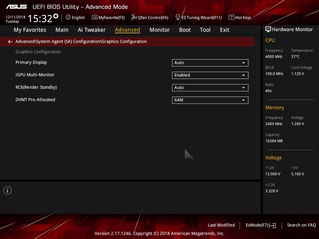

woodoodm Posted December 11, 2018 Share Posted December 11, 2018 Confirm: Just enabling Multi GPU in the BIOS solves JPG and Video preview and playback. Asus Z170i PRO Gaming + i7-6700K Link to comment https://www.insanelymac.com/forum/topic/334881-how-to-fix-quicklook-and-preview-loading-issues-in-mojave/page/11/#findComment-2653208 Share on other sites More sharing options...
arsradu Posted December 11, 2018 Author Share Posted December 11, 2018 2 hours ago, woodoodm said: Confirm: Just enabling Multi GPU in the BIOS solves JPG and Video preview and playback. Asus Z170i PRO Gaming + i7-6700K You mean Multi-monitor? If not, could you, please, provide a screenshot of the Multi GPU option from your BIOS? Question: do you have WhateverGreen kext installed? Or checked InjectIntel in Clover config.plist? Enabling the iGPU in BIOS is one step, but not the only one, for as far as I know. Link to comment https://www.insanelymac.com/forum/topic/334881-how-to-fix-quicklook-and-preview-loading-issues-in-mojave/page/11/#findComment-2653216 Share on other sites More sharing options...

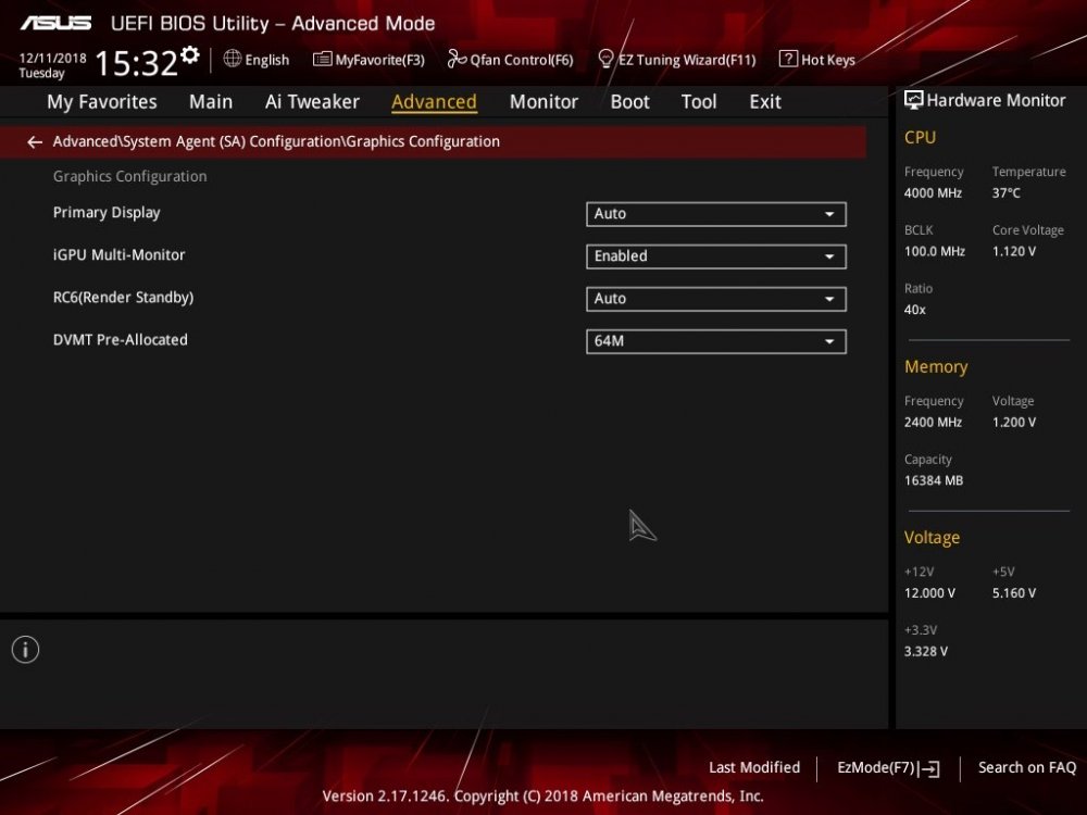

woodoodm Posted December 11, 2018 Share Posted December 11, 2018 7 hours ago, arsradu said: You mean Multi-monitor? If not, could you, please, provide a screenshot of the Multi GPU option from your BIOS? Question: do you have WhateverGreen kext installed? Or checked InjectIntel in Clover config.plist? Enabling the iGPU in BIOS is one step, but not the only one, for as far as I know. Yes, Multi-monitor, sorry. With this adjustments, .JPG and video preview works fine with Asus Z170i PRO Gaming + i7-6700K and Radeon RX 560 4G 1 Link to comment https://www.insanelymac.com/forum/topic/334881-how-to-fix-quicklook-and-preview-loading-issues-in-mojave/page/11/#findComment-2653274 Share on other sites More sharing options...
vpv Posted December 16, 2018 Share Posted December 16, 2018 (edited) On 12/11/2018 at 4:39 PM, woodoodm said: Yes, Multi-monitor, sorry. With this adjustments, .JPG and video preview works fine with Asus Z170i PRO Gaming + i7-6700K and Radeon RX 560 4G Just registered to say thank you. Enabling IGPU multi monitor solved my jpeg preview issue. My system uses an Asus h87m pro motherboard with an i74770 cpu and an amd rx 580 gpu. For the IGPU I have inject intel enabled and set the platform id to 0x0d220003 For the gpu I have nothing in the config.plist (The only issue I have left is that drm playback stopped working after the last two Mojave updates.) Edited December 16, 2018 by vpv Link to comment https://www.insanelymac.com/forum/topic/334881-how-to-fix-quicklook-and-preview-loading-issues-in-mojave/page/11/#findComment-2654031 Share on other sites More sharing options...

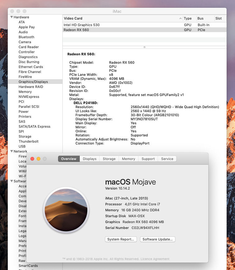

SavageAUS Posted December 19, 2018 Share Posted December 19, 2018 If i have my iGPU enabled to fix this issue should it show up in system info? I can't remember. Link to comment https://www.insanelymac.com/forum/topic/334881-how-to-fix-quicklook-and-preview-loading-issues-in-mojave/page/11/#findComment-2654510 Share on other sites More sharing options...
arsradu Posted December 19, 2018 Author Share Posted December 19, 2018 36 minutes ago, SavageAUS said: If i have my iGPU enabled to fix this issue should it show up in system info? I can't remember. It does in my case. But it also depends which SMBIOS are you using. If you went the iMacPro/MacPro route to fix this, since those don't have iGPUs, they will also not display it in that section. If you went with something like the iMac14,2 which does have an iGPU, it should show up here, if everything is properly set up in Clover config. Link to comment https://www.insanelymac.com/forum/topic/334881-how-to-fix-quicklook-and-preview-loading-issues-in-mojave/page/11/#findComment-2654515 Share on other sites More sharing options...
