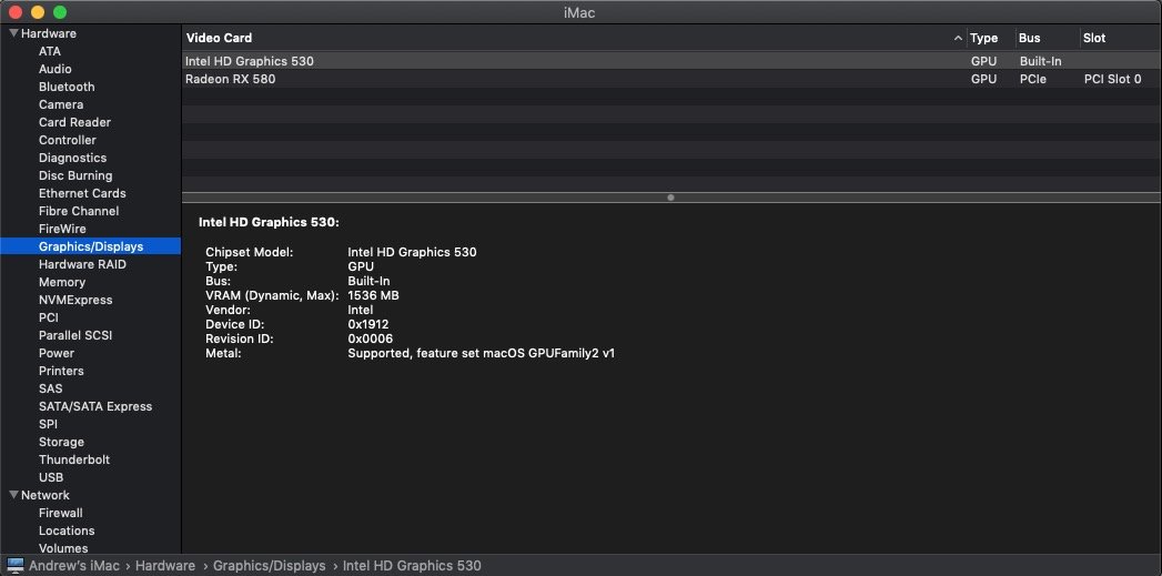

Thanks for the help but I am pleased to say I have got it working. I had another look at my BIOS and found the IGPU in the advanced system agent. I enabled it and my preview is working perfectly.

As a followup to my earlier posting, I have been able to get this working on my Coffee Lake system I wrote about earlier. (Gigabyte Z370XP SLI, i5-8400, RX-580) The recent Public Beta (18A365a) added some more systems into the graphics support, Pavo wrote this somewhere in the main Mohave pre-release thread.
I used Clover Configurator to generate the smbios section for an iMac Pro, removed stuff like the firmware features, etc. -- letting Clover generate that information, and replaced this small smbios section in my main config.plist, took the machine offline and restarted. Preview and QuickLook worked as they should. I did not have to turn on the IGPU in the BIOS settings, nor use inject-intel = true or make any other changes.
So Pavo's idea about the smbios settings waaaaaay back when does look like it is on the mark. Hopefully Apple will keep adding more systems so that Preview and QuickLook work right, after all iTunes, Safari, pretty much all of the other apps use jpegs and display them correctly already.

I believe for iMac17,1 SMBIOS you need to leave the iGPU on because in a real iMac17,1 the intel hd 530 frambuffer is loading when macOS starts, even though there's no RX580 chipset for the dGPU in the iMac17,1 but it is how it's defined.
