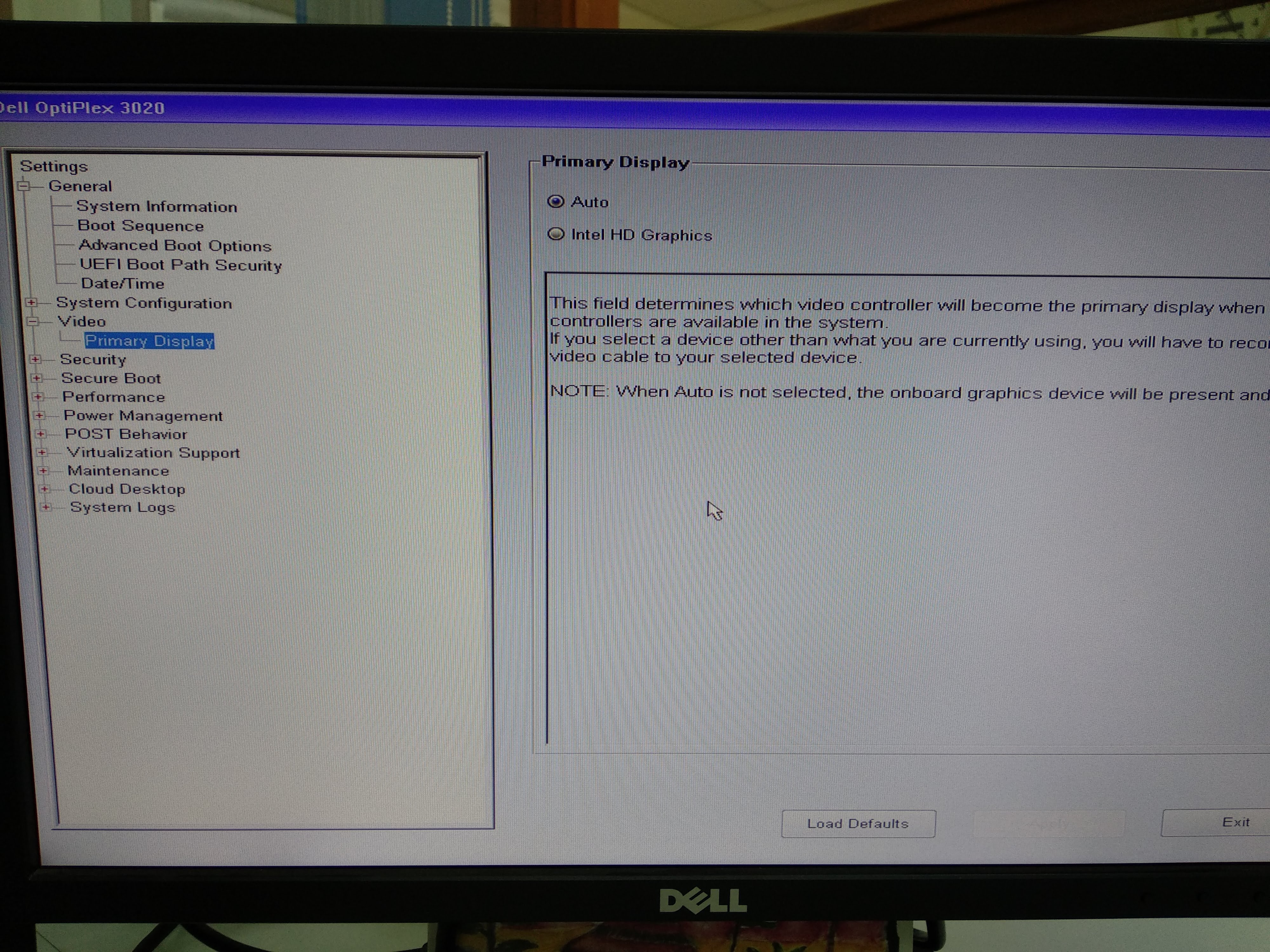

Thank you for your response.
I have tried your suggestions, removed IntelGraphicsFixup kext which I added just to experiment for the solution. Moreover, I tried changing SMBIOS to iMac14,2 and also Inject System ID but the problem is still there.
I added my signature to give you more detail about my system. I have DP and VGA onboard on my system and the LCD is connected to Display Port.
Thanks
Bhaggu
Thanks
Bhaggu
That motherboard is not looking good. I remember you said you don't use a dedicated graphics card, so, you can't switch to that, but can you share the video options you've got and their status (enabled/disabled etc) from your BIOS? Screenshots would be even better.
Config-wise, it looks good to me. So...I'm afraid all of this might go down to motherboard and BIOS.
I never liked these pre-built systems. They put all kinds of c**p in them.
Edited by arsradu

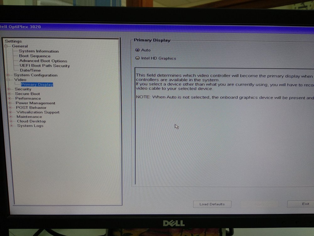

 I have two option in Video Auto and Intel, I have tried both but no luck.
EDIT: Updated to Final release but still same issue. :(
Edited by bhaggu

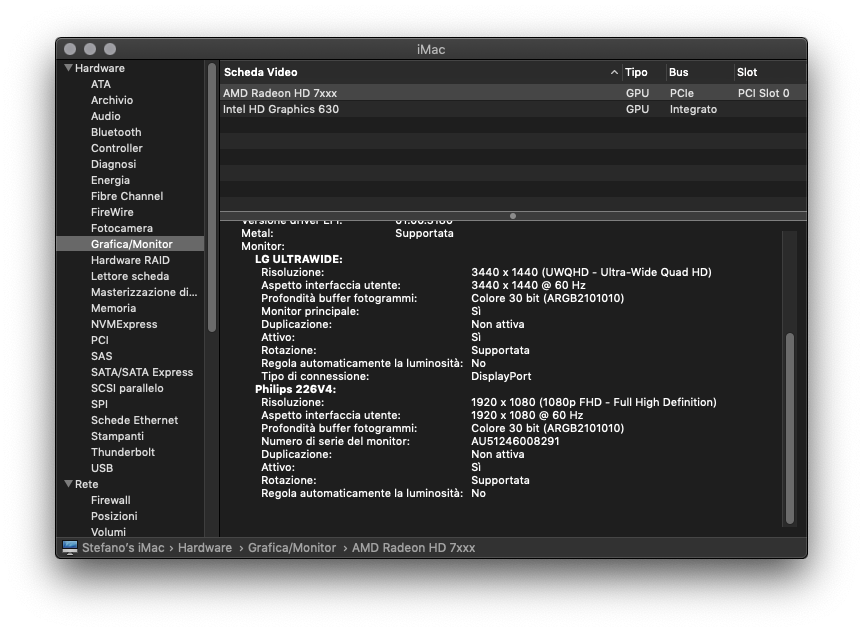

25 minutes ago, daeron666 said:
Hi guys, I followed the guide but something didn't work.
I see the 2 vga but still have problems with preview, and now it takes a loooong time to boot.
Can you help me?
My config MSI Tomahawk Z270, 7700k, R9 270X.
Can you help me?
config.plist
You see two GPUs because you inject both AMD and Intel GPUs in your config.plist you don't need to inject any of them, Mojave will detect the iGPU automatically and the R9 270x doesn't need to be injected as well.
Remove all those injections and try again, make sure that you have a working backup of your existing EFI before making any changes to your current setting.
  • Thanks 1
Damn, that was some fast summoning. :))) Many, many thanks for your feedback! This thread just wouldn't be the same without it.

I tried but nothing changed.
Otherwise it recognize as AMD Radeon HD 7xxx (even with inject ATI).
Please help me....
Added new modified config.plist
config.plist
Edited by daeron666

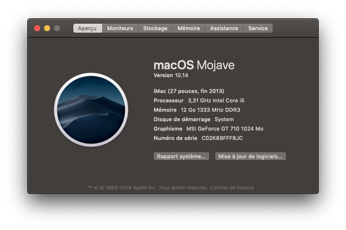

Hi,
Here is my config :
MB Asus P8P67 Pro rev 3.1 without iGPU.
GPU is a Nvidia GT710 (A GT210 by the past, before Mojave).
Clover 4674.
I'm experiencing the same "JPG quick look issue".
Everything else works perfectly with this configuration that I've always used since OSX Lion (except for the recently installed GT710 for Mojave).
I never used Lilu and Watevergreen. Just installed this 2 kexts but still the problem. Is there particulars parameters to use with them ?379955718_Capturedcran2018-09-2715_09_46.png.e1be78c79944161609aeae196a8cbd59.png
config.plist
Edited by d.o.n.g.h.w.a.n
Please help me....
config.plist
Changing the AMD Radeon HD 7xxx to AMD Radeon HD 270X is cosmetic it has no effect on the performance, there are several fixes for that and the easies one is to use WhateverGreen+lilu. It will help macOS to detect the correct framebuffer for your AMD GPU and it also fixes the incorrect AMD GPU detection along with the fix for the preview and quick look.
You can also use the clover's Kernel and Kext Patches to fix 7xxx . What I suggest is to trying to fix the preview and quick look issue first and once it's fixed we can fix other issues.
  • Thanks 1
20 minutes ago, daeron666 said:
Now preview works, but I see only radeon hd 7xxx.
For best performance should I see the hd630 too?
I see on cinebench now my score is 110, with high sierra it was 130...
Post the whole EFI folder and I'll take a look.
The 20 points drop in cinebench score is not usual unless the iGPU is totally disabled which can explain the performance drop.
Add this under the Kernel and Kext Patches
find: 37787878
replace: 32373058
comment: The 7xxx fix is: Change 7xxx to 270X
