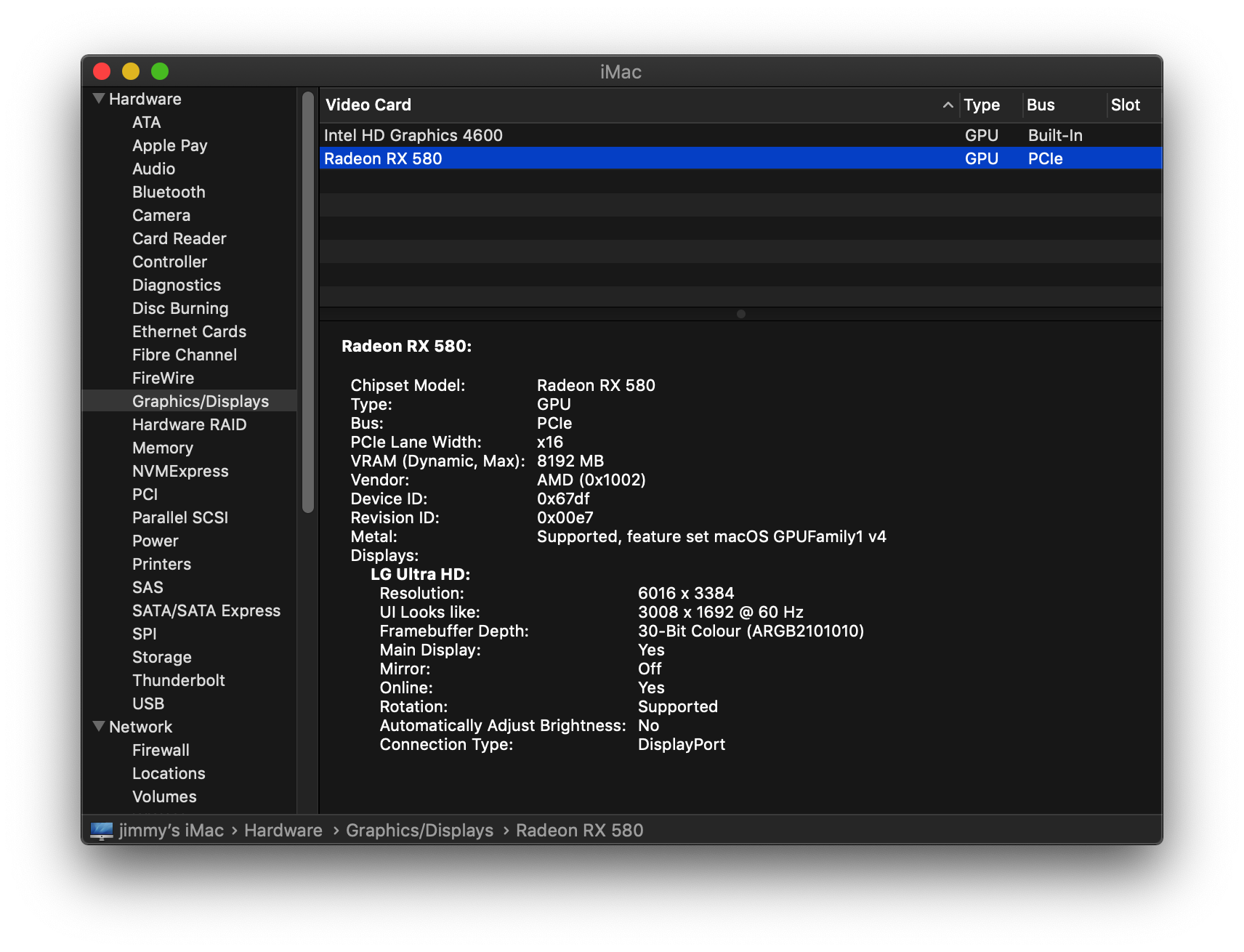

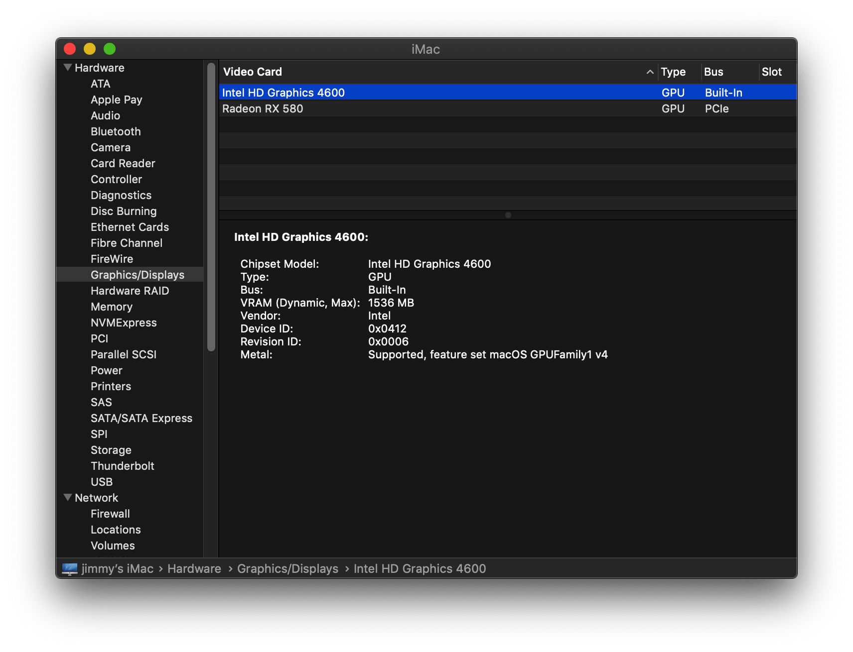

@SavageAUS Looks like it is properly displayed in my case. :) So...yeah, I'd say probably the config needs a bit more tweaking.
696798399_Screenshot2018-12-19at23_09_06.thumb.png.8236f27c9579dfe99a144b76be5a0b5c.png
1965952847_Screenshot2018-12-19at23_09_14.thumb.png.133796af0910cb356cf08f7627f1f8d8.png

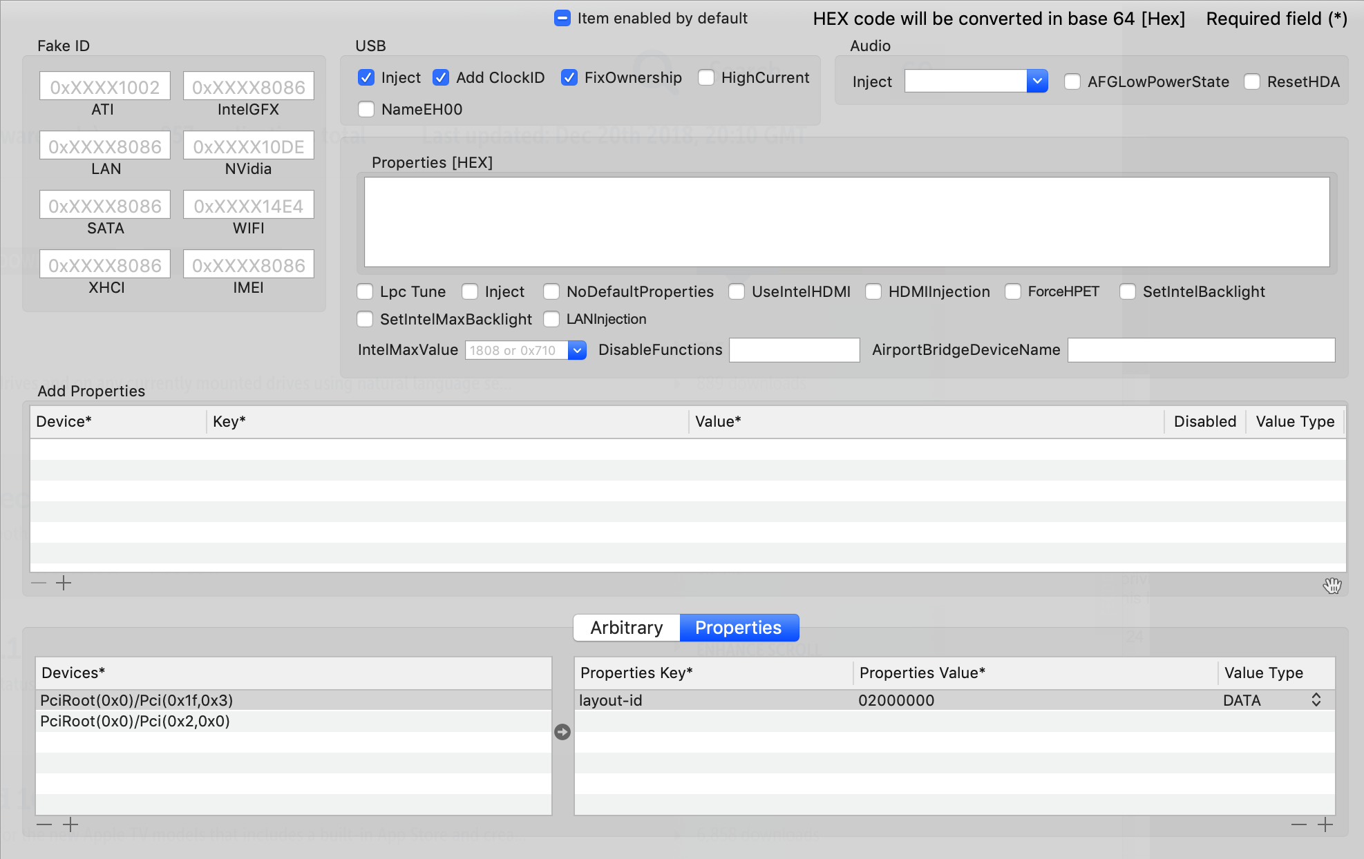

This is my config. Quicklook and preview both work.

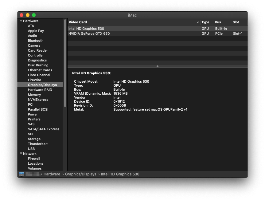

Anyway, I managed to get it working on a Skylake build, as well. Motherboard: GA-Z170-Gaming K3, CPU: 6600K, iGPU: Intel Graphics HD 530, dGPU: GTX 650 OC 2GB. iMac17,1 SMBIOS.
In BIOS, I set these things:
  1. Peripherals -> Initial Display Output -> iGFX
  2. Chipset -> Internal Graphics -> Enabled
         DVMT Pre-Allocation -> default 64M.
         DVMT Total Gfx Mem -> default 256M
  3. Save
  4. Reboot

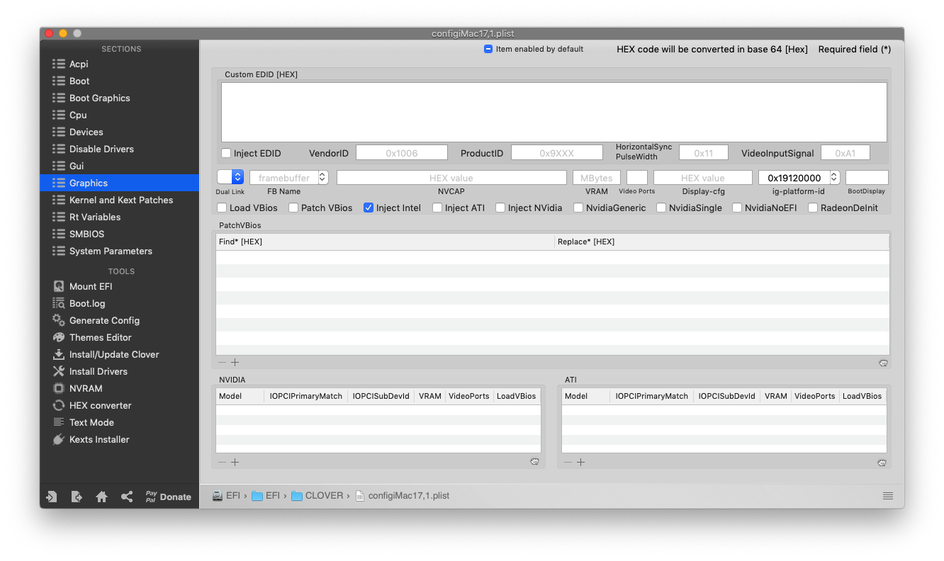

In Clover config, I set these things:
101152012_Screenshot2018-12-20at12_45_27.thumb.png.57260e76c6d52e732c852e2cbfaac447.png
Aaaand....TA-DAAA!
I'll let you judge the result for yourself. :)
Oh, forgot to mention: QuickLook and Preview work, as well.

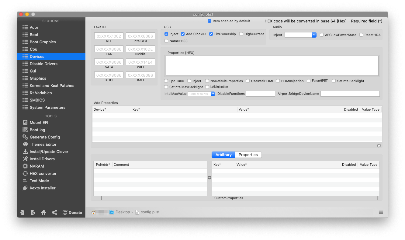

On that screenshot you posted of devices you have arbitrary highlighted at the bottom, if you select properties you will see where it’s set.
Sent from my iPhone using Tapatalk
You mean this?
If so, I don't know... Never used this method before. But...doesn't seem to work for what you're trying to accomplish.
1054541528_Screenshot2018-12-20at23_24_00.thumb.png.845d7ab2ff1fc590a7ad281d60ce163d.png
Also, I think I'm probably missing something here, but isn't Layout ID used for analog audio...? What does that have to do with the iGPU?
Anyway... You have an alternative method in my previous post, which I'm pretty sure it will work since both builds are using the exact same iGPU, if you wanna give it a try. :) I'd love to hear your results.

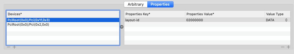

This one is Audio yes

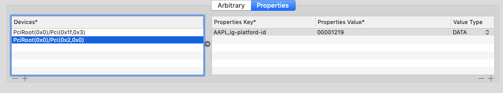

But this one is iGPU
Wait, i see the problem, spelling mistake in platform.
Edited by SavageAUS
1 minute ago, SavageAUS said:
Just fixed it and it still isn't showing up in system report.
Doesn't matter, it's working.
As I mentioned before, you might want to add Inject Intel, as well, to your Clover config. In my experience, it will not show up without it. :)
Anyway, I'm glad it works. :)

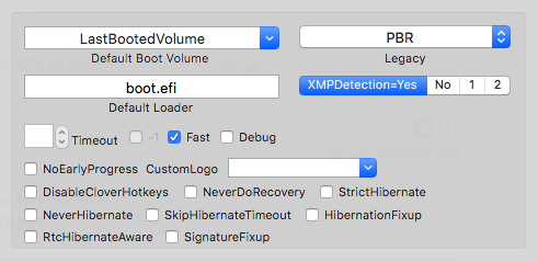

Nope, debug is actually off and "Fast" is on :D
Well, compared to the speed of a drunk snail on drugs, a few minutes is definitely fast. LOL
But...weird... I don't have this issue. Could be a problem with newer motherboards maybe....or could be something else related to the config... I don't know, I've never encountered this issue before, unless Debug was set to True. And even then it wasn't THAT long.
