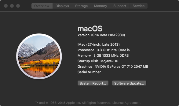

MacPeet Posted February 7, 2019 Author Share Posted February 7, 2019 (edited) 3 hours ago, cele_82 said: Thanks man, I have a Core2Quad 9650(with SSE4) and a nvidia GT610. This worked like a charm in 10.9 wondering if the nvidia GT610 is ok with 10.13 ? 10.13.x yes, 10.14.x no ((restricted with rollback from the HS, currently only until 10.14.3) With Beta's 10.14.4 it does not currently work.) GT710 works OOB with Sierra, High Sierra and Mojave. Currently no problems with my Optiplex 780 and GT 710 with Mojave 10.14.4 DP2 Beta. Everything works. Edited February 7, 2019 by MacPeet Link to comment Share on other sites More sharing options...

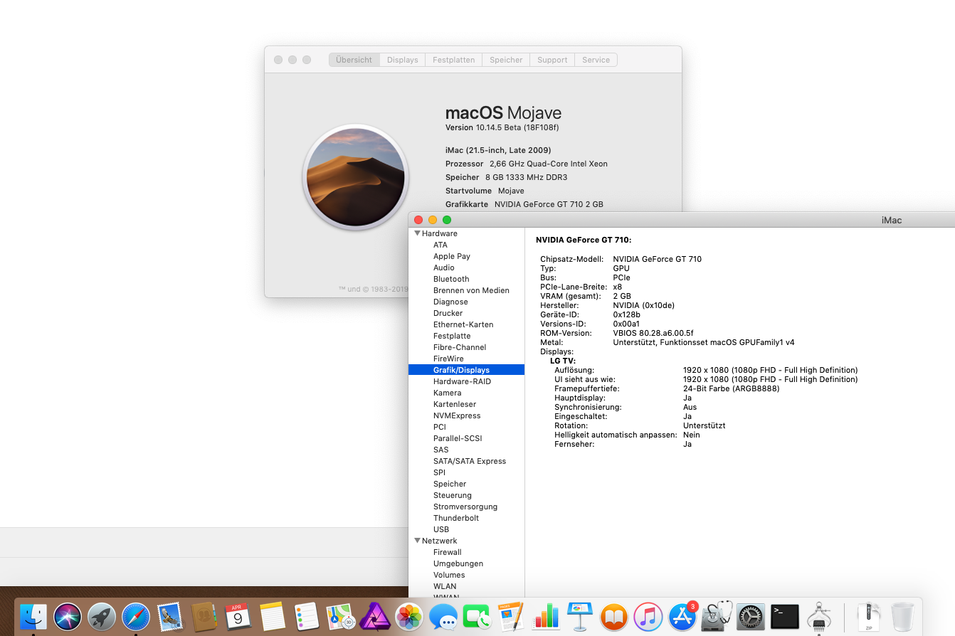

MacPeet Posted April 9, 2019 Author Share Posted April 9, 2019 @ cele_82 No, nobody has written yet. In principle as in 10.13! 10.14 needs the telemetry patch and Optiplex780 needs rollback AppleHDA, as already described. HD5450 no longer works with Mojave. You need a GT710, for example, which supports metal graphics. You have to read a lot and find your way to Mojave yourself. Currently I have no time and no desire for a guide. The old box is still working with 10.14.5 DP2: 2 Link to comment Share on other sites More sharing options...

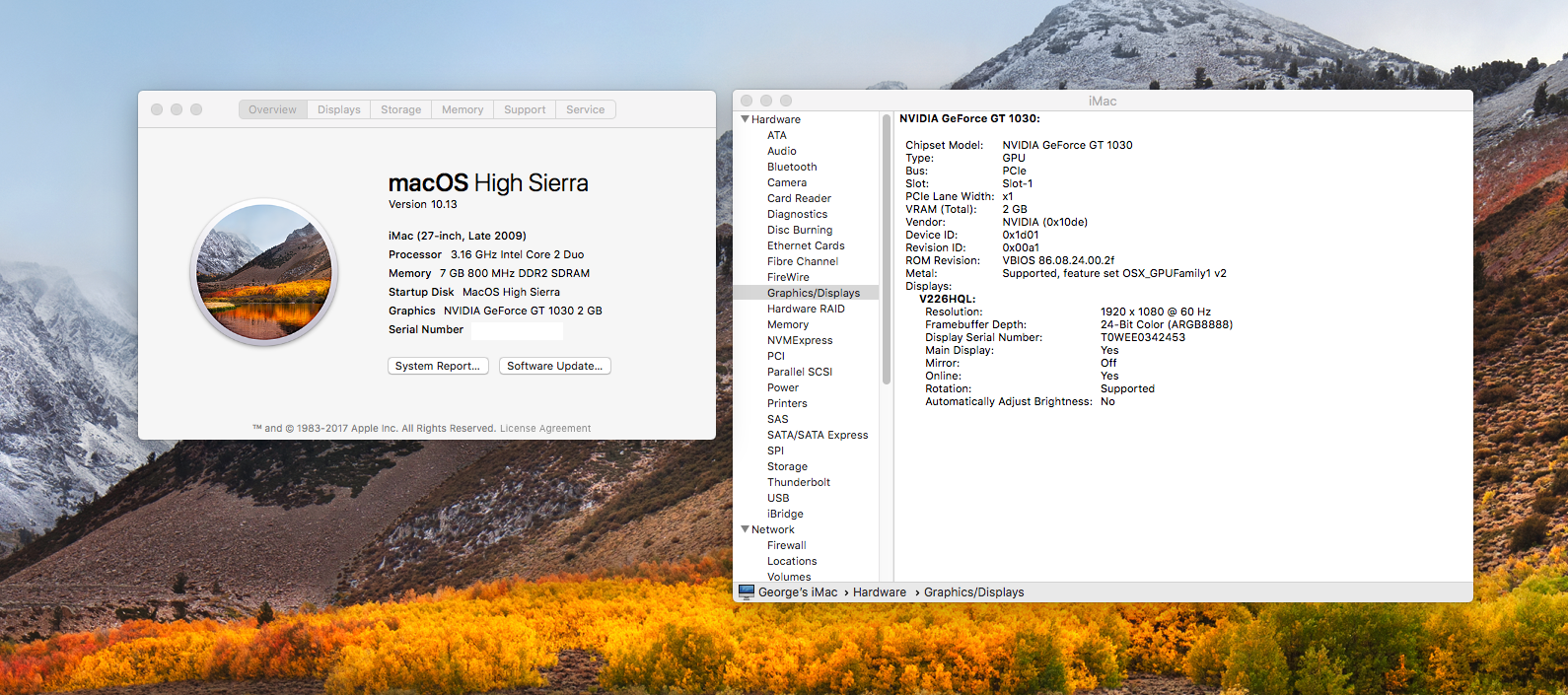

georgeg16 Posted May 12, 2019 Share Posted May 12, 2019 Hey everyone, I don't know if this thread is dead but I need help with one little thing. I have just installed High Sierra 10.13.0 and used Rico's dsdt and config, now when I boot from Clover it just goes to a black screen while it's loading half way. I saw on here people using a GT1030 which is what I have but I don't know why it doesn't work for me. Cheers guys Link to comment Share on other sites More sharing options...
MacPeet Posted May 13, 2019 Author Share Posted May 13, 2019 Thread is not dead. GT1030 needs web driver. Boot with boot flag nv_disable=1 into the system, then install nvidia web driver for 10.13.x !!! x = (pay attention to the version) !!! Link to comment Share on other sites More sharing options...
georgeg16 Posted May 13, 2019 Share Posted May 13, 2019 5 hours ago, MacPeet said: Thread is not dead. GT1030 needs web driver. Boot with boot flag nv_disable=1 into the system, then install nvidia web driver for 10.13.x !!! x = (pay attention to the version) !!! I did, I made sure I downloaded the right version of the Web Drivers according to my build number. I tried lilu and whatevergreen kexts but it hasn't made any difference Link to comment Share on other sites More sharing options...
chris1111 Posted May 13, 2019 Share Posted May 13, 2019 (edited) 5 minutes ago, georgeg16 said: I did, I made sure I downloaded the right version of the Web Drivers according to my build number. I tried lilu and whatevergreen kexts but it hasn't made any difference See my EFI you have config GT 10130 You have all neccesery files in that EFI Edited May 13, 2019 by chris1111 Link to comment Share on other sites More sharing options...
georgeg16 Posted May 13, 2019 Share Posted May 13, 2019 27 minutes ago, chris1111 said: See my EFI you have config GT 10130 You have all neccesery files in that EFI Man you are a life saver!!!! It works now, thank you so much Chris 1 Link to comment Share on other sites More sharing options...

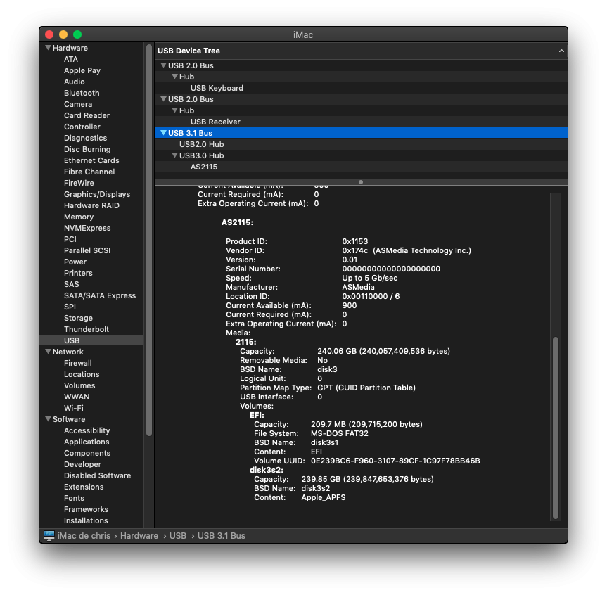

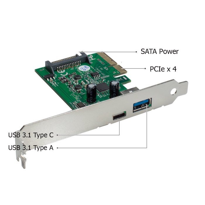

chris1111 Posted May 14, 2019 Share Posted May 14, 2019 (edited) Good news Owner of Dell Optiplex 790 Mediasonic 2 ports USB 3.1 Gen II () 10 Gb/s Carte PCI Express NATIVE macOS Mojave 2 port USB 3.1 for only 30. $ Box can Available here ➣ Mediasonic 2 ports USB 3.1 Gen II () 10 Gb/s Carte PCI Express Edited May 14, 2019 by chris1111 Link to comment Share on other sites More sharing options...

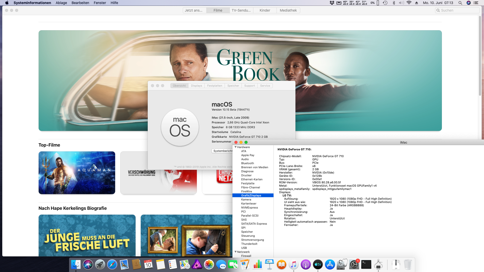

MacPeet Posted June 10, 2019 Author Share Posted June 10, 2019 Good news, my Optiplex780 is still working with Catalina. Installation Catalina directly on my Mojave SSD with SMBIOS iMac13,1 After the installation I am back on SMBIOS iMac10,1. Many new things in Catalina. iTunes no longer exists. This is just music now. Own movies now in AppleTV and podcasts now in the podcast app. Sync iDevices now in the Finder. 1 1 Link to comment Share on other sites More sharing options...
