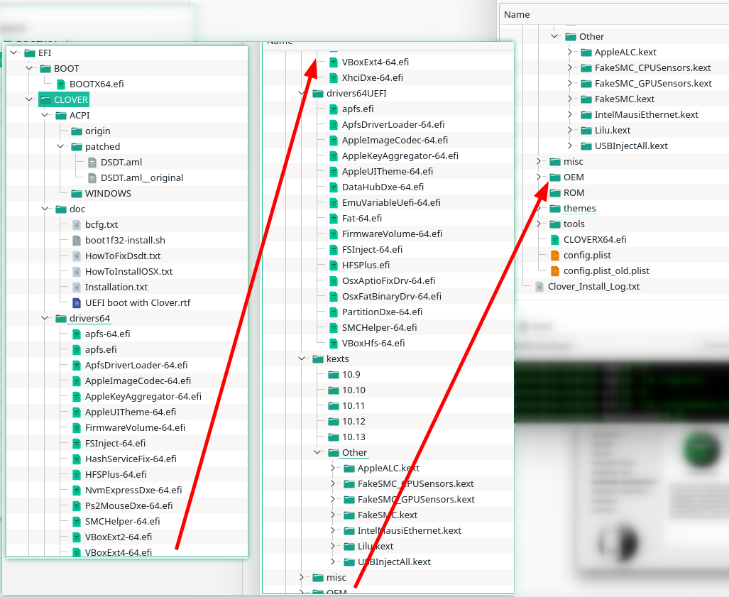

socam77 Posted December 15, 2018 Share Posted December 15, 2018 (edited) Thank you for your response, I've created an new Video-Link (https://youtu.be/AG4kwTlemvg) now to my posting. What do you mean with share the complete EFI you have using? You mean as Zip-File? You mean the one I've made a screenshot of in the previous Post? efi_optiplex990.zip Edited December 15, 2018 by socam77 Add a file Link to comment https://www.insanelymac.com/forum/topic/332512-guide-macos-high-sierra-1013-dell-optiplex-780-760-755-790-990/page/14/#findComment-2653953 Share on other sites More sharing options...
chris1111 Posted December 15, 2018 Share Posted December 15, 2018 (edited) 2 hours ago, socam77 said: Thank you for your response, I've created an new Video-Link (https://youtu.be/AG4kwTlemvg) now to my posting. What do you mean with share the complete EFI you have using? You mean as Zip-File? You mean the one I've made a screenshot of in the previous Post? efi_optiplex990.zip Video not available Your EFI is not good! You have mixed Driver fileVault and driversUEFI You have also a DSDT patch for Radeon HD try this EFI and let me known Change the EFI Folder by this one attaching here Reboot type F12 select USB Device then boot Type space bar select Verbose boot then go up then boot to macOS EFI.zip Edited December 16, 2018 by chris1111 1 Link to comment https://www.insanelymac.com/forum/topic/332512-guide-macos-high-sierra-1013-dell-optiplex-780-760-755-790-990/page/14/#findComment-2653961 Share on other sites More sharing options...
socam77 Posted December 16, 2018 Share Posted December 16, 2018 I've replaced my /EFI at USB-Stick with yours. Thats the results: Booting -v show the output at booting-time at the Moment the GUI is loaded, the Screen becomes light, and the Fan of the GT 220 stops (or runs slower) You can't see anything at the screen, but only that it's light gray (even not the mousepointer). You can wait as long you wan't nothing else happend. So I tried to put Nvidia to vesa-mode. That starts the GUI in right way. After this, I'd do like before: Remove partition Create a new one. Start the installer. But installation abort like before. Here the Video: Link to comment https://www.insanelymac.com/forum/topic/332512-guide-macos-high-sierra-1013-dell-optiplex-780-760-755-790-990/page/14/#findComment-2654061 Share on other sites More sharing options...
chris1111 Posted December 16, 2018 Share Posted December 16, 2018 4 minutes ago, socam77 said: I've replaced my /EFI at USB-Stick with yours. Thats the results: Booting -v show the output at booting-time at the Moment the GUI is loaded, the Screen becomes light, and the Fan of the GT 220 stops (or runs slower) You can't see anything at the screen, but only that it's light gray (even not the mousepointer). You can wait as long you wan't nothing else happend. So I tried to put Nvidia to vesa-mode. That starts the GUI in right way. After this, I'd do like before: Remove partition Create a new one. Start the installer. But installation abort like before. Here the Video: Do you have latest BIOS from Dell for the Optiplex 990 Link to comment https://www.insanelymac.com/forum/topic/332512-guide-macos-high-sierra-1013-dell-optiplex-780-760-755-790-990/page/14/#findComment-2654064 Share on other sites More sharing options...

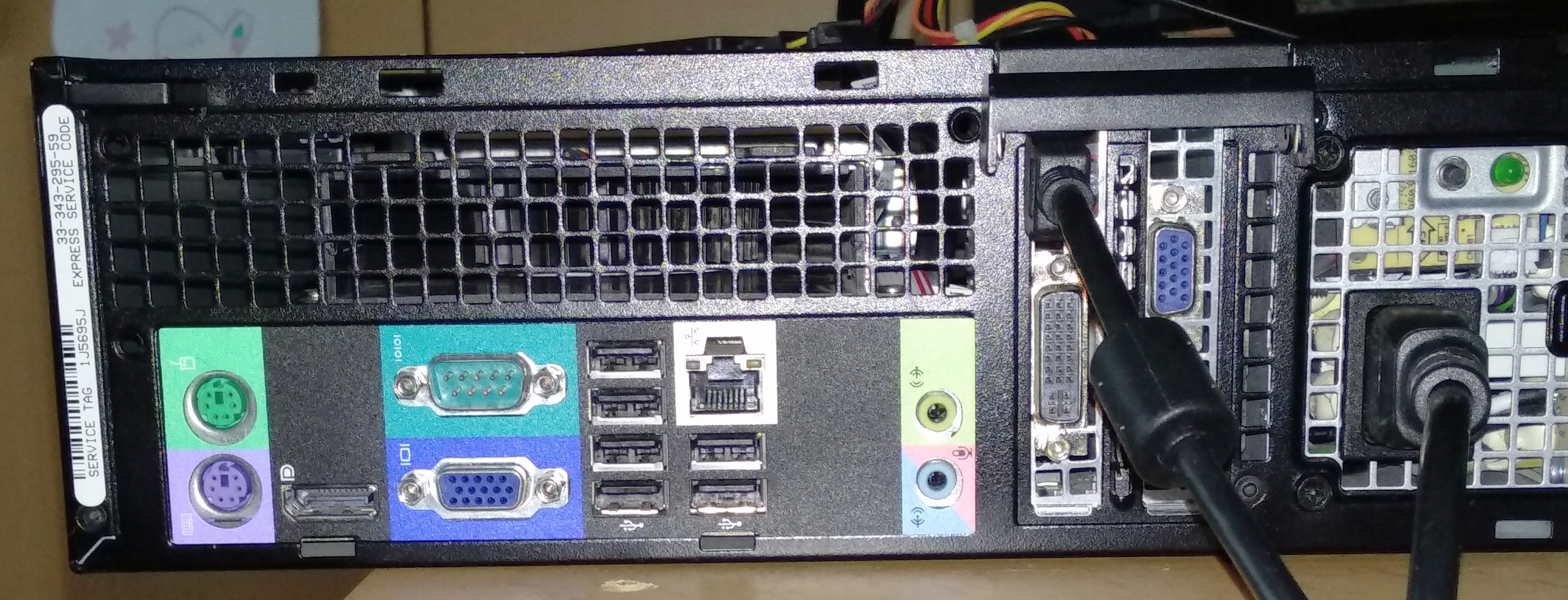

chris1111 Posted December 17, 2018 Share Posted December 17, 2018 1 hour ago, socam77 said: Ok, if I remove Inject Nvidia, the Installer GUI didn't appear. On loading the Installer, the system only reboot. Should I fully remove the NVidia-Card for the install-process? Are you in the DVI port to the graphics card? You can try to remove Video card but use the integrate DisplayPort to HDMI screen or DVI Link to comment https://www.insanelymac.com/forum/topic/332512-guide-macos-high-sierra-1013-dell-optiplex-780-760-755-790-990/page/14/#findComment-2654184 Share on other sites More sharing options...
socam77 Posted December 17, 2018 Share Posted December 17, 2018 I use the HDMI-Port of the graphics-card. The Optiplex 990 doesn't has an integrated hdmi-port as far as I can see. Link to comment https://www.insanelymac.com/forum/topic/332512-guide-macos-high-sierra-1013-dell-optiplex-780-760-755-790-990/page/14/#findComment-2654213 Share on other sites More sharing options...
chris1111 Posted December 17, 2018 Share Posted December 17, 2018 (edited) 11 minutes ago, socam77 said: I use the HDMI-Port of the graphics-card. The Optiplex 990 doesn't has an integrated hdmi-port as far as I can see. I think yes its a DiplayPort You can Buying a Gigabyte GeForce GT 710 working OOB See my signature Edited December 17, 2018 by chris1111 Link to comment https://www.insanelymac.com/forum/topic/332512-guide-macos-high-sierra-1013-dell-optiplex-780-760-755-790-990/page/14/#findComment-2654214 Share on other sites More sharing options...
socam77 Posted December 17, 2018 Share Posted December 17, 2018 I've searched the web and forums arround, and found, that GT 220 even should be supported very good. The pitty is, I don't have a Display-Port Cable, only HDMI: https://de.wikipedia.org/wiki/High_Definition_Multimedia_Interface And this doesn't fit in there. But do you think it's caused of the graphics-card... even if the errors are thrown notice for the apfs-filesystem at the harddrive? Link to comment https://www.insanelymac.com/forum/topic/332512-guide-macos-high-sierra-1013-dell-optiplex-780-760-755-790-990/page/14/#findComment-2654294 Share on other sites More sharing options...
