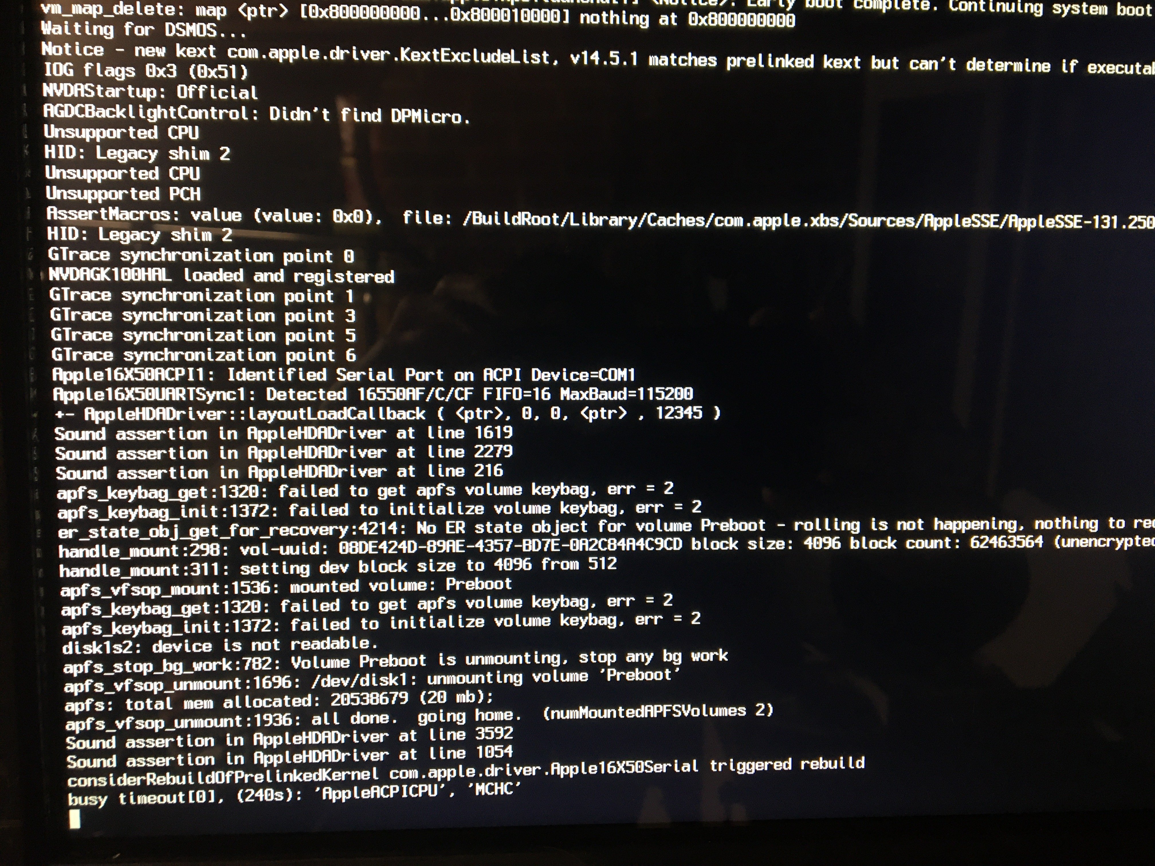

Hello all,
I have a Dell Optiplex 780 (Core 2 Quad 9400), and I am atempting to install macOS Catalina. I used dosdude1's patcher tool to create a bootable installer, and installation went without any issues. I installed Catalina to my internal SSD, but now, when I try to boot from it my system crashes. In verbose, I get all the way to IOConsoleUsers:GIOScreenLock, (When the macOS GUI initializes) however after that message, my system simply reboots. I have attached my config.plist below, any help or guidance anyone can give me would be greatly apreciated.
Specs:
CPU: Core 2 Quad 9400
Ram: 4GB (Stock)
GPU: Nvidia Geforce GT 710
config.plist
1 hour ago, CD100 said:
Hello all,
Specs:
Ram: 4GB (Stock)
config.plist
try this let me know
config.plist.zip
Thank you for your reply
Unfortunately, I have had no luck, even with the new config.plist, the same issue still persists.
I don't know if this is relevant or not, but before the crash I get the following message repeated over lots of times
apfs_spec_read_wrapper:10890:apfs_spec_read_wrapper : f_info->fsroffset 49152IMG_20200126_135426965.thumb.jpg.fbc47caf04d55293f358a8582885a82b.jpg
Again, I don't know if this is actually important or not, but I figured I would mention it.

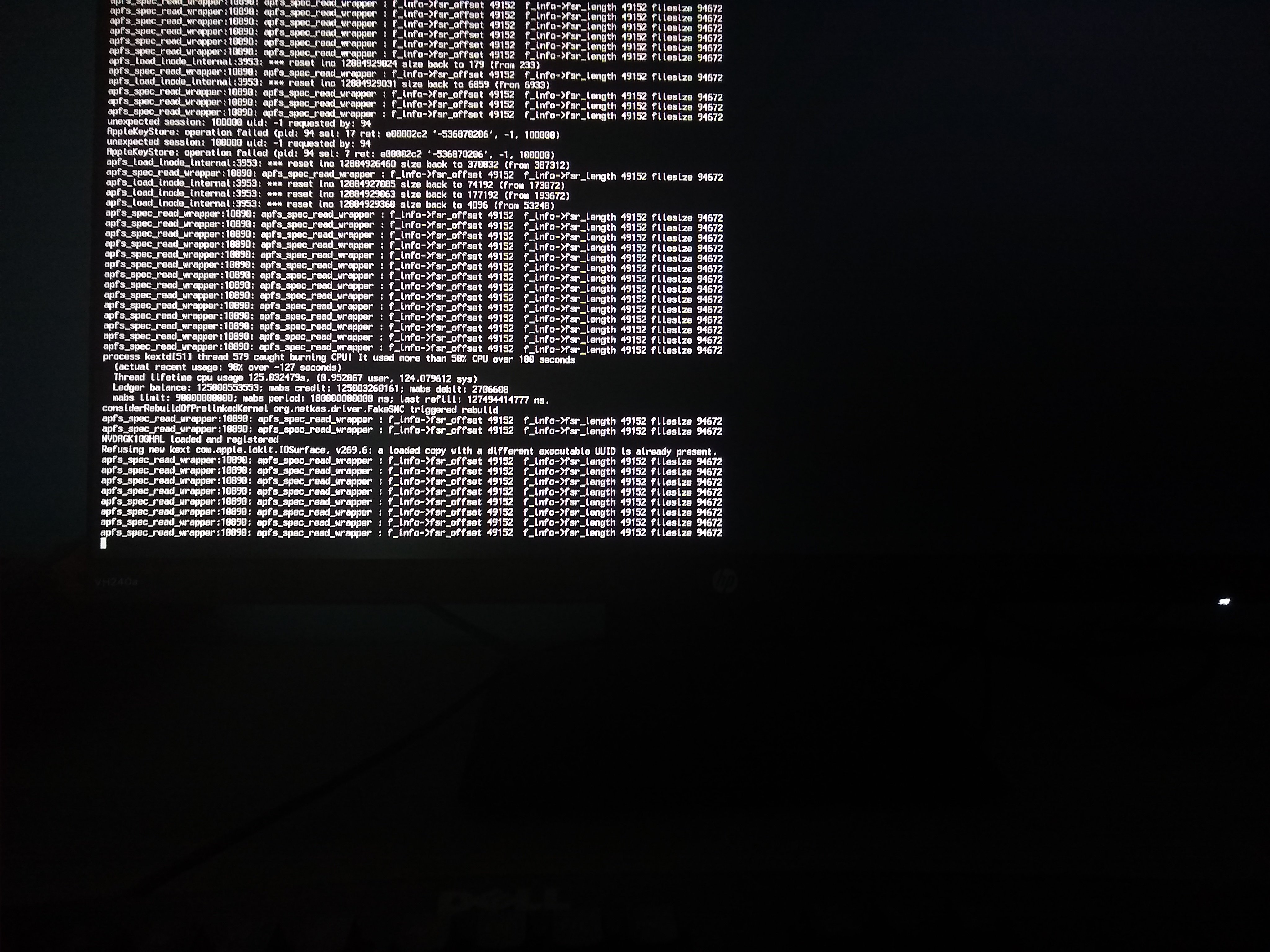

Try to Use this for the USB Installer
then after change the config
7 hours ago, chris1111 said:
With the Geforce 720 don't use AppleALC, use only VoodooHDA
With the 710 no problem to use AppleALC
I ended up putting the 720 back in.
I did exactly what you've said. And it seems to be working perfectly.
Thank you very much for the help, much appreciated. :)
chris1111,
I re-downloaded my Catalina install app (From MAS this time instead of dosdude patch tool) and re created my usb with the method you specified. I then wiped my system disk, and reinstalled from my new usb. Unfortunately it still won't boot to the desktop, and reboots in the same spot. :(
On the bright side, the strange apfs_spec error message is gone, and the system boots much faster now (But still wont boot ALL the way)
Edited by CD100
8 minutes ago, CD100 said:
chris1111,
I think You have to patch the system for the Core 2 Quad 9400
read here how to
Edited by chris1111

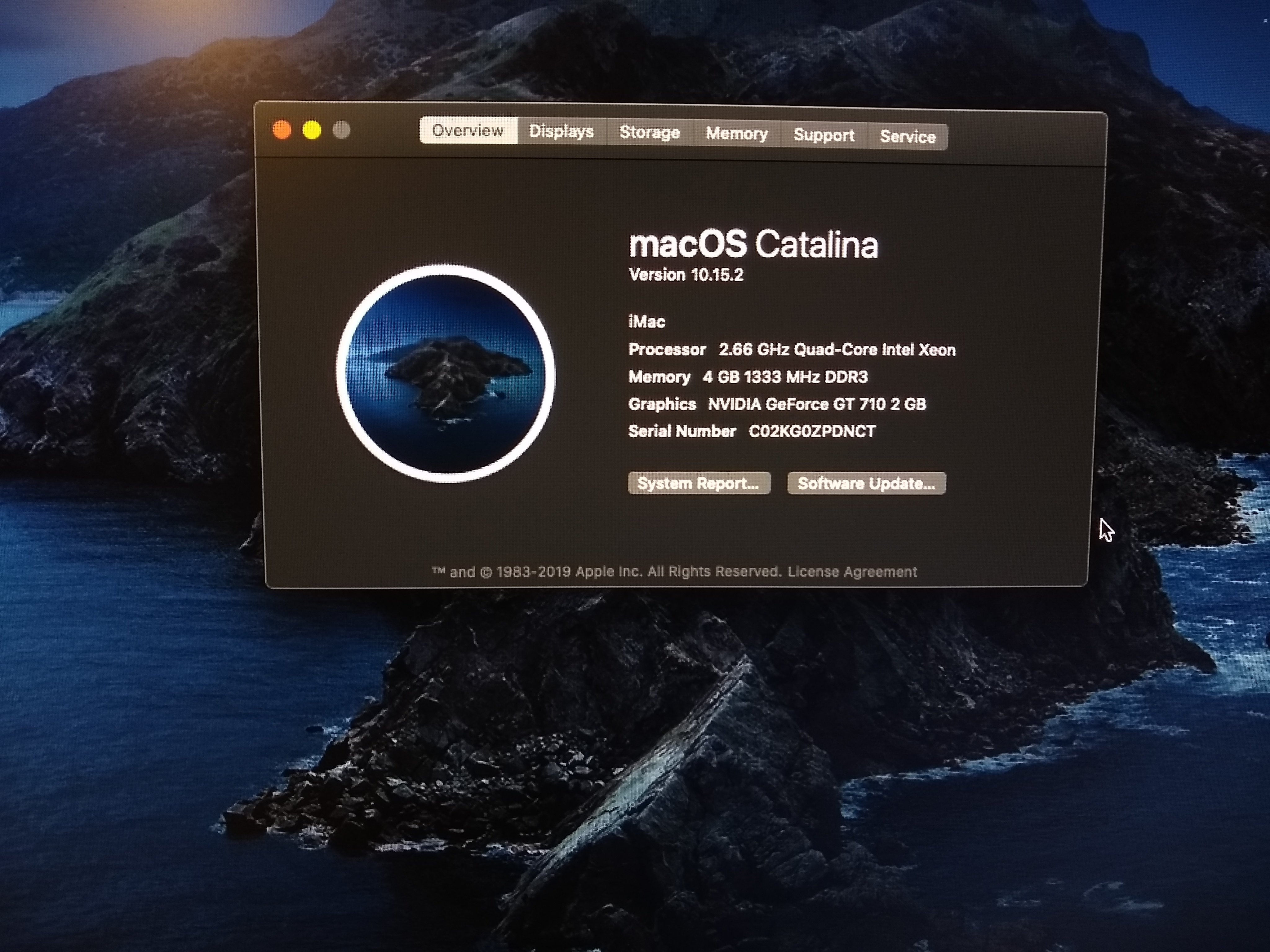

read here how to
SUCCESS!!!!
I successfully applied the mojave2core patch to my system, and it is now working great. Thanks a lot for the help, and for pointing me in the direction of the SSE patch.
7 minutes ago, CD100 said:
SUCCESS!!!!
