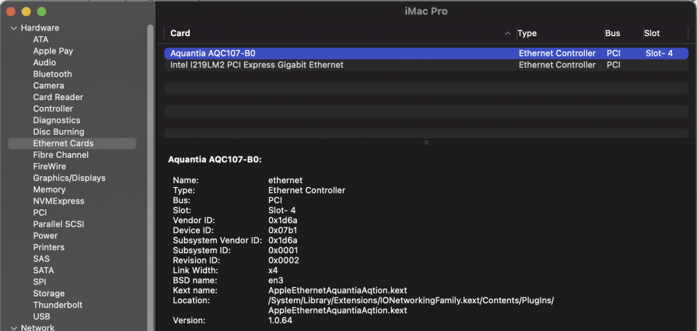

d5aqoep Posted November 25, 2020 Author Share Posted November 25, 2020 @Mieze Is it possible to enable WOL for Aquantia AQC-107 in Catalina/Big Sur? Link to comment https://www.insanelymac.com/forum/topic/330614-marvell-aquantia-10-gb-ethernet-support-thread/page/13/#findComment-2745418 Share on other sites More sharing options...

madins Posted January 6, 2021 Share Posted January 6, 2021 (edited) On 9/9/2020 at 12:10 PM, d5aqoep said: What's with bold font? Hehe To tell you the truth, I have both the cards Asus and Syba and starting with Big Sur, they are not supported out of the box (OOTB). Asus needs the Clover/OpenCore kext patch available on 1st page of this topic in Catalina. For Big Sur DP3 to DP6 work both cards need this following kext patch in OpenCore. (I don't use clover anymore) * com.apple.driver.AppleEthernetAquantiaAqtion * Find: 0F84C002 0000 * Replace: 660F1F44 0000 Use OpenCore Configurator app to open your config.plist. Enter it in Kernel -> Patch section -> Identifier as com.apple.driver.AppleEthernetAquantiaAqtion On a different note, has anyone got their Aquantia cards to WOL from shutdown? Intelmausi kext has a new fork to enable WOL from shutdown. Something similar for our 10 Gbe cards would be phenomenal. I finally got my hack upgraded to Big Sur and I can confirm this still works for 11.1 the official release. My card is the TR-Link card I mentioned in previous replies. I also used DeviceProperties to change the name and type. Edited January 6, 2021 by madins Link to comment https://www.insanelymac.com/forum/topic/330614-marvell-aquantia-10-gb-ethernet-support-thread/page/13/#findComment-2748314 Share on other sites More sharing options...

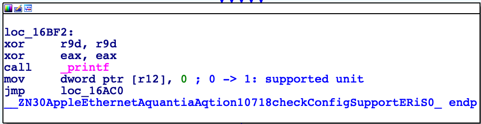

Mieze Posted March 29, 2021 Share Posted March 29, 2021 (edited) This afternoon I reverse-engineered the driver's checkConfigSupport()-function, which determines if a card is supported, and developed a new patch that works with Catalina and Big Sur. Basically, it fixes the return value of the function marking any card as supported. As the patch is applied to a code section which hasn't changed for years, I'm quite confident that it will survive several updates of Big Sur too. Here is the OC patch: For those of you who are interested in the background, the picture below shows which code sequence is changed: Have fun! Mieze Edited March 29, 2021 by Mieze 6 3 Link to comment https://www.insanelymac.com/forum/topic/330614-marvell-aquantia-10-gb-ethernet-support-thread/page/13/#findComment-2754192 Share on other sites More sharing options...

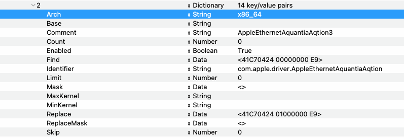

Shikumo Posted June 8, 2021 Share Posted June 8, 2021 You might try this old patch, which is still working for me on Monterey Beta 1. <key>Arch</key> <string>Any</string> <key>Base</key> <string>__ZN27AppleEthernetAquantiaAqtion5startEP9IOService</string> <key>Comment</key> <string>Aquantia AQC107 patch Big Sur</string> <key>Count</key> <integer>1</integer> <key>Enabled</key> <true/> <key>Find</key> <data> D4TAAgAA </data> <key>Identifier</key> <string>com.apple.driver.AppleEthernetAquantiaAqtion</string> <key>Limit</key> <integer>0</integer> <key>Mask</key> <data> </data> <key>MaxKernel</key> <string></string> <key>MinKernel</key> <string>20.0.0</string> <key>Replace</key> <data> Zg8fRAAA </data> <key>ReplaceMask</key> <data> </data> <key>Skip</key> <integer>0</integer> 1 1 Link to comment https://www.insanelymac.com/forum/topic/330614-marvell-aquantia-10-gb-ethernet-support-thread/page/13/#findComment-2760231 Share on other sites More sharing options...

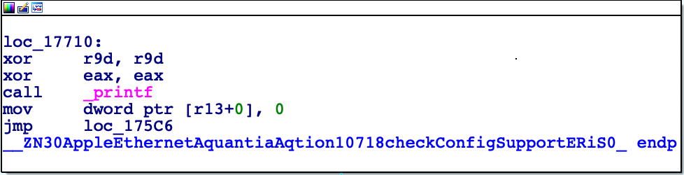

Mieze Posted June 9, 2021 Share Posted June 9, 2021 Obviously the code sequence has changed a bit but the structure remains the same: Therefore we've got to modify the patch too. You need to find 41 c7 45 00 00 00 00 00 e9 and replace it with 41 c7 45 00 01 00 00 00 e9 Good luck! Mieze 5 3 Link to comment https://www.insanelymac.com/forum/topic/330614-marvell-aquantia-10-gb-ethernet-support-thread/page/13/#findComment-2760408 Share on other sites More sharing options...
Pavo Posted June 9, 2021 Share Posted June 9, 2021 1 hour ago, Mieze said: Obviously the code sequence has changed a bit but the structure remains the same: Therefore we've got to modify the patch too. You need to find 41 c7 45 00 00 00 00 00 e9 and replace it with 41 c7 45 00 01 00 00 00 e9 Good luck! Mieze Perfection..... As always @Mieze thanks. 1 1 Link to comment https://www.insanelymac.com/forum/topic/330614-marvell-aquantia-10-gb-ethernet-support-thread/page/13/#findComment-2760414 Share on other sites More sharing options...
