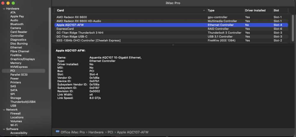

J Lamp Posted May 23, 2024 Share Posted May 23, 2024 Anyone else having problems with a AQC107 on 14.5? It worked at first, but the other evening it disconnected in the middle of a session and wouldn't reconnect. A reboot fixed it, but that only worked once. It is working and continues to work 100% rock solid when booting into Windows. Mac system report sees the card correctly. It shows as up and "Connected" in the network preferences, but there are no network lights on the card. It's almost as if it was powered off. In fact, I can see the link lights flashing on the card until 14.5 starts to load, then they turn off. I've tried it with and without the ssdt I have for it. I have deleted and recreated the network prefs for it. The fact that it worked at first in 14.5 is weird. I'm unsure what to try next. Any suggestions? As a test I tried this with my 14.4 backup, the card works fine. Link to comment https://www.insanelymac.com/forum/topic/330614-marvell-aquantia-10-gb-ethernet-support-thread/page/21/#findComment-2820385 Share on other sites More sharing options...

J Lamp Posted May 25, 2024 Share Posted May 25, 2024 @Slice, thanks for the link to the DMAR discussion. I've got a feeling that this is where the issue lies after the update. I'm still looking into it. @etorix, I appreciate the alternate card suggestions. I'd rather not spend money on this, but this card has stopped working so many times after updates that it may simply be time to try something else. If either of you or anyone else can clue me in on how to extract the binary from the prebuilt partition I can look into seeing if the patch has changed. What I find interesting is that a AQC107s https://www.sonnettech.com/product/solo10g-pcie-card.html apparently does work (in real macs anyway.) The "s" supposedly stands for security (I don't know what exactly that means in context of the hardware itself.) Macs are supposed to load the firmware on an AQC in a similar fashion to what they did with Broadcom hardware. Maybe the issue is that the card isn't getting the firmware properly? Link to comment https://www.insanelymac.com/forum/topic/330614-marvell-aquantia-10-gb-ethernet-support-thread/page/21/#findComment-2820457 Share on other sites More sharing options...

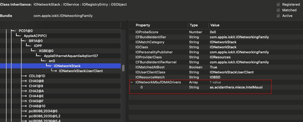

J Lamp Posted May 28, 2024 Share Posted May 28, 2024 On 5/26/2024 at 7:22 PM, Mieze said: The ASUS card with flashed Apple firmware in my MSI Z490 Gaming Plus, which stopped working after the Update to 14.3.1, now resumed work after I installed the 14.5 update, although I didn't change anything else, except updating OC to version 1.0.0. AppleVTD is enabled and the patch is the same I used with Ventura. Strange, really strange...🤔 Yeah, it is strange. When the card works it's rock solid, when it doesn't it's a PITA. I have had the AQC107 drop out while saturating the link on my onboard I219-v and not even using the 10g link. @Mieze looks like you would be the one to ask about this, does this IOreg look right to you? I am using IntelMausi for the onboard network. (my damn AQC107 card just went down while I was writing this ☹️) Link to comment https://www.insanelymac.com/forum/topic/330614-marvell-aquantia-10-gb-ethernet-support-thread/page/21/#findComment-2820530 Share on other sites More sharing options...
Mieze Posted May 29, 2024 Share Posted May 29, 2024 (edited) @J Lamp Yes, this is correct. The property IONetworkMbufDMADrivers lists driver which still use traditional data buffers called mbufs. IOSkywalk based network drivers use different data buffers but this interface is undocumented which makes it nearly impossible to develop a perfectly working driver for independent developers. Edited May 29, 2024 by Mieze Typo Link to comment https://www.insanelymac.com/forum/topic/330614-marvell-aquantia-10-gb-ethernet-support-thread/page/21/#findComment-2820537 Share on other sites More sharing options...

Slice Posted May 30, 2024 Share Posted May 30, 2024 On 5/29/2024 at 12:07 AM, J Lamp said: Yeah, it is strange. When the card works it's rock solid, when it doesn't it's a PITA. I have had the AQC107 drop out while saturating the link on my onboard I219-v and not even using the 10g link. @Mieze looks like you would be the one to ask about this, does this IOreg look right to you? I am using IntelMausi for the onboard network. (my damn AQC107 card just went down while I was writing this ☹️) But I think DMA is not DMAR. Link to comment https://www.insanelymac.com/forum/topic/330614-marvell-aquantia-10-gb-ethernet-support-thread/page/21/#findComment-2820594 Share on other sites More sharing options...

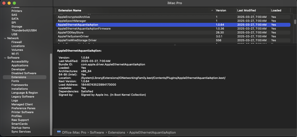

J Lamp Posted September 18, 2024 Share Posted September 18, 2024 (edited) Cycling back around on this (but not in a good way...) I eventually got my 107 working reliably by using "automerge" and a patched DMAR table in Clover, nothing else worked properly. I recently updated Clover to 5160 and was able to boot into 14.6 with everything working. With that I updated to Sequoia, no more 10g network.😮💨 I've checked with Darwin Dumper, I'm still getting my correctly patched DMAR table. Has the kext patch changed in 15.0? EDIT: Improperly configured "MatchOs" (Duh) All good now. Edited September 18, 2024 by J Lamp Link to comment https://www.insanelymac.com/forum/topic/330614-marvell-aquantia-10-gb-ethernet-support-thread/page/21/#findComment-2825572 Share on other sites More sharing options...
J Lamp Posted April 2, 2025 Share Posted April 2, 2025 (edited) Sadly this is down again in 15.4. I have checked the above mentioned settings. AppleVTD is loaded. The DMAR table still looks fine. AppleEthernetAquantiaAqtion and AppleEthernetAquantiaAqtionFirmware are loaded. Under System Settings > Network there is no MAC address for the card. If I try to create a new service it does not list the card, so apparently they are not talking at all. Wondering if the patch has changed again? FIXED: I have not needed this before, but it would seem that as of 15.4 I needed to enable the "ForceAquantiaEthernet" quirk. Problem solved! Edited April 2, 2025 by J Lamp Solution 1 Link to comment https://www.insanelymac.com/forum/topic/330614-marvell-aquantia-10-gb-ethernet-support-thread/page/21/#findComment-2831287 Share on other sites More sharing options...
