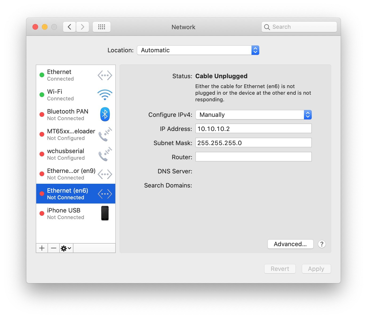

Hi,
I just bought a TP-LINK TL-NT521 10GBe card with AGC107 chipset:
https://www.tp-link.com.cn/product_1520.html
It did work OOB, I've been tested for a few hours. Then I switched to Windows, installed the driver and benchmark the speed.  When I came back to my hackintosh, it now always show "Cable Unplugged".  The card is directly connected to and FreeNAS with X540-T2, that works on Windows so should not be any cable problem.
My OS version is 10.15.6 Catalina with OpenCore 0.5.9.  I've tried some patches but still no fix.
Thanks in advance.
