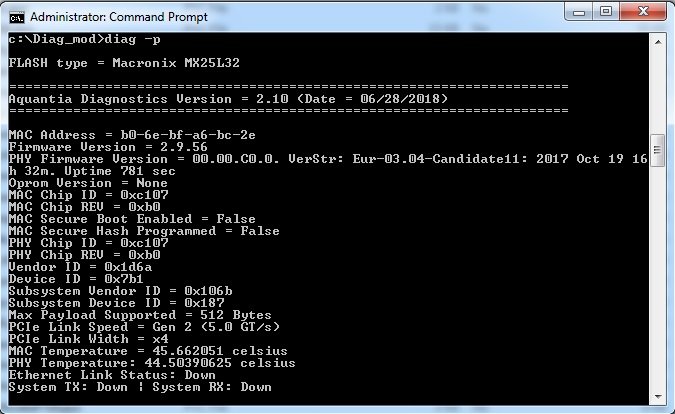

arz.sitnikov Posted March 19, 2019 Share Posted March 19, 2019 51 minutes ago, d5aqoep said: Here is the dump from Syba card AQC107_NormalDirtyWake-3.0.33_bdp.clx Thanks! And what about "device info"? Can you make a screenshot? I'm interested in Mac Chip Id, Chip Revision and etc.. Link to comment https://www.insanelymac.com/forum/topic/330614-marvell-aquantia-10-gb-ethernet-support-thread/page/10/#findComment-2667455 Share on other sites More sharing options...

Thireus Posted May 6, 2019 Share Posted May 6, 2019 On 3/5/2019 at 10:36 AM, d5aqoep said: @Thireus Did you manage to fix your MAC address? If not I may have a fix for you. You can read the enclosed firmware readme file enclosed and flash just the MAC address. Readme-Aquantia-Firmware.txt Thank you d5aqoep, I haven't tried yet, but I understand where the issue is now. Everything makes sense now. So the issue is with MAC End, which must be set to 'FF-FF-FF' or maybe 'BB-FF-FF' with BB being the first byte of the end of the MAC address: 'AA-AA-AA-BB-XX-YY'. Or we can even set MAC End to be 'BB-XX-ZZ' with ZZ = YY + 1, while leaving count at 0x0. Anyway, the most important bit is that my issue was caused by MAC End being lower than MAC Being + Count. I'll try to make the change and I will report back. MAC OUI = MAC FIRST 3 BYTES MAC BEGIN = MAC NIC BEGIN = MAC LAST 3 BYTES MAC END = MAC NIC END = MAC LAST 3 BYTES LIMIT WHEN FLASHING MULTIPLE CARDS (must satisfy: MAC BEGIN + COUNT < MAC END) COUNT = COUNTER THAT INCREMENTS 'MAC BEGIN' UNTIL IT REACHES 'MAC END' (used when flashing several cards in a row) That's very misleading to name those variables begin and end... they could have named them MAC NIC BEGIN and MAC NIC END. 1 Link to comment https://www.insanelymac.com/forum/topic/330614-marvell-aquantia-10-gb-ethernet-support-thread/page/10/#findComment-2672779 Share on other sites More sharing options...
Thireus Posted May 18, 2019 Share Posted May 18, 2019 I'm happy to report it worked like a charm. My MAC address is back! :D C:\diag\aqua\AQUANTIA\AMD64>diag --password !h:ahT8uW6 --aqc AQC107-Config.aqc FLASH type = Winbond W25Q32 Erase duration 6362069 us Starting Read Whole Flash . Pass Starting Flash Update . Pass Starting Flash Update . . Pass Starting Flash Update . . Bytes: 0x20000 Bytes: 0x40000 . . Pass Starting Flash Update . . Pass Override result = PASS Thank you d5aqoep! Link to comment https://www.insanelymac.com/forum/topic/330614-marvell-aquantia-10-gb-ethernet-support-thread/page/10/#findComment-2674164 Share on other sites More sharing options...

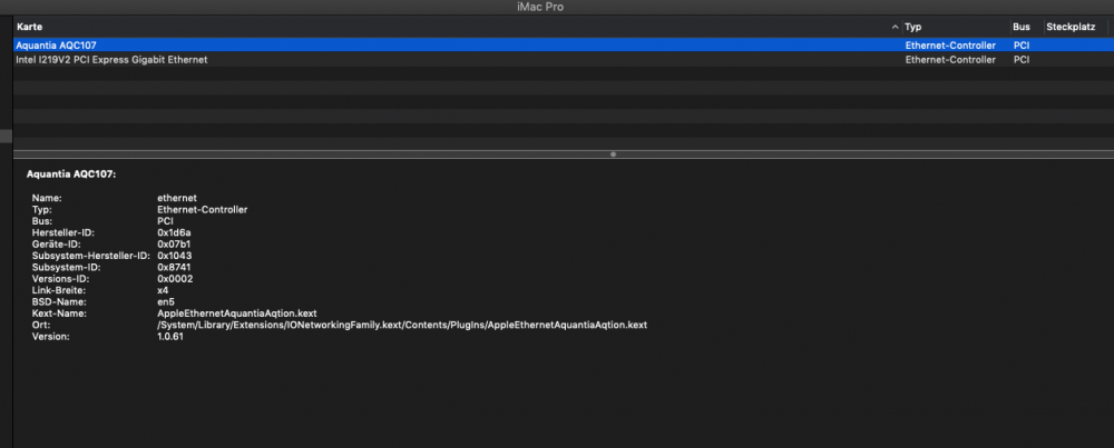

jya Posted May 27, 2019 Share Posted May 27, 2019 On 9/5/2018 at 9:48 PM, Allubz said: Dear peeps, I'm at a loss with my ASRock X299 XE board that has the AQC107 chip. I see user jya claims to have it running on this board, and I believe (s)he does, because I managed to get it to work in 10.13.3 Does the firmware flashing only work when updating from 10.13.2 to 10.13.3, or with any 10.13.3 installation? Did you end up saving the original firmware by any chance? Following update to Windows 1903 the card no longer works and it no longer works with macOS 10.15.5 either. Only have it working with linux now. Link to comment https://www.insanelymac.com/forum/topic/330614-marvell-aquantia-10-gb-ethernet-support-thread/page/10/#findComment-2675343 Share on other sites More sharing options...
Allubz Posted May 28, 2019 Share Posted May 28, 2019 I never made a backup. I think I had one board replaced because I wrongly flashed it with the 10.13.3 AQC107 firmware via CSM-UEFI, rather than full UEFI. The other board after that functioned just fine, but I don't have it anymore and it runs 10.13.6 still, as far as I know. You mean to say that with 10.14.5 the chipset stopped working? Not sure if others can confirm this, but you could always try a reflash with 10.13.3, or downgrade to a lower Mojave version to see if the firmware is still intact on the ACQ107. The Windows part I have even less a clue about, as Windows 10 updates tend to break anything you love, whether intentionally or, mostly, it just happens gl deal with it #M$ Link to comment https://www.insanelymac.com/forum/topic/330614-marvell-aquantia-10-gb-ethernet-support-thread/page/10/#findComment-2675383 Share on other sites More sharing options...

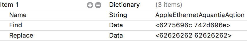

Mieze Posted May 28, 2019 Share Posted May 28, 2019 (edited) As I'm using my ASUS card in a machine which still runs the server version of High Sierra because I need the mail service, I'm unable to test but after taking a quick look at the driver and firmware kext, I can confirm that they both have been changed in 10.14.5. The drivers version changed from 1.0.59 to 1.0.61 but the firmware's version remains 1 as it used to be in 10.14.3. In case you are having trouble with the chip, please add "apple-axge-debug=0xff" to your boot arguments and check the kernel logs for corresponding output which might help to find out what exactly is happening. In case they added more checks, I might be able to create a new patch. Mieze Edited May 30, 2019 by Mieze 1 Link to comment https://www.insanelymac.com/forum/topic/330614-marvell-aquantia-10-gb-ethernet-support-thread/page/10/#findComment-2675449 Share on other sites More sharing options...

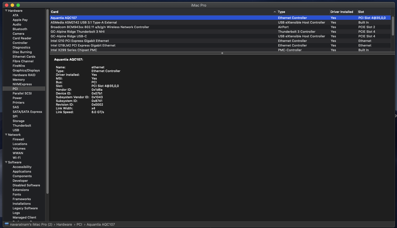

Luminadevapps Posted May 31, 2019 Share Posted May 31, 2019 I have Asus card. Can I know How to test this card X299 system with 10GBe? Link to comment https://www.insanelymac.com/forum/topic/330614-marvell-aquantia-10-gb-ethernet-support-thread/page/10/#findComment-2675667 Share on other sites More sharing options...

d5aqoep Posted July 1, 2019 Author Share Posted July 1, 2019 (edited) On 6/29/2019 at 1:15 AM, meaganmargaret said: So, d5aqoep, are you using this firmware with both a Mac/Hack and Windows? Can someone just update an Asus 10Gb card's Apple modified firmware with this? I am using Syba Card which is having 107S chipset and is native with macOS. I have updated the card to 3.1.88 and it works flawlessly even in Catalina Beta 2. It also works as expected in Windows 10 v1903 with latest drivers from Aquantia website. I also updated my Asus 10 GB and Aquantia 107N cards to this same firmware and both are not detected in macOS. So it clearly not the firmware but the chipset that matters. Maybe @Mieze can see what can be done and whether a simple kext to patch would suffice for these cards which are not native. Native cards are just 3 1. Syba 10 GBE 2. Aquantia 10G Gaming (Black PCB) 3. Synology 10 GBE I can only confirm 1st one but there are many reports that the 2nd and 3rd are compatible as well. No point in wasting time with Asus 10G cards. They are worthless with no macOS and no WOL support. PS: I also have a QNAP 10 GBE card which was also not compatible with macOS but since 1.5 years, it is lying in my TS-653B server so I haven't bothered to update it's firmware yet. Edited July 1, 2019 by d5aqoep Link to comment https://www.insanelymac.com/forum/topic/330614-marvell-aquantia-10-gb-ethernet-support-thread/page/10/#findComment-2679821 Share on other sites More sharing options...
rongu Posted July 1, 2019 Share Posted July 1, 2019 2 minutes ago, d5aqoep said: I am using Syba Card which is having 107S chipset and is native with macOS. I have updated the card to 3.1.88 and it works flawlessly even in Catalina Beta 2. I also updated my Asus 10 GB and Aquantia 107N cards to this same firmware and both are not detected in macOS. So it clearly not the firmware but the chipset that matters. Maybe @Mieze can see what can be done and whether a simple kext to patch would suffice for these cards which are not native. Native cards are just 3 1. Syba 10 GBE 2. Aquantia 10G Gaming (Black PCB) 3. Synology 10 GBE I can only confirm 1st one but there are many reports that the 2nd and 3rd are compatible as well. No point in wasting time with Asus 10G cards. They are worthless with no macOS and no WOL support. Just want to make sure I am not missing anything. I had 3 Asus 10GB cards work on 3 separate systems (10.13.6 and 10.14.5) with stock firmware without any kext or any patches. I had used them for about 1 month+ so far with a average thru-put of about 500 MB/s, other then WOL, everything work as advertised. Please advise as I thought of trying out Syba 10 GBe also. Thanks ! Link to comment https://www.insanelymac.com/forum/topic/330614-marvell-aquantia-10-gb-ethernet-support-thread/page/10/#findComment-2679823 Share on other sites More sharing options...
d5aqoep Posted July 1, 2019 Author Share Posted July 1, 2019 4 hours ago, Alex.C said: Just want to make sure I am not missing anything. I had 3 Asus 10GB cards work on 3 separate systems (10.13.6 and 10.14.5) with stock firmware without any kext or any patches. I had used them for about 1 month+ so far with a average thru-put of about 500 MB/s, other then WOL, everything work as advertised. Please advise as I thought of trying out Syba 10 GBe also. Thanks ! Interesting. I have ASUS XG-C100C card and it does not even get detected in macOS. Syba 10 GBE is without a doubt the best choice for hackintosh. It is guaranteed to work in future macOS editions as well as it is the exact same chipset AQC-107S Apple uses in their iMac Pros and newer macMini. Link to comment https://www.insanelymac.com/forum/topic/330614-marvell-aquantia-10-gb-ethernet-support-thread/page/10/#findComment-2679840 Share on other sites More sharing options...
Neek Posted July 12, 2019 Share Posted July 12, 2019 On 7/1/2019 at 3:22 AM, d5aqoep said: Native cards are just 3 1. Syba 10 GBE 2. Aquantia 10G Gaming (Black PCB) 3. Synology 10 GBE The Sonnet Tech Solo10G card works natively as well. Link to comment https://www.insanelymac.com/forum/topic/330614-marvell-aquantia-10-gb-ethernet-support-thread/page/10/#findComment-2681182 Share on other sites More sharing options...
ergot Posted July 16, 2019 Share Posted July 16, 2019 On 7/1/2019 at 3:23 PM, d5aqoep said: Interesting. I have ASUS XG-C100C card and it does not even get detected in macOS. Syba 10 GBE is without a doubt the best choice for hackintosh. It is guaranteed to work in future macOS editions as well as it is the exact same chipset AQC-107S Apple uses in their iMac Pros and newer macMini. Correct, the Syba have also drivers for Mac OS... Link to comment https://www.insanelymac.com/forum/topic/330614-marvell-aquantia-10-gb-ethernet-support-thread/page/10/#findComment-2681753 Share on other sites More sharing options...

HmO Posted September 1, 2019 Share Posted September 1, 2019 12 minutes ago, meaganmargaret said: @Mieze So, have you or anyone, experimented with OpenCore? I have tried to move your patch (for the Asus XG-C100C) from Clover to OC and no success yet..... I tried putting it in Kernel -> Patch (see below), but it did not work. Should the identified be IONetworking? dict> <key>Comment</key> <string>AQC 107 10 GbE v2</string> <key>Identifier</key> <string>com.apple.driver.AppleEthernetAquantiaAqtion</string> <key>Count</key> <integer>1</integer> <key>Enabled</key> <false/> <key>Find</key> <data>YnVpbHQtaW4=</data> <key>InfoPlistPatch</key> <false/> <key>Name</key> <string>AppleEthernetAquantiaAqtion</string> <key>Replace</key> <data>YnVpbHQtaW4=</data> <key>Skip</key> <integer>0</integer> </dict> Why Enabled is false instead we need true Link to comment https://www.insanelymac.com/forum/topic/330614-marvell-aquantia-10-gb-ethernet-support-thread/page/10/#findComment-2688220 Share on other sites More sharing options...
