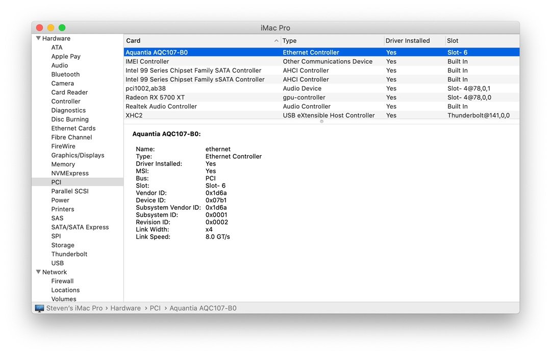

madins Posted January 11, 2020 Share Posted January 11, 2020 This is a screenshot of the TR-Link card in macOS. Link to comment https://www.insanelymac.com/forum/topic/330614-marvell-aquantia-10-gb-ethernet-support-thread/page/11/#findComment-2703726 Share on other sites More sharing options...
overshoot Posted January 14, 2020 Share Posted January 14, 2020 On 1/11/2020 at 5:00 PM, madins said: Looking at other posts, you need to modify the device ID to 07b1 for the card to work. I just found another working card LR-Link 6880BT, it costs around $78. There are links in both AliExpress and Taobao, I found buyers commented this card give the identical vendor and device IDs as the Aquantia card. They reported no modification needed to have native support. I'm not sure about WOL though. Aquantia card on Amazon.co.uk is about £260, which is way too expensive. I've read different things and I was confused on what I should do, especially after reading a thread talking upgrading the firmware from a specific vendor. Anyhow, thanks a lot for your answer! I'll try that modification otherwise I'll get one of these LR-Link. Cheers! Link to comment https://www.insanelymac.com/forum/topic/330614-marvell-aquantia-10-gb-ethernet-support-thread/page/11/#findComment-2704199 Share on other sites More sharing options...
overshoot Posted January 15, 2020 Share Posted January 15, 2020 Quick update... I did try to locate the Device ID on the EEPROM dump but wasn't able to find it. I banged my head for an hour at least until I decided to upgrade the firmware from my Windows PC. Once I plugged it back to the MacPro, cable got detected finally. So a firmware update did fix it for me. No modification needed. Link to comment https://www.insanelymac.com/forum/topic/330614-marvell-aquantia-10-gb-ethernet-support-thread/page/11/#findComment-2704420 Share on other sites More sharing options...
