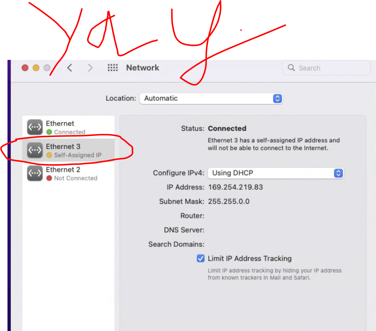

dovedescent7 Posted May 15, 2022 Share Posted May 15, 2022 ok so i returned the tehuti 4010 card Today i received my TP-LINK AQC107 card and installed it. its showing as 2nd ethernet without changing any software.. Is there a guide on how to get this working? Link to comment https://www.insanelymac.com/forum/topic/330614-marvell-aquantia-10-gb-ethernet-support-thread/page/17/#findComment-2782316 Share on other sites More sharing options...
i0ntempest Posted May 15, 2022 Share Posted May 15, 2022 @dovedescent7With OC 0.8.0 all u need to do is tick a box mentioning aquantia under kernel quirks. Make sure VT-d is enabled in BIOS. If you still have problems after this, try toggling DisableIoMapper. 1 Link to comment https://www.insanelymac.com/forum/topic/330614-marvell-aquantia-10-gb-ethernet-support-thread/page/17/#findComment-2782317 Share on other sites More sharing options...

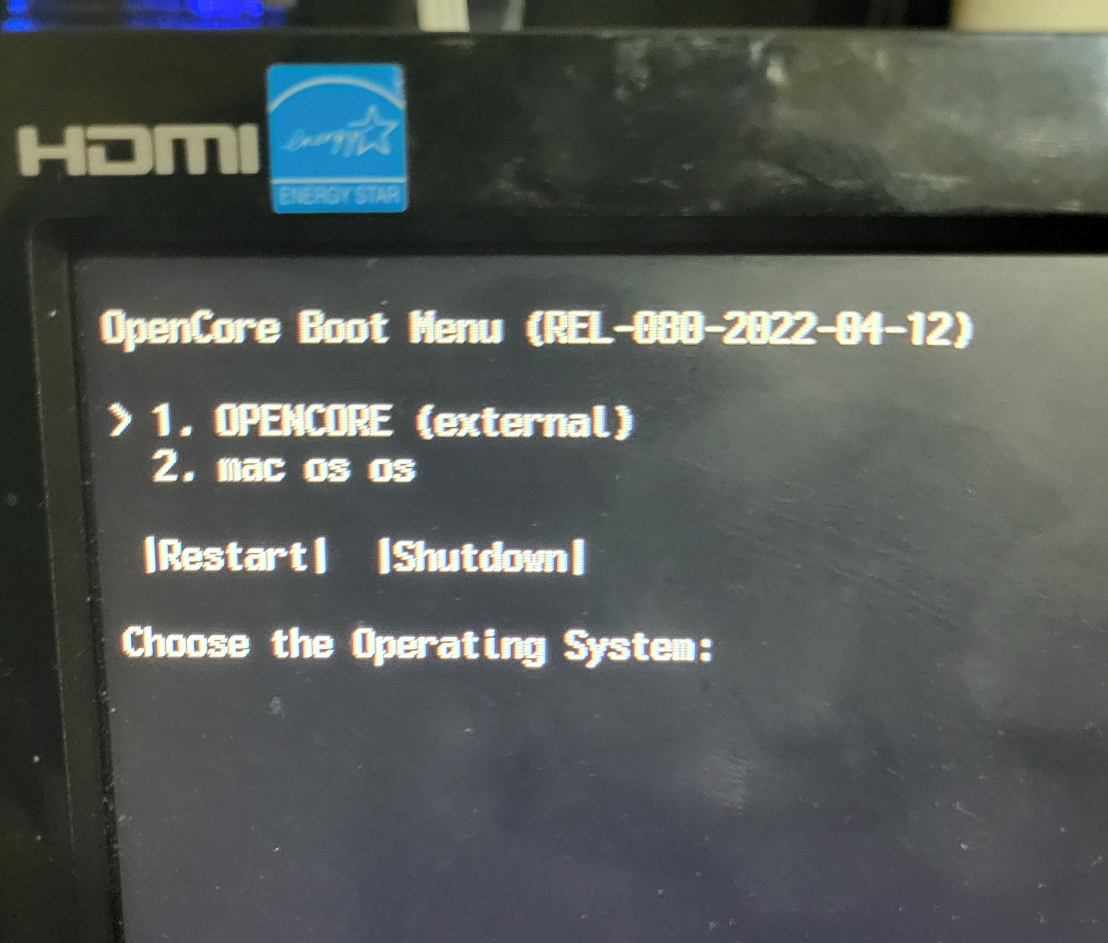

dovedescent7 Posted June 2, 2022 Share Posted June 2, 2022 (edited) Real quick, I dont recall if im on .8 or .79 or whatever.. Can i find that out which opencore i used in my usb ? WHere? How? Secondly i read that Monterey breaks aquantia and needs pacthing.. Is this true? And can OC configurator be used on windows? Edited June 2, 2022 by dovedescent7 Link to comment https://www.insanelymac.com/forum/topic/330614-marvell-aquantia-10-gb-ethernet-support-thread/page/17/#findComment-2783479 Share on other sites More sharing options...
i0ntempest Posted June 2, 2022 Share Posted June 2, 2022 13 minutes ago, dovedescent7 said: Real quick, I dont recall if im on .8 or .79 or whatever.. Can i find that out which opencore i used in my usb ? WHere? How? Secondly i read that Monterey breaks aquantia and needs pacthing.. Is this true? And can OC configurator be used on windows? Bottom right of opencore boot picker has the version The quirks are exactly those patches aggregated OC configurator is macOS only Link to comment https://www.insanelymac.com/forum/topic/330614-marvell-aquantia-10-gb-ethernet-support-thread/page/17/#findComment-2783480 Share on other sites More sharing options...
dovedescent7 Posted June 2, 2022 Share Posted June 2, 2022 (edited) 29 minutes ago, i0ntempest said: Bottom right of opencore boot picker has the version The quirks are exactly those patches aggregated OC configurator is macOS only ok got oc configurator in mac and it appears from here that i have .8 see below image. all i did is point to my config plist on usb, then check that aquantia box, then hit save, is this correct? thats what i did, also enabled vt in bios Im assuming i am editing the config plist on the flash (installer) drive? Then once i check the quirk in kernel for aquantia do i reinstall from usb? Im not understanding the concepts. when i reboot to i boot from usb? do i boot from usb or my opencore install on ssd? Edited June 2, 2022 by dovedescent7 Link to comment https://www.insanelymac.com/forum/topic/330614-marvell-aquantia-10-gb-ethernet-support-thread/page/17/#findComment-2783482 Share on other sites More sharing options...
i0ntempest Posted June 2, 2022 Share Posted June 2, 2022 Do u not have a EFI partition in your internal disks? Can you boot macOS without your USB drive? Link to comment https://www.insanelymac.com/forum/topic/330614-marvell-aquantia-10-gb-ethernet-support-thread/page/17/#findComment-2783483 Share on other sites More sharing options...
dovedescent7 Posted June 2, 2022 Share Posted June 2, 2022 (edited) yes i have internal efi, no i dont need usb to boot. Sorry i should have explained, that you would need to be VERY detailed with me, ive only did this once, though successful. If you could put you kid gloves on with me that would be great. So i assume i have to do this with my internal efi... What do i use to mount internal efi? And with oc configurator, is it like propertree where i need to point to config.plist AND OC folder?? OR just point to efi then config plist, make changes, then hit save? Edited June 2, 2022 by dovedescent7 Link to comment https://www.insanelymac.com/forum/topic/330614-marvell-aquantia-10-gb-ethernet-support-thread/page/17/#findComment-2783484 Share on other sites More sharing options...
i0ntempest Posted June 2, 2022 Share Posted June 2, 2022 Then you should boot from and edit that, assuming it is also 0.8. If not, you edit the EFI on your flash drive, boot from it, once you confirm everything is working you should copy your external EFI folder in to your internal ESP and replace that EFI folder. 1 Link to comment https://www.insanelymac.com/forum/topic/330614-marvell-aquantia-10-gb-ethernet-support-thread/page/17/#findComment-2783485 Share on other sites More sharing options...

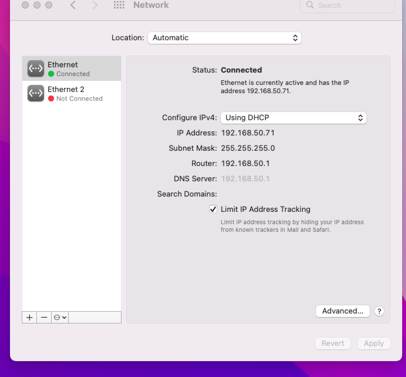

i0ntempest Posted June 2, 2022 Share Posted June 2, 2022 Try connecting from the 10GbE port to your router, see if you get an IP. If you only get a 169.254 address, continue from step 2. Link to comment https://www.insanelymac.com/forum/topic/330614-marvell-aquantia-10-gb-ethernet-support-thread/page/17/#findComment-2783491 Share on other sites More sharing options...

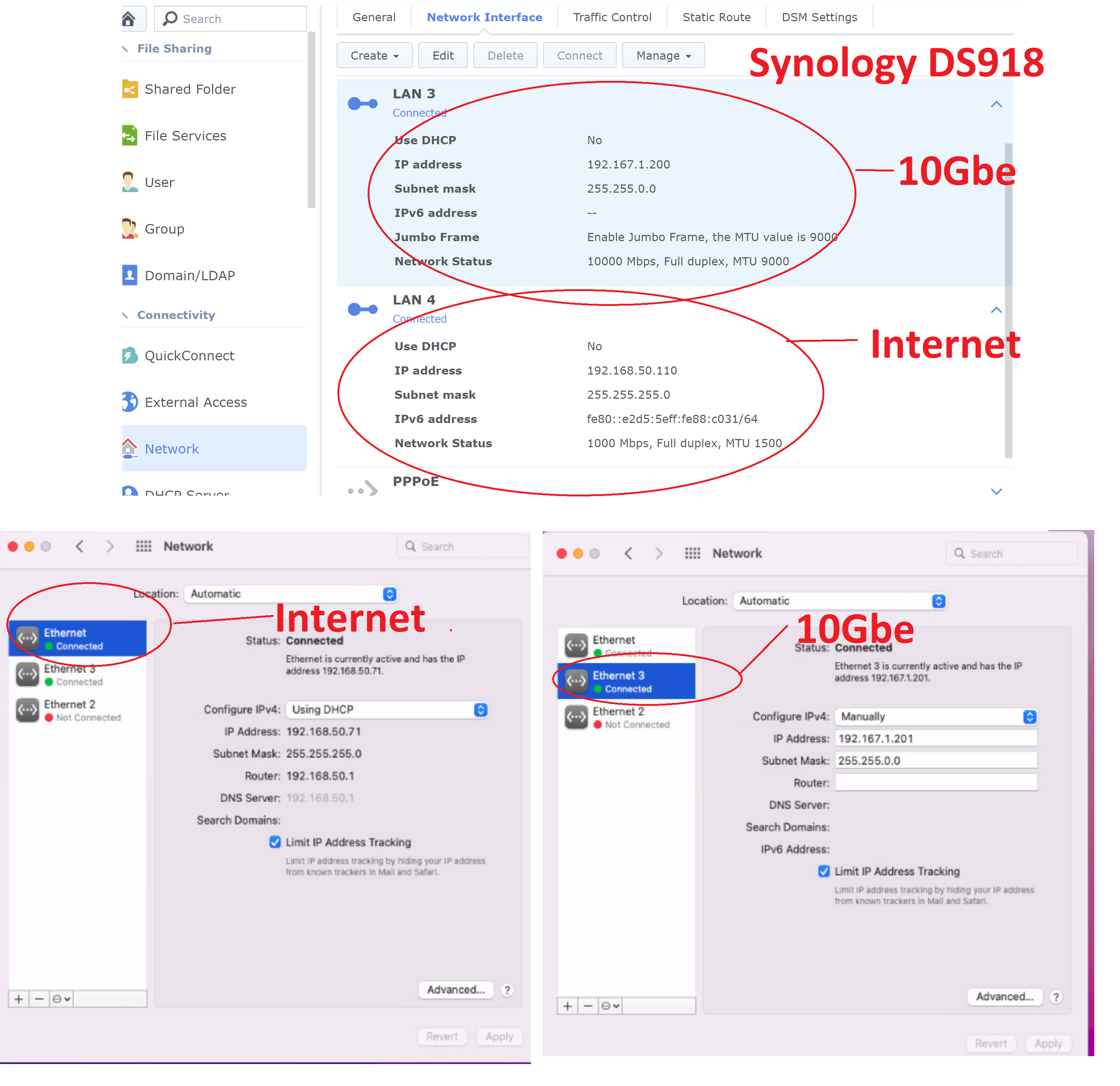

dovedescent7 Posted June 3, 2022 Share Posted June 3, 2022 (edited) 14 hours ago, i0ntempest said: Try connecting from the 10GbE port to your router, see if you get an IP. If you only get a 169.254 address, continue from step 2. Yeah so I've done all the steps, and i dont think those are the issue. I Did toggle the DIsableIoMap thing too. I'm 99% sure the IP addresses and network settings are wrong for the 10Gbe, because i don't know what to set them too. (i know how to in windows, but not mac I'm not a mac guy, and im told that for 10Gbe direct connect with Mac, the settings are different then if it were windows. If the card weren't working i'm assuming i wouldnt see the adapter showing as green, and wouldn't see anything for addresses like in the below image. Also since i changed the kernel settings in OC Config, the light is now on, on the 10Gbe Card. Could someone provide me the correct network settings/addresses for the 10Gbe Direct connect on Mac and My Synology please? Edited June 3, 2022 by dovedescent7 Link to comment https://www.insanelymac.com/forum/topic/330614-marvell-aquantia-10-gb-ethernet-support-thread/page/17/#findComment-2783514 Share on other sites More sharing options...
roddie Posted June 3, 2022 Share Posted June 3, 2022 (edited) 25 minutes ago, dovedescent7 said: Could someone provide me the correct network settings/addresses for the 10Gbe Direct connect on Mac and My Synology please? Off-topicish, but there's not really a difference between IP settings across different platforms other than where the screens are. Assuming you want to use the network 192.168.54.0/30 (192.168.54.1 for the Synology and 192.168.54.2 for the Mac), you would configure the Mac to look something like this: Note: You do not want to add a "Router" setting or alter anything else. Conversely, the Synology would be configured with 192.168.54.1 255.255.255.252. Hope that helps! Edited June 3, 2022 by roddie Link to comment https://www.insanelymac.com/forum/topic/330614-marvell-aquantia-10-gb-ethernet-support-thread/page/17/#findComment-2783515 Share on other sites More sharing options...
dovedescent7 Posted June 3, 2022 Share Posted June 3, 2022 36 minutes ago, roddie said: Off-topicish, but there's not really a difference between IP settings across different platforms other than where the screens are. Assuming you want to use the network 192.168.54.0/30 (192.168.54.1 for the Synology and 192.168.54.2 for the Mac), you would configure the Mac to look something like this: Note: You do not want to add a "Router" setting or alter anything else. Conversely, the Synology would be configured with 192.168.54.1 255.255.255.252. Hope that helps! Awesome, ok i put these settings in.. What next? Do i simply go to GO>CONNECT TO SERVER on the mac? Link to comment https://www.insanelymac.com/forum/topic/330614-marvell-aquantia-10-gb-ethernet-support-thread/page/17/#findComment-2783516 Share on other sites More sharing options...
roddie Posted June 3, 2022 Share Posted June 3, 2022 Just now, dovedescent7 said: Awesome, ok i put these settings in.. What next? Do i simply go to GO>CONNECT TO SERVER on the mac? Best idea is to try to ping the Synology's IP address to see if your configuration is good, then you can try to connect with Finder. One thing I forgot to mention that might not be obvious, is that the network you use between the two devices needs to be different than your general network so that there are no conflicts. So if you're using 192.168.1.0/24 in your regular network, 192.168.54.0/30 is safe to use. Link to comment https://www.insanelymac.com/forum/topic/330614-marvell-aquantia-10-gb-ethernet-support-thread/page/17/#findComment-2783517 Share on other sites More sharing options...

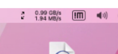

dovedescent7 Posted June 3, 2022 Share Posted June 3, 2022 (edited) 11 minutes ago, roddie said: Best idea is to try to ping the Synology's IP address to see if your configuration is good, then you can try to connect with Finder. One thing I forgot to mention that might not be obvious, is that the network you use between the two devices needs to be different than your general network so that there are no conflicts. So if you're using 192.168.1.0/24 in your regular network, 192.168.54.0/30 is safe to use. I used your settings and it works! SUCCESS!!! I'll have to tweak some things because the max from Synology is 450MB/s but that's a feat in itself! Transferred a 60GB video in 2 minutes from nas to mac. So can we update the OP now to show that the Trendnet card is now tested?? (image below) Man im SO GRATEFUL FOR YOUR HELP!!! Thanks a million.. FINAL question i swear.. Do you think that toggling the DIsableIoMapper thing could possibly make this connection even faster? The reason i wonder is because from this nas i get 1GB/s to windows. And the mac im using has a fast nvme ssd, the nas has all ssd's in raid 0, technically should be faster but.... Any ideas on how to improve these network transfer speeds? Oh and PS transfer FROM mac TO the Synology im getting 1GB/s Edited June 3, 2022 by dovedescent7 Link to comment https://www.insanelymac.com/forum/topic/330614-marvell-aquantia-10-gb-ethernet-support-thread/page/17/#findComment-2783518 Share on other sites More sharing options...
roddie Posted June 3, 2022 Share Posted June 3, 2022 3 hours ago, dovedescent7 said: I used your settings and it works! SUCCESS!!! I'll have to tweak some things because the max from Synology is 450MB/s but that's a feat in itself! Transferred a 60GB video in 2 minutes from nas to mac. So can we update the OP now to show that the Trendnet card is now tested?? (image below) Man im SO GRATEFUL FOR YOUR HELP!!! Thanks a million.. FINAL question i swear.. Do you think that toggling the DIsableIoMapper thing could possibly make this connection even faster? The reason i wonder is because from this nas i get 1GB/s to windows. And the mac im using has a fast nvme ssd, the nas has all ssd's in raid 0, technically should be faster but.... Any ideas on how to improve these network transfer speeds? Glad you got it working! 3.6Gb/s on a point-to-point connection isn't actually bad for a 10Gb/s NIC on a PC. There are a few factors that can impact throughput (protocol, cable quality, CPU on either side, network card quality, MTU, drivers, software, etc.) and it's really hard to guess where improvements could be made. An obvious one for me as a networking person is to try to set the MTU on both sides to something higher than the default of 1500 (9000 is a standardish setting), but both NICs need to support it and you need to make them match. Also, a good way to measure throughput is to use a tool like IPERF that can run on both devices. As for EFI/Mac-specific tweaks, I'll let the smart folks in this thread comment - I'm just a dumb network guy who generally just follow the guides here 🙂 Link to comment https://www.insanelymac.com/forum/topic/330614-marvell-aquantia-10-gb-ethernet-support-thread/page/17/#findComment-2783527 Share on other sites More sharing options...
