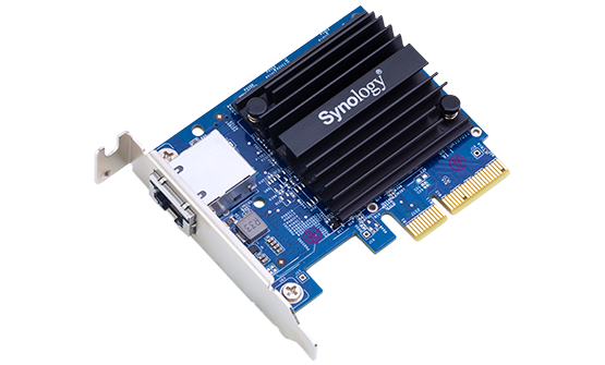

cosmos654 Posted August 12, 2018 Share Posted August 12, 2018 A brand new RJ45 10Gb NIC card based on same Aquantia chip by Synology with 5 YEARS warranty and (it semms) better heatsink: https://www.synology.com/en-uk/products/E10G18-T1 Link to comment https://www.insanelymac.com/forum/topic/330614-marvell-aquantia-10-gb-ethernet-support-thread/page/9/#findComment-2629791 Share on other sites More sharing options...
