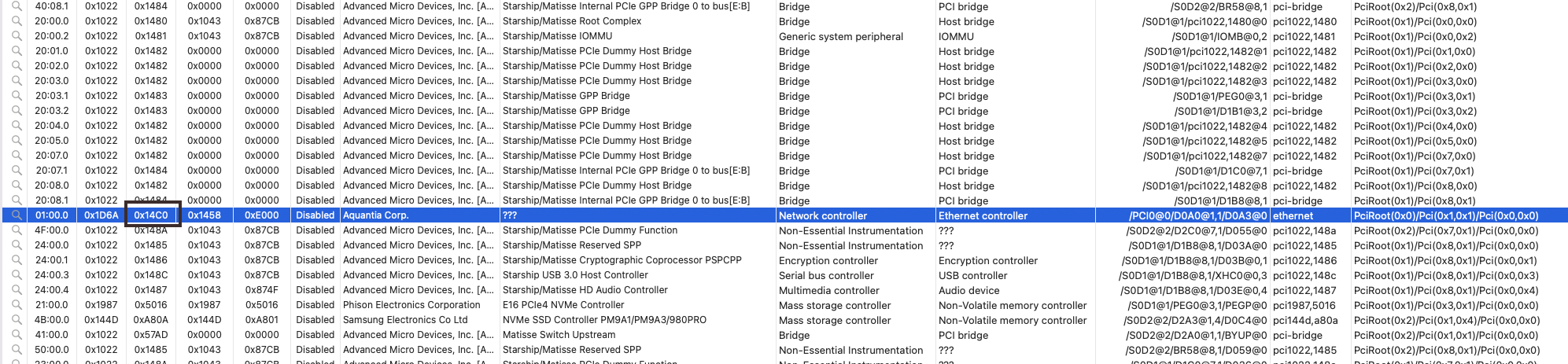

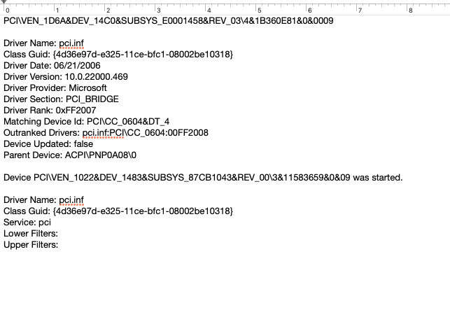

valmeida29 Posted July 13, 2022 Share Posted July 13, 2022 (edited) I end it up buying a Gigabyte Vision 10G card GC-AQC113C to try to get Monterey working. I installed the SSDT but no luck . I booted into windows so that I can get the PCI information below . Any help greatly appreciated  SSDT-Aquantia-AQC113C.aml config.plist Edited July 13, 2022 by valmeida29 Link to comment https://www.insanelymac.com/forum/topic/330614-marvell-aquantia-10-gb-ethernet-support-thread/page/18/#findComment-2788942 Share on other sites More sharing options...

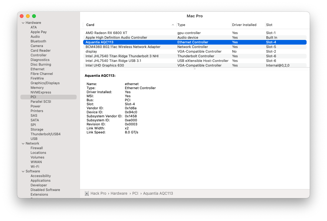

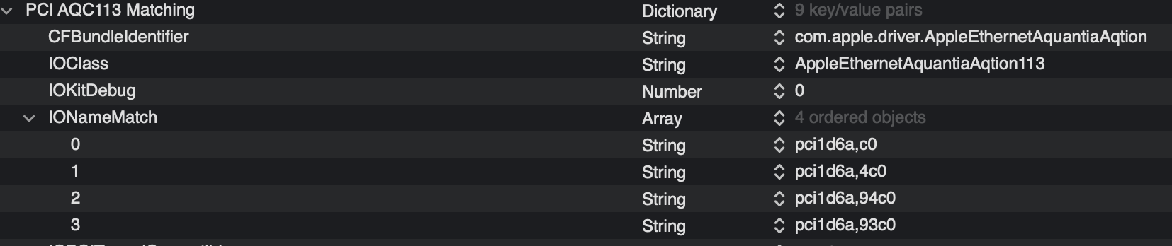

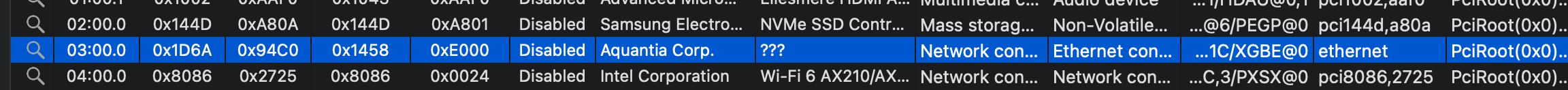

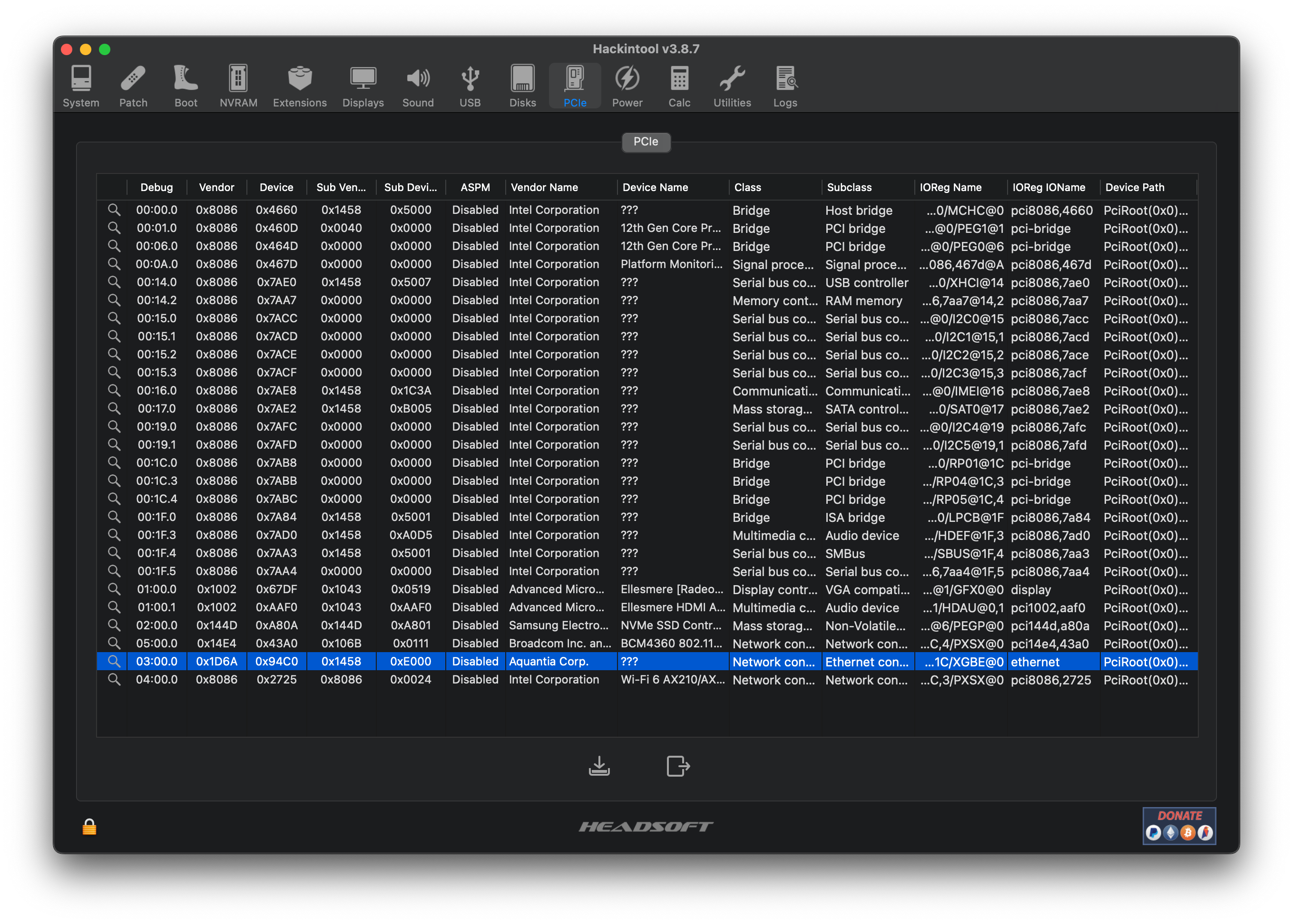

Cyberdevs Posted July 14, 2022 Share Posted July 14, 2022 @valmeida29 From what i see in the screenshot the assigned device id is 0x14C0 which is the default value of the device and it must be 0x94C0 so either the SSDT didn't load or it requires some changes. Â As you can see in the picture below my AQC113 with the original 0x14c0 now has the correct device ID: Link to comment https://www.insanelymac.com/forum/topic/330614-marvell-aquantia-10-gb-ethernet-support-thread/page/18/#findComment-2788960 Share on other sites More sharing options...
Cyberdevs Posted July 14, 2022 Share Posted July 14, 2022 @valmeida29 On another note the SSDT that you are using addresses the device in the following path:   External (_SB_.PC00.RP01, DeviceObj)   External (_SB_.PC00.RP01.PXSX, DeviceObj)   External (DTGP, MethodObj)   // 5 Arguments   If (_OSI ("Darwin"))   {     Scope (\_SB.PC00.RP01) in your screenshot the location path is shown as:   External (_SB_.PCI0.D0A0, DeviceObj)   External (_SB_.PCI0.D0A0.PXSX, DeviceObj)   External (DTGP, MethodObj)   // 5 Arguments   If (_OSI ("Darwin"))   {     Scope (\_SB.PCI0.D0A0) So try this SSDT:  SSDT-Aquantia-AQC113C.aml Link to comment https://www.insanelymac.com/forum/topic/330614-marvell-aquantia-10-gb-ethernet-support-thread/page/18/#findComment-2788964 Share on other sites More sharing options...
valmeida29 Posted July 16, 2022 Share Posted July 16, 2022 On 7/14/2022 at 2:36 AM, Cyberdevs said: @valmeida29 On another note the SSDT that you are using addresses the device in the following path:   External (_SB_.PC00.RP01, DeviceObj)   External (_SB_.PC00.RP01.PXSX, DeviceObj)   External (DTGP, MethodObj)   // 5 Arguments   If (_OSI ("Darwin"))   {     Scope (\_SB.PC00.RP01) in your screenshot the location path is shown as:   External (_SB_.PCI0.D0A0, DeviceObj)   External (_SB_.PCI0.D0A0.PXSX, DeviceObj)   External (DTGP, MethodObj)   // 5 Arguments   If (_OSI ("Darwin"))   {     Scope (\_SB.PCI0.D0A0) So try this SSDT:  SSDT-Aquantia-AQC113C.aml 287 B · 1 download 😞 didnt work Link to comment https://www.insanelymac.com/forum/topic/330614-marvell-aquantia-10-gb-ethernet-support-thread/page/18/#findComment-2789088 Share on other sites More sharing options...

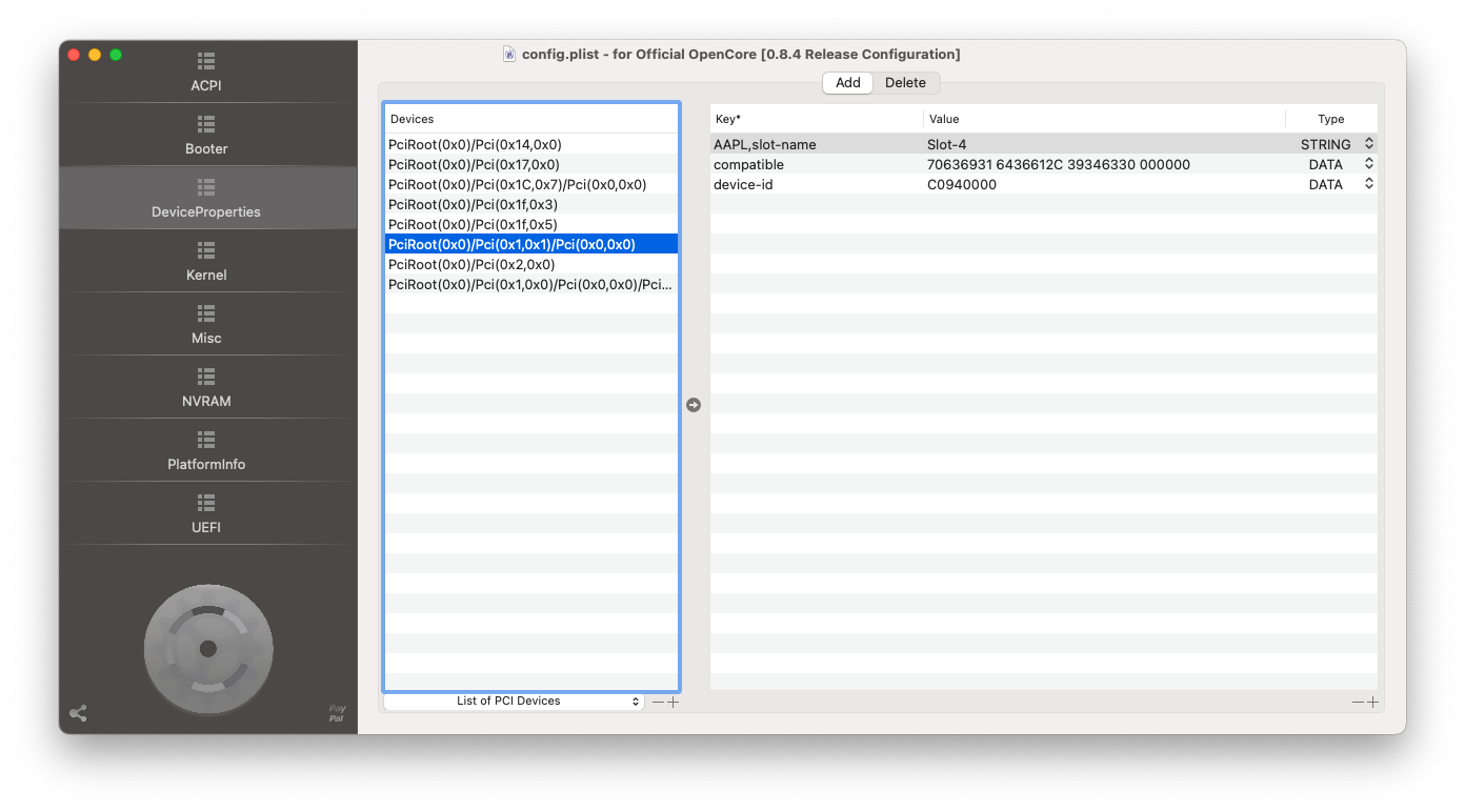

i0ntempest Posted September 23, 2022 Share Posted September 23, 2022 (edited) Success report! I got my new Gigabyte GC-AQC113C to work, and without even using an SSDT. All I did was some device property injections per this tutorial. EDIT: turns out even device-id injection is not necessary, only "compatible" is needed. Edited September 23, 2022 by i0ntempest Link to comment https://www.insanelymac.com/forum/topic/330614-marvell-aquantia-10-gb-ethernet-support-thread/page/18/#findComment-2793849 Share on other sites More sharing options...

Cyberdevs Posted September 28, 2022 Share Posted September 28, 2022 On 9/26/2022 at 8:39 PM, i0ntempest said: 04:00.0 Ethernet controller [0200]: Aquantia Corp. (null) [1d6a:14c0] (rev 03) (subsys 1458:e000) It's not in the pci ids file yet... post IOreg with your current settings, the device id is 14c0 so it is detected correctly. Use IORegistryExplorer Link to comment https://www.insanelymac.com/forum/topic/330614-marvell-aquantia-10-gb-ethernet-support-thread/page/18/#findComment-2794120 Share on other sites More sharing options...
i0ntempest Posted September 28, 2022 Share Posted September 28, 2022 9 hours ago, Cyberdevs said: post IOreg with your current settings, the device id is 14c0 so it is detected correctly. Use IORegistryExplorer Here. Right now I only injected `compatible` field and it's enough to make it work. I've tested injecting `device-id` field together does not fix my problem. Hack Pro.ioreg.zip Link to comment https://www.insanelymac.com/forum/topic/330614-marvell-aquantia-10-gb-ethernet-support-thread/page/18/#findComment-2794145 Share on other sites More sharing options...
