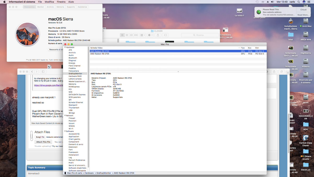

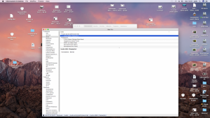

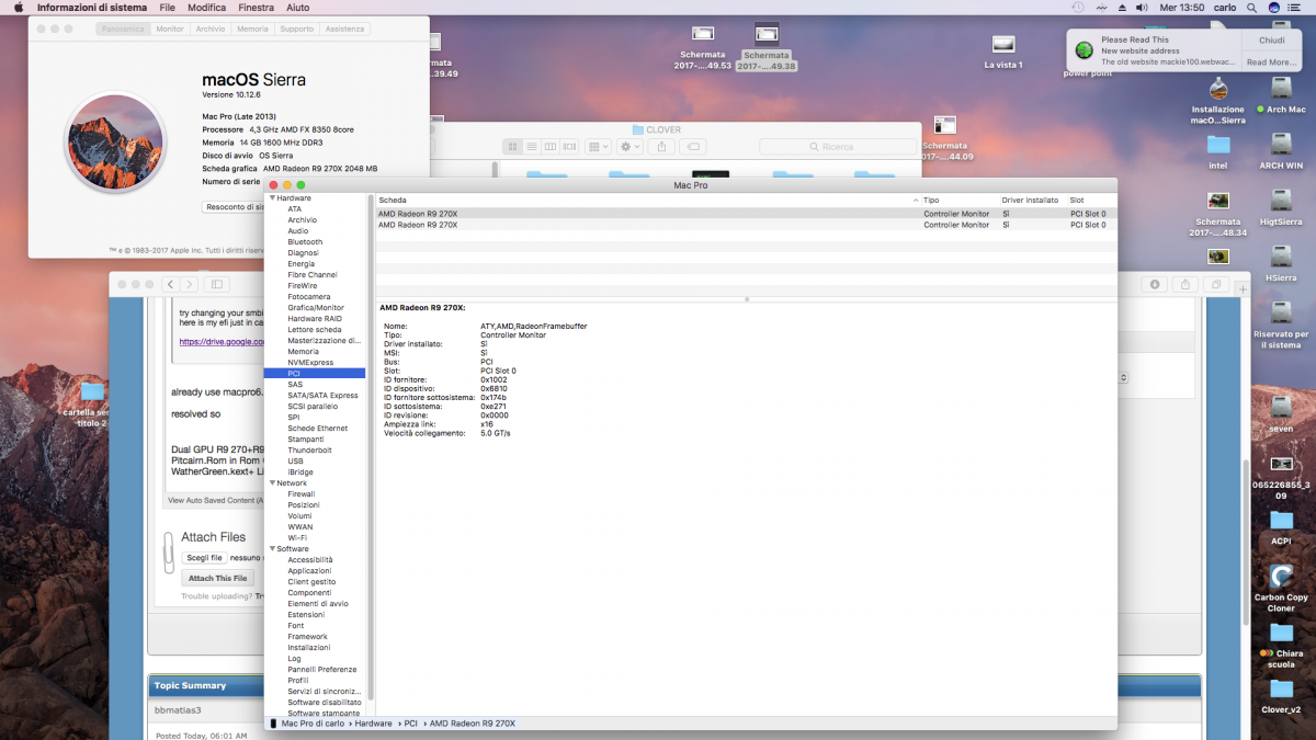

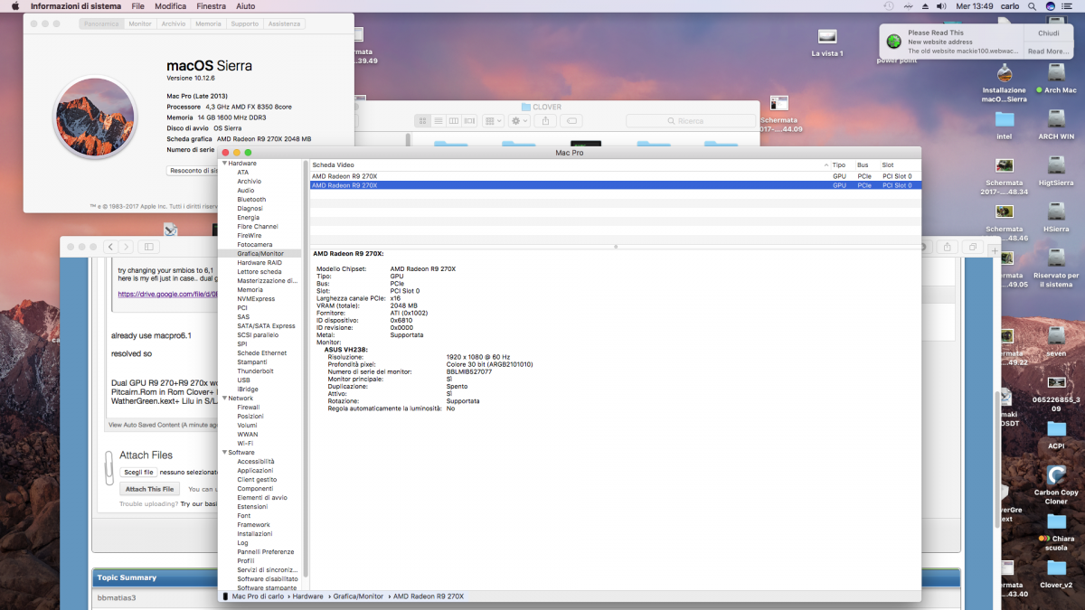

it does not work with two GPUs
with a Gpu running with Sierra and with High Sierra, if I insert the second GPU restart
2x AMD r9 270x
Good with a single GPU HDMI, DVI, Dvi, DP work, stop / wake up OK, Good HSierra replace kext :yes:
with two GPUs nothing, restart :(
try changing your smbios to 6,1
here is my efi just in case.. dual gpu worked for me
https://drive.google.com/file/d/0B-v6U5cirK6TS2lyeVJNclVSSFU/view?usp=sharing
already use macpro6.1
resolved so
Resolved soual Gpu R9 270+ R9 270X works
Sierra and High Sierra, Pitcairn. rom in rom Clover + fake ID 0x68101002
WatherGreen.kext + lilu in S /
Dual GPU R9 270+R9 270x works SIERRA and High Sierra
Pitcairn.Rom in Rom Clover+ FakeID 0x68101002
Whatevergreen+ Lilu in S/L/E
:thumbsup_anim:  :thumbsup_anim:

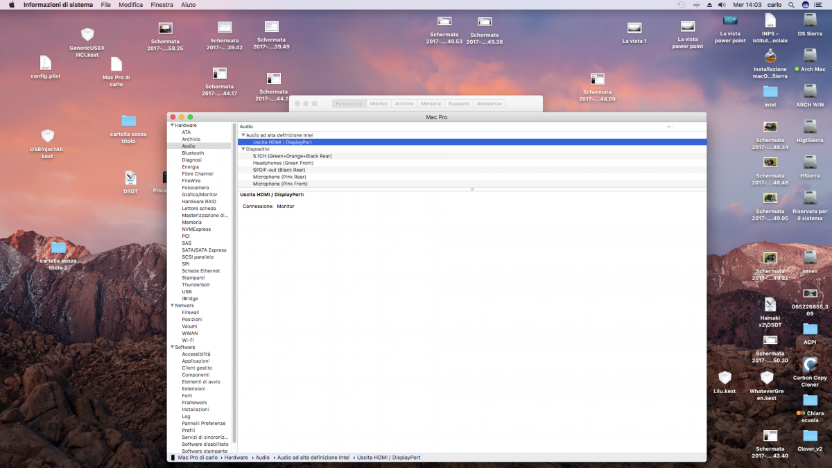

The only thing that remains to us AMD users is the audio that using flag npci = 0xxx does not work
we are forced to use VoodooHDA
even though it is great
