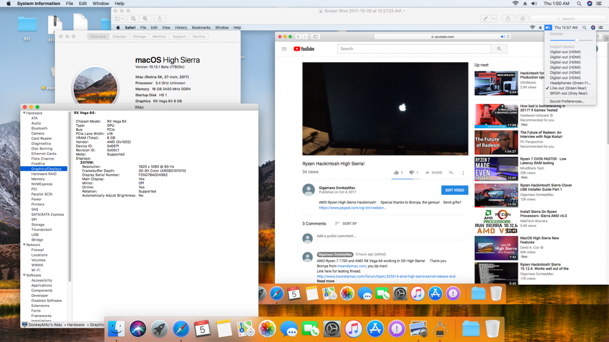

It was hard to get past black screen I first tried RX 480, then Nvidia GT210 (I have same issue as Shaneee), then my trusty old R7 265/ R9 270x. Very cool, next to get things working and then try the vega 64.
This is great. I have a Vega 64. Did you need to do anything special to get working with the GPU?

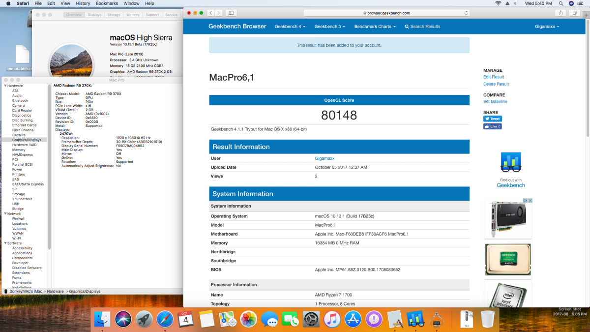

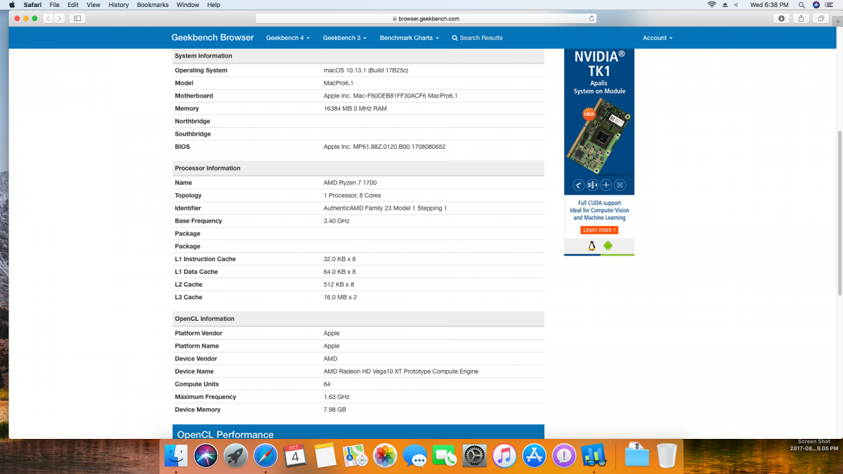

Some graphics issues but kernel seems very stable otherwise.    No crashes, Geekbench CPU is 4150 single core and 21500 for multi core.    OpenGl graphics crashing in Uningine Benchmarks, but it might be a wifi issue?     My Atheros wifi card didn't register, but it works in Sierra and works in High Sierra with Intel pentium.   I'm using my Broadcom 4360 card now no major problems.    I don't have working audio with the Vega card I will try HDA fixes ( works on intel).

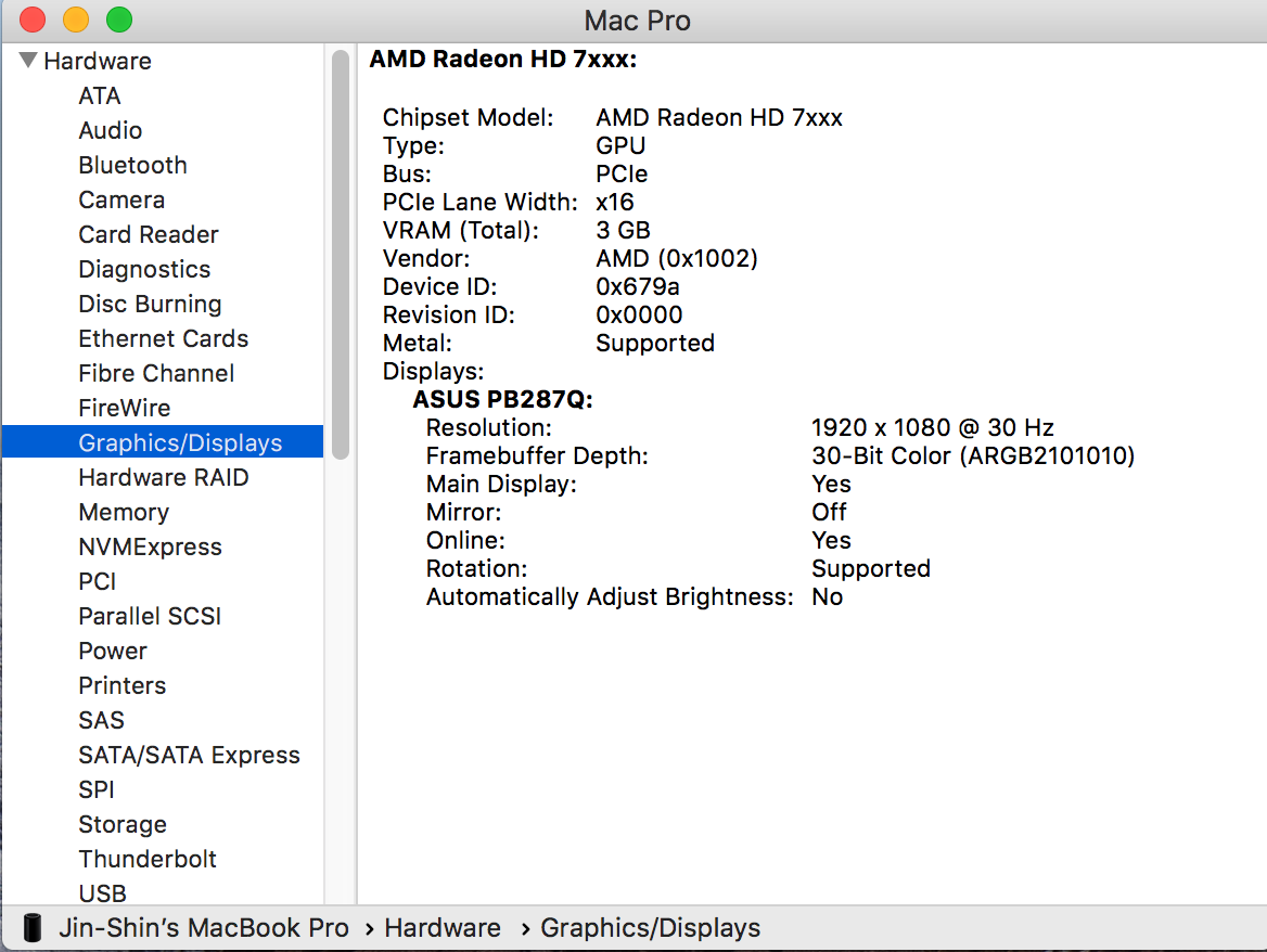

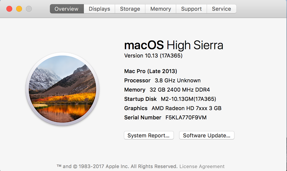

Thanks for this excellent kernel which worked in bot FX-6300 and Ryzen 1700X hackintosh at 10.13GM(17A365).
The only one bug is unable to wake-up from sleep (blank screen) which means either Lilu/WhateverGreen not working or kernel need some modification for this issue.
Attached below shown desktop in Ryzen 1700X hackintosh.
[Edit]
I found the blank screen on wake up from S3 sleep issue can be fixed by loaded Lilu.kext & WhateverGreen.kext in /System/Library/Extensions instead of in EFI/Clover/kexts/other and OC to 3.6GHz in FX-6300 hackintosh & 3.8 GHz in Ryzen 1700X hackintosh.
