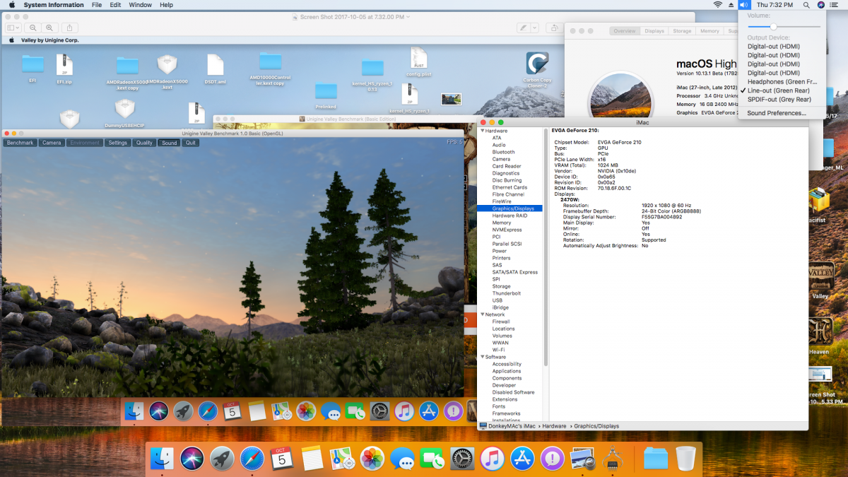

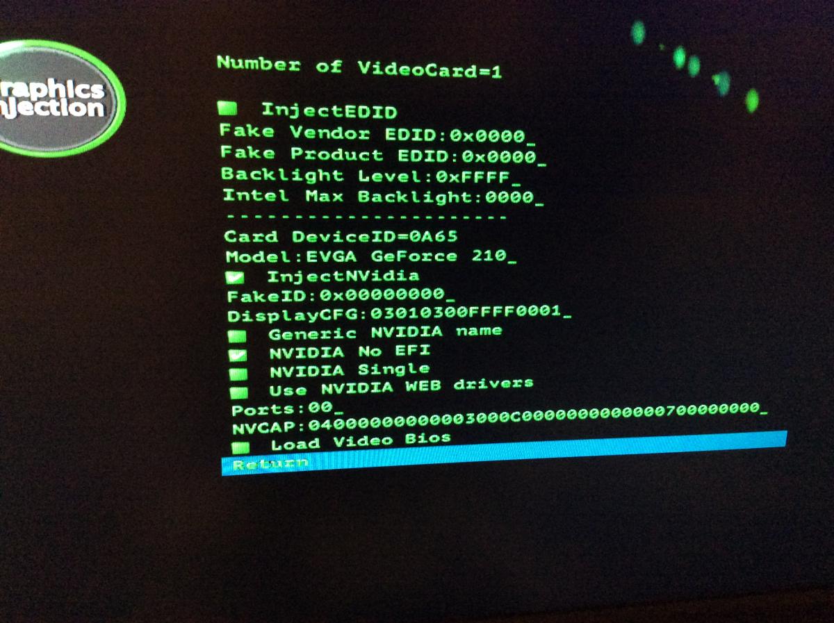

Gigamaxx Posted October 6, 2017 Author Share Posted October 6, 2017 Yeah Ryzen High Sierra GT210 This worked for me, Clover 4020, Inject Nvidia, Nvidia no EFI. First try after changing cards. I knew they added these for a reason. . That’s Uningine Valley basic at 4fps, we’re rockin! Link to comment https://www.insanelymac.com/forum/topic/325514-amd-high-sierra-kernel-release-and-testing/page/9/#findComment-2509502 Share on other sites More sharing options...
