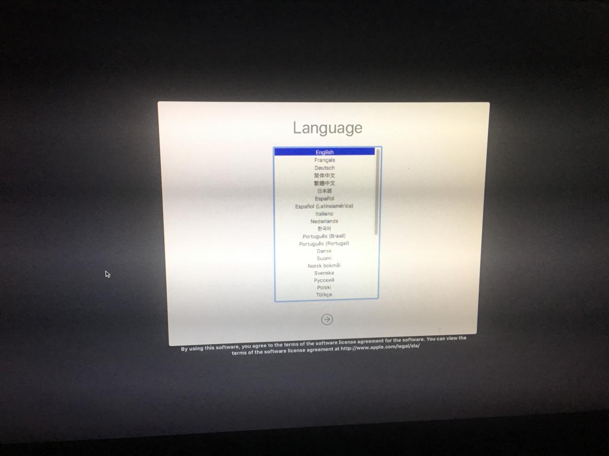

tikizondo94 Posted October 1, 2017 Share Posted October 1, 2017 If they are installed it's NVIDIAWebDrv=Yes Got 10.13 installed using USB but still my GT430 won't work Can only boot in safe mode currently. I still cant get it to boot. "Yet". Im trying to boot off of a cloned SSD drive using a usb dock lol. That may be whats slowing the process down lol Link to comment https://www.insanelymac.com/forum/topic/325514-amd-high-sierra-kernel-release-and-testing/page/3/#findComment-2506355 Share on other sites More sharing options...
Shaneee Posted October 1, 2017 Share Posted October 1, 2017 I still cant get it to boot. "Yet". Im trying to boot off of a cloned SSD drive using a usb dock lol. That may be whats slowing the process down lol Still with Enoch? Clover will show the OPEMU error close to the end of boot. You can fix by using the El Capitan NVDAStartup.kext I had to do this on Sierra. Not sure if it'll work with WebDrivers though. I'm installing the 10.13.1 DP to see if that helps my issue @Bronya can you compile with your modifications please. The makeinc.def file needs different modifications. I can share mine if needed. 2 Link to comment https://www.insanelymac.com/forum/topic/325514-amd-high-sierra-kernel-release-and-testing/page/3/#findComment-2506357 Share on other sites More sharing options...
Gigamaxx Posted October 1, 2017 Author Share Posted October 1, 2017 Still with Enoch? Clover will show the OPEMU error close to the end of boot. You can fix by using the El Capitan NVDAStartup.kext I had to do this on Sierra. Not sure if it'll work with WebDrivers though. I'm installing the 10.13.1 DP to see if that helps my issue @Bronya can you compile with your modifications please. The makeinc.def file needs different modifications. I can share mine if needed. Have you tried lilukext and nvidiagraphicsfixupkext? 2 Link to comment https://www.insanelymac.com/forum/topic/325514-amd-high-sierra-kernel-release-and-testing/page/3/#findComment-2506376 Share on other sites More sharing options...

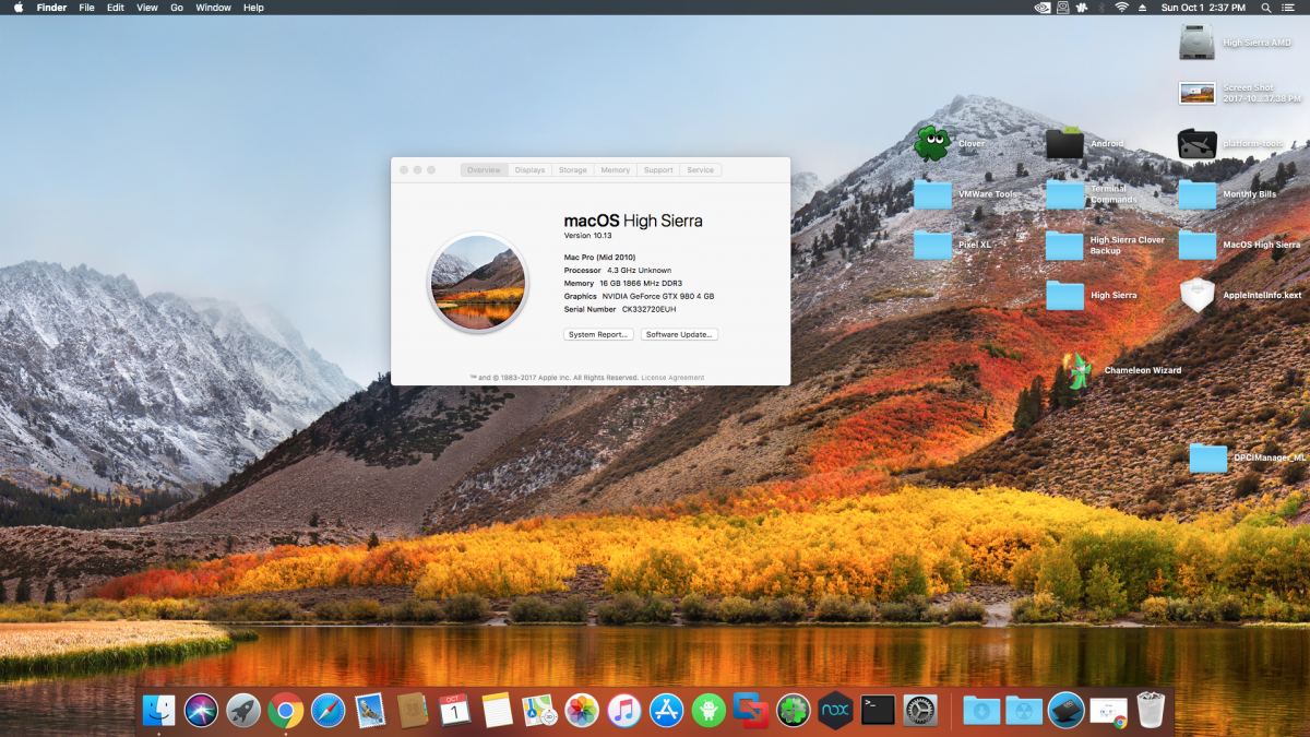

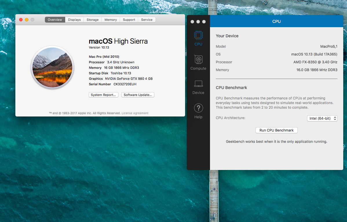

tikizondo94 Posted October 1, 2017 Share Posted October 1, 2017 Ok finally got it all working. Lilu and NvidiaGraphicsFixUp in E/E. Dumped AppleTYMce and Pmtelemetry in S/L/E. Using latest USB sierra fix and AppleAHCIPort.kext in S/L/E. Added Shaneees kernel and all works fine now Nvidia web are loading normally. Smooth so far. Many Thanks Extra.zip 5 Link to comment https://www.insanelymac.com/forum/topic/325514-amd-high-sierra-kernel-release-and-testing/page/3/#findComment-2506420 Share on other sites More sharing options...

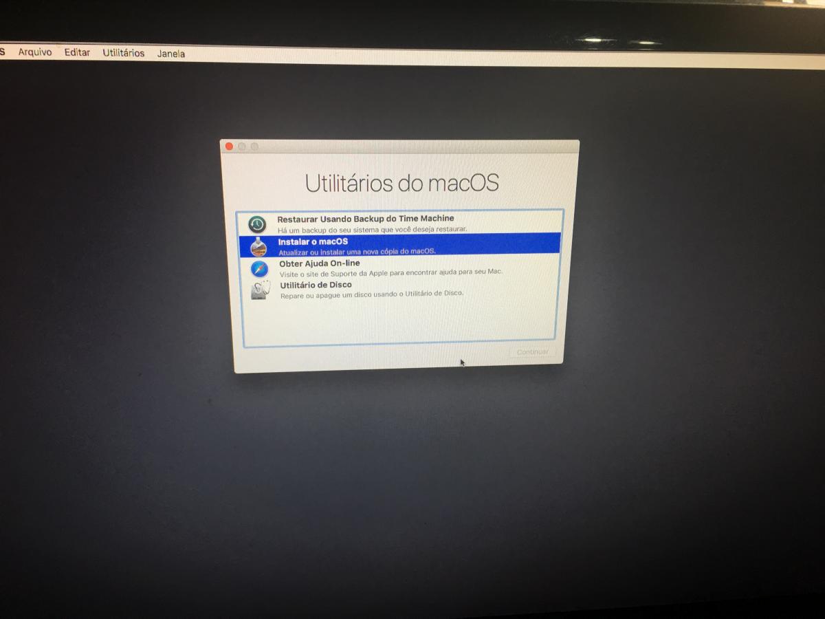

fagneroliveira Posted October 1, 2017 Share Posted October 1, 2017 I get the installer today. I not in home now. In my house i post the process 1 Link to comment https://www.insanelymac.com/forum/topic/325514-amd-high-sierra-kernel-release-and-testing/page/3/#findComment-2506460 Share on other sites More sharing options...

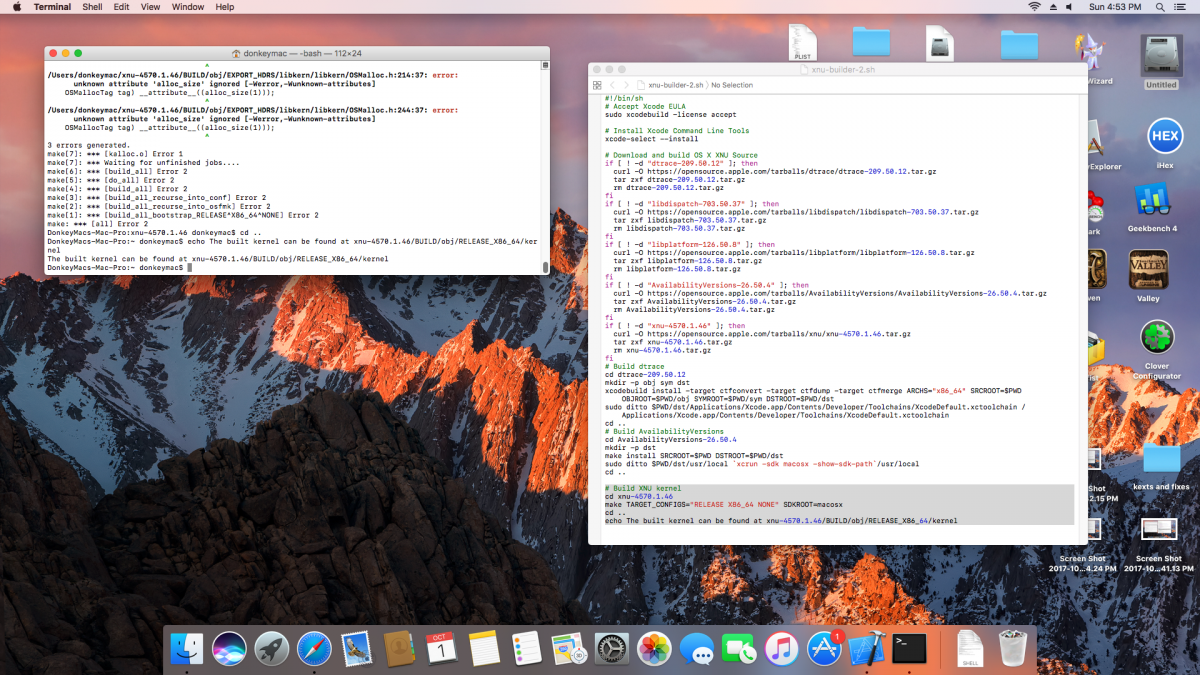

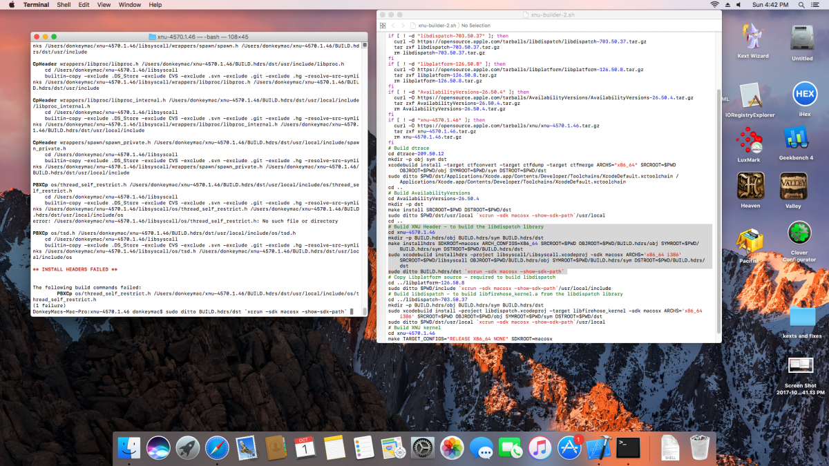

Gigamaxx Posted October 2, 2017 Author Share Posted October 2, 2017 Can I get your diff then so I can build? Many users waiting:) I'll share system kext when I'm next at pc Heres my Terminal output Shaneee from running Duran Keely's command set., let me know if I can provide anything more. If you know how to correct the Header error let me know. Terminal Saved Output.zip 1 Link to comment https://www.insanelymac.com/forum/topic/325514-amd-high-sierra-kernel-release-and-testing/page/3/#findComment-2506667 Share on other sites More sharing options...
ydeng Posted October 2, 2017 Share Posted October 2, 2017 Heres my Terminal output Shaneee from running Duran Keely's command set., let me know if I can provide anything more. If you know how to correct the Header error let me know. just use cp to copy os/thread_self_restrict.h to that BUILD.hdrs/dst/usr/local/include/os . Link to comment https://www.insanelymac.com/forum/topic/325514-amd-high-sierra-kernel-release-and-testing/page/3/#findComment-2506676 Share on other sites More sharing options...

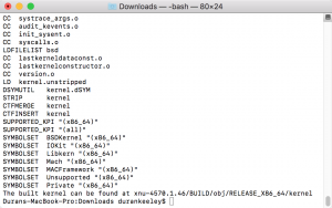

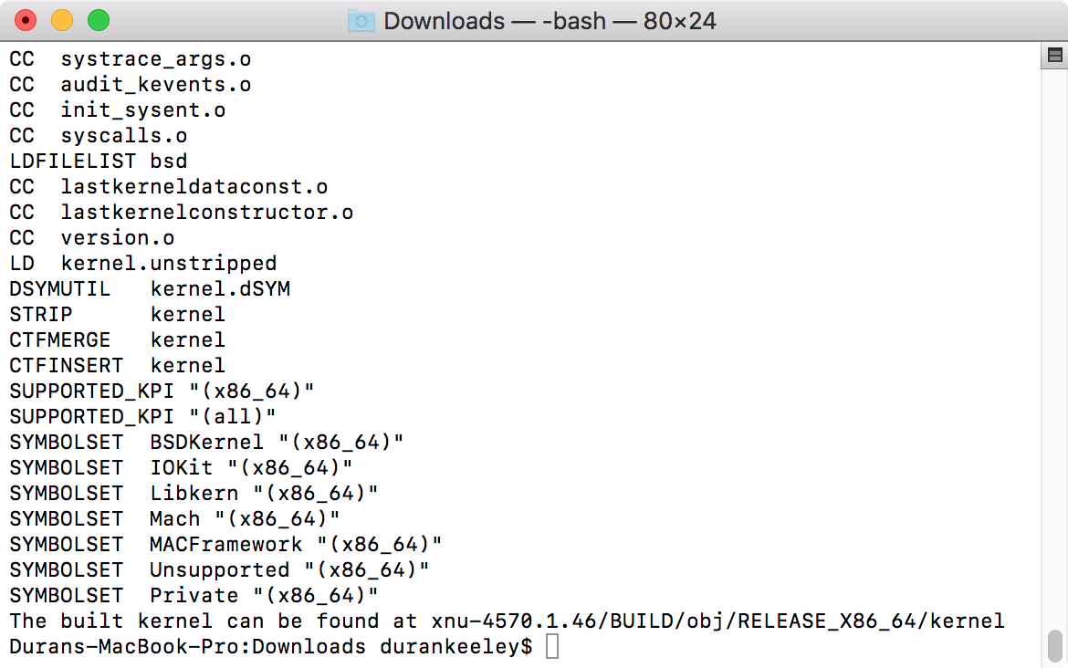

Duran Keeley Posted October 2, 2017 Share Posted October 2, 2017 Didn't complete on my system. 10.12.6 with Xcode 9. My build script has the libdispatch already complied and just installs to the relevant place. 2017-09-30 11:00:46.580 xcodebuild[21465:46871] DVTAssertions: Warning in /Library/Caches/com.apple.xbs/Sources/IDEXcode3ProjectSupport/IDEXcode3ProjectSupport-13203/Xcode3Core/LegacyProjects/Frameworks/DevToolsCore/DevToolsCore/BuildSystem/Runtime/PBXTargetBuildContext.mm:757 Details: unexpected successful exit code from cancelled command <C0009:'PBXCp tsd.h':P6> Object: <PBXTargetBuildContext: 0x7ff0904a60f0> Method: -createCommandInvocationRecordFromInvocation: Thread: <NSThread: 0x7ff09079d670>{number = 14, name = (null)} Please file a bug at http://bugreport.apple.com with this warning message and any useful information you can provide. ** INSTALL HEADERS FAILED ** Heres my Terminal output Shaneee from running Duran Keely's command set., let me know if I can provide anything more. If you know how to correct the Header error let me know. There was a problem with versions but ignore the header msg, you want the firehose file that it builds Sorry I just installed High Sierra on my MacBook now & xcode to test. Anyway, there were a few sloppy coding in the previous builder, this will take you right to the end and build it now. xnu-builder-4570.1.46.zip 2 Link to comment https://www.insanelymac.com/forum/topic/325514-amd-high-sierra-kernel-release-and-testing/page/3/#findComment-2506778 Share on other sites More sharing options...

Shaneee Posted October 2, 2017 Share Posted October 2, 2017 I should also mention guys. I was able to install with the USB method. I just restored a 10.12 installer to USB then replaced System/Library/Installation/Packages with that from the 10.13 InstallESD.dmg, and replaced the BaseSystem.dmg, AppleDiagnostics and the two chunklist files to the root of the USB. These files are hidden on the USB so just use Terminal to remove them. 4 Link to comment https://www.insanelymac.com/forum/topic/325514-amd-high-sierra-kernel-release-and-testing/page/3/#findComment-2506783 Share on other sites More sharing options...

Shaneee Posted October 2, 2017 Share Posted October 2, 2017 greatt ! Shaneee and what bootloader did u use ? I just used the Enoch already on my HDD but Clover should work too. Duran the xnu builds much cleaner on my system now thanks. 1 Link to comment https://www.insanelymac.com/forum/topic/325514-amd-high-sierra-kernel-release-and-testing/page/3/#findComment-2506799 Share on other sites More sharing options...
