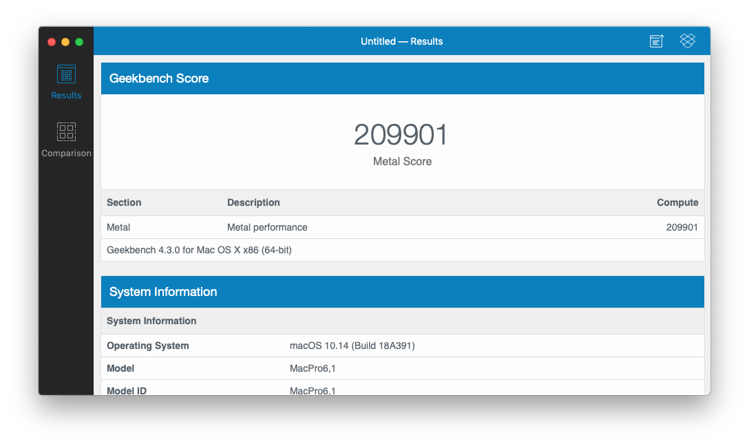

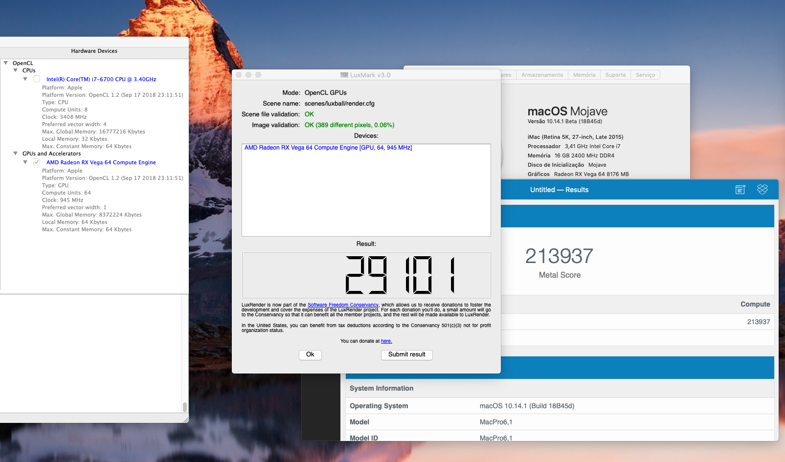

fireedo Posted September 18, 2018 Share Posted September 18, 2018 hi, found this thread very helpful, but how to activate GPU sensors monitoring on this RX VEGA 64? does anyone here have working sensor with their Vega? this is my working kext (at least for me), testing using LuxMark, Rise of the tomb raider and Fortnite, no lag, no freeze and no crash...hope will be "fixed" by apple with the final Mojave AMD10000Controller.kext.zip 1 Link to comment https://www.insanelymac.com/forum/topic/325120-vega-frontier-edition-on-high-sierra/page/14/#findComment-2635505 Share on other sites More sharing options...
Max.1974 Posted September 18, 2018 Share Posted September 18, 2018 1 hour ago, fireedo said: hi, found this thread very helpful, but how to activate GPU sensors monitoring on this RX VEGA 64? does anyone here have working sensor with their Vega? this is my working kext (at least for me), testing using LuxMark, Rise of the tomb raider and Fortnite, no lag, no freeze and no crash...hope will be "fixed" by apple with the final Mojave AMD10000Controller.kext.zip Thanks for reply my friend. Im not advanced user, so im not know how monitoring AMD GPU on macOs. I will test your kext too!! Link to comment https://www.insanelymac.com/forum/topic/325120-vega-frontier-edition-on-high-sierra/page/14/#findComment-2635515 Share on other sites More sharing options...

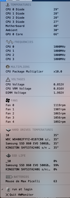

Slice Posted September 19, 2018 Share Posted September 19, 2018 On 9/18/2018 at 1:32 AM, fireedo said: hi, found this thread very helpful, but how to activate GPU sensors monitoring on this RX VEGA 64? does anyone here have working sensor with their Vega? this is my working kext (at least for me), testing using LuxMark, Rise of the tomb raider and Fortnite, no lag, no freeze and no crash...hope will be "fixed" by apple with the final Mojave AMD10000Controller.kext.zip My version of HWSensors3 has VEGA monitoring. The link for download is in my signature. 1 Link to comment https://www.insanelymac.com/forum/topic/325120-vega-frontier-edition-on-high-sierra/page/14/#findComment-2635691 Share on other sites More sharing options...
corint1 Posted September 19, 2018 Share Posted September 19, 2018 (edited) 4 hours ago, Slice said: My version of HWSensors3 has VEGA monitoring. The link for download is in my signature. sorry but ... need some specials config ? for me not working ... all are wrong ... fan show at 16383 rpm ... no vga sensor ... cpu temp wrong...20 c ... etc etc Edited September 19, 2018 by corint1 Link to comment https://www.insanelymac.com/forum/topic/325120-vega-frontier-edition-on-high-sierra/page/14/#findComment-2635731 Share on other sites More sharing options...
Slice Posted September 20, 2018 Share Posted September 20, 2018 20 hours ago, corint1 said: sorry but ... need some specials config ? for me not working ... all are wrong ... fan show at 16383 rpm ... no vga sensor ... cpu temp wrong...20 c ... etc etc You probably mixed different sets. My plugins work with my FakeSMC. You should delete other variants. Application may be HWMonitorSMC2.app or iStatMenu.app. See https://www.insanelymac.com/forum/topic/330115-radeonmonitor-problems/page-6?do=findComment&comment=2550487 1 Link to comment https://www.insanelymac.com/forum/topic/325120-vega-frontier-edition-on-high-sierra/page/14/#findComment-2635853 Share on other sites More sharing options...

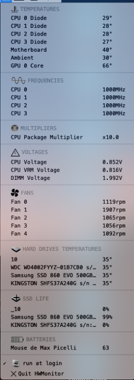

Max.1974 Posted September 20, 2018 Share Posted September 20, 2018 11 hours ago, Slice said: You probably mixed different sets. My plugins work with my FakeSMC. You should delete other variants. Application may be HWMonitorSMC2.app or iStatMenu.app. On 9/19/2018 at 6:17 AM, Slice said: My version of HWSensors3 has VEGA monitoring. The link for download is in my signature. Works very fine @Slice thanks Master!!! Link to comment https://www.insanelymac.com/forum/topic/325120-vega-frontier-edition-on-high-sierra/page/14/#findComment-2635922 Share on other sites More sharing options...
corint1 Posted September 20, 2018 Share Posted September 20, 2018 8 minutes ago, max.1974 said: Works very fine @Slice thanks Master!!! on gigabyte maybe working, but on asus mainboard not ... you both have gigabyte mobo ... 1 Link to comment https://www.insanelymac.com/forum/topic/325120-vega-frontier-edition-on-high-sierra/page/14/#findComment-2635924 Share on other sites More sharing options...

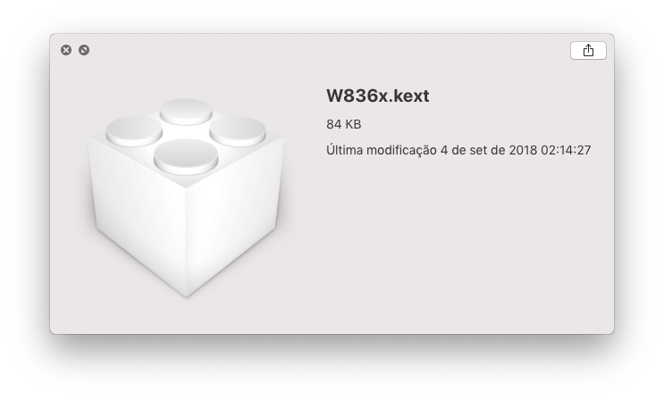

Max.1974 Posted September 22, 2018 Share Posted September 22, 2018 (edited) On 9/20/2018 at 7:31 PM, corint1 said: on gigabyte maybe working, but on asus mainboard not ... you both have gigabyte mobo ... Are you try use this Kext: W836.kext? And use FakeSMC together on Clover folders. Edited September 22, 2018 by max.1974 Link to comment https://www.insanelymac.com/forum/topic/325120-vega-frontier-edition-on-high-sierra/page/14/#findComment-2636065 Share on other sites More sharing options...
corint1 Posted September 22, 2018 Share Posted September 22, 2018 40 minutes ago, max.1974 said: Are you try use this Kext: W836.kext? And use FakeSMC together on Clover folders. yes, i copied the entire folder ... i have all kext files even if some know they do not use me (nvidia) Link to comment https://www.insanelymac.com/forum/topic/325120-vega-frontier-edition-on-high-sierra/page/14/#findComment-2636067 Share on other sites More sharing options...
