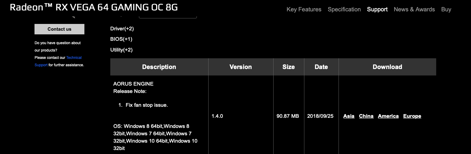

Max.1974 Posted September 27, 2018 Share Posted September 27, 2018 (edited) Maybe someone @okrasit could manage this driver on Windows to use on macOs... FIX FAN ISSUE... release 25/09/2018 Edited September 27, 2018 by max.1974 Link to comment https://www.insanelymac.com/forum/topic/325120-vega-frontier-edition-on-high-sierra/page/15/#findComment-2637104 Share on other sites More sharing options...

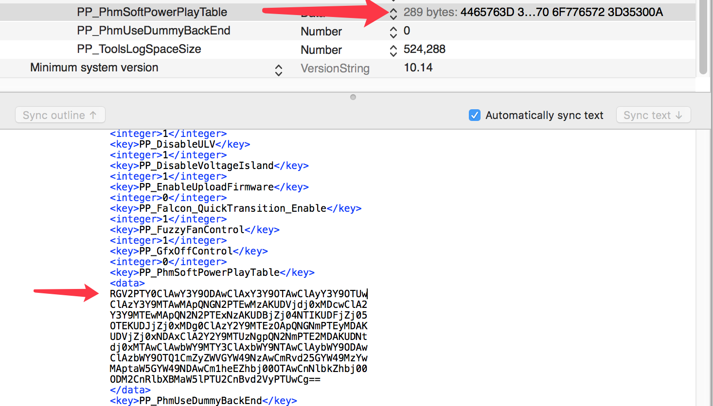

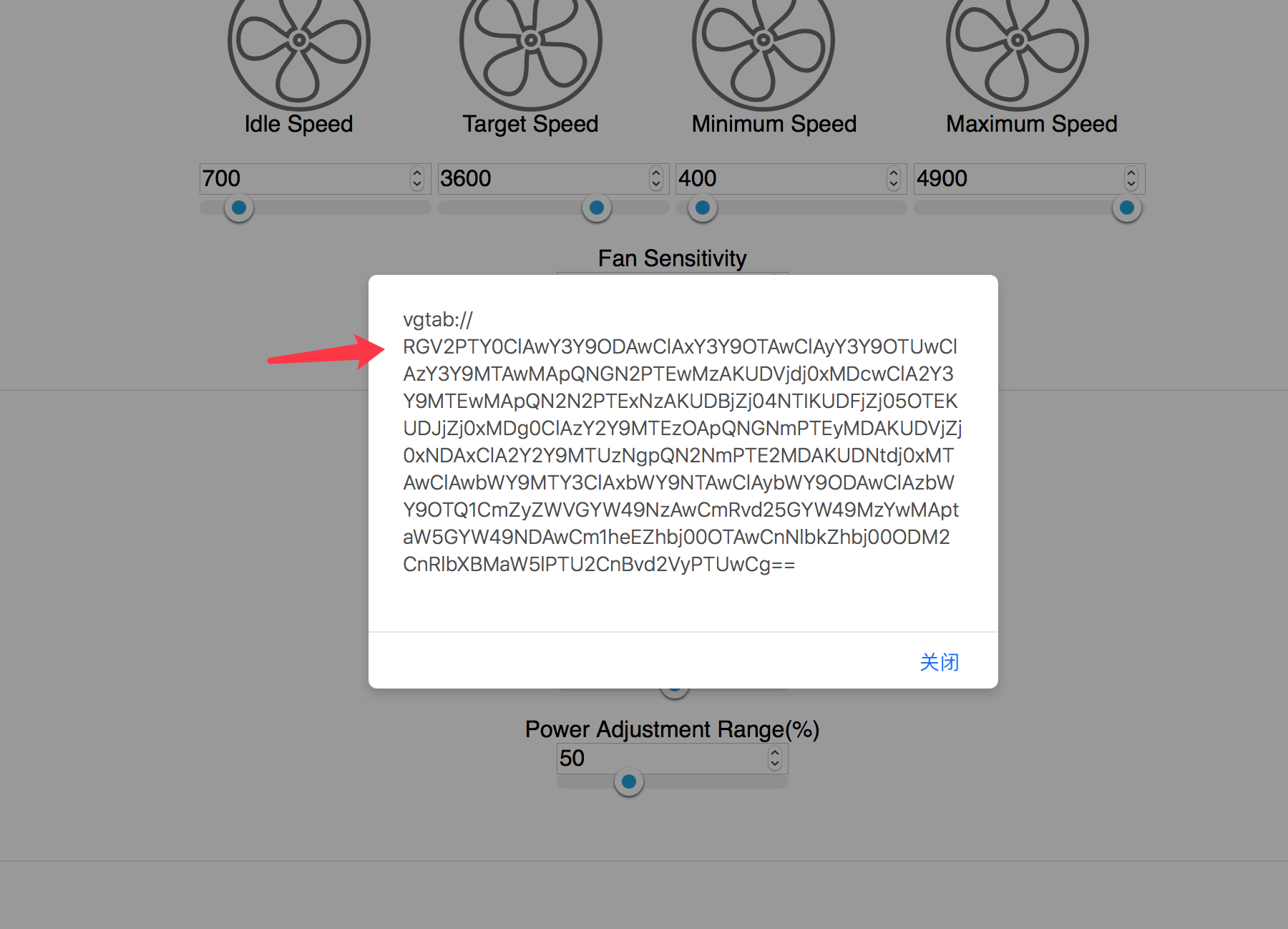

Yangbe Posted September 27, 2018 Share Posted September 27, 2018 I use [ VGTab-en.app ] in the attachment below to generate data like this, -------------------------------------------- and it is different from others do like below, I don't know what is right , and I don't how to generate data like this. VGTab-en.app.zip Link to comment https://www.insanelymac.com/forum/topic/325120-vega-frontier-edition-on-high-sierra/page/15/#findComment-2637163 Share on other sites More sharing options...

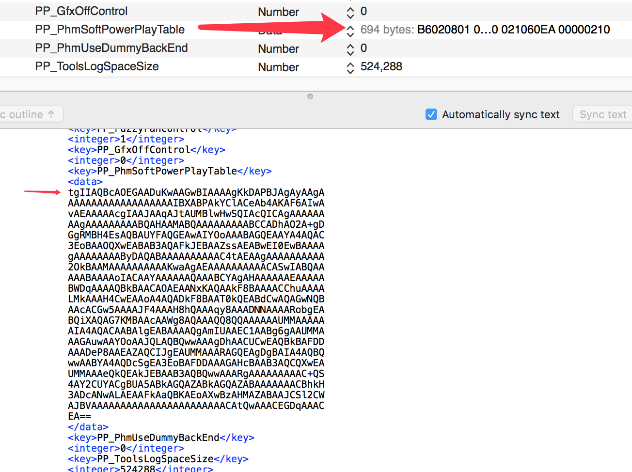

okrasit Posted September 30, 2018 Share Posted September 30, 2018 12 hours ago, CMMChris said: Well, then kindly provide me with a tutorial about how to enable it. This would help a LOT of people out there. Thanks in advance. Try this: tgIIAQBcAOEGAADuKwAAGwBIAAAAgKkDAPBJAgCOAAgAAAAAAAAAAAAAAAAAAAIBXABPAkYClACeAb4AKAF6AIwAvAEAAAAAcgIAAJAAqAJtAUMBlwHwSQIAcQICAgAAAAAAAAgAAAAAAAAABQAHAAMABQAAAAAAAAABCIQDhAOEA4QDhAOEA7YDTAQBAUwEAQGEAwAIYOoAAABAGQEAAYA4AQAC3EoBAAOQXwEABAB3AQAFkJEBAAZQvQEABwEI0EwBAAAAgAAAAAAAAByDAQABAAAAAAAAAABwpwEAAgAAAAAAAAAAiLwBAAMAAAAAAAAAADjBAQAEAAAAAAAAAACI1QEABQAAAAABAAAAmPwBAAYAAAAAAQAAAMBRAgAHAAAAAAEAAAAABWDqAAAAQBkBAACAOAEAANxKAQAAkF8BAAAACChuAAAALMkAAAH4CwEAAoA4AQADkF8BAAT0kQEABdCwAQAGOMEBAAcACGw5AAAAJF4AAAH8hQAAAqy8AAADNNAAAARobgEABQiXAQAGsK0BAAcAAWg8AQAAAQQ8QQAAAAAAUMMAAAAAAIA4AQACAAA0mAEABAAAAQgAmIUAAEC1AABg6gAAUMMAAAGAuwAAYOoAAJQLAQBQwwAAAgDhAACUCwEAQBkBAFDDAAADeP8AAEAZAQCIJgEAUMMAAARAGQEAgDgBAIA4AQBQwwAABYA4AQDcSgEA3EoBAFDDAAAGAHcBAAB3AQCQXwEAUMMAAAeQkQEAkJEBAAB3AQBQwwAAARgAAAAAAAAACwAAvAJIJiUACgBUA5ABkAGQAZABkAGQAZABAAAAAAACBDEH3ADcANwAkAEAAFkAaQBKAEoAXwBzAHMAZABAAJCSl2CWAJBVAAAAAAAAAAAAAAAAAAAAAAACAtQwAAACEGDqAAACEA== 20 hours ago, Pavo said: Safari absolutely supports watching 4k videos on YouTube. Not since Google switched to VP9 codec 1 Link to comment https://www.insanelymac.com/forum/topic/325120-vega-frontier-edition-on-high-sierra/page/15/#findComment-2637988 Share on other sites More sharing options...

Max.1974 Posted October 1, 2018 Share Posted October 1, 2018 3 hours ago, okrasit said: Try this: tgIIAQBcAOEGAADuKwAAGwBIAAAAgKkDAPBJAgCOAAgAAAAAAAAAAAAAAAAAAAIBXABPAkYClACeAb4AKAF6AIwAvAEAAAAAcgIAAJAAqAJtAUMBlwHwSQIAcQICAgAAAAAAAAgAAAAAAAAABQAHAAMABQAAAAAAAAABCIQDhAOEA4QDhAOEA7YDTAQBAUwEAQGEAwAIYOoAAABAGQEAAYA4AQAC3EoBAAOQXwEABAB3AQAFkJEBAAZQvQEABwEI0EwBAAAAgAAAAAAAAByDAQABAAAAAAAAAABwpwEAAgAAAAAAAAAAiLwBAAMAAAAAAAAAADjBAQAEAAAAAAAAAACI1QEABQAAAAABAAAAmPwBAAYAAAAAAQAAAMBRAgAHAAAAAAEAAAAABWDqAAAAQBkBAACAOAEAANxKAQAAkF8BAAAACChuAAAALMkAAAH4CwEAAoA4AQADkF8BAAT0kQEABdCwAQAGOMEBAAcACGw5AAAAJF4AAAH8hQAAAqy8AAADNNAAAARobgEABQiXAQAGsK0BAAcAAWg8AQAAAQQ8QQAAAAAAUMMAAAAAAIA4AQACAAA0mAEABAAAAQgAmIUAAEC1AABg6gAAUMMAAAGAuwAAYOoAAJQLAQBQwwAAAgDhAACUCwEAQBkBAFDDAAADeP8AAEAZAQCIJgEAUMMAAARAGQEAgDgBAIA4AQBQwwAABYA4AQDcSgEA3EoBAFDDAAAGAHcBAAB3AQCQXwEAUMMAAAeQkQEAkJEBAAB3AQBQwwAAARgAAAAAAAAACwAAvAJIJiUACgBUA5ABkAGQAZABkAGQAZABAAAAAAACBDEH3ADcANwAkAEAAFkAaQBKAEoAXwBzAHMAZABAAJCSl2CWAJBVAAAAAAAAAAAAAAAAAAAAAAACAtQwAAACEGDqAAACEA== Not since Google switched to VP9 codec okrasit, are you could post config for this patch? like 1630.... Link to comment https://www.insanelymac.com/forum/topic/325120-vega-frontier-edition-on-high-sierra/page/15/#findComment-2638009 Share on other sites More sharing options...
CMMChris Posted October 1, 2018 Share Posted October 1, 2018 @okrasit Thanks! I meanwhile fixed it myself though. Created an undervolted custom config with VGTab and 1500MHz max clock that runs stable on my machine. Gets me a solid 185k score in Geekbench and 29k score in Luxmark. Also, coil whine is completely gone. Sweet! Here is my code if anyone wants to try: Quote B6020801 005C00E1 060000EE 2B00001B 00480000 0080A903 00F04902 00640008 00000000 00000000 00000000 00000201 5C004F02 46029400 9E01BE00 28017A00 8C00BC01 00000000 72020000 9000A802 6D014301 9701F049 02007102 02020000 00000000 08000000 00000000 05000700 03000500 00000000 00000108 20038403 B603E803 01041A04 33044C04 01013804 01018403 000860EA 00000040 19010001 80380100 02DC4A01 0003905F 01000400 77010005 90910100 066CB001 00070108 80380100 00008000 00000000 00905F01 00010000 00000000 0000A086 01000200 00000000 000000B0 AD010003 00000000 00000000 C0D40100 04000000 00000000 00D0FB01 00050000 00000100 0000E022 02000600 00000001 000000F0 49020007 00000000 01000000 000560EA 00000040 19010000 80380100 00DC4A01 0000905F 01000000 08286E00 00002CC9 000001F8 0B010002 80380100 03905F01 0004F491 010005D0 B0010006 C0D40100 0700086C 39000000 245E0000 01FC8500 0002ACBC 00000334 D0000004 686E0100 05089701 0006ECA3 01000700 01683C01 00000104 3C410000 00000050 C3000000 00008038 01000200 00247101 00040000 01080098 85000040 B5000060 EA000050 C3000001 80BB0000 60EA0000 940B0100 50C30000 0200E100 00940B01 00401901 0050C300 000378FF 00004019 01008826 010050C3 00000440 19010080 38010080 38010050 C3000005 80380100 DC4A0100 DC4A0100 50C30000 06007701 00007701 00905F01 0050C300 00079091 01009091 01000077 010050C3 00000118 00000000 0000000B E412BC02 60093700 0A005403 90019001 90019001 90019001 90010000 00000002 043107DC 00DC00DC 002C0100 00590069 004A004A 005F0073 00730064 00400090 92976096 00905500 00000000 00000000 00000000 00000000 0202D430 00000210 60EA0000 0210 I am using Clover now to inject the settings. Much more convenient than Kext edits / injectors: 4 Link to comment https://www.insanelymac.com/forum/topic/325120-vega-frontier-edition-on-high-sierra/page/15/#findComment-2638063 Share on other sites More sharing options...
Max.1974 Posted October 1, 2018 Share Posted October 1, 2018 (edited) Great my friend!!! and are you not have lags ? Could you post how settings is...clock, memory, etc... Edited October 1, 2018 by max.1974 Link to comment https://www.insanelymac.com/forum/topic/325120-vega-frontier-edition-on-high-sierra/page/15/#findComment-2638095 Share on other sites More sharing options...
CMMChris Posted October 1, 2018 Share Posted October 1, 2018 Settings are: GPU Clock: 800 / 900 / 1000 / 1100 / 1200 / 1300 / 1400 / 1500 GPU Voltage: 800 / 900 / 950 / 1000 / 1025 / 1050 / 1075 / 1100 HBM2 Clock: 167 / 500 / 800 / 945 HBM2 Voltage: 1080 Fan Idle: 700 Fan Target: 2400 Fan Minimum: 400 Fan Maximum: 4900 Target Temperatur: 55°C Power Adjustment Range: 100% Little issue I have: I can only put the code in my clover config.plist with Xcode. When I save the file using Clover Configurator, it changes the Hex values for some reason and it will not work anymore. Anyone knows why it does this? 2 Link to comment https://www.insanelymac.com/forum/topic/325120-vega-frontier-edition-on-high-sierra/page/15/#findComment-2638101 Share on other sites More sharing options...

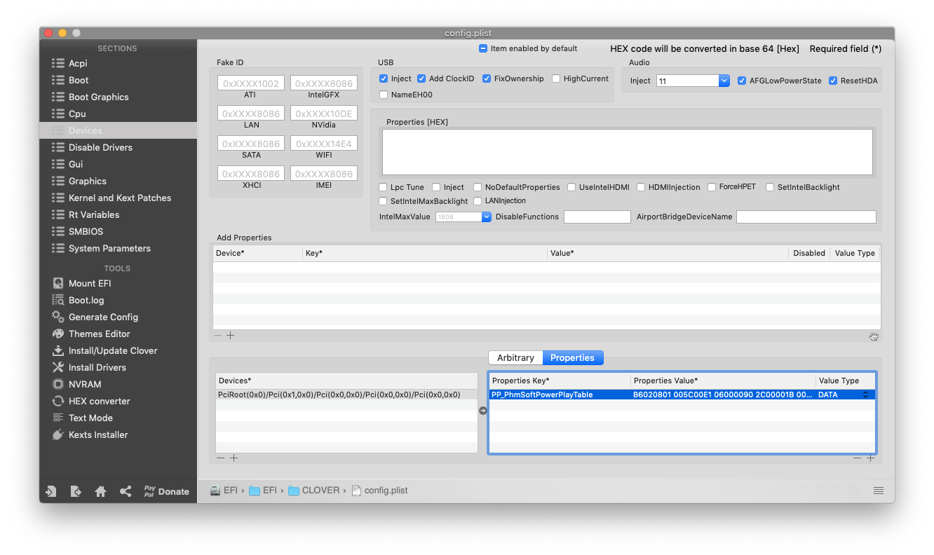

Max.1974 Posted October 1, 2018 Share Posted October 1, 2018 Did you try use PlistEdit Pro? When im use in Clover, not happens this issue.. Tks for reply Chris, what's settings are you using? That from okrasit not stop fan issue... VGTab works for you? Link to comment https://www.insanelymac.com/forum/topic/325120-vega-frontier-edition-on-high-sierra/page/15/#findComment-2638109 Share on other sites More sharing options...
Max.1974 Posted October 1, 2018 Share Posted October 1, 2018 (edited) 11 minutes ago, Wackymac said: has anyone experienced issues after a few hours of up time? my geek bench metal scores drop from 210 000 down to 160 000 only after a few hours of the machine being idle. You need show how is your hardware (signature) and what the macOS that you are using... Edited October 1, 2018 by max.1974 Link to comment https://www.insanelymac.com/forum/topic/325120-vega-frontier-edition-on-high-sierra/page/15/#findComment-2638112 Share on other sites More sharing options...
CMMChris Posted October 1, 2018 Share Posted October 1, 2018 (edited) 18 minutes ago, max.1974 said: Did you try use PlistEdit Pro? When im use in Clover, not happens this issue.. Tks for reply Chris, what's settings are you using? That from okrasit not stop fan issue... VGTab works for you? Settings are posted above. Regarding PlistEdit Pro: Why should I use it? Xcode works fine. My issue is with Clover Configurator. When I use it to edit my Clover config.plist it screws up the PowerPlay Table Hex code. As an example, the code I posted above that works for me, gets changed to this after saving the config.plist with Clover Configurator: Quote B6020801 005C00E1 060000EE 2B00001B 00048000 00080A90 300F0490 20064000 08000000 00000000 00000000 00000002 0105C004 F0246029 4009E01B E0028017 A0008C00 BC010000 00007202 00009000 A80206D0 14301970 1F049020 07102020 20000000 00000008 00000000 00000005 00070000 30005000 00000000 00001082 00384003 B603E803 01041A04 33044C04 01013804 00101840 3000860E A0000004 01901000 01803801 0002DC4A 01000390 5F010004 00077010 00590910 100066CB 00100070 10088038 01000000 80000000 00000090 5F010000 10000000 00000000 0A086010 00200000 00000000 0000B0AD 01000300 00000000 0000000C 0D401000 40000000 00000000 00D0FB01 00050000 00000100 0000E022 00200060 00000000 1000000F 04902000 07000000 00010000 00000560 EA000000 40019010 00080380 10000DC4 A0100009 050F0100 00000828 6E000000 2CC90000 01F800B0 10002803 80100039 05F01000 4F490101 0005D0B0 010006C0 D4010007 00086C03 90000002 45E00000 1FC85000 002ACB0C 00000334 D0000004 686E0100 05089701 00006ECA 30100070 001683C0 10000010 043C4100 00000000 50C30000 00000080 38001000 20000247 10100040 00001080 09088500 0040B500 0060EA00 0050C300 0001080B B000060E A0000940 B010050C 30000002 00E10000 940B0100 40190100 50C30000 00378FF0 00040190 10088260 10050C03 00000440 19010080 38010080 38010050 0C300000 58038010 0DC4A010 0DC4A010 0050C300 00060077 01000077 0100905F 0100050C 30000079 09101009 09101000 07070100 50C30000 01180000 00000000 000B0E41 2BC02600 937000A0 05403900 19000190 01900190 01900190 01000000 00000200 43107DC0 0DC00DC0 02C01000 05900609 004A004A 005F0073 00730064 00400090 09297609 60090550 00000000 00000000 00000000 00000000 000202D4 30000002 10060EA0 000021 With Xcode the Hex values remain unchanged. Edited October 1, 2018 by CMMChris Link to comment https://www.insanelymac.com/forum/topic/325120-vega-frontier-edition-on-high-sierra/page/15/#findComment-2638114 Share on other sites More sharing options...
