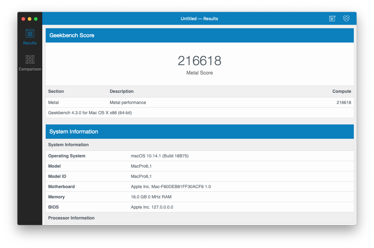

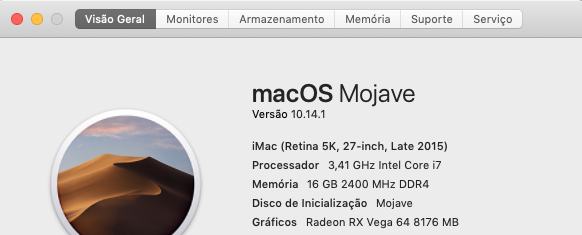

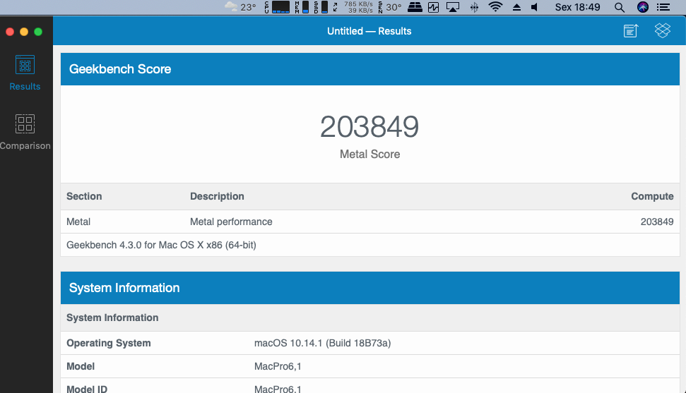

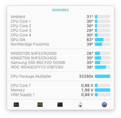

Max.1974 Posted October 31, 2018 Share Posted October 31, 2018 Im felling good changes in new Mojave update!!! Build 18B75 "Fan Speed(%)"=14 "Core Clock(MHz)"=1619 "Memory Clock(MHz)"=1045 "Fan Speed(RPM)"=719 "Temperature(C)"=61 Link to comment https://www.insanelymac.com/forum/topic/325120-vega-frontier-edition-on-high-sierra/page/19/#findComment-2644139 Share on other sites More sharing options...
douirc Posted October 31, 2018 Share Posted October 31, 2018 4 hours ago, CMMChris said: I created a PowerPlayTable Generator in Excel based on a Windows PowerPlayTable. Offers much more settings than VGTab. This works great for me. You guys can play around with different settings. The Preset is an OC card stock configuration with lower voltage and overclocked memory. Should work fine for all cards. To use the data, paste the hex code into an editor, get rid of line breaks and spaces and then insert it into your Clover config or the Kext files info.plist using a plist editor like Xcode (will automatically convert it into the base64 encoded data). vega64-mac-pp_table-gen.xlsx super cool, thanks for sharing! so you just change the values in column AF to produce the hex table, then convert to base64 and upload to kext. my next challenge, understanding the rhyme/reason for the values in column AF 1 Link to comment https://www.insanelymac.com/forum/topic/325120-vega-frontier-edition-on-high-sierra/page/19/#findComment-2644140 Share on other sites More sharing options...

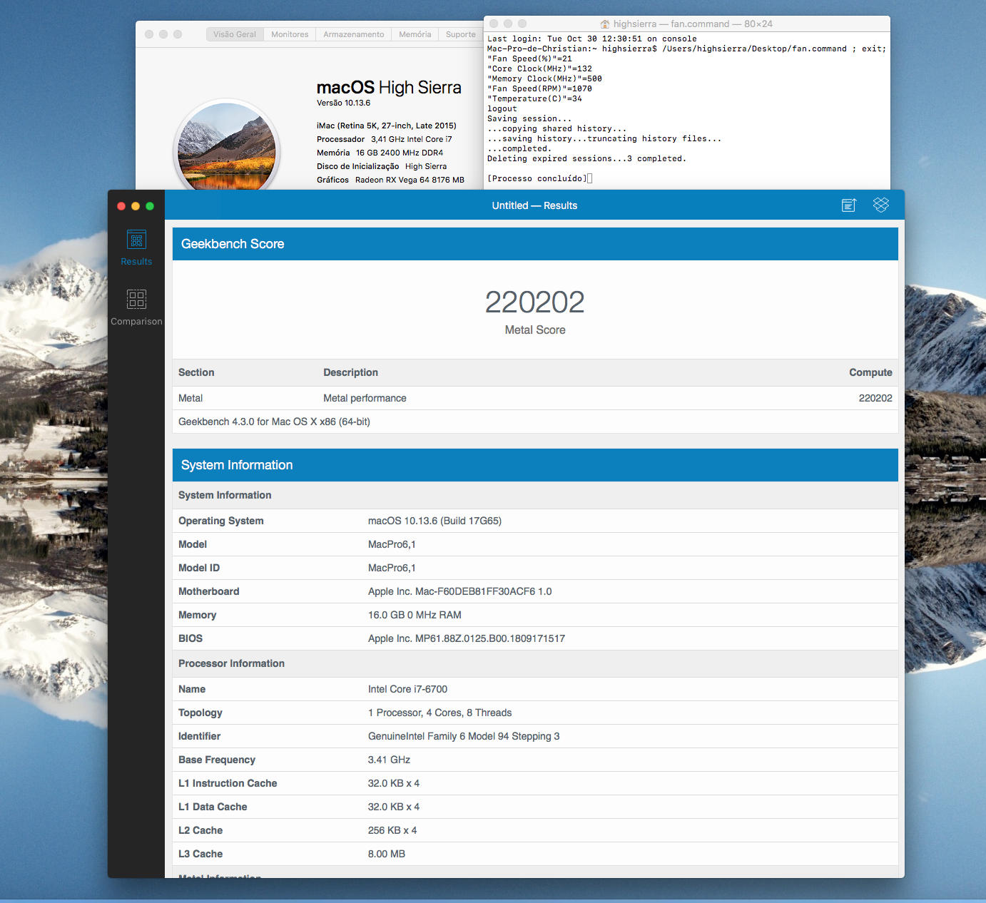

Max.1974 Posted October 31, 2018 Share Posted October 31, 2018 HS still Very Awesome, quiet and Good!!! Link to comment https://www.insanelymac.com/forum/topic/325120-vega-frontier-edition-on-high-sierra/page/19/#findComment-2644141 Share on other sites More sharing options...
douirc Posted October 31, 2018 Share Posted October 31, 2018 4 minutes ago, max.1974 said: Im felling good changes in new Mojave update!!! Build 18B75 This mean 10.14.1 supports Vega 64 OOTB? No more playing with PowerTables? 1 Link to comment https://www.insanelymac.com/forum/topic/325120-vega-frontier-edition-on-high-sierra/page/19/#findComment-2644143 Share on other sites More sharing options...
Max.1974 Posted October 31, 2018 Share Posted October 31, 2018 10 minutes ago, douirc said: This mean 10.14.1 supports Vega 64 OOTB? No more playing with PowerTables? Im not sure, but you need test without power table... im not tested without...but it seems like High Sierra to me.... very strong... Link to comment https://www.insanelymac.com/forum/topic/325120-vega-frontier-edition-on-high-sierra/page/19/#findComment-2644144 Share on other sites More sharing options...
