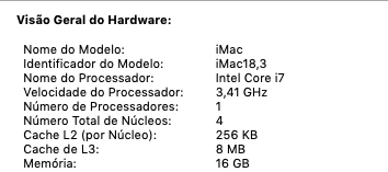

Max.1974 Posted September 1, 2018 Share Posted September 1, 2018 (edited) Hi all!!! had a new versions of Lilu and WhateverGreen kexts, that's very fine with RX Vega. Another detail is that im change my SMBIOS. Now im using iMac 18,3. Before im using 17,1. and using my edited VegaTab_64.kext, nice and quite fans. Don't forget that's important too enable IGFX graphic in MotherBoard Bios, but not connected anything, just Vega. Good weekend for all!!!! Edited September 1, 2018 by max.1974 Link to comment https://www.insanelymac.com/forum/topic/325120-vega-frontier-edition-on-high-sierra/page/13/#findComment-2632753 Share on other sites More sharing options...

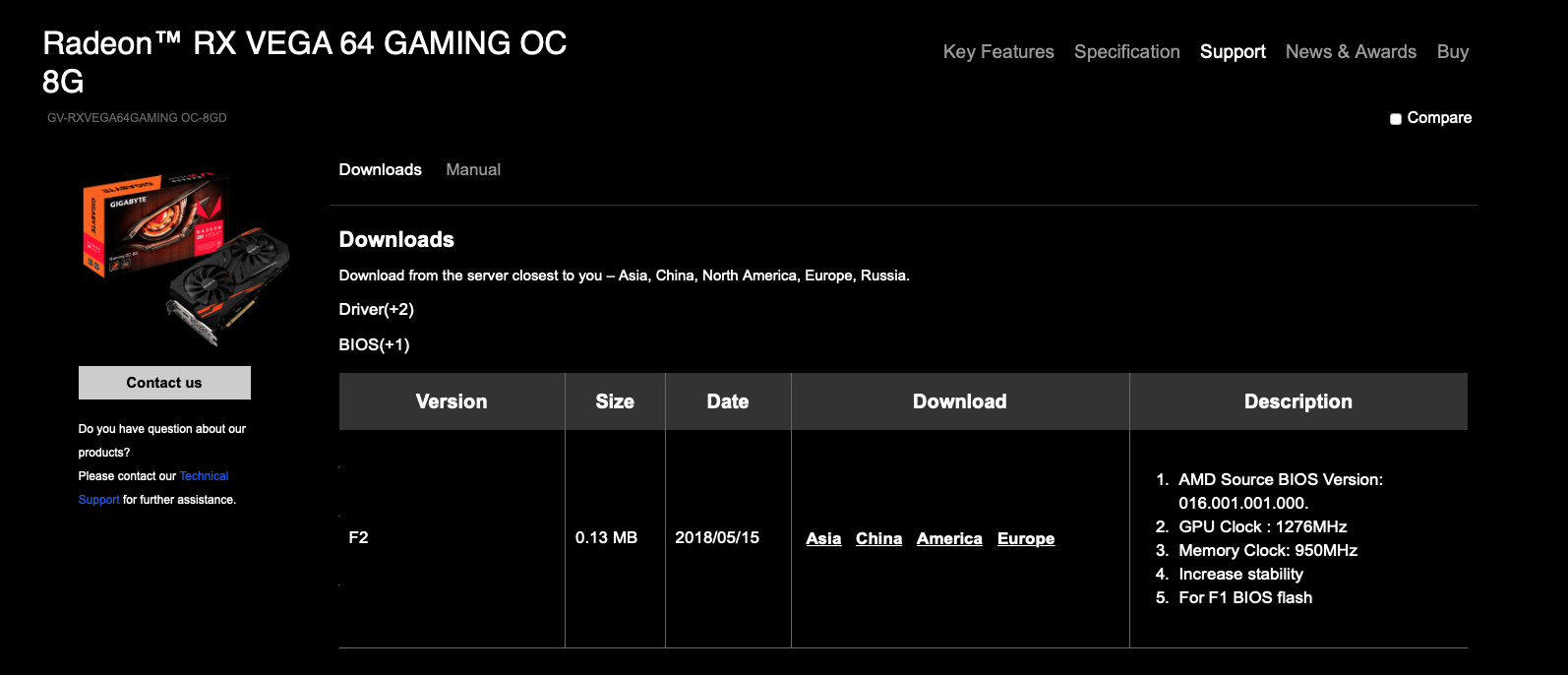

CMMChris Posted September 3, 2018 Share Posted September 3, 2018 @max.1974 Yup, same card as mine. I am running a golden build. Everything works and is recognized correctly. My only issue is the graphics card which I can not run at its full clock speed or it will crash. What BIOS have you flashed on it? From a different card or the latest BIOS provided by Gigabyte? Because I have already updated mine to the latest from Gigabyte. 1 Link to comment https://www.insanelymac.com/forum/topic/325120-vega-frontier-edition-on-high-sierra/page/13/#findComment-2633075 Share on other sites More sharing options...

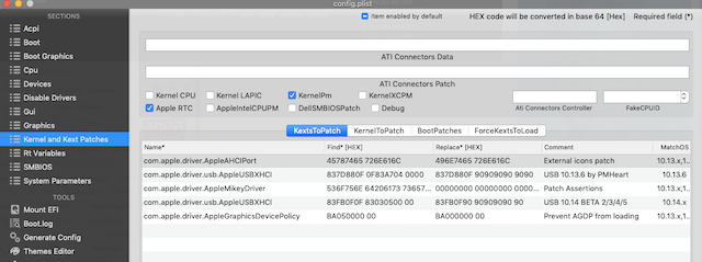

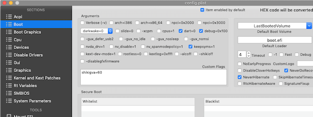

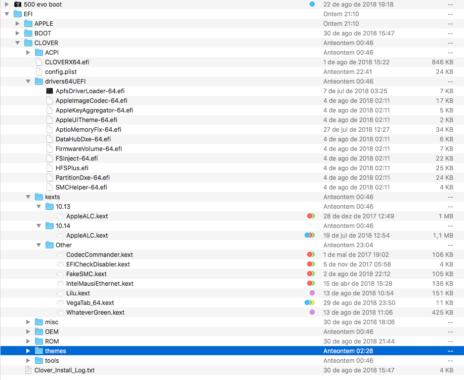

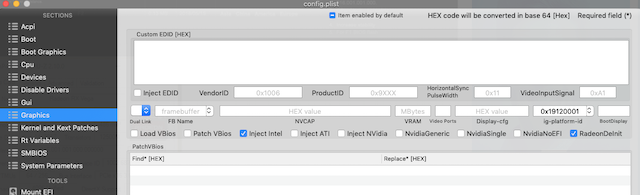

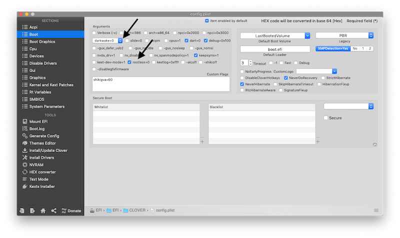

Max.1974 Posted September 3, 2018 Share Posted September 3, 2018 (edited) @CMMChris im flash bios F2 from Gigabyte support, and im using just Vega Tab and nothing more...sorry for your trouble...Who knows if is better when final Mojave is come... https://www.gigabyte.com/Graphics-Card/GV-RXVEGA64GAMING-OC-8GD#support-dl-bios EDIT: And just for information, my Clover settings is that: Edited September 3, 2018 by max.1974 Link to comment https://www.insanelymac.com/forum/topic/325120-vega-frontier-edition-on-high-sierra/page/13/#findComment-2633098 Share on other sites More sharing options...

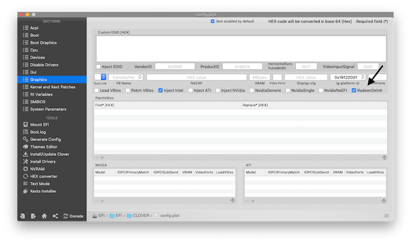

CMMChris Posted September 4, 2018 Share Posted September 4, 2018 Why do you have "RadeonDeInit" set? 1 Link to comment https://www.insanelymac.com/forum/topic/325120-vega-frontier-edition-on-high-sierra/page/13/#findComment-2633195 Share on other sites More sharing options...

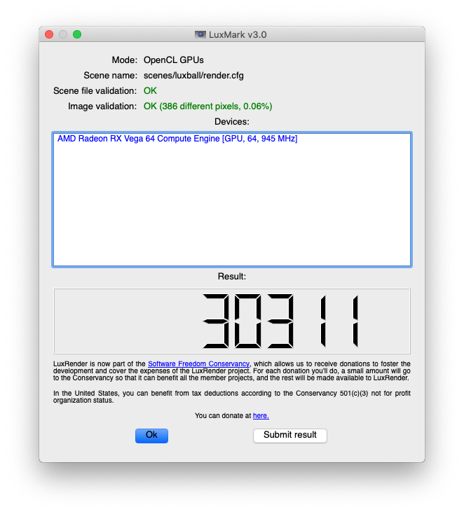

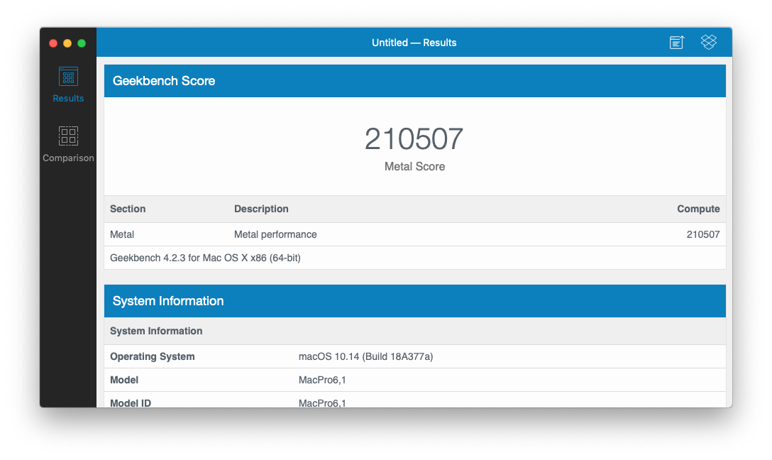

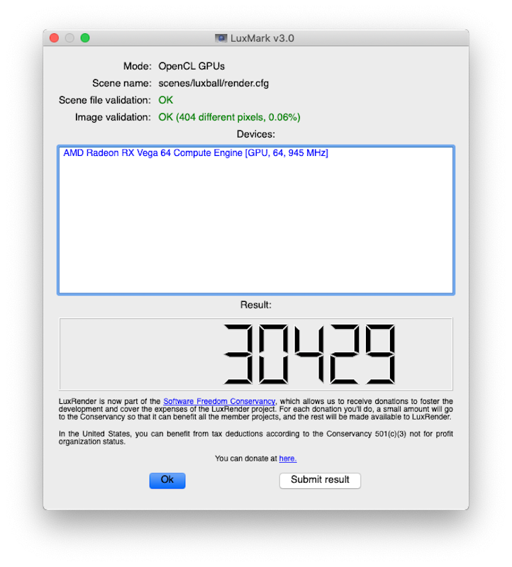

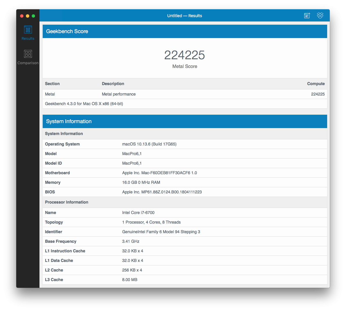

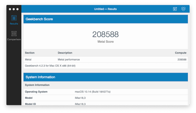

Max.1974 Posted September 4, 2018 Share Posted September 4, 2018 (edited) @CMMChris im read in others forums that is important check this RadeonDelnit. I've been edit kexts and others configurations on Clover. If you want, you can test this, because really better performance the card. Im wish that thinks help you and others guys!! Remember that im not expert users, so if someone have a better idea, please, tell us... Im will test in High Sierra, but im not install HS yet... The numbers above its higher, but not was constantly, a feel tests all long to use system came down, but now I have same results anytime. So im think is better have this stabilities ... Im notice too, that when we open a Safari on YouTube, and play any video, and run GeekBench 4, the scores up!!!! So im think that is because AMD RX Vega 64 just had your better performance just when is used, im not sure...but seems to me... Good Luck my friends!!! Im make this: New VegaTab_64.kext VegaTab_64.kext-edited 04.09.2018.zip WHIT SAFARI RUNS VIDEO ON YOUTUBE Edited September 4, 2018 by max.1974 Link to comment https://www.insanelymac.com/forum/topic/325120-vega-frontier-edition-on-high-sierra/page/13/#findComment-2633211 Share on other sites More sharing options...

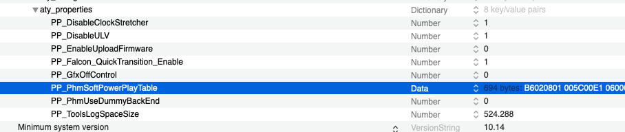

Max.1974 Posted September 7, 2018 Share Posted September 7, 2018 (edited) Hi all... im decide change power table in Vega Tab for insert PP_PhmSoftPowerPlayTable on Amd10000Controller.kext plist If someone wanted im share the last kext from Mojave beta 10 already modified with values from posts above credits: @okrasit My GPU is Radeon™ RX VEGA 64 GAMING OC 8G Core: 1642MHz/1150mV, Memory: 1045MHz/1075mV, SOC: 1199MHz, Temp target: 70, Idle fan: 700rpm B6020801 005C00E1 060000EE 2B00001B 00480000 0080A903 00F04902 008E0008 00000000 00000000 00000000 00000201 5C004F02 46029400 9E01BE00 28017A00 8C00BC01 00000000 72020000 9000A802 6D014301 9701F049 02007102 02020000 00000000 08000000 00000000 05000700 03000500 00000000 00000108 84038403 B603E803 1A044C04 60047E04 01013304 01018403 000860EA 00000040 19010001 80380100 02DC4A01 0003905F 01000400 77010005 90910100 0650BD01 00070108 D04C0100 00008000 00000000 00448D01 00010000 00000000 0000DCC7 01000200 00000000 00000098 FC010003 00000000 00000000 D81B0200 04000000 00000000 00F44002 00050000 00000100 00001C64 02000600 00000001 00000068 81020007 00000000 01000000 000560EA 00000040 19010000 80380100 00DC4A01 0000905F 01000000 08286E00 00002CC9 000001F8 0B010002 80380100 03905F01 0004F491 010005D0 B0010006 38C10100 0700086C 39000000 245E0000 01FC8500 0002ACBC 00000334 D0000004 686E0100 05089701 0006B0AD 01000700 01683C01 00000104 3C410000 00000050 C3000000 00008038 01000200 00349801 00040000 01080098 85000040 B5000060 EA000050 C3000001 80BB0000 60EA0000 940B0100 50C30000 0200E100 00940B01 00401901 0050C300 000378FF 00004019 01008826 010050C3 00000440 19010080 38010080 38010050 C3000005 80380100 DC4A0100 DC4A0100 50C30000 06007701 00007701 00905F01 0050C300 00079091 01009091 01000077 010050C3 00000118 00000000 0000000B 0000BC02 48264600 0A005403 90019001 90019001 90019001 90010000 00000002 04310790 01900190 01900100 00590069 004A004A 005F0073 00730064 00400090 92976096 00905500 00000000 00000000 00000000 00000000 0202D430 00000210 60EA0000 0210 Im update FakeSMC and Sensors that help very much!!! (RehabMan credits). Im not use anymore Vega_Tab64.kext on "other" folder, so need delete from Clover folders. Very quiet and have a very Good Performance on Mojave Beta 10. You can check with this Command on Terminal: ioreg -l |grep \"PerformanceStatistics\" | cut -d '{' -f 2 | tr '|' ',' | tr -d '}' | tr ',' '\n'|grep 'Temp\|Fan' My values constantly is: "Fan Speed(%)"=16 "Fan Speed(RPM)"=793 "Temperature(C)"=36 Don't forget the use kext utility and after quit, run this command in terminal: sudo touch /System/Library/Extensions && sudo kextcache -u / Aternative you can run after command above, run too RepairPermission command from Olarila.com with reset Nvram on boot and so type "y" to Restart... (don't worry the clock will back after few reboots) RepairPermissions.zip I hope so can help someone!!! AMD10000Controller.kext.zip Other.zip config.plist.zip im change my serial board and my MB is GIGABYTE Z170XP-SLi / i7 Skylake 3,40 Ghz / Kext Utility.zip RehabMan-FakeSMC-2018-0403 - MONITOR.zip (in the other folder have the same files, just Monitor app you can put on Applications and run it after boot) Credits: @MaLd0n and @RehabMan Radeon™ RX VEGA 64 GAMING OC 8G Edited September 7, 2018 by max.1974 2 Link to comment https://www.insanelymac.com/forum/topic/325120-vega-frontier-edition-on-high-sierra/page/13/#findComment-2633781 Share on other sites More sharing options...

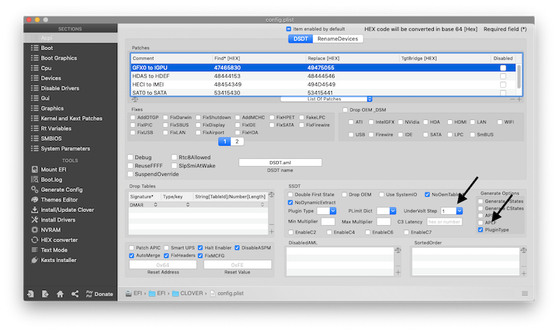

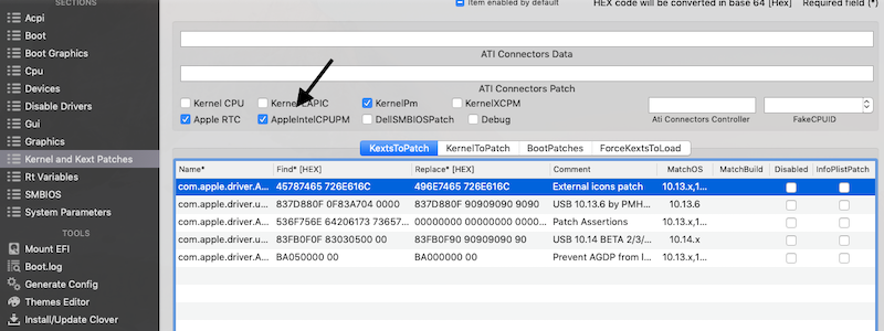

Gen4ig Posted September 14, 2018 Share Posted September 14, 2018 (edited) This way good work from properties without any modification with original kext. like this: Edited September 14, 2018 by Gen4ig 2 Link to comment https://www.insanelymac.com/forum/topic/325120-vega-frontier-edition-on-high-sierra/page/13/#findComment-2634737 Share on other sites More sharing options...

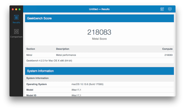

Max.1974 Posted September 15, 2018 Share Posted September 15, 2018 (edited) On High Sierra, im have this result: AMD1000 HIGH SIERRA 10.13.6.zip Edited September 15, 2018 by max.1974 Link to comment https://www.insanelymac.com/forum/topic/325120-vega-frontier-edition-on-high-sierra/page/13/#findComment-2635200 Share on other sites More sharing options...
