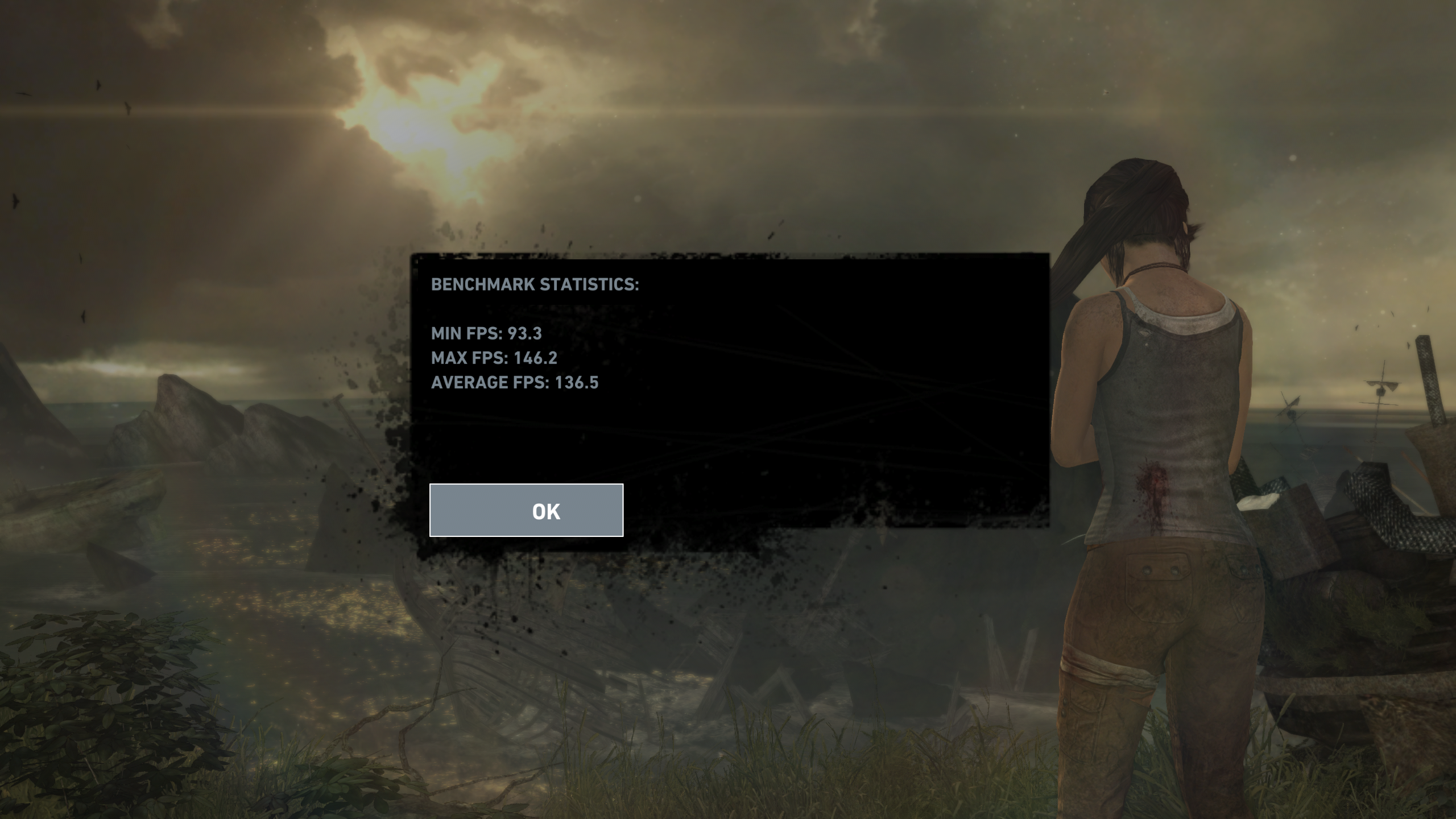

WannaBeOCer Posted June 30, 2018 Share Posted June 30, 2018 (edited) 22 hours ago, surfinchina said: Yes I know! Mojave is great with the Vega. Better than windows now. The 10.13.6 latest seems to have got the same treatment. For me anyway. They're finally getting the Vega working as it should. Can you comment on the difference in temps? My Vega crashed a couple of times on Mojave when I was running the speedup kext and was running quite hot... I'm not using any powerplay kext, only whatevergreen with the Mojave driver. Just played 2 hours of Tomb Raider 2560x1440p @ 144hz and the highest temp I saw was 47c with the fan set to 2200RPM. Edited June 30, 2018 by WannaBeOCer Link to comment https://www.insanelymac.com/forum/topic/325120-vega-frontier-edition-on-high-sierra/page/11/#findComment-2623198 Share on other sites More sharing options...

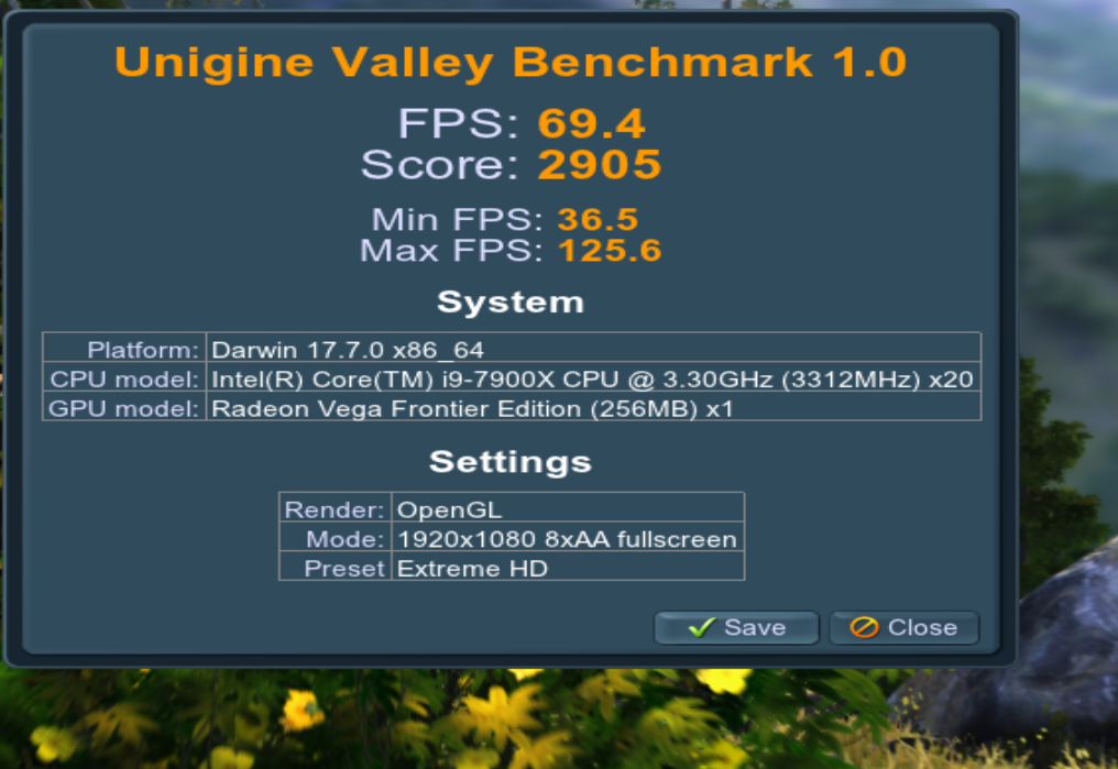

Tom01 Posted July 6, 2018 Share Posted July 6, 2018 (edited) On 6/30/2018 at 5:27 AM, WannaBeOCer said: I'm not using any powerplay kext, only whatevergreen with the Mojave driver. Just played 2 hours of Tomb Raider 2560x1440p @ 144hz and the highest temp I saw was 47c with the fan set to 2200RPM. Can you run Unigine-Valley with Extreme HD Preset!? My Vega 64 Liquid Cooling crashes and it is slower than the 290X on Cinebench. I am using macOS 10.13.5 with Whatevergreen. Edited July 12, 2018 by Tom01 Link to comment https://www.insanelymac.com/forum/topic/325120-vega-frontier-edition-on-high-sierra/page/11/#findComment-2624625 Share on other sites More sharing options...
surfinchina Posted July 6, 2018 Share Posted July 6, 2018 2 hours ago, Tom01 said: Can you run Unigine-Valley with Extreme HD Preset!? My Vega 64 Liquid Cooling crashes. And it is slower than my Radeon 290X. I am using macOS 10.13.5 with Whatevergreen. What was your score on extreme hd? My temps maxed out at 67, score 2905. My Vega is ex. air FE with an EK waterblock and a water bios in it. Link to comment https://www.insanelymac.com/forum/topic/325120-vega-frontier-edition-on-high-sierra/page/11/#findComment-2624646 Share on other sites More sharing options...
Tom01 Posted July 8, 2018 Share Posted July 8, 2018 @surfinchina It is crashing before finishing. In Cinebench it is slower than the 290X. The other Benchmarks are faster. @WannaBeOCer Which Brand do you have and what Power-Supply? Link to comment https://www.insanelymac.com/forum/topic/325120-vega-frontier-edition-on-high-sierra/page/11/#findComment-2624942 Share on other sites More sharing options...

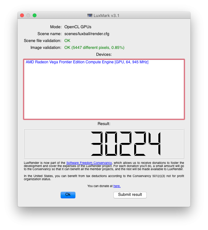

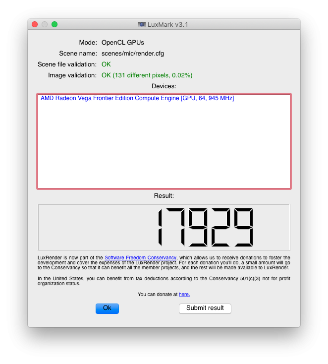

Tony Arnold Posted July 31, 2018 Share Posted July 31, 2018 7 hours ago, Tom01 said: With the SoftPowerPlayTable. Yep, my SoftPowerPlayTable didn't change - under High Sierra, Luxmark shows a Clock of 1642Mhz. Under Mojave, it shows 945Mhz. It's either a bug in Mojave, or a bug in Luxmark. It really doesn't have anything to do with my SSDT changes. In any case, the wrongly displayed clock speed of the GPU doesn't seem to impact performance - it's just cosmetic. Link to comment https://www.insanelymac.com/forum/topic/325120-vega-frontier-edition-on-high-sierra/page/11/#findComment-2628311 Share on other sites More sharing options...
